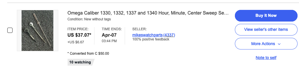

I am looking for another 1342. They seem to have become quite popular. I just got a battery clamp for mine. Debating on some hands on eBay. You are welcome to them.
https://www.ebay.com/itm/124671662930

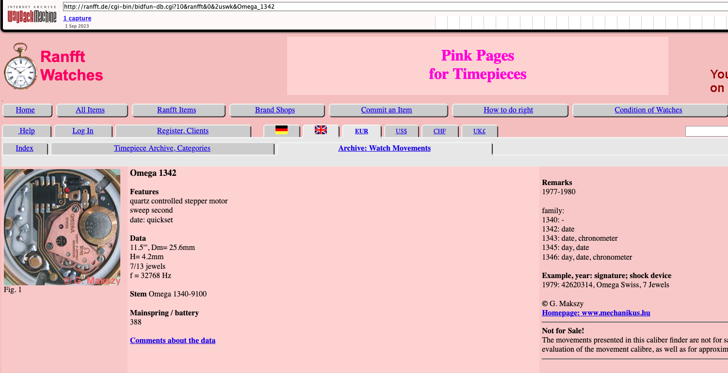

I have been grabbing screen shots from archive.org There are over 10,000 pages. Bit tricky finding stuff. The index does not track the whole alphabet. I think it overflows around J or H. If you have a base link, you can Sometimes edit the url to replace the manufacture and caliber.
Since the archive index craps out at 10K most of the common hits are in German.

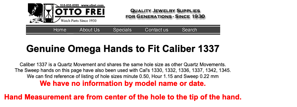

I found where I probably got my reference to the hand size. oFrie. I am including a screenshot as links tend to die.
It looks like some ETA hands may fit as well... - good luck.
Omega 1342 hand holes = H1.15 x M 0.5 x S 0,.22
