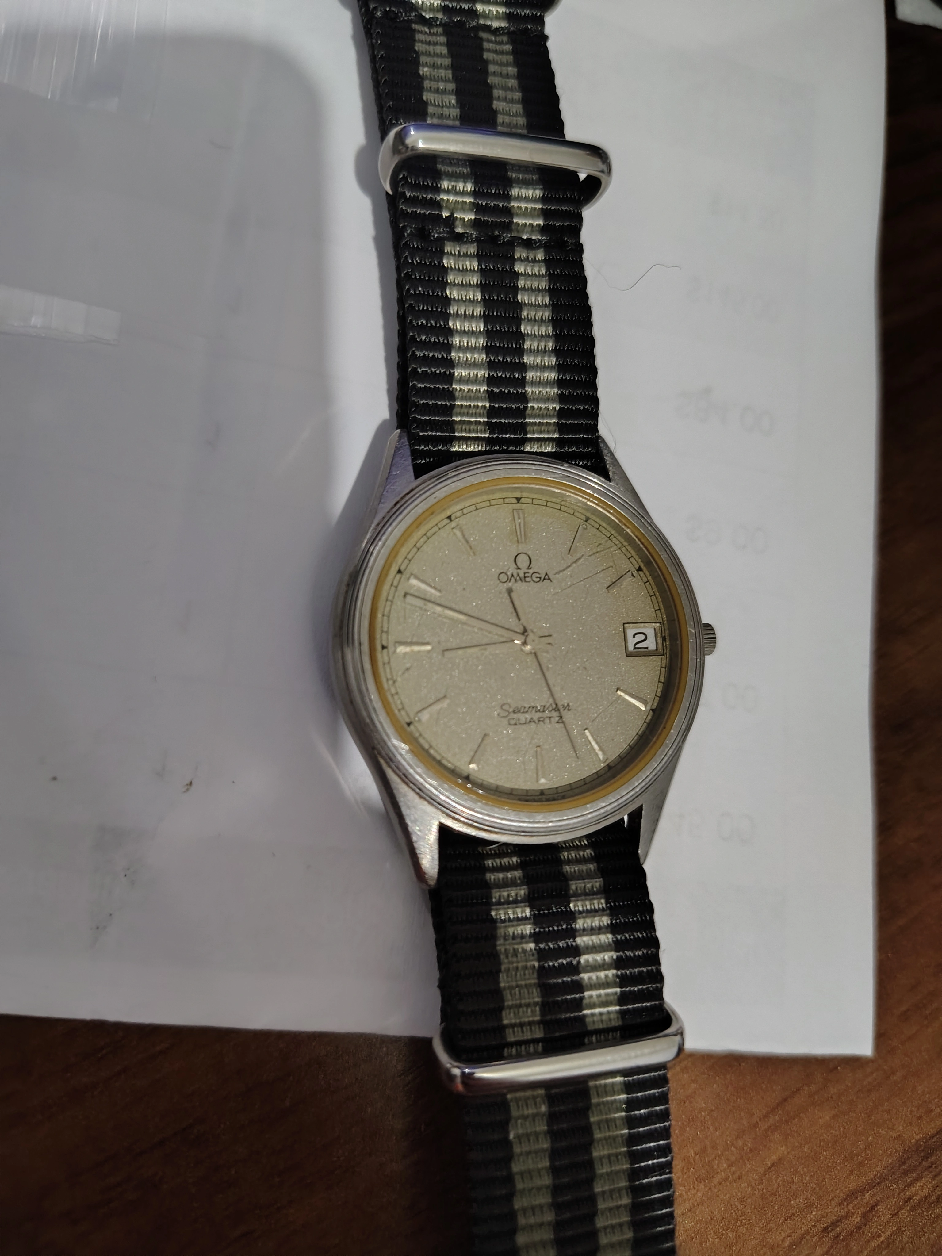

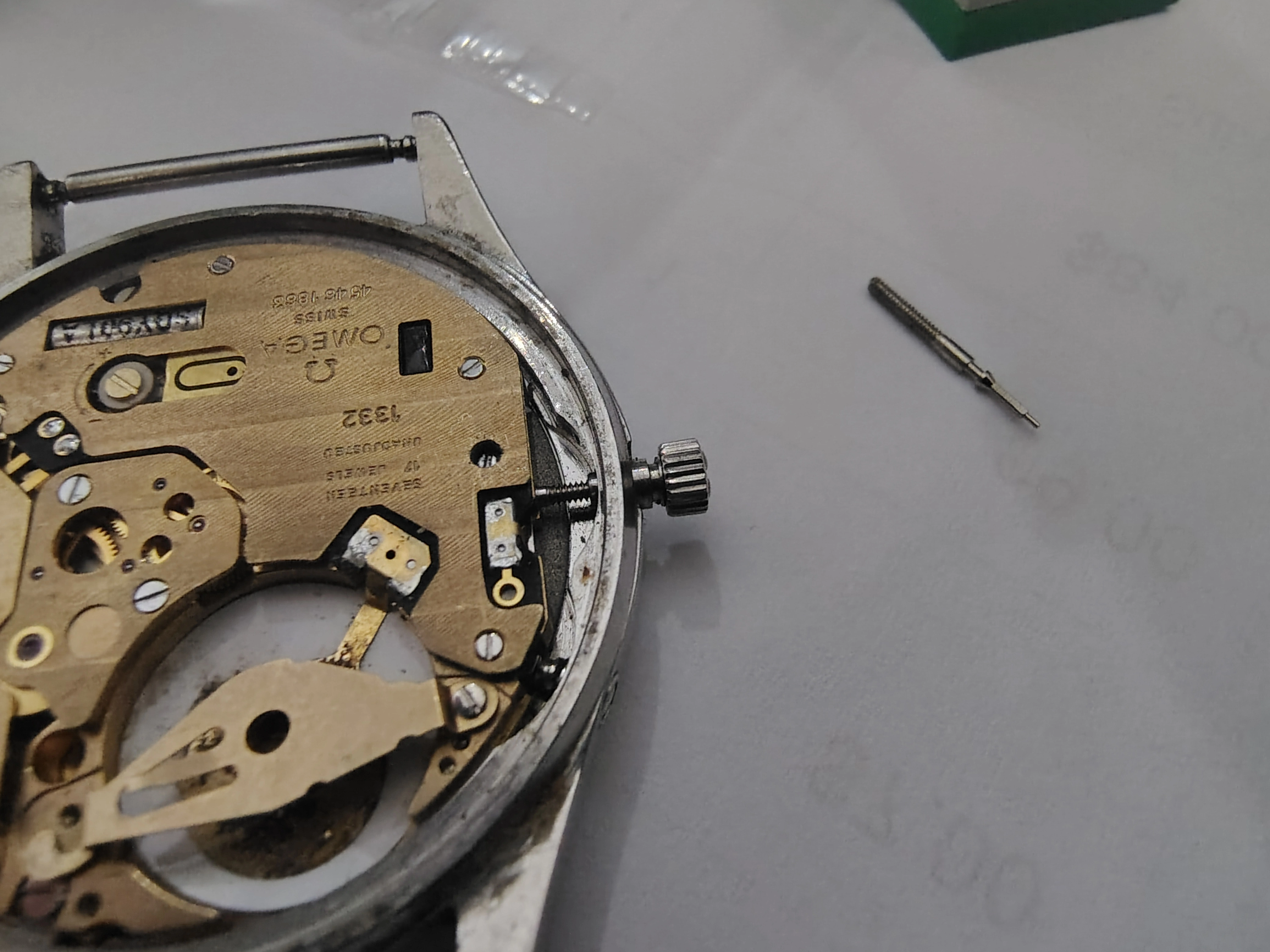

Hello all,
I've got an old 1332 Quartz that came with no crown. It works fine with a battery but has otherwise had a hard life. Evidence of light leakage and the stem was clearly broken.
Before I'm reminded of my stupidity for trying this myself, which I will certainly accept - an Omega repairer in Melbourne (from their website) quoted me $700 something for a potential crown repair. It cost me nothing and I like to learn. I also don't have that to spend on a watch that I could replace for less.
I've got the NOS stem and crown. I've removed the old stem and as thought, it was snapped at the crown end. Now I've tried inserting the replacement and while it does go in most the way after a slight rotation to catch the square end, it doesn't completely go in.
Any ideas?
Forgive my lack of correct terminology. Thank you all for your assistance and input. View attachment 3052555

Alright - this will probably reassure that I am absolutely butchering this task, but I think I've had a breakthrough.
I tried putting it in carefully once more, being careful not to force it or push etc. Upon turning it, it did turn one of the hands. Would this mean the clutch was out/engaged? Could it have been out when the original crown snapped off and that's why it won't go the full distance now, because the clutch is pulled out?

Have you trimmed the stem to the correct length? Stems typically (but not always) have to be trimmed to fit the specific use, so they are left intentionally long...
I did read that was sometimes the case. I haven't done that yet but can this weekend. I incorrectly assumed a NOS stem wouldn't need it.
Should it click in otherwise though? Or will it always pull out with ease until I use the tightening screw.
Thank you!

Stems cut to length for Omega is a relatively new thing, so older stems are almost always needing a trim, unless you happen to get very lucky.
Once the stem is pushed in as far as it will go, tighten the screw. Then check to make sure you can pull the stem out to the time setting position without the stem coming out of the movement. If the stem is secure in the movement (you can push it in and pull it out a few times without issue) and the crown is still not up against the case, the stem needs to be trimmed.
Trim carefully - if you trim too short it won't be good.
that screw is what’s holding the stem secure in place , if you insert the stem without tightening the screw it will go out when you pull it .

Right, so if I put the stem in and tighten the screw now with it being too long, I should at least be able to see if the stem does indeed work as meant to.

Everyone - fantastic but surprising news!
I tried it pre-trimming and the crown pulled out as desired, so I could set the time etc.
I looked at how much I'd need to shorten it by and thought it looked pretty close to the snapped stem.
Whacked the crown on that and it's working perfectly. Maybe it wasn't snapped after all, and the old crown simply fell off? Thread looked a bit crooked though which was why I suspected a snap.
I've now got a spare NOS stem too!

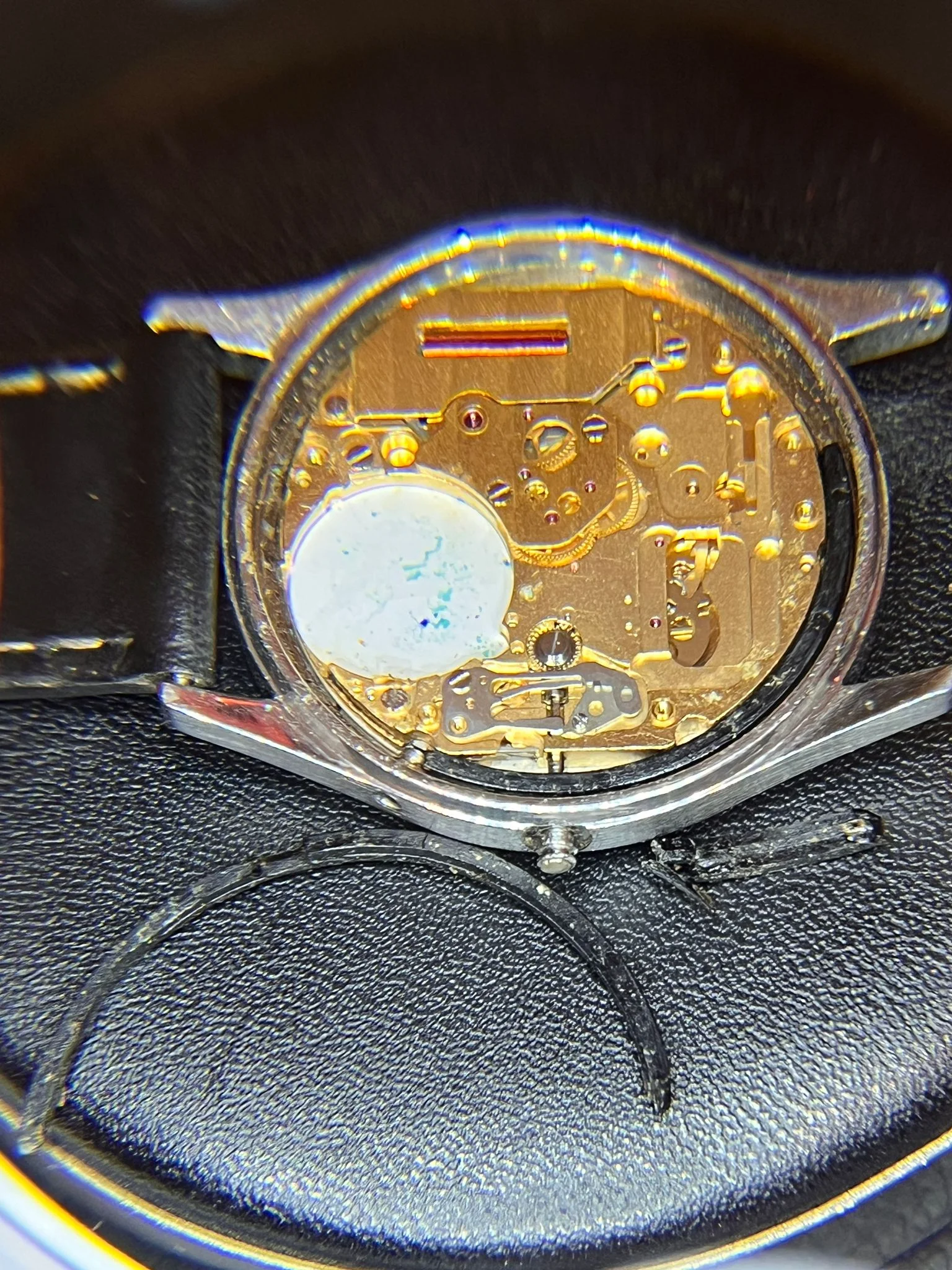

Quick question: whil I was taking apart the watch the plastic ring (see below watch) between the movement and the cast broke because of old age. Wondered if you know what the part is called/ what the number is?
To be honest, I have no idea as it doesn´t appear on the guide I posted up there. Mine broke too but it still fits perfectly. I am thinking of just sticking it together as it only holds the movement in place.
