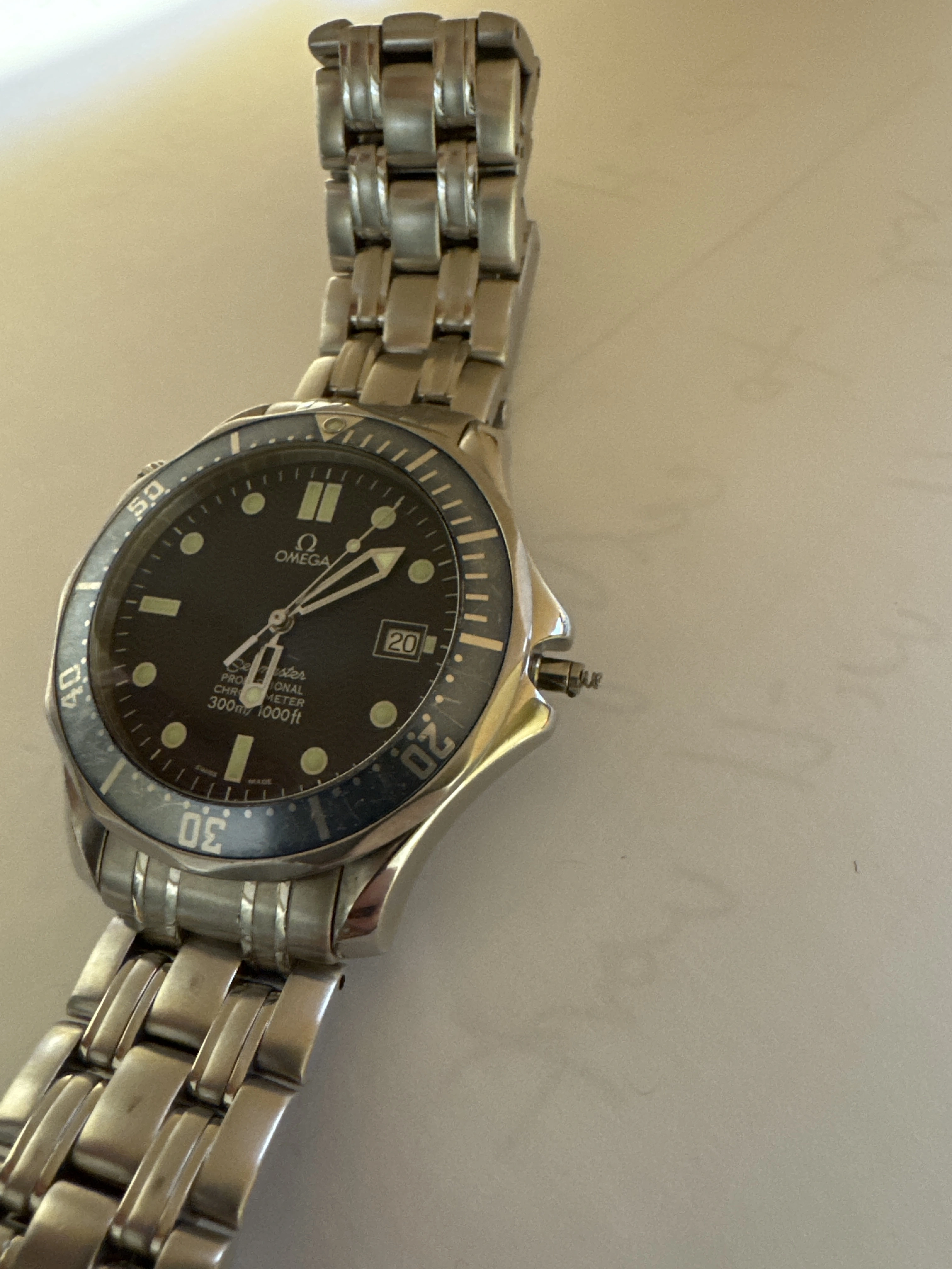

I wish I was making this story up. I picked up my new-to-me 2531.80 Seamaster today @ FedEx. First nice watch I’ve ever owned. Sitting in my truck, I opened up the box, unwrapped the watch, etc. I immediately went to try and pop out the crown to set the date and time, and the crown would not budge no matter what I did. Crown also wouldn’t turn in place. I got out my knife I keep in my truck with a tiny flat head screwdriver attachment and tried to gently pry on the crown against the case. Apparently I was too forceful and the first movement the crown made was to completely fly off into the unknown of my truck. As of right now I spent an hour searching, my hands are freezing cold, and I have not located the crown (and whatever else I might be missing because I have no idea what I’m doing).

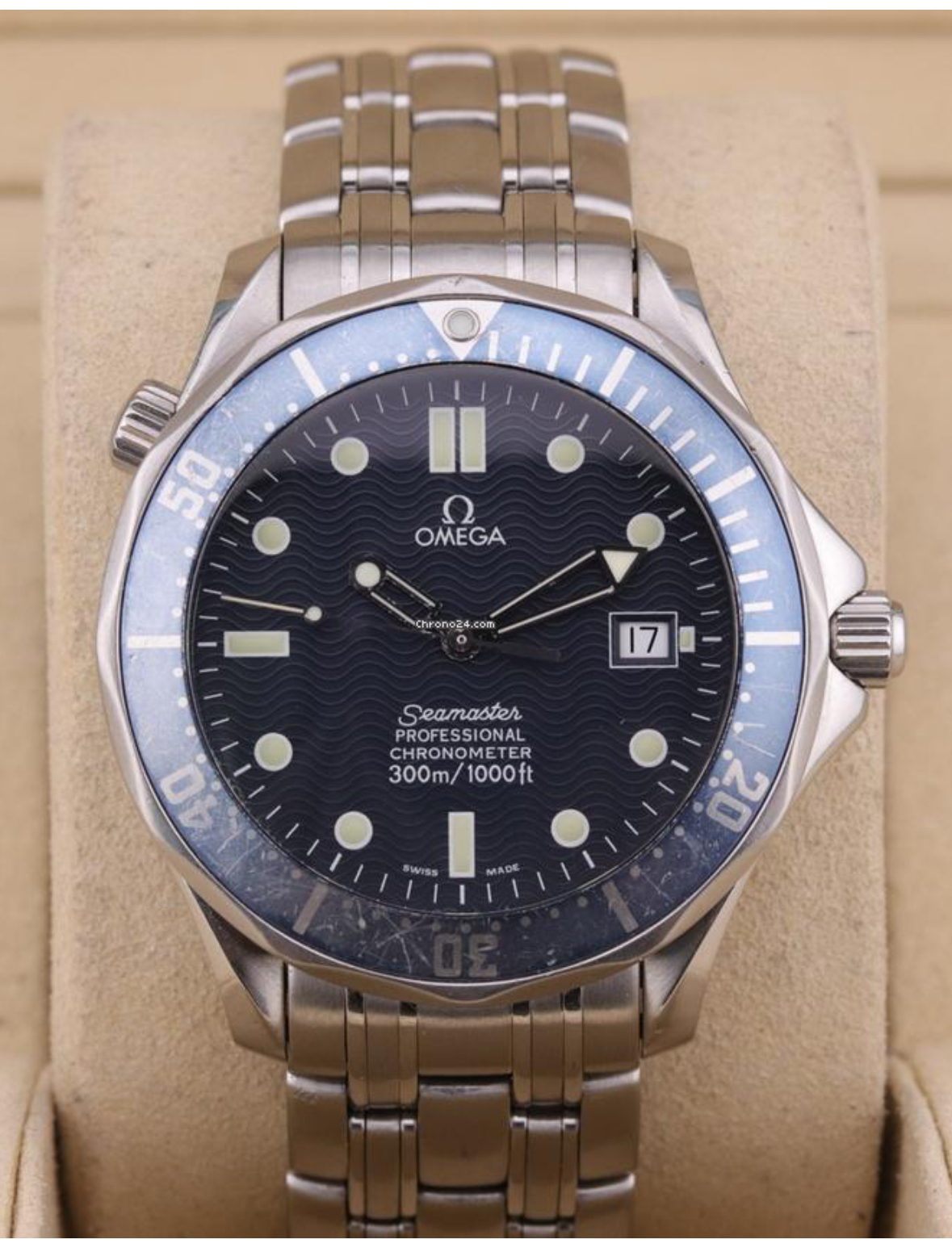

Can anyone help guide as to what I should do next? I have photo attached of the watch from the listing with crown on, and a photo of the way it currently is. I don’t even know where to start other than keep looking through my truck for the crown.

Unfortunately it unscrews my friend

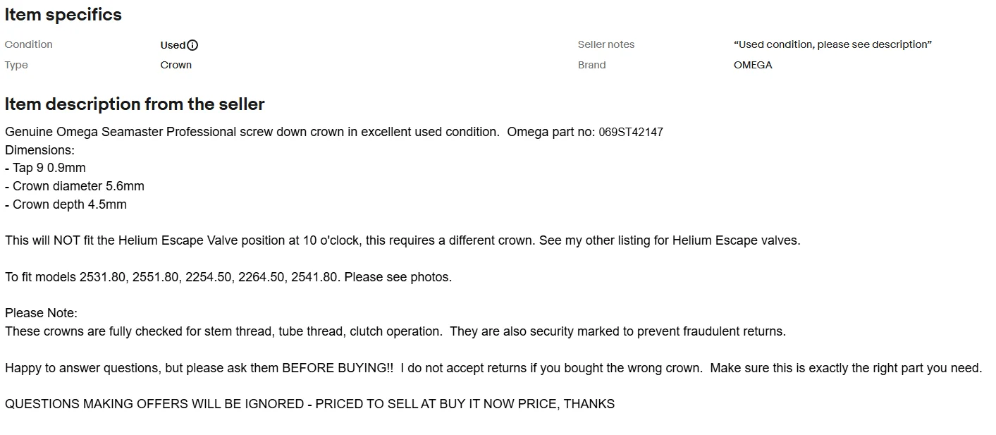

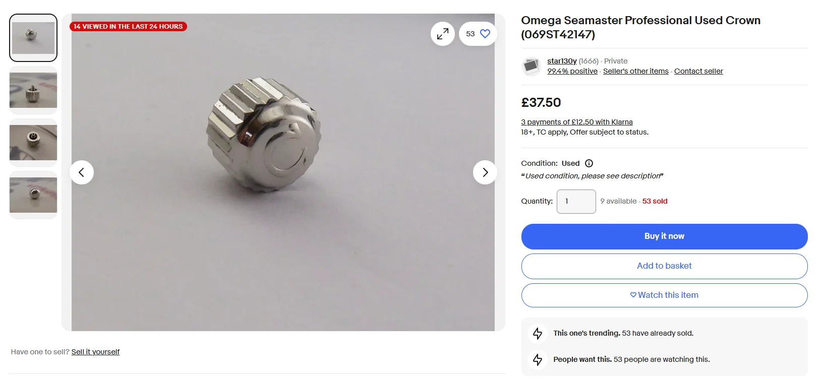

Hi there,
I just bought a new rubber gasket for my 36mm (2561.80) from this eBay seller.
Fortunately they are selling a replacement crown with screw.
Hope you can get it sorted!
eBay Link: https://www.ebay.co.uk/itm/26617663...9QX1E9&hash=item3df95d2166:g:02QAAOSwf5BiBP4L

What you have done is break the crown itself. The cap of the crown that has the logo on it has separated from the tube portion of the crown that screws into the case. In my view, the only reliable way to repair this is with a new crown.
Although the post with the replacement crown for sale might be helpful, the advert is misleading, as that crown will not fit all 25318000's. The 25318000 used a few different cases, so in order to determine what crown you need, you will have to open up the case back, which also unscrews. Inside the case back there will be some information, but there will be numbers. The crown and case tube (the part that the crown screws into - just in case you need it) will vary based on those numbers as follows:
168.1503 - crown needed is 069ST42123, case tube 090ST4201
168-1603 - crown needed is 069ST42123, case tube 090ST4201
168-1623 - crown needed is 069ST42147, case tube 090ST1231
You may also need a new winding stem - 72211205101021
