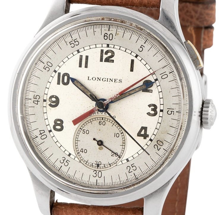

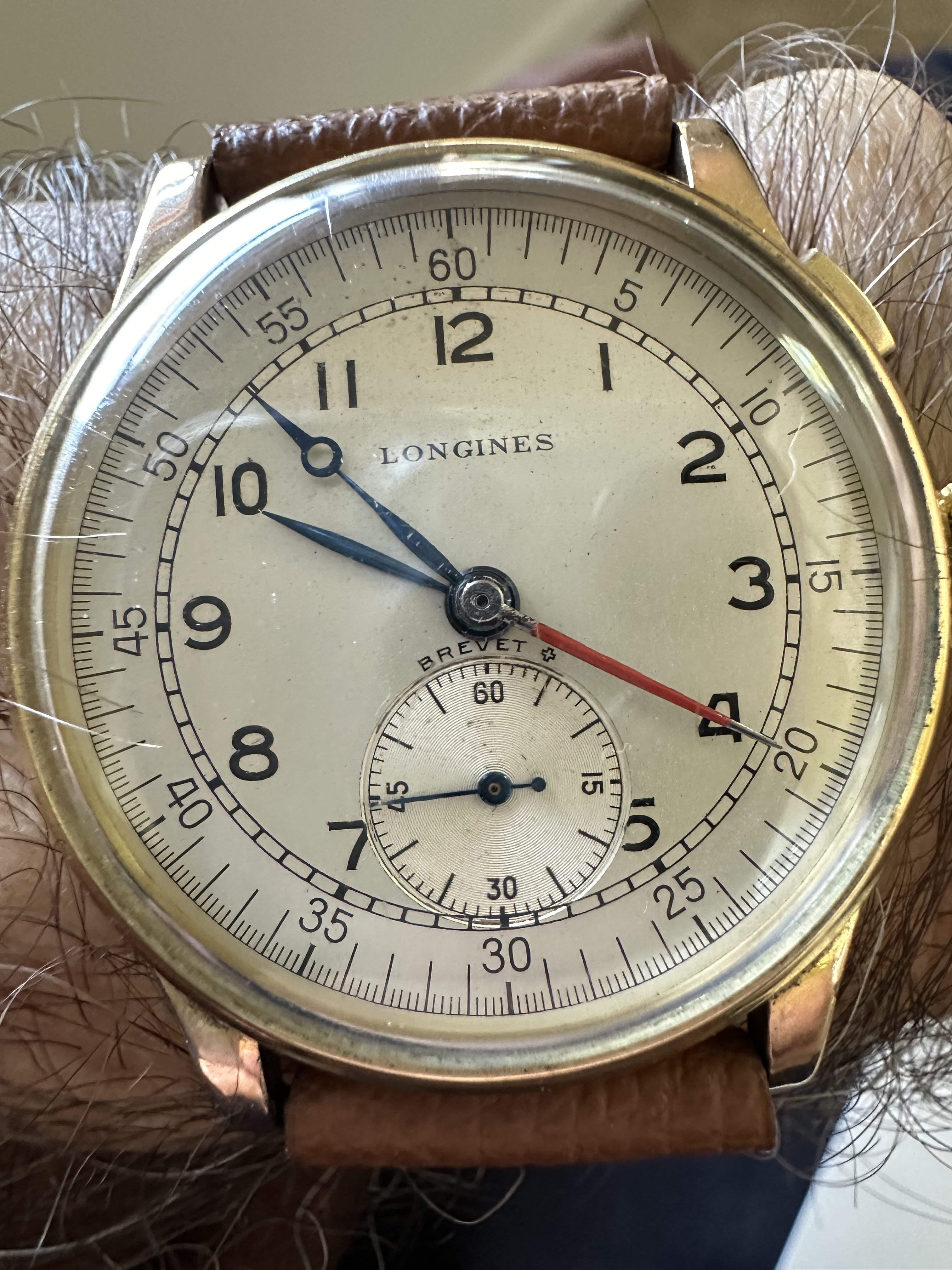

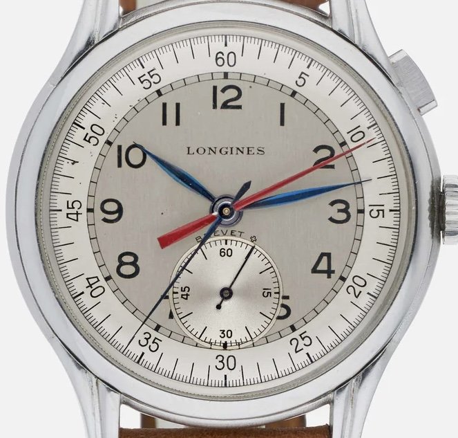

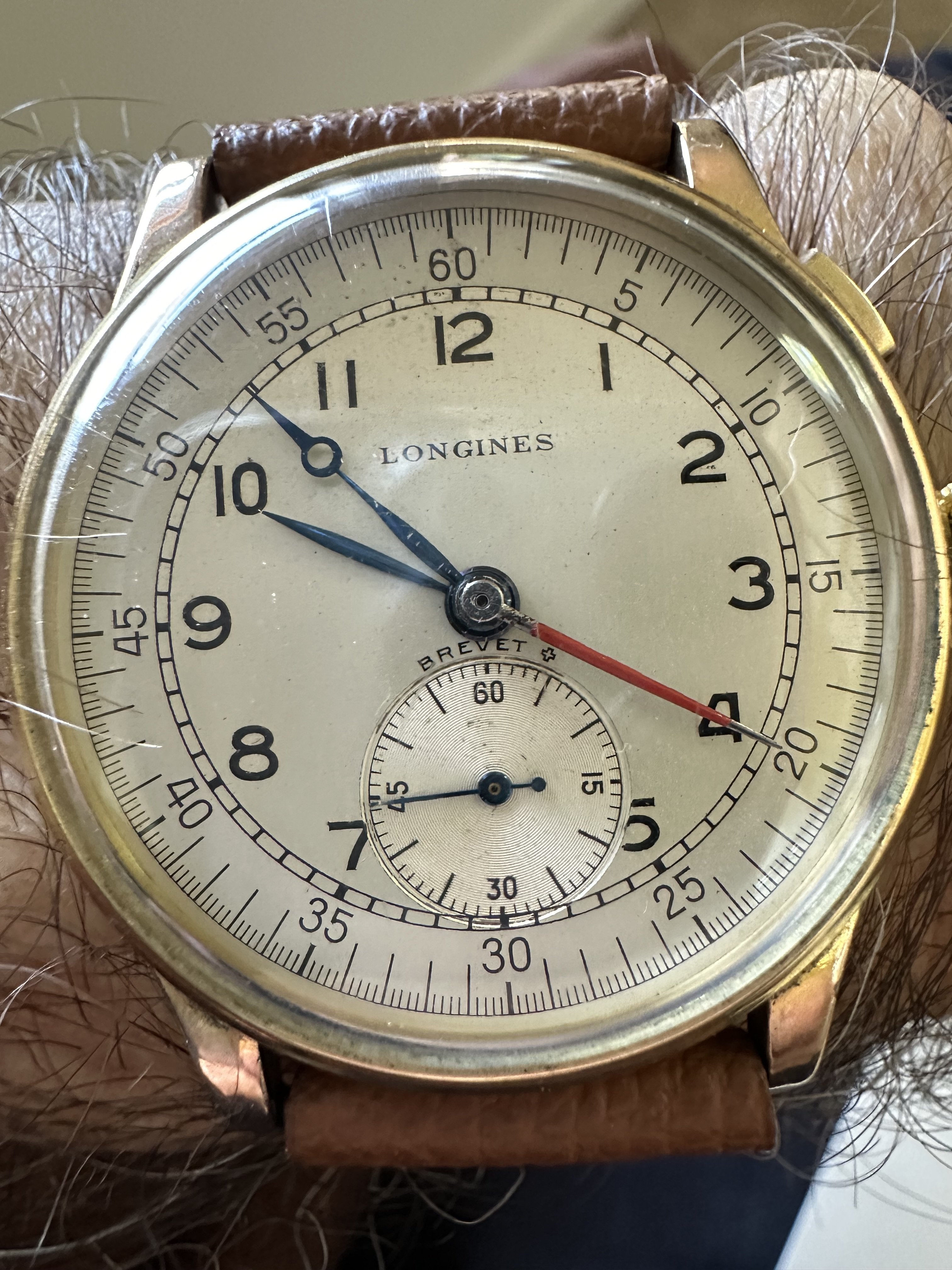

I am a green watch collector (hopefully just green, not glowing green). I recently bought this 12.68Z:
This watch is missing a central seconds hand. I also think the chrono minutes hand tip and tail both were damaged and it was patched back up. When I purchased it I was thinking the watch was originally sold without a seconds hand at the buyer's request, but the broken minutes hand makes me now think that is not the case. Also who wants a chrono with a minutes hand only?
I was planning on getting a new seconds hand for the watch, I looked at the mechanism and it is still working great for the seconds hand in terms of how the central gear is turning and resetting so I think it only needs a hand. Does that sound sensible?

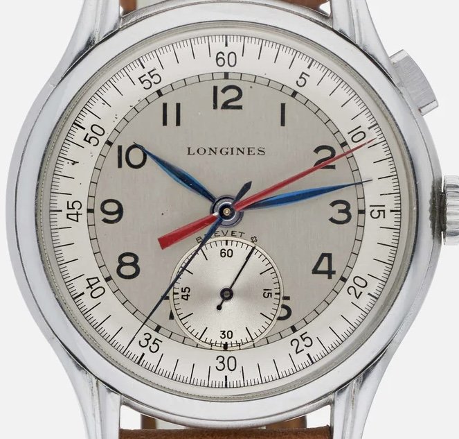

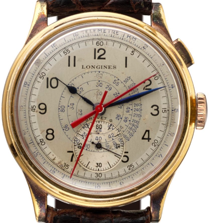

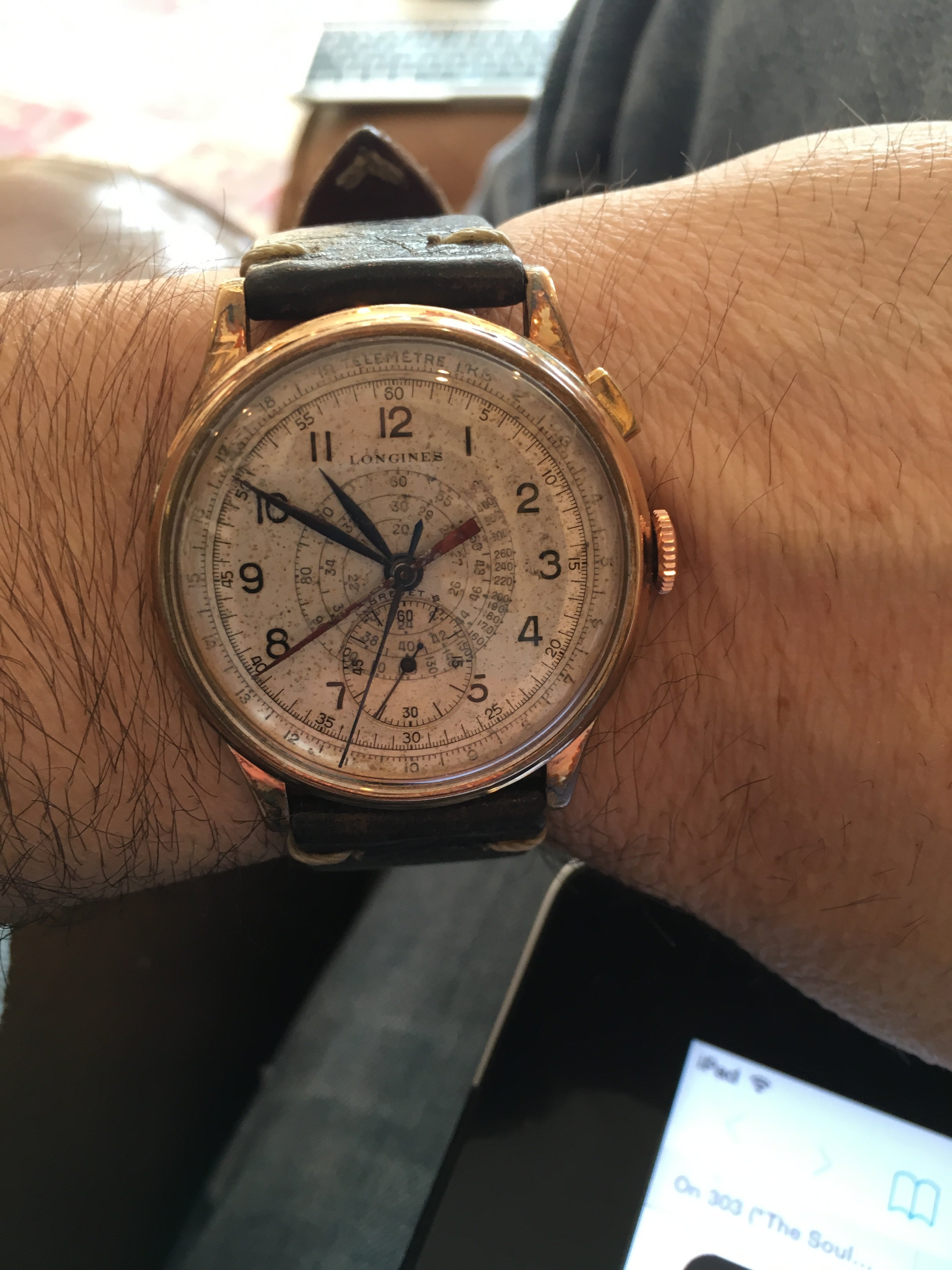

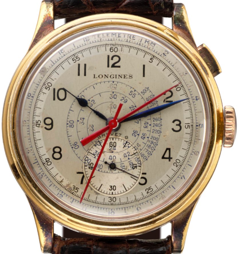

PS here are a couple other examples of 12.68Z from a similar late-40's period for reference. The first one is also the exact same reference number, 5034. There are another ten in Goldberger's book and they all have a central seconds hand; two have only seconds no chrono minutes.

Are you sure this is a 12.68Z movement? I have never seen a 12.68Z with anything other than a minute and an hour hands plus a subdial second hand. Or is the chronograph function an add-on?
17
5
It is an add-on, below the chrono stuff it looks pretty much like the non-chrono 12.68Z. Why didn't they give it a new number? Beats me! There are many chrono 12.68Z out there, all the Longines monopusher flyback models I think are 12.68Z based.

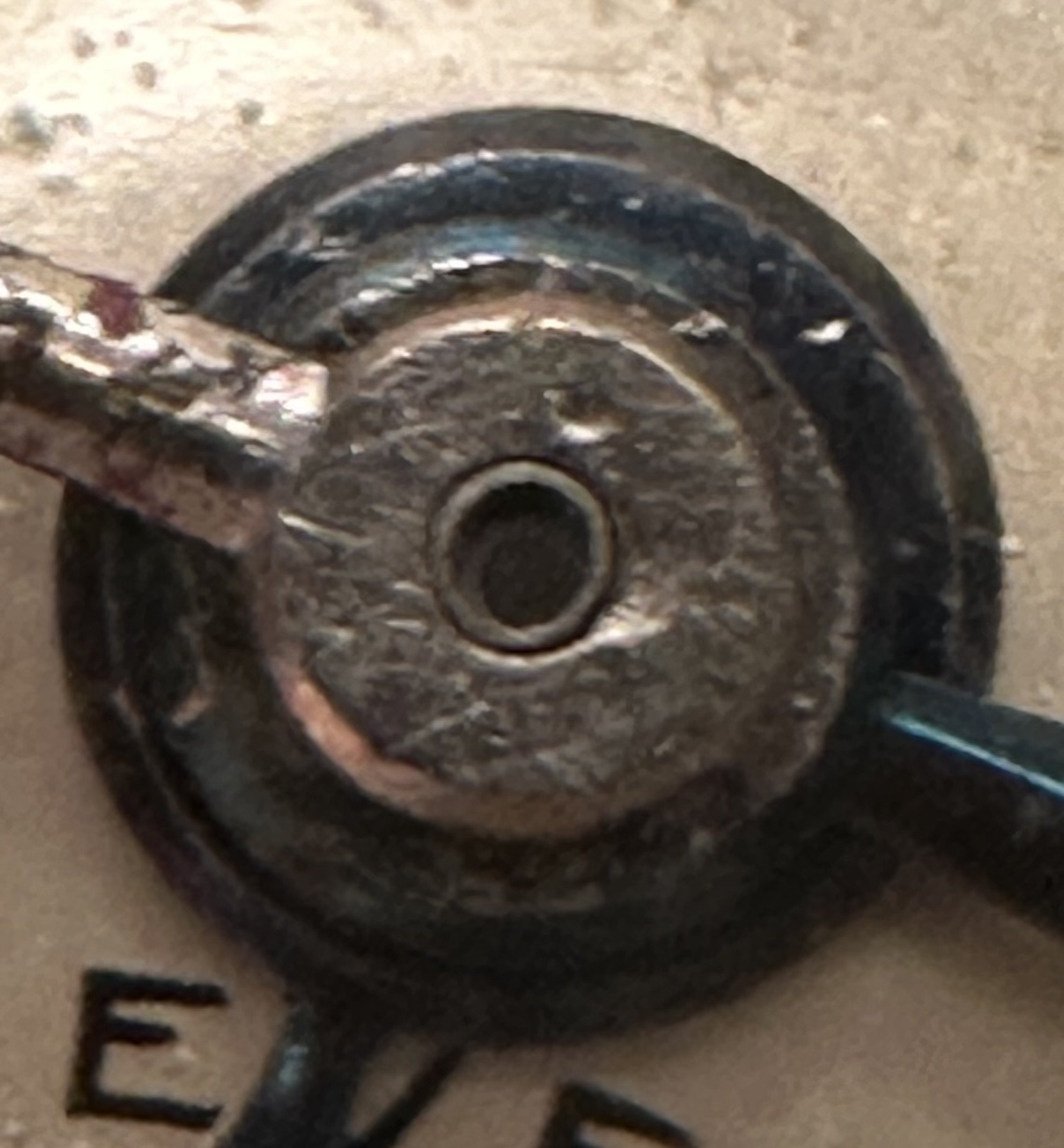

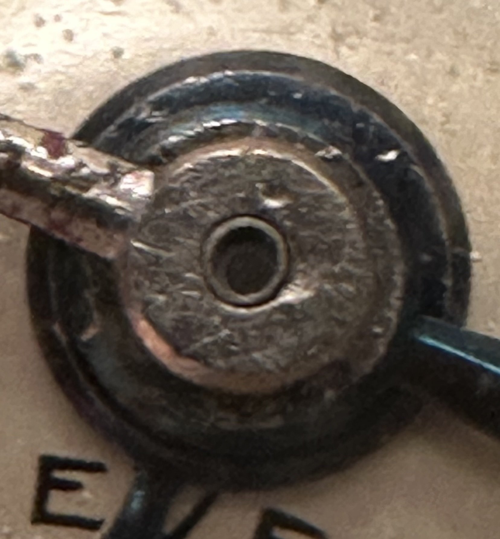

Yes I think you are right.. I didn’t realize the seconds hand has a female end on it. I guess the shaft is usually part of the gear wheel driving it? To be clear I am not planning on just getting a hand and fixing it, I am going to send it in for repair. It sounds like that gear wheel will also need to be fixed then..
Here is a picture, I think there should be a shaft coming up through the middle there and there is not?
1,145
5,654

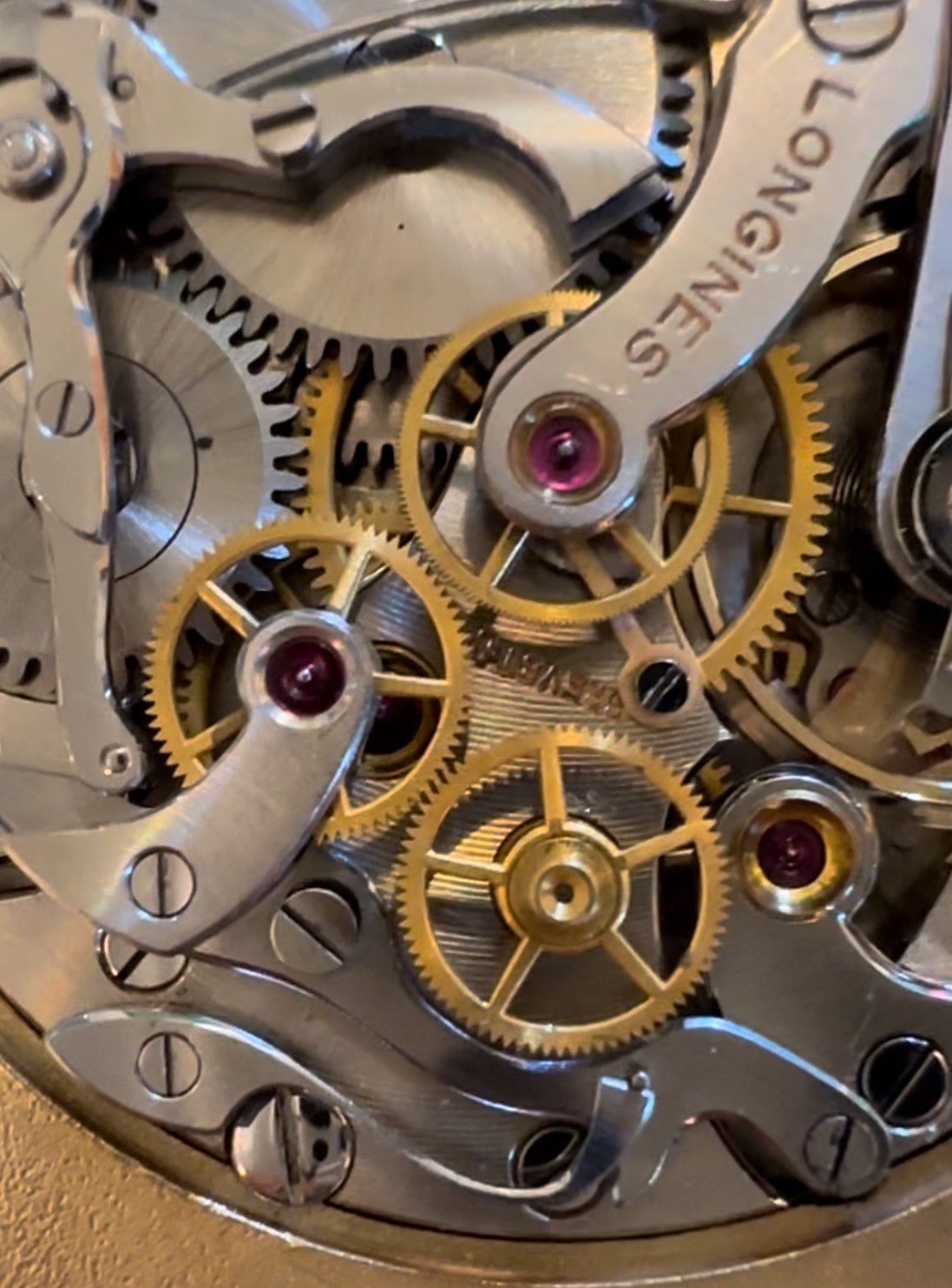

You are right, unfortunately I believe this part is obsolete. But a good watchmaker would be able to re-pivot the gear. Do you have a picture of the movement?
17
5

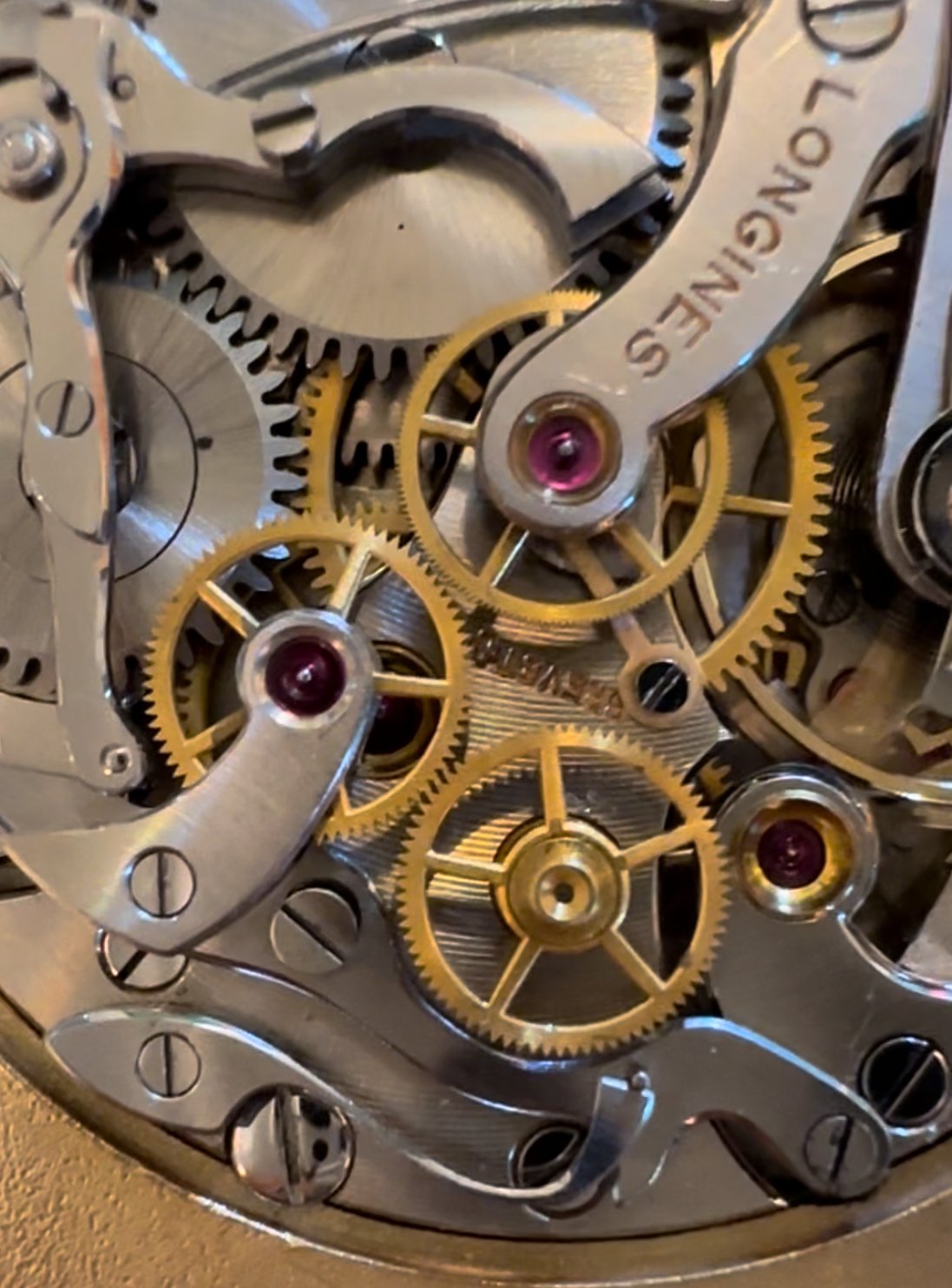

Here is a shot I took of the seconds wheels. They were mis-aligned but fortunately it was an easy fix.
The watchmaker I use can make parts, I think the main issue will be the cost.

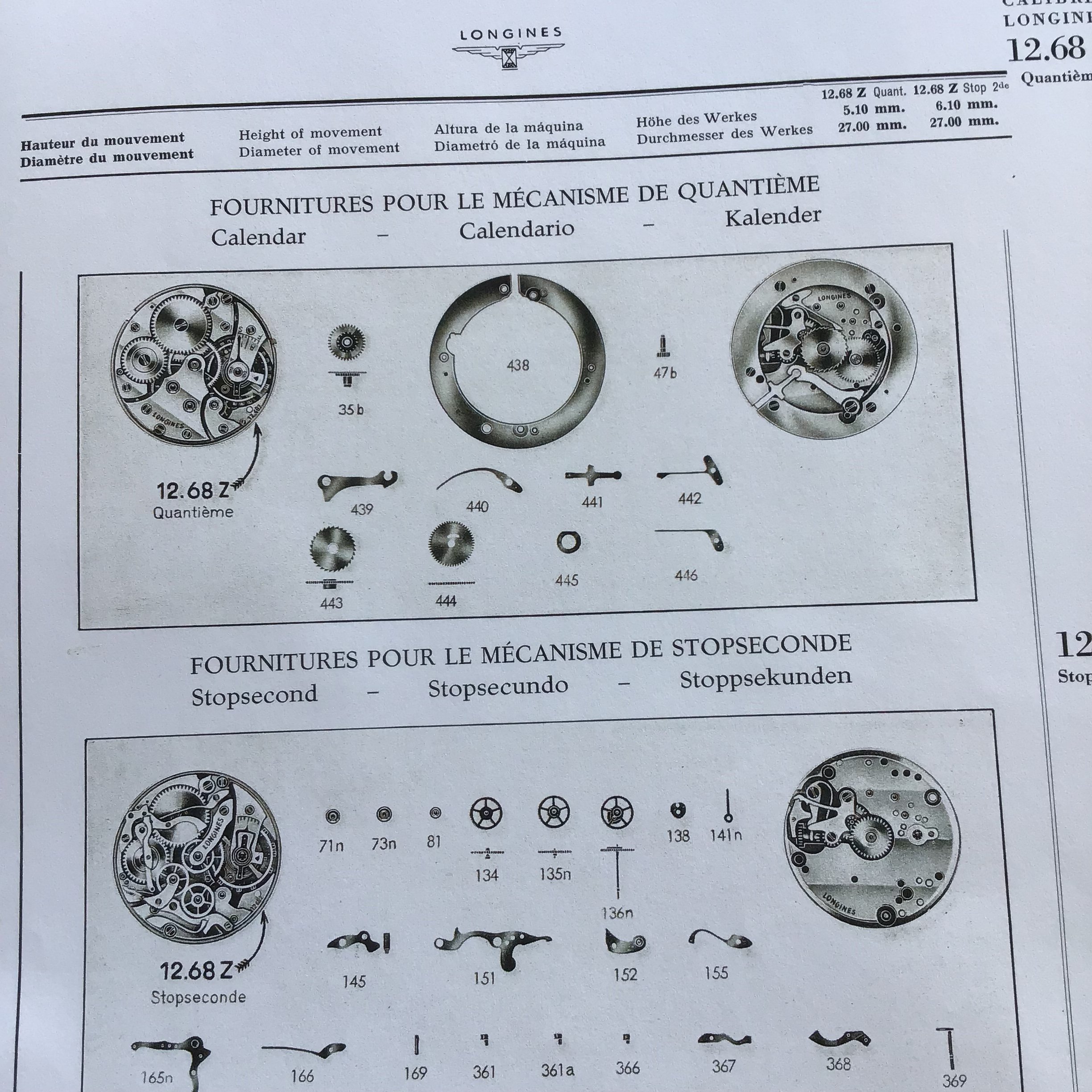

Thanks for that parts picture, I can see the central seconds wheel in the list.. it’s the one with the long shaft. The Goldberger book shows the 1938 patent but no parts list.
