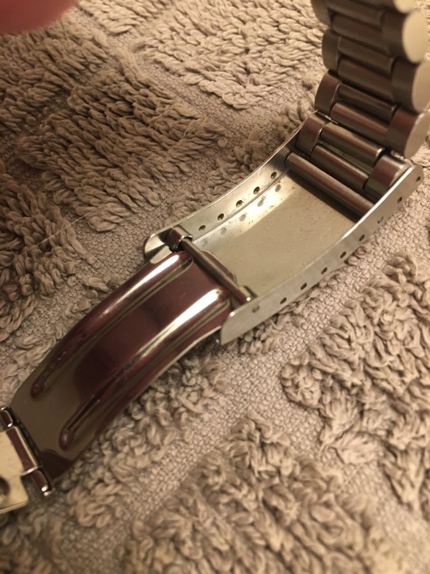

I recently bought a new 1171 bracelet from my Omega Boutique to see what a lighter, more vintage-style bracelet would feel like on my Speedmaster.
While I love the lightness and slinkiness of the piece, I'm troubled by the fragile nature of the clasp. Specifically, as you can see in my pic, the jointed "leaf" of the clasp is attached to the outer clasp with only two small rolls or folds of steel, which - as I've already learned - are easily opened if there is any twisting or flexing of the bracelet (especially when putting the watch on, or taking it off). I had the leaf half-way separate from the bracelet the other day while taking the watch off, which is how I discovered this seeming design flaw. I note that on my Rolex Submariner (circa 2004), the leaf is attached to the pin by a complete roll of the entire steel leaf, not two tiny fold-backs, and is therefore much more secure.
So, my thought was that these two folds could be reinforced by spot welds, permanently preventing them from spreading apart and coming off the pin. I figure someone like Rolliworks, or any shop set up with micro-welding equipment could accomplish this.
Just curious: has anyone tried such a remedy on this bracelet before? Or perhaps come up with another solution?
Thanks,
D

Take a thin-nosed-pliers, and bend those folds further such that the bracelet can not open/come-undone (thats how I fixed mine). But I agree : this is a bad design (especially considering the cost), and probably has/will cause many expensive watches to be damaged.

Thanks Eugene, I did indeed use padded pliers to compress the folds as much as possible. I never looked to see their position before it separated - perhaps they weren't fully compressed to begin with, but I am super cautious now when putting-on or taking-off the watch, to prevent putting torque on that joint. I also loosened the bracelet in terms of fit so it goes over my hand easier (requiring less pulling/twisting/tugging), but this is looser than I would normally wear it.
It's a drag because, while I like the way the bracelet looks and feels, I feel like I have to treat the watch like it's fragile, lest I flex my wrist too much and realize the bracelet has come apart. Kind of takes the "tool" out of "tool watch." If it comes apart again, I'm going to have to go back to the bruiser bracelet the watch came with.

True that the Rolex version of the stamped metal clasp is a bit more robust. Not only there is a complete roll around the pin, but the pin itself is a solid rivet. The one on the Omega is a spring bar (i.e. hollow).
But this kind of clasps have been in use by Omega for decades. I can't believe they are as fragile as you feel.
I think the contrast against the modern milled clasps is biasing your perception. I think that a bit of tightening is all you need to be perfectly safe. Technically speaking, you have the same potential issue in the hinge between the two blades.
After my watchmaker did it for me, I tested it by trying to push the bar out of the 'folds'. I could not no matter how hard I tried, and that made me happy.
Very true.
I think it's also possible, this is a quality control issue - i.e., the two fold-over sections may not have been fully compressed to begin with. For instance, on this clasp, opening/closing the snap latch took herculean effort - to the point that the first time I opened the latch - straight out of the package - I thought I was going to break the bracelet. I needed to adjust the curvature of the leaf to adjust the snap tension to a normal level. So ... could be the fold-over sections on the pin simply weren't compressed properly. I'll never know, but they are certainly pressed down now!

I have noticed on mine that the bar popped out of one of the sides of the clasp and it could have easily fallen off my wrist. I try to carefully put it on and take it off so this does not happen and inspect it pretty frequently. There are quite a few stories online about this and I shouldn't have been surprised when it happened to me too.
Is this an issue with the modern 1171s ? Could it be that they are now using a thinner clasp spring bar than what they used in the past ?

I actually misspoke, your bracelet looked the same as the one I have on my FOIS seen here but the reference numbers are different. Still, same idea, same poor design. It's a decades old, vintage bracelet so I am not exactly shocked
