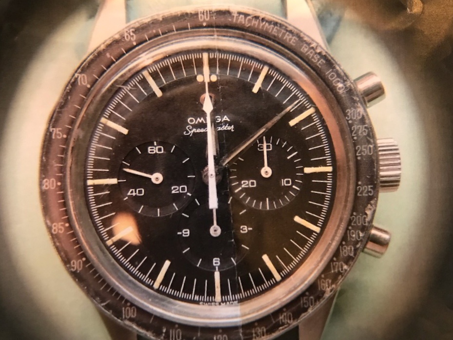

It is for this bad boy

If you are fine with this one - no problem here 😀
I am very satisfied with the one I've got. But I am looking for a DON bezel and a 7912 bracelet

I can trade you a DON with the one installed on the watch if you want 😗
No thanks But if you want to sell, you can tell me what your DON is worth?

So you have a Franken, but in a good way with a bezel that is from the earlier 2998 and a chrono hand from the later 145.012. As noted above, you may find that some would swap a nice Base 500 DON bezel for that your tatty Base 1000 as yours is way more hard to find and isn't original to your watch in any case.
I am very sure that many people would swap, but not me. I'm just looking for at base 500 DON bezel

Nice looking watch and clearly some mismatching parts.

Yes, I know the hands and the bezel are off, but besides from that it is original.
I will take your advice regarding the bracelet under consideration. Thanks
