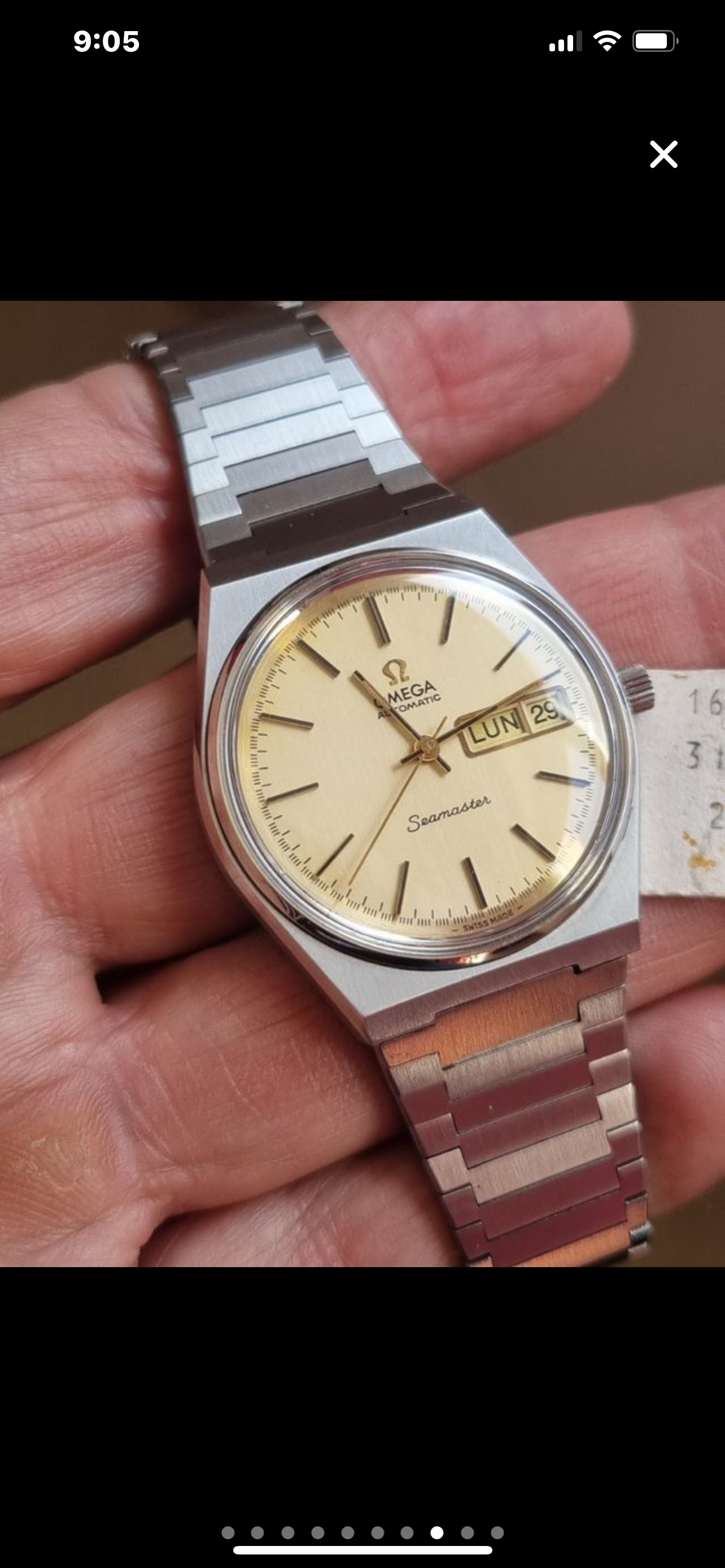

Okay, I will search patiently cause now my goal is that the mechanism works nicely. In my case the design that appeals to me is something similar to this:
Thank you again to both of you for the advice!

Ok well obviously that has a bracelet so you won’t find one for £250-300. I’d say these probably start around £450 for anything worth having.
Make sure the bracelet fits your wrist, some of the links for these 70’s bracelets are very hard to find if you need to make it bigger
