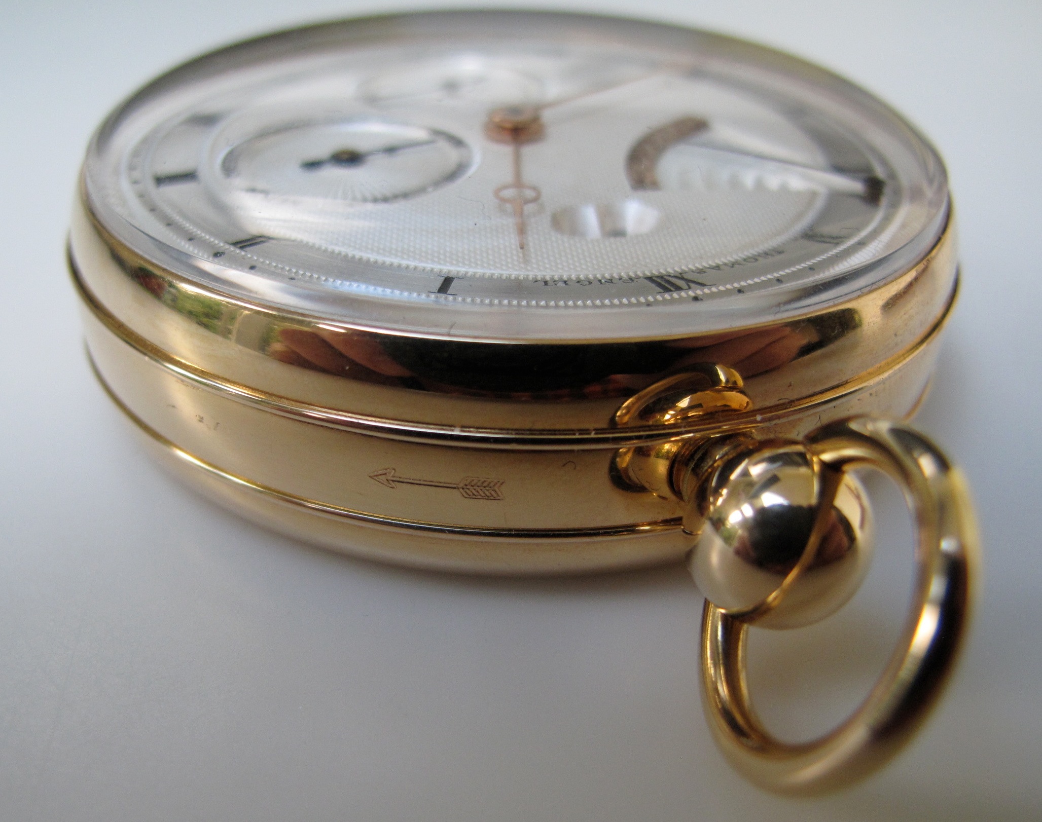

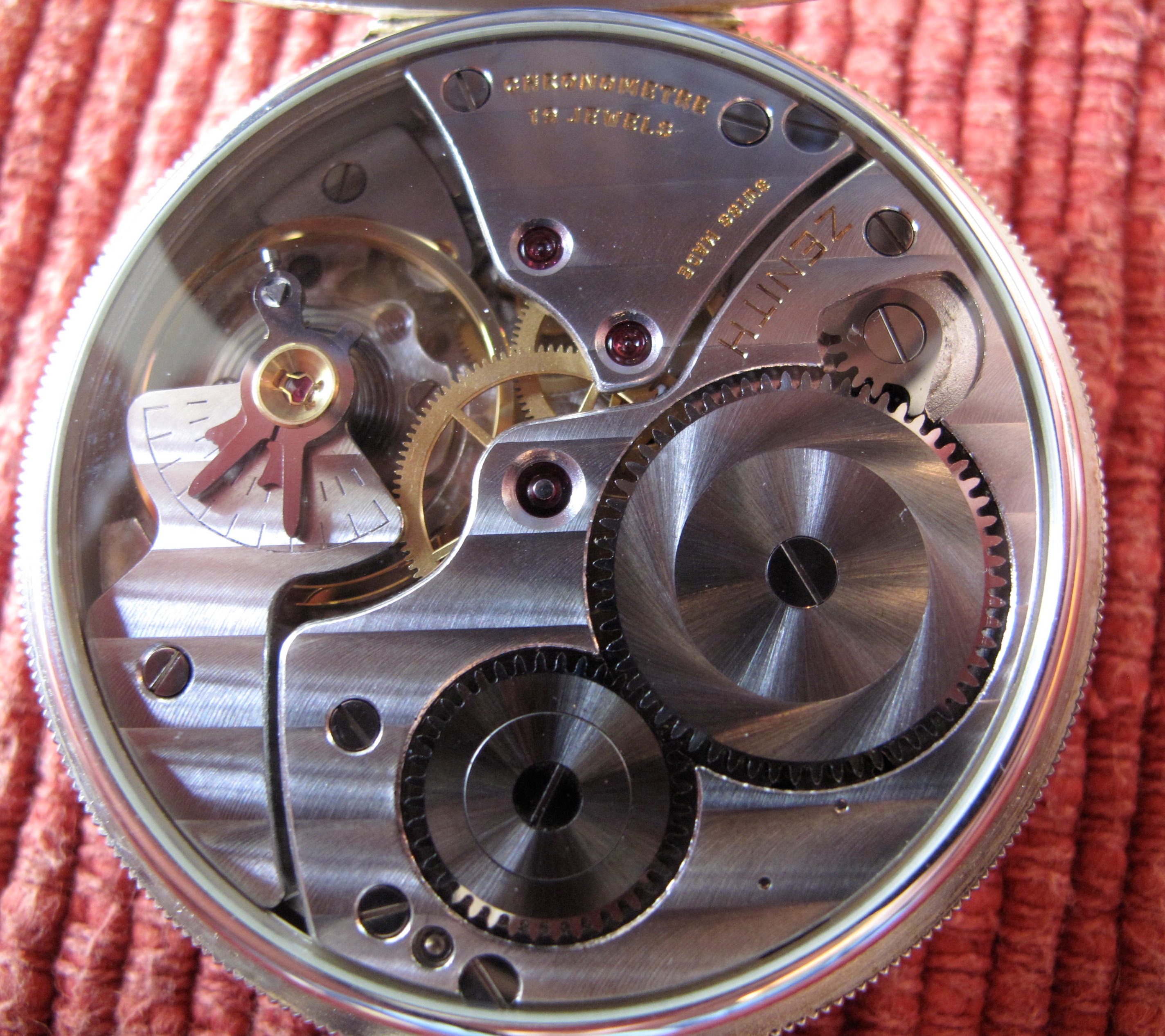

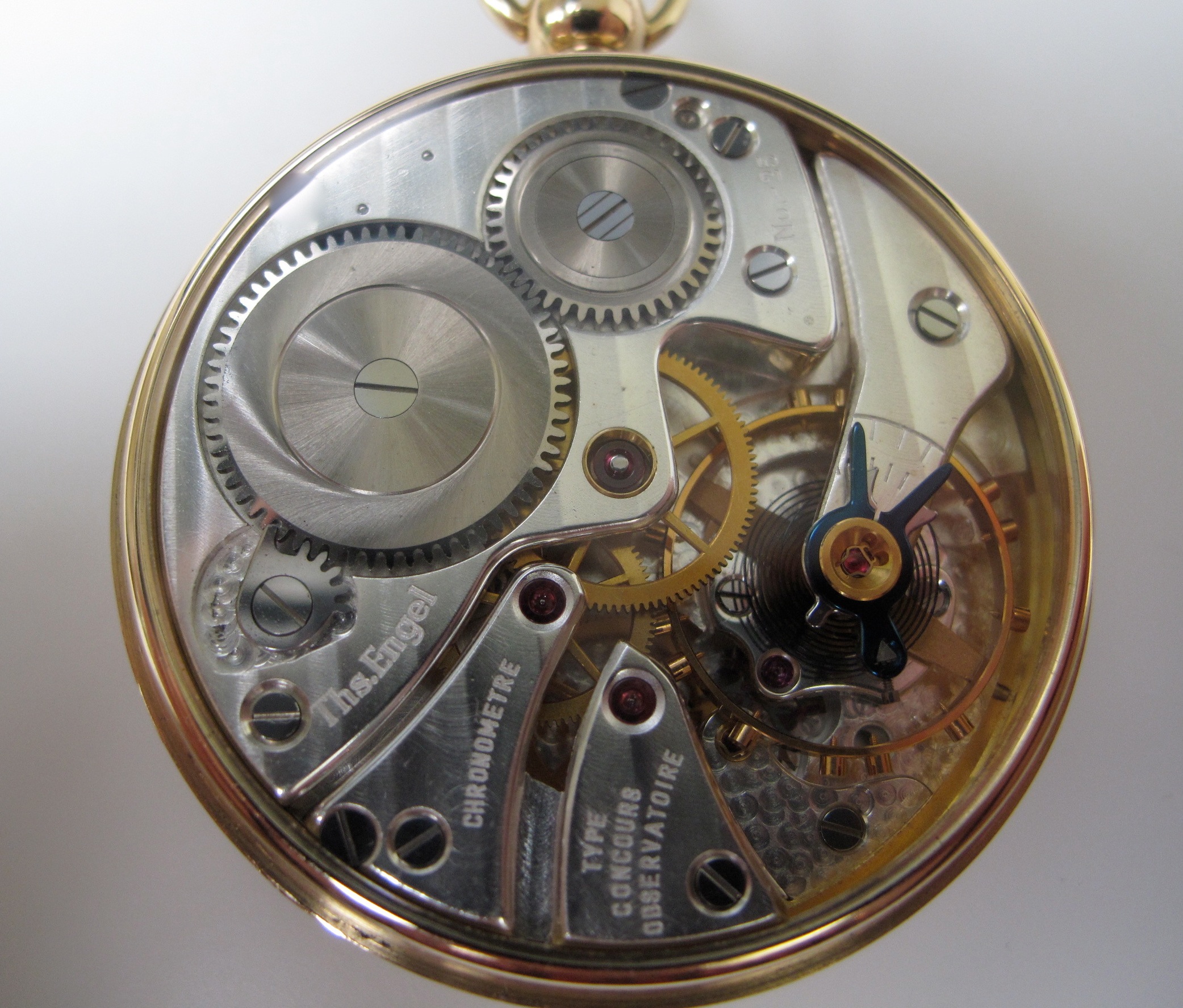

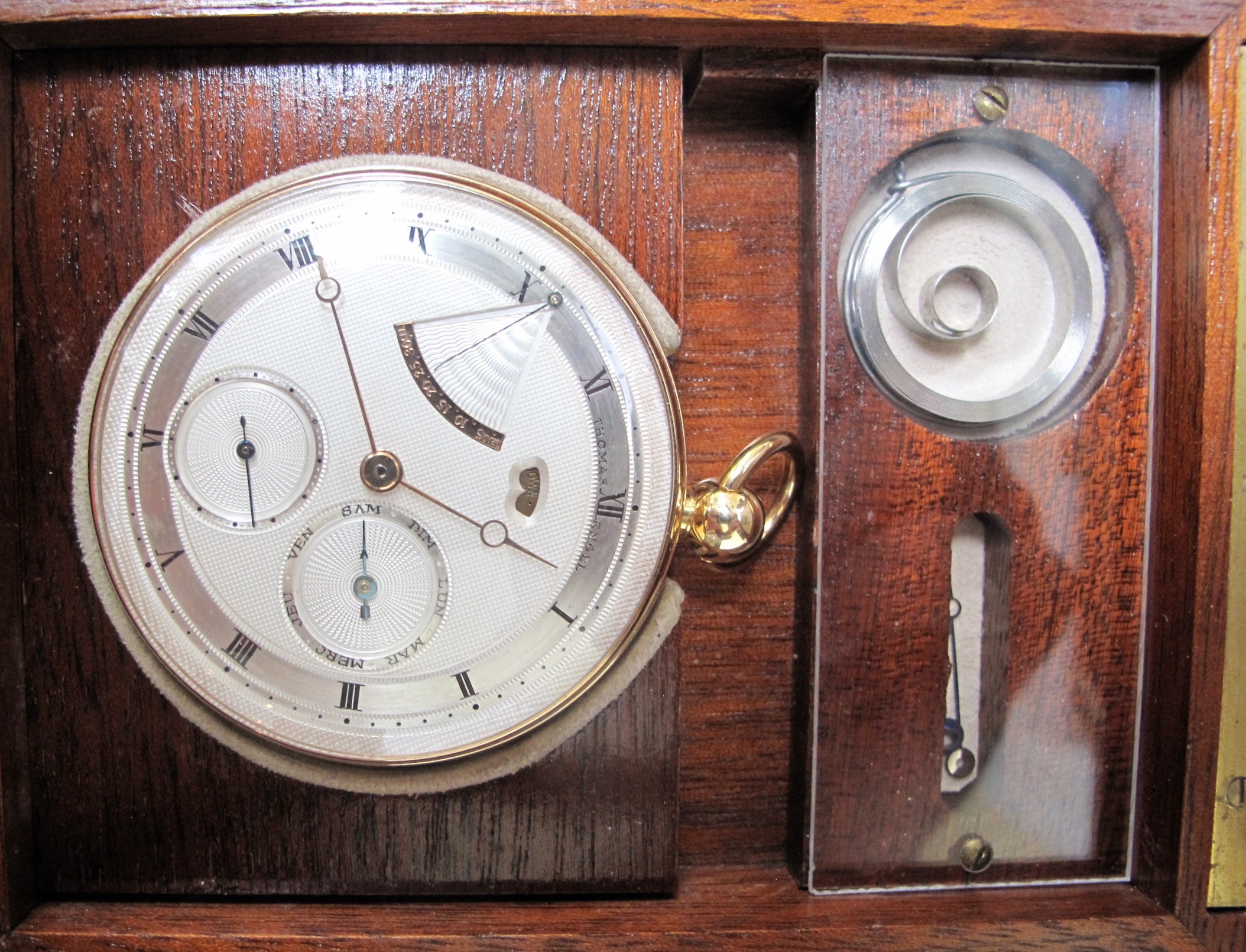

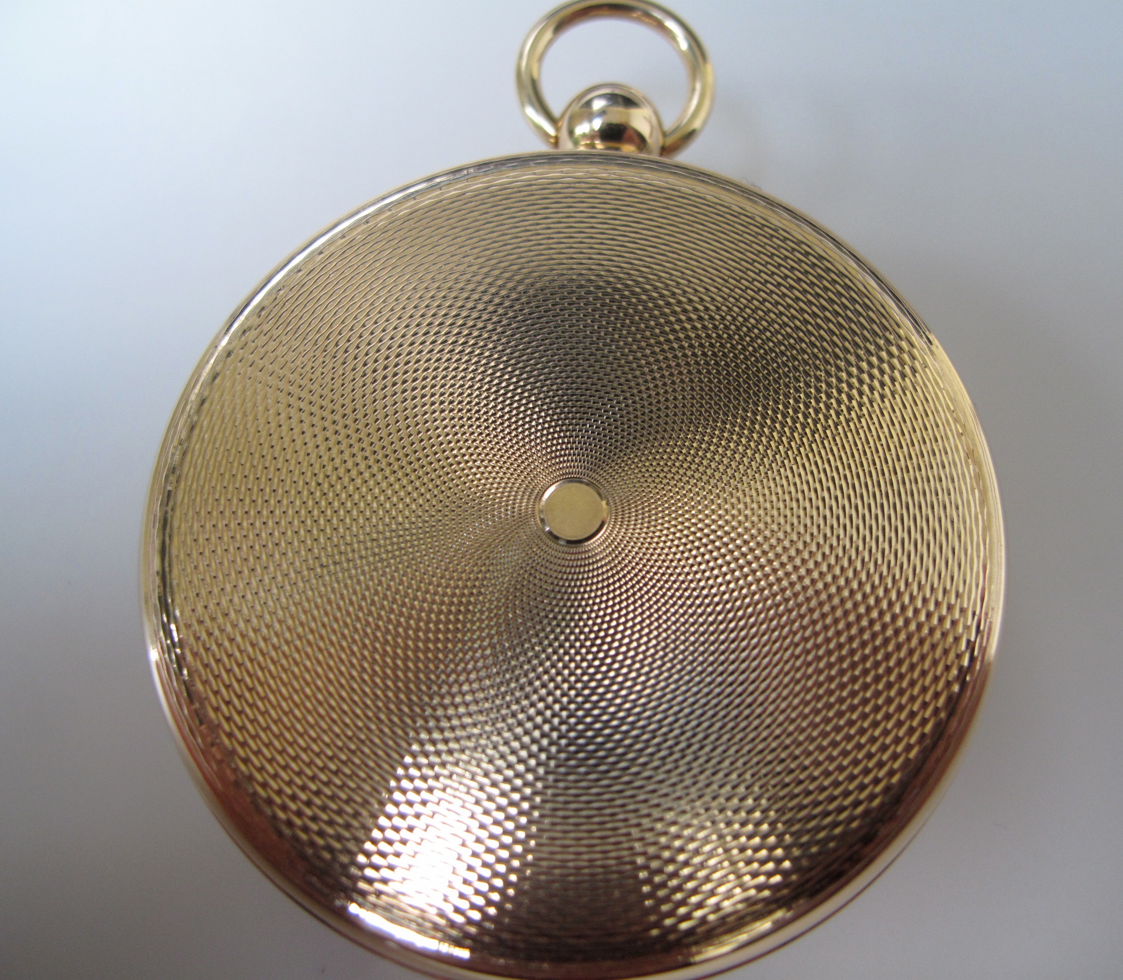

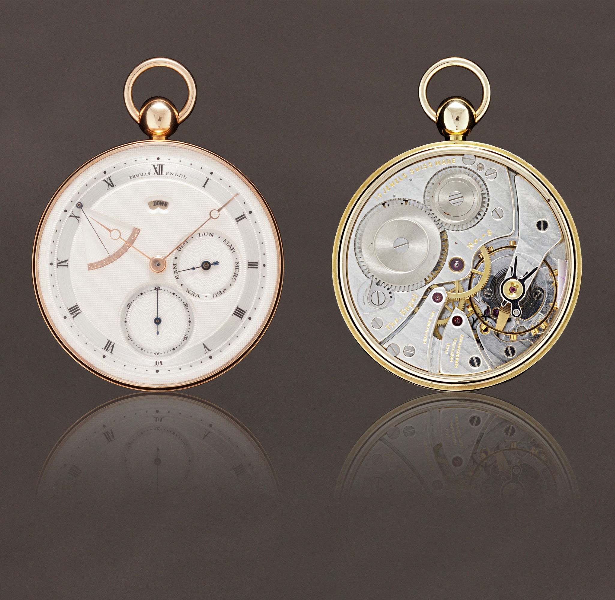

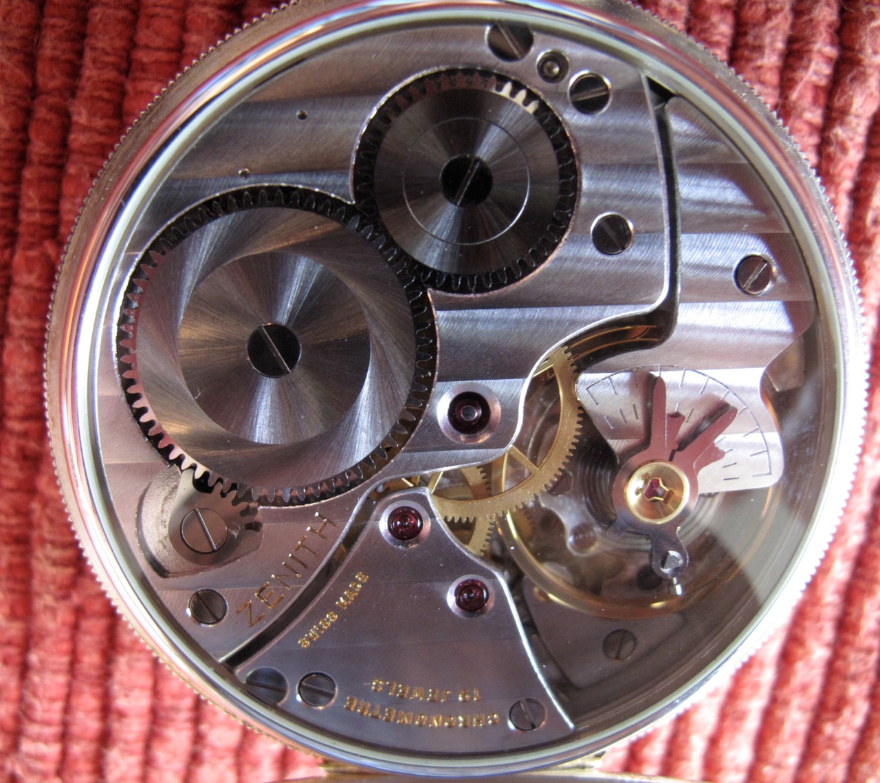

    Shown below for comparison are: the standard Zenith cal. 5011K movement, from my Zenith No. 184; the dial and movement of Engel No. 8 (c. 1980; photos from Antiquorum); and the dial, movement and case of Engel No. 25.
    With respect to the movements, you will note that Engel divided the wheel bridge and altered the balance bridge as compared to Zenith’s original, and modified the fine regulation. With No. 25 (but not No. 8), he also reduced the size of the barrel bridge. (Forgive me if my terminology is incorrect. I am no watchmaker, and I lack the expertise to understand the purpose of these modifications; any insight would be welcome.) There are no doubt other less visible refinements, probably including the mainspring as a spare is provided and the power reserve is greater than the standard 5011K. Not surprisingly, his watches all achieved chronometer certification at the Neuchâtel Observatory.
    It was Breguet who invented shockproofing, and shock absorbers are fitted to the escape wheel pivots as well as the balance. There is, of course, a monometallic self-compensating Breguet hairspring, which I believe is standard to the 5011K.

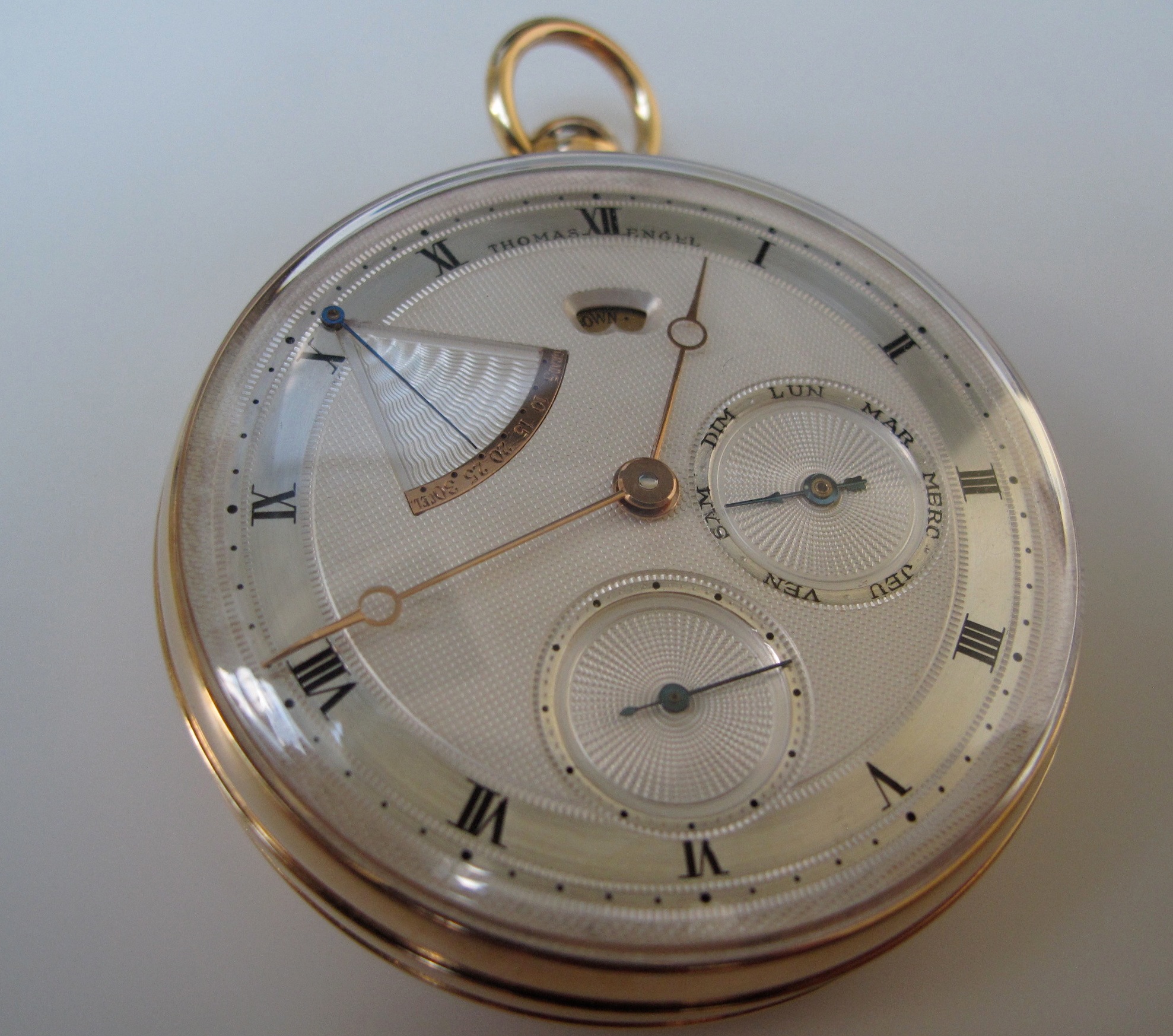

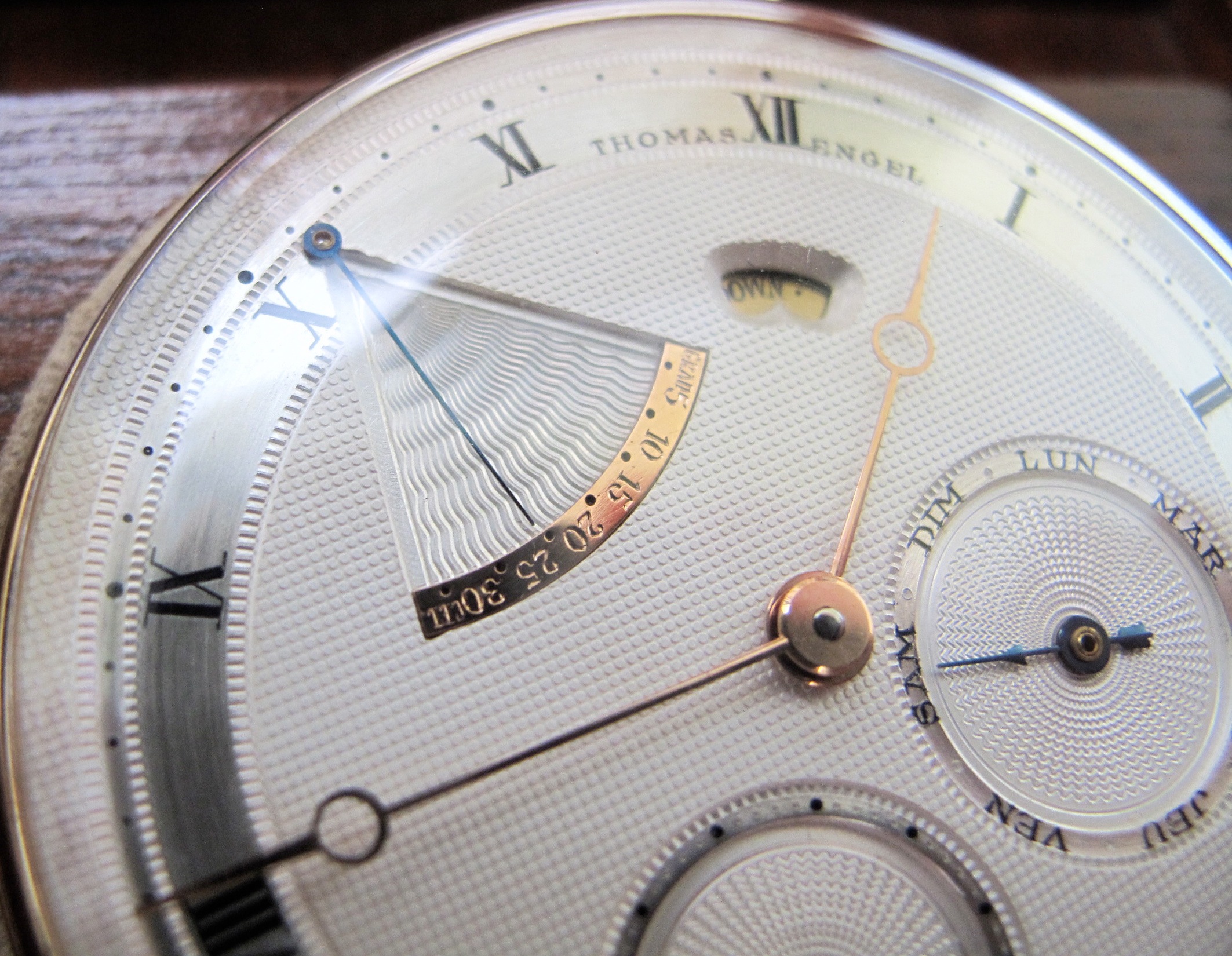

    Turning to the dials, they are very much in the style of Breguet. Breguet was not the first to move from enamel to metal dials, but he was the first to use guilloché decoration, employed here beautifully by Engel. There is a 48+ hour power reserve Up/Down indicator (mine wound down in 52¼ hours; the standard 5011K winds down in 47½), a temperature gauge marked from 0° to 30°C, a subsidiary seconds dial at 6, and a days of the week subdial at 3. (Never trust auction catalogs; some idiot at one of the major auction houses once mistook the temperature gauge for the power reserve indicator, and so recorded the power reserve as 30 hours instead of the actual 48+. Heaven knows what this person thought the Up/Down indicator was for. Through sheer laziness, this error has been perpetuated in every catalog description of these watches since - a scandalous lack of attention to detail.)
    Note the difference in sub-dial size between No. 8 and No. 25, and the difference in the angle of the temperature gauge (a better-balanced arrangement in No. 25).

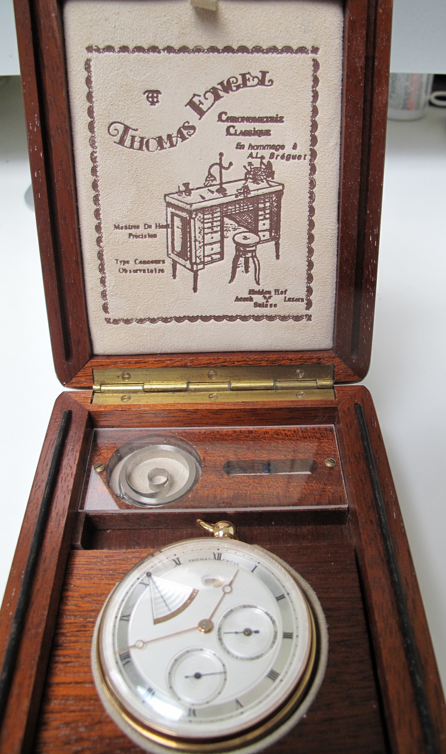

    Like Breguet, Engel used Breguet hands (gold, with spares in blued steel), Roman numerals, and point marks on the minute ring and seconds subdial (the latter marked differently as between No. 8 and No. 25). He housed his watches in wooden boxes each containing the spare mainspring and the extra set of hands (illustrated).
    Engel also wrote a book on the life and work of Breguet: A.L. Breguet, Watchmaker to Kings, subtitled Thoughts on Time (Lucerne, 1994) – illustrated below, including a photo of Engel’s own spectacular No. 17, c. 1981, with tourbillon and tact complications. He is an honorary member of the Worshipful Company of Clockmakers (the London watch and clockmakers’ guild established in 1631, and the world’s oldest surviving horological institution). His watches are remarkably elegant pieces with their Breguet DNA, but with souped-up versions of Zenith’s finest chronometer movement, probably more accurate than anything the Master produced.

    Standard 5011K movement in Zenith Pocket Watch:
    Engel No. 8 (photo from Antiquorum, 2012):
    Engel No. 25 movement:
    More of Engel No. 25
    IMG_3646.jpg IMG_3648.jpg IMG_3649.jpg IMG_3651.jpg IMG_3652.jpg IMG_3653.jpg
    And the Professor's book:
    And Engel No. 17:
