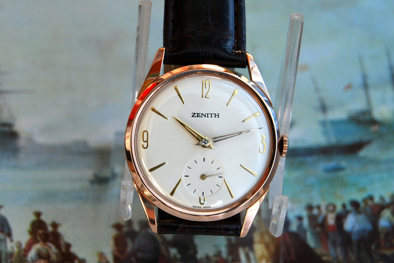

    This is the style (maybe even the correct model ?) that I'm looking for:
    All pics borrowed from the "free photobucket internet".
    I'm a complete idiot, when it comes to vintage watches or movements.....please speak slooowly so I can understand you, thanks in advance :)

    Well, top of the heap for 1959 would be chronometers with cal 135, Zenith's dominating 30mm movement that swept chronometry prizes from 1950-1954, including an absolute record in 1954. It comes at a pretty stiff premium to other Zenith movements, but it is the configuration you are looking for. Next is probably the cal 40 or 40T, a very good, chronometer capable movement. The 120 series is central seconds, so that's out, as is the 133.8 and the 71 because they are bumper automatics.
    For 1959, you are looking for a movement number in the 4700000 - 4850000 range.

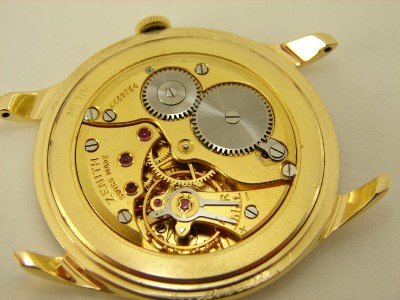

    No quick way to know. You have to recognize the movement by its appearance. You posted a cal 40 from about 1956, so very nearly a winner by your criteria. Here's a cal 135 for comparison - the huge balance wheel is characteristic of this one.

  8. LouS Mrs Nataf's Other Son Staff Member Mar 23, 2013
    6,713
    18,260

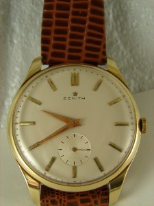

    Oooooh, close but no cigar.....last question (I'm lying :) ) The main differences between a 40 & 40T ?
    Here's a 1959 40T...wonder how big the case is ?
  10. ulackfocus Mar 23, 2013
    25,983
    26,974
    FYI: that's a refinished dial.
  11. LouS Mrs Nataf's Other Son Staff Member Mar 23, 2013
    6,713
    18,260
    Yep, definitely. Avoid.
    One has a "T" - I kid, I kid. The T has a mobile hairspring stud whereas the plain 40 is fixed. Roessler says that the 40 is usually gold plated and the 40T nickel plated - that's probably an easier way to spot the difference than to make out the details of the stud.
    this is the hairspring stud BTW
