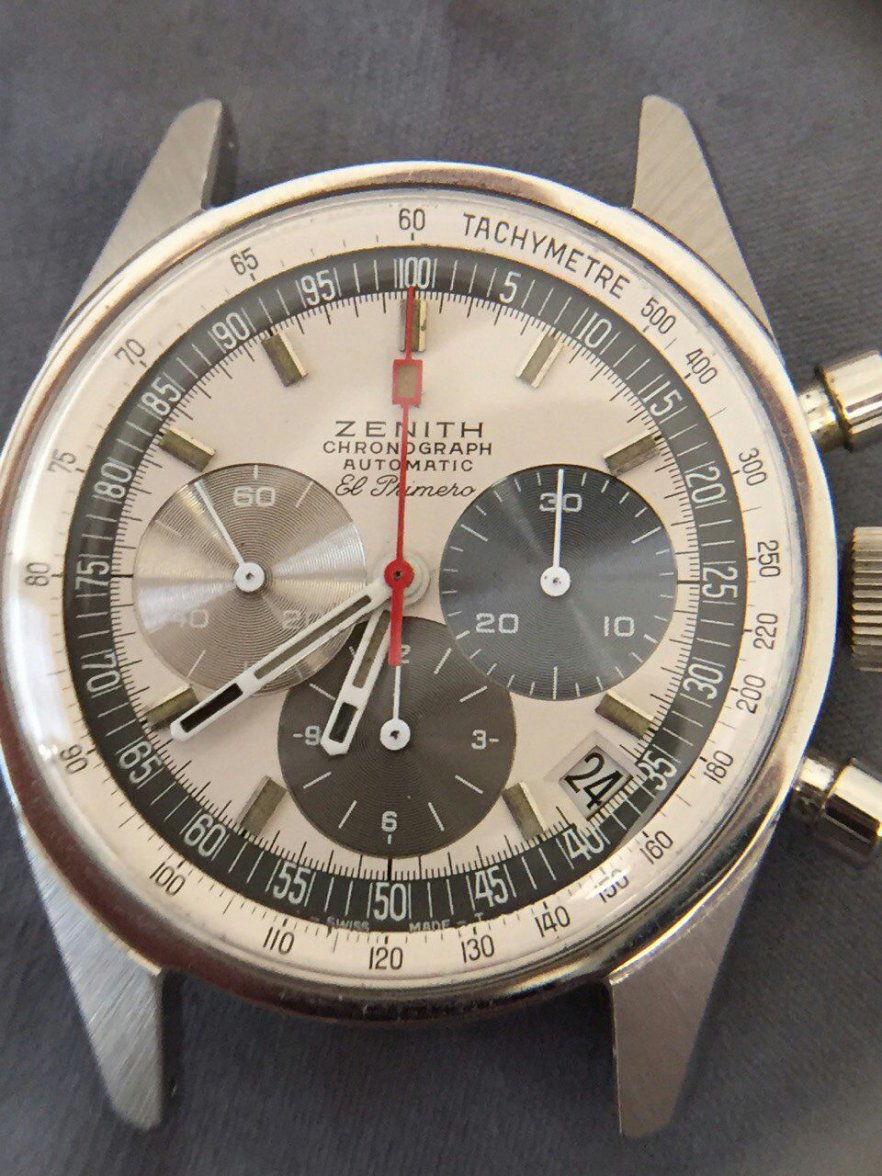

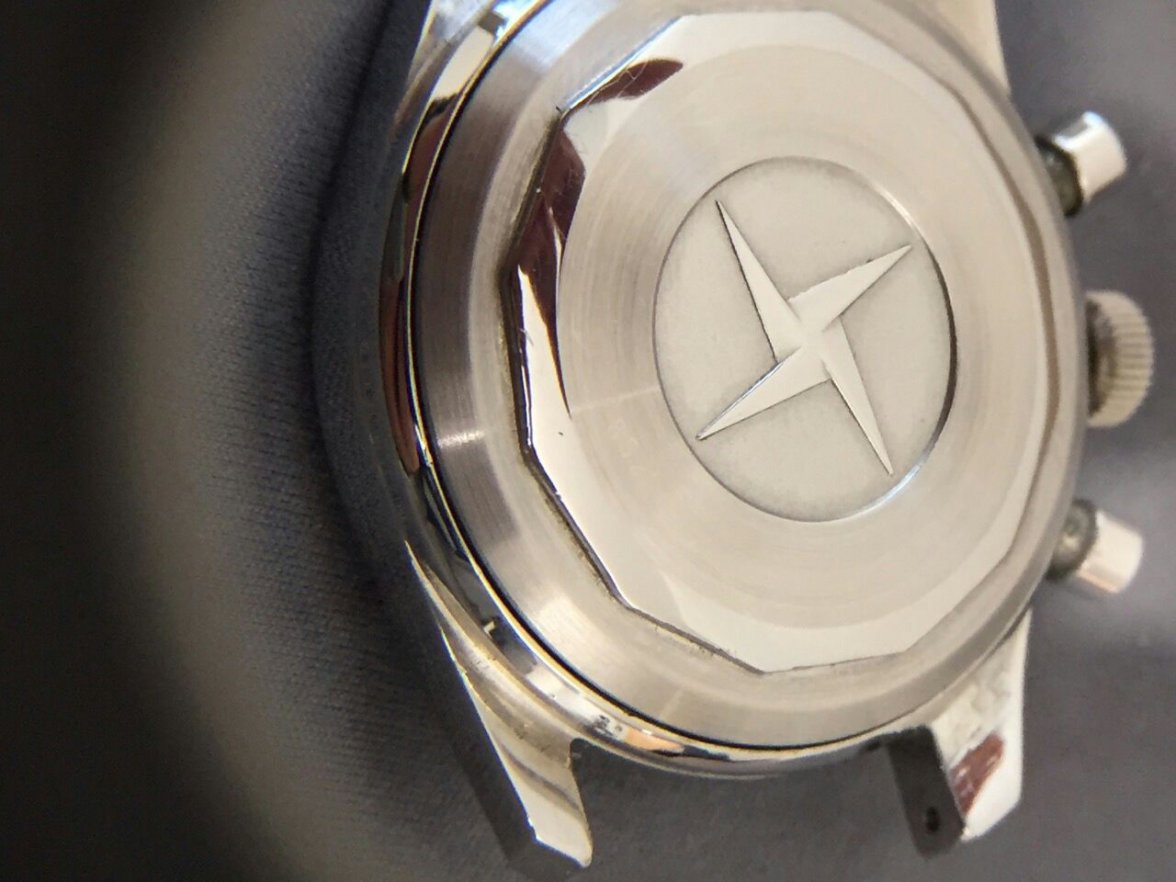

    I found this A386, what do you guys think ?
    To me case is really good
    dial is original
    bezel is original
    hands are originals
    sub register hands are originals
    crown is original
    pushers, i dont know
    Lumes plots are quite dark. I would have wanted to have something more yellow, but most seem to be like that...
    It looks to be a late version of the A386 (according to the back case and the fonts on the dial)

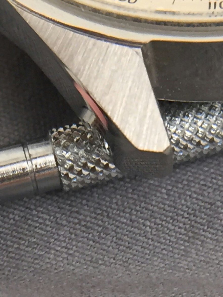

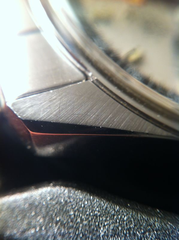

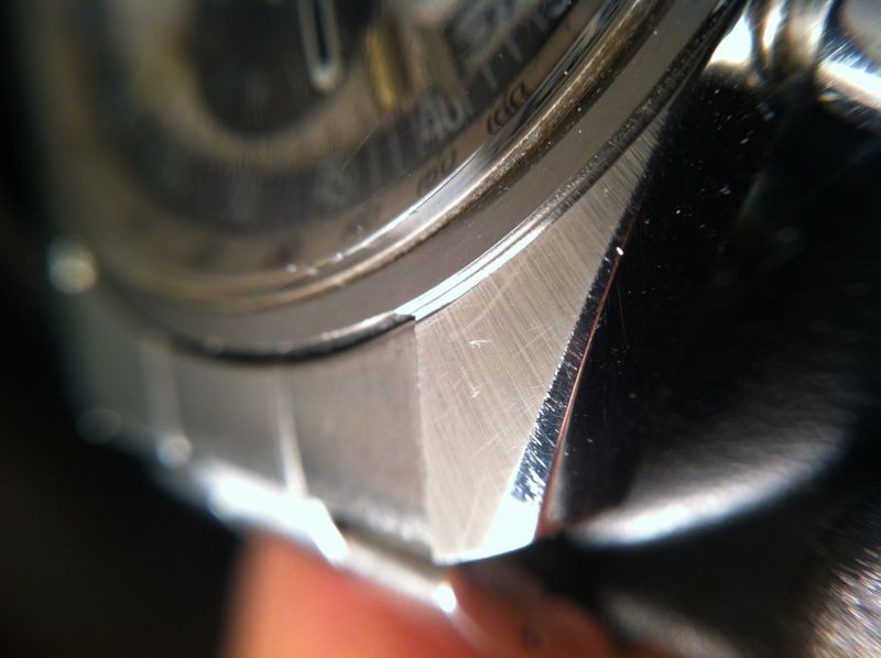

  5. papaebetu Oct 23, 2016
    417
    884
    Sorry Lous, but for me casework are completly wrong.
    Sharp lugs...
    In photo, how are correct for my 2cents opinion
    GIGI
    Edited Oct 23, 2016
    ELV web likes this.

  7. wristpirate Oct 23, 2016
    1,227
    3,691
    If you zoom into @Frederic_gva 's third photo the lugs do look to have the bevelled edge like in @papaebetu 's second photo. It might just be the angles and shadowing we are seeing in the photos, perhaps some further photos will help?
    I do suspect that these bevelled edges may have been lost over the years due to excessive polishing and the recent casework restorer has added these. The first photo gives the impression that a lot of metal has been lost on the edges of the lugs

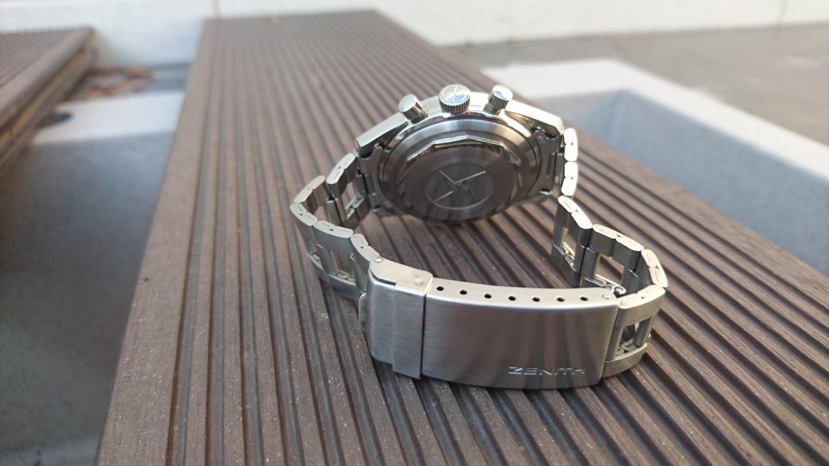

  9. m neuman What, me worry? Oct 23, 2016
    419
    698
    Nice, but bracelet is short at least one link. Should be 7 and 5 this one is 6 and 5

  10. LouS Mrs Nataf's Other Son Staff Member Oct 23, 2016
    6,713
    18,242
    I think there are bevels - just not visible in the photos.

  14. naidu Oct 24, 2016
    237
    1,674
    It's a nice mk3, I think too there are bevels, just not clearly visible on the first pictures.
    Hands are interesting, indeed the 3 small hands seems to be like the hands of a mk1 (very thin). I have already seen some mk 2 with these hands but this is the first mk 3 that I see with them.

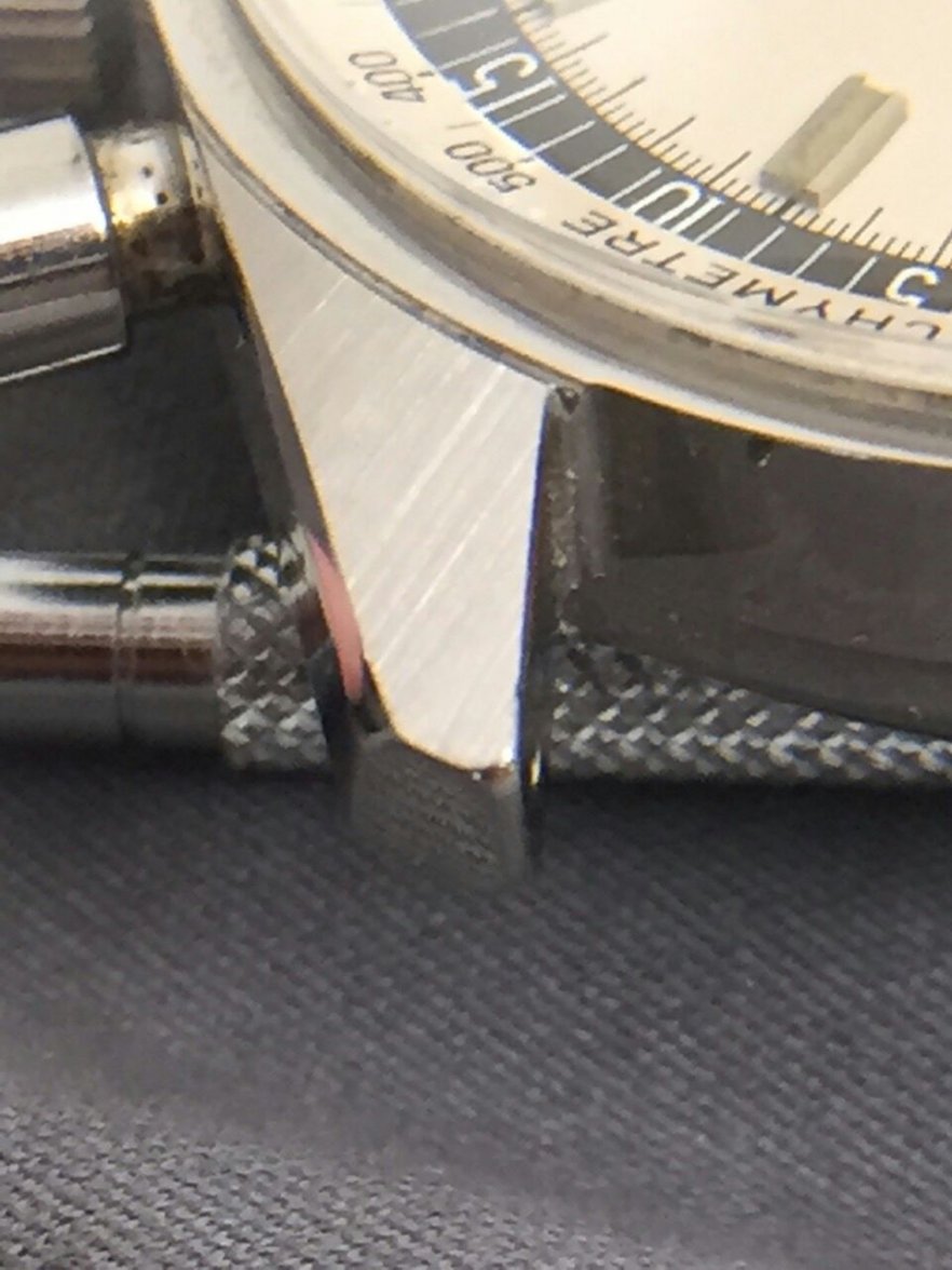

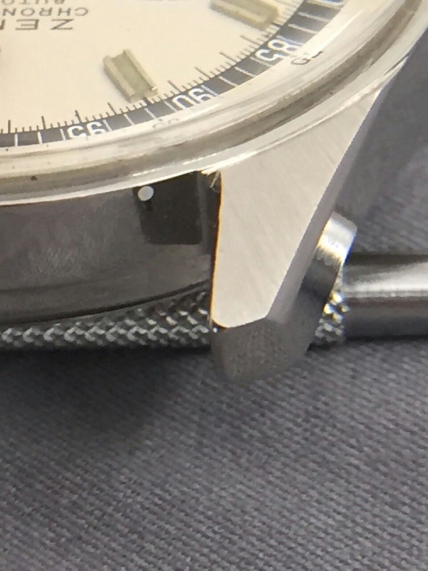

  15. Frederic_gva Oct 24, 2016
    460
    1,602

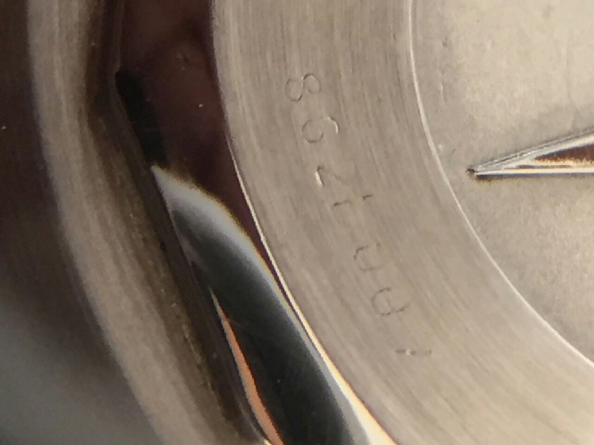

    some photos with the lugs. it looks like the bevel edges are present
    however serial number is almost missing due to polish
    WhatsApp Image 2016-10-24 at 16.35.19.jpeg WhatsApp Image 2016-10-24 at 16.35.18.jpeg WhatsApp Image 2016-10-24 at 16.35.47.jpeg WhatsApp Image 2016-10-24 at 16.35.57.jpeg WhatsApp Image 2016-10-24 at 16.35.59.jpeg WhatsApp Image 2016-10-24 at 16.35.21.jpeg WhatsApp Image 2016-10-24 at 16.35.54.jpeg
  16. lwong Oct 24, 2016
    543
    968
    Looks like pretty decent casework to me. If only all refinishers held such high standards.

  18. Frederic_gva Oct 24, 2016
    460
    1,602
    MarkIII register hands should be thicker ? Could be "transitionnal" reference... register hands box was not empty and had to be finished before opening a new one LOL....
    chronoboy64 likes this.

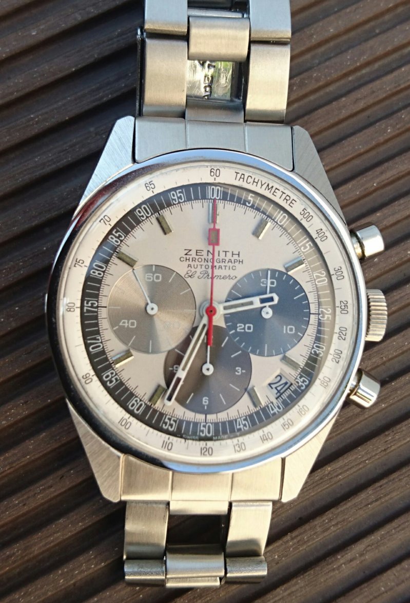

  19. naidu Oct 24, 2016
    237
    1,674
    To compare : mk 3 on left, mk 1 on right.
