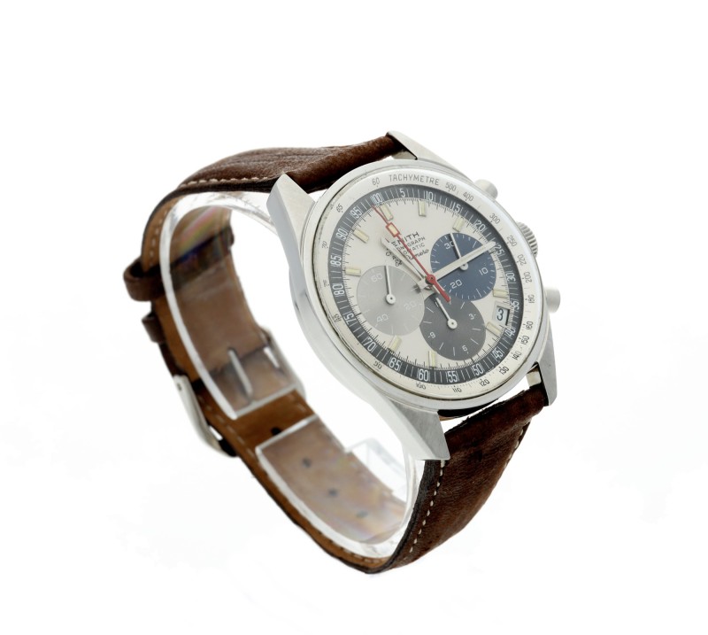

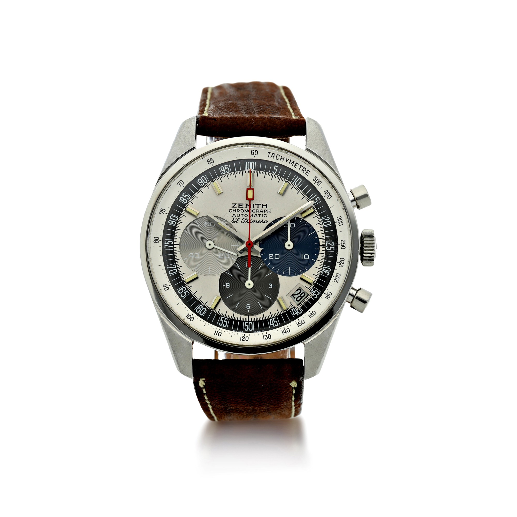

Hadn't seen this El Primero posted anywhere, so thought I'd start a thread. A386 up at Sotheby's "Important Watches" tomorrow. est. $8k-12k. Wondering if those wiser than me have any thoughts on this particular example.
Full lot here: https://www.sothebys.com/en/buy/auc...9/reference-a386-el-primero-a-stainless-steel
Photo courtesy Sotheby's.
Wrong minute and hour hands. Case looks polished a bit too much. Lume looks like it has been redone. The area between the inner bezel and outer bezel looks odd, it shouldn’t be empty space like that so I think something is not right with the bezel.

As we all know, the A386 is a very important watch -- just not this one.....
I agree with ELV's comments. Looks like a wrong replacement tachy ring. It is too small, and doesn't line up with the dial....

Sold for about $14k. Wonder if we'll see the same case # resurface with a more "correct" configuration of dial/hands soon. For future reference, case #: 923D635
