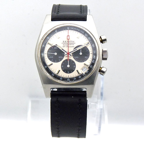

    Hi!
    Can anyone help specify what size crown to source for an a384? I am thinking of restoring a piece that looks like it’s been dragged behind a tractor for two weeks :(
    Thanks!
    PS: borrowed the picture ... this one has not been dragged behind a tractor :)

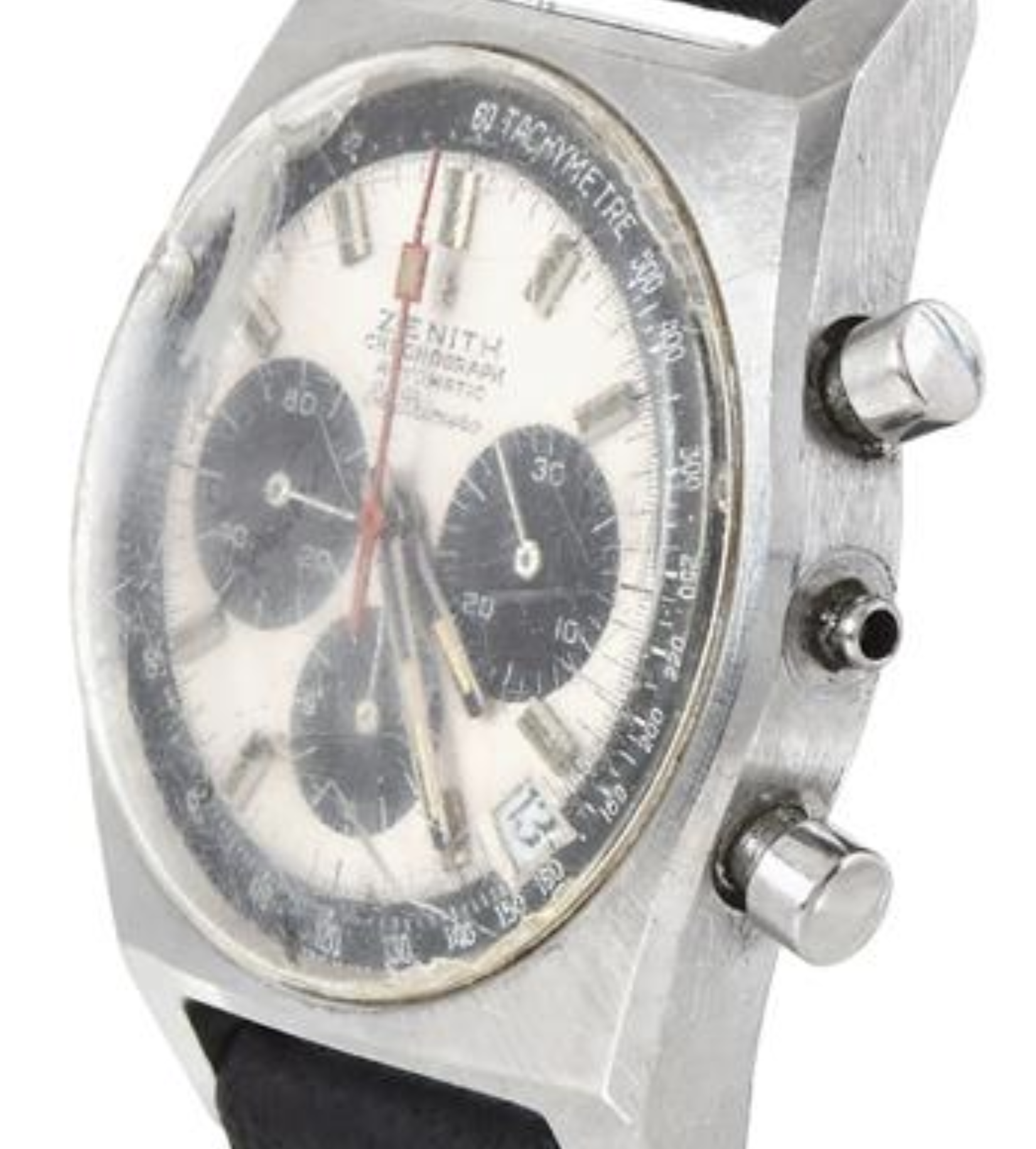

  3. Bogatir Oct 3, 2018
    18
    11
    Thanks! Here's a picture of the actual watch. As you can see it's been banged up pretty well. I have discussed it with my watchmaker and we think we could do a decent job with the watch, but it would be expensive. Skärmavbild 2018-10-02 kl. 14.28.14.png
    asrnj77 likes this.
  4. Bogatir Oct 3, 2018
    18
    11
    The winding stem and crown is missing. One of the pushers is a bit askew. The crystal looks like it's been through a shotgun target practice-session :)
    I am only interested in unpolished, untouched watches and this piece seems like it's never been touched. Only abused. Besides the parts missing, the 3019 movement seems ok.

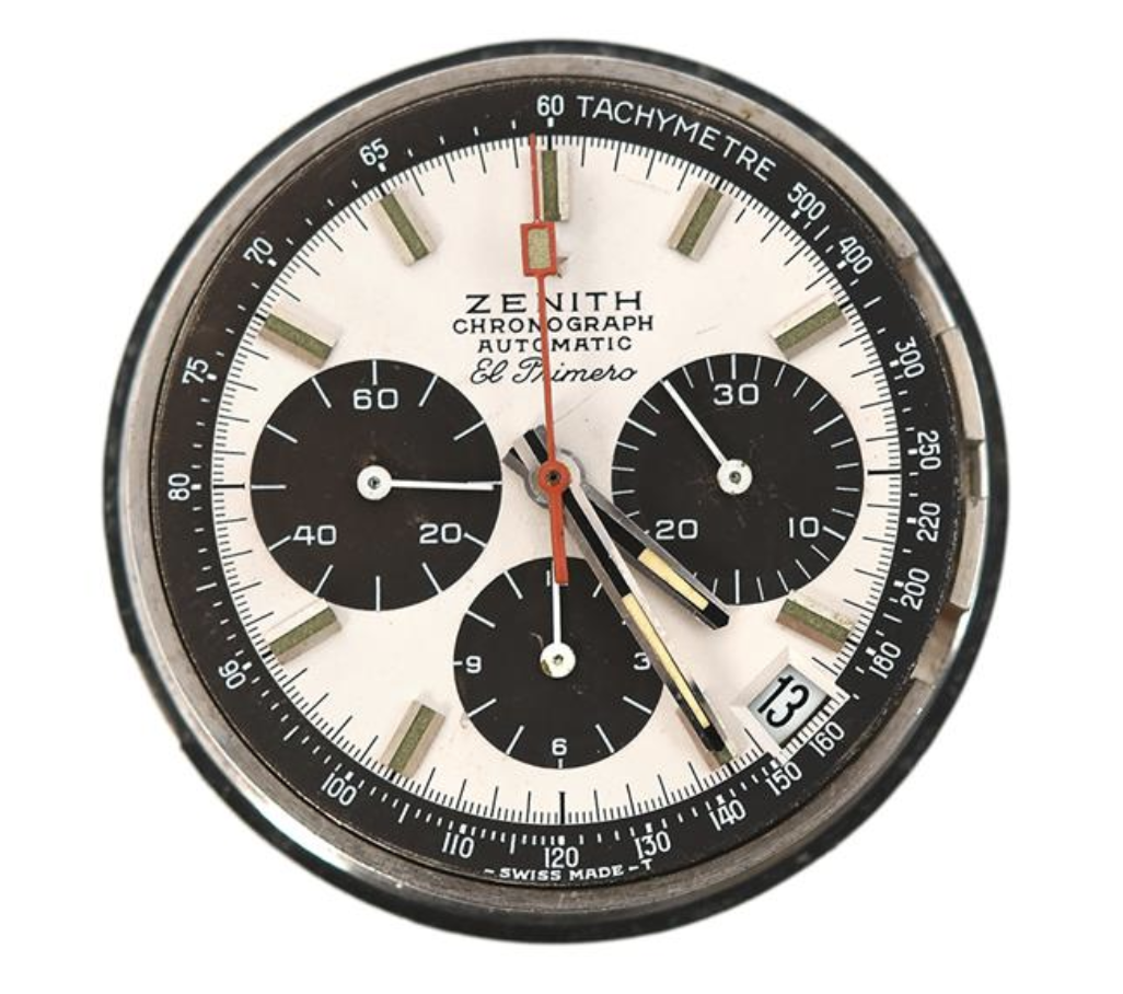

  7. Bogatir Oct 3, 2018
    18
    11
    Will keep you posted if I go ahead. You're a good gambler, the dial is decent:
    wristpirate likes this.

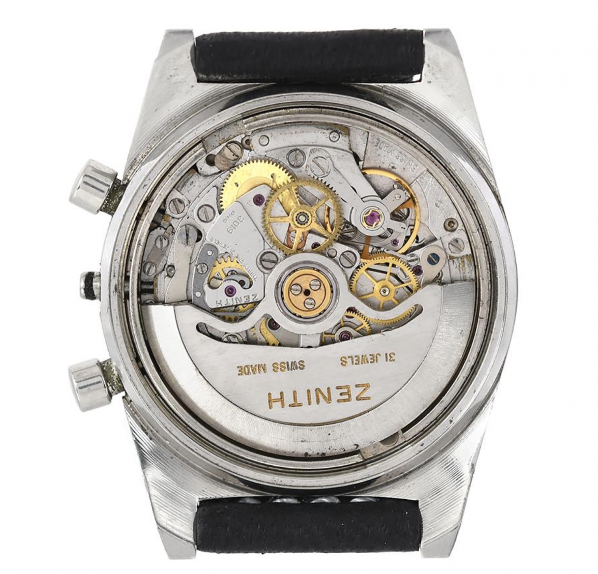

  8. Bogatir Oct 3, 2018
    18
    11
    The movement:
  9. georgeszaslavsky Oct 3, 2018
    492
    1,398
    The movement is dirty and only on a vibrograph you would be able to know its accuracy. Best thing to do for a crown is to search on ebay or on chrono24, pretty sure that you will find something. If not send your watch to Zenith for full restoration.
