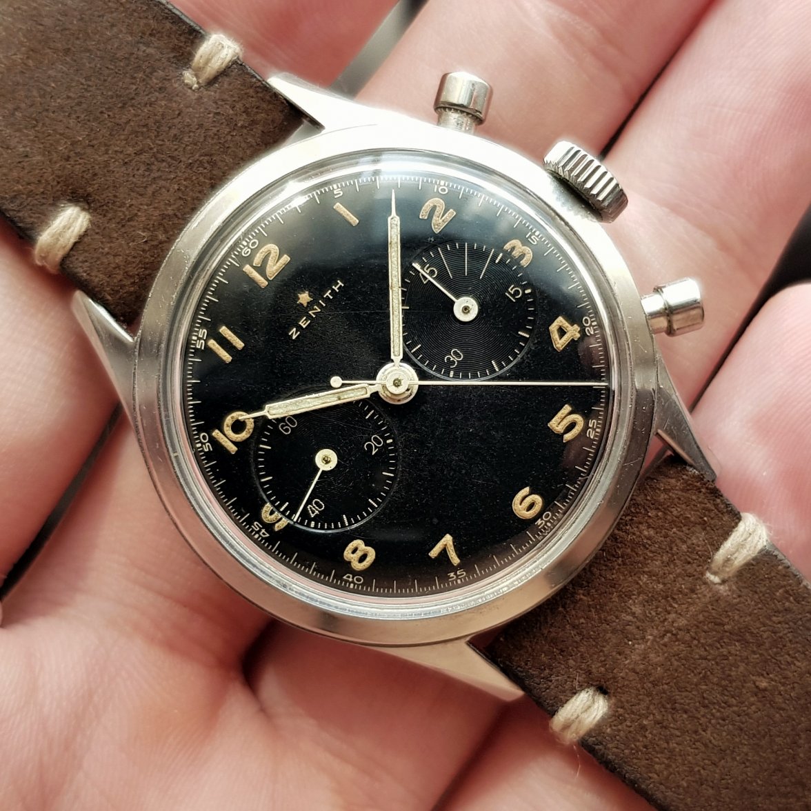

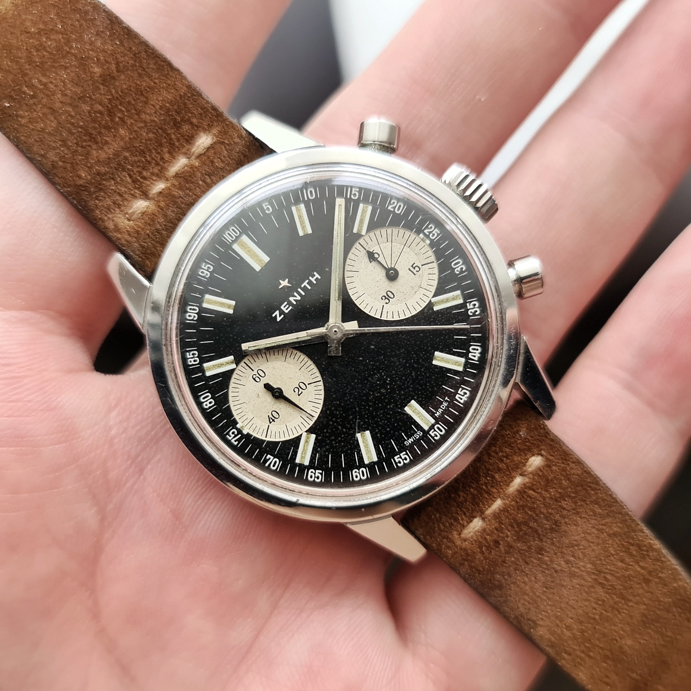

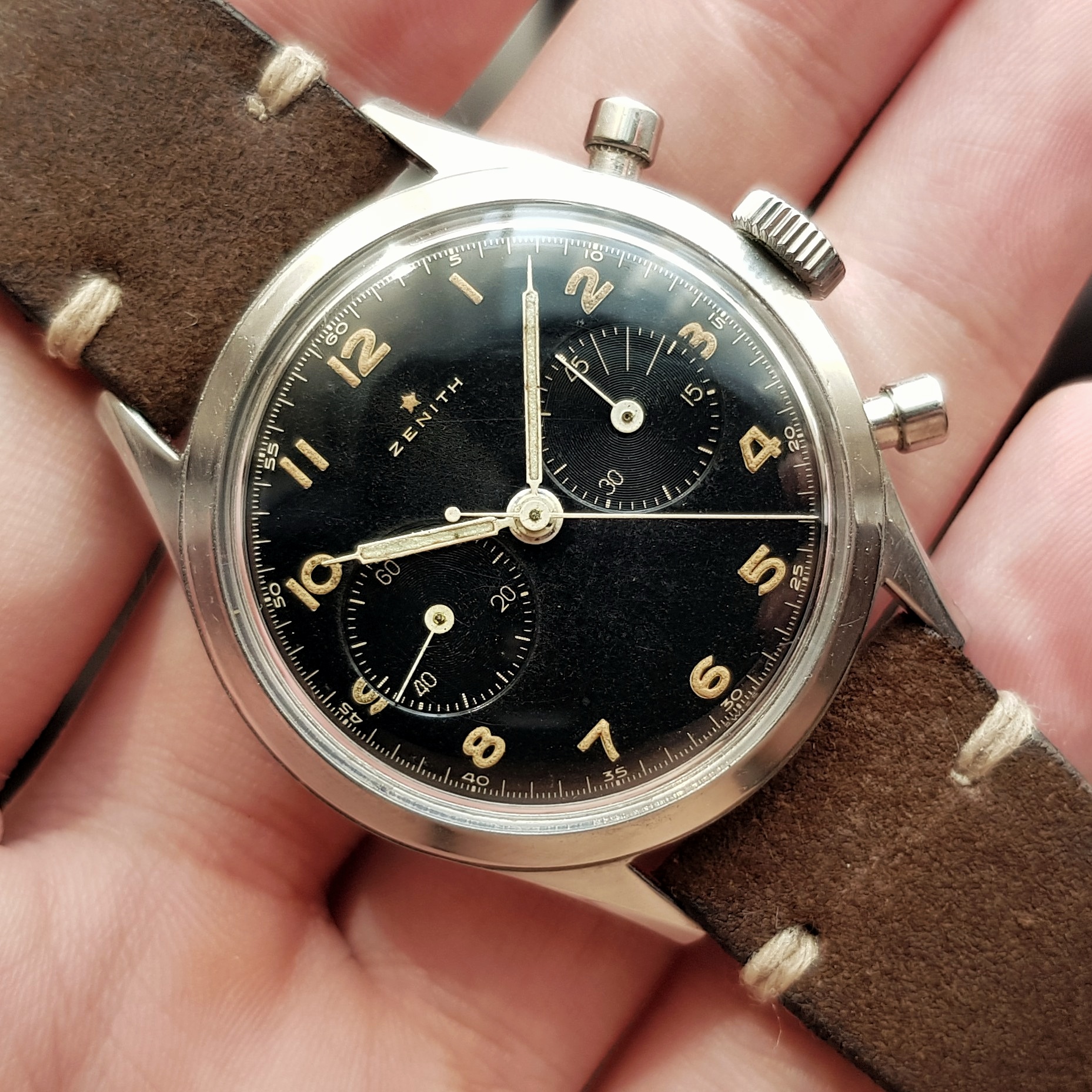

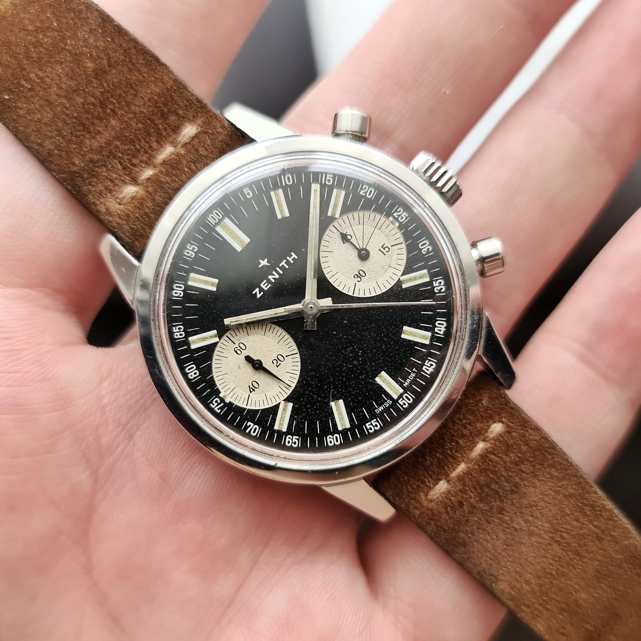

I really find these A27X models really awesome and so underrated. The quality of the watch is sublime. Here's mine, with an added Yugaslavian Air Force one with the same movement.
I think I may have spied that Yugoslav military piece on the private watch sales?? Its fantastic. Thanks for your pics superb

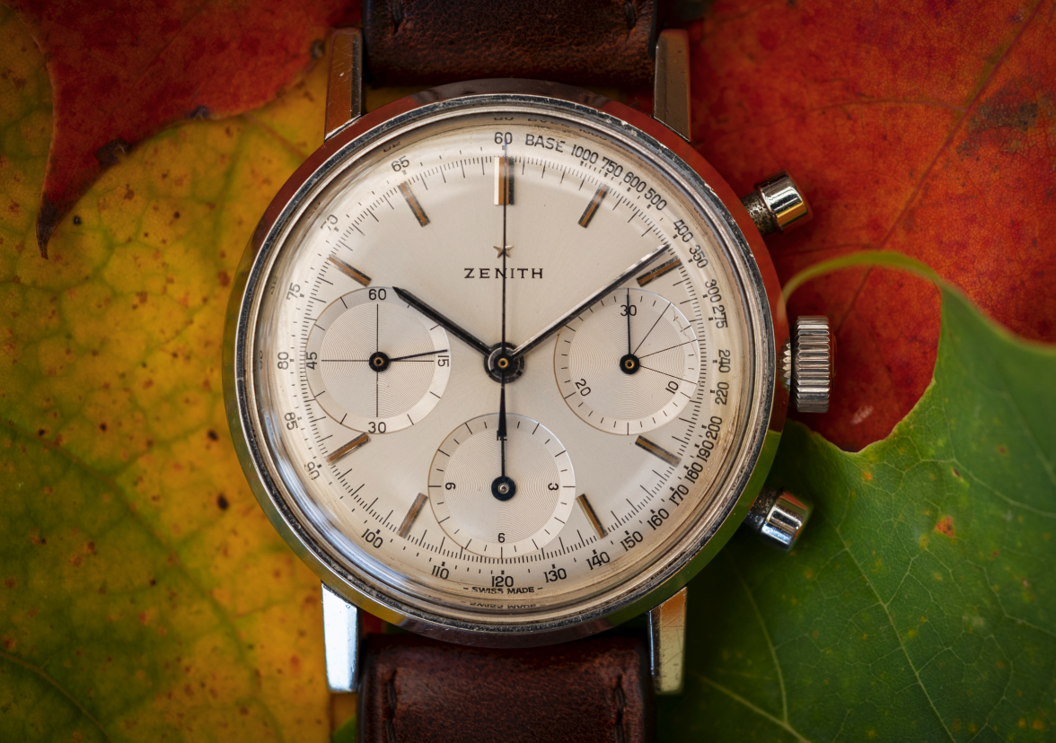

I had this A273.
Different style seconds hand.
Is that your photography? Stunning example

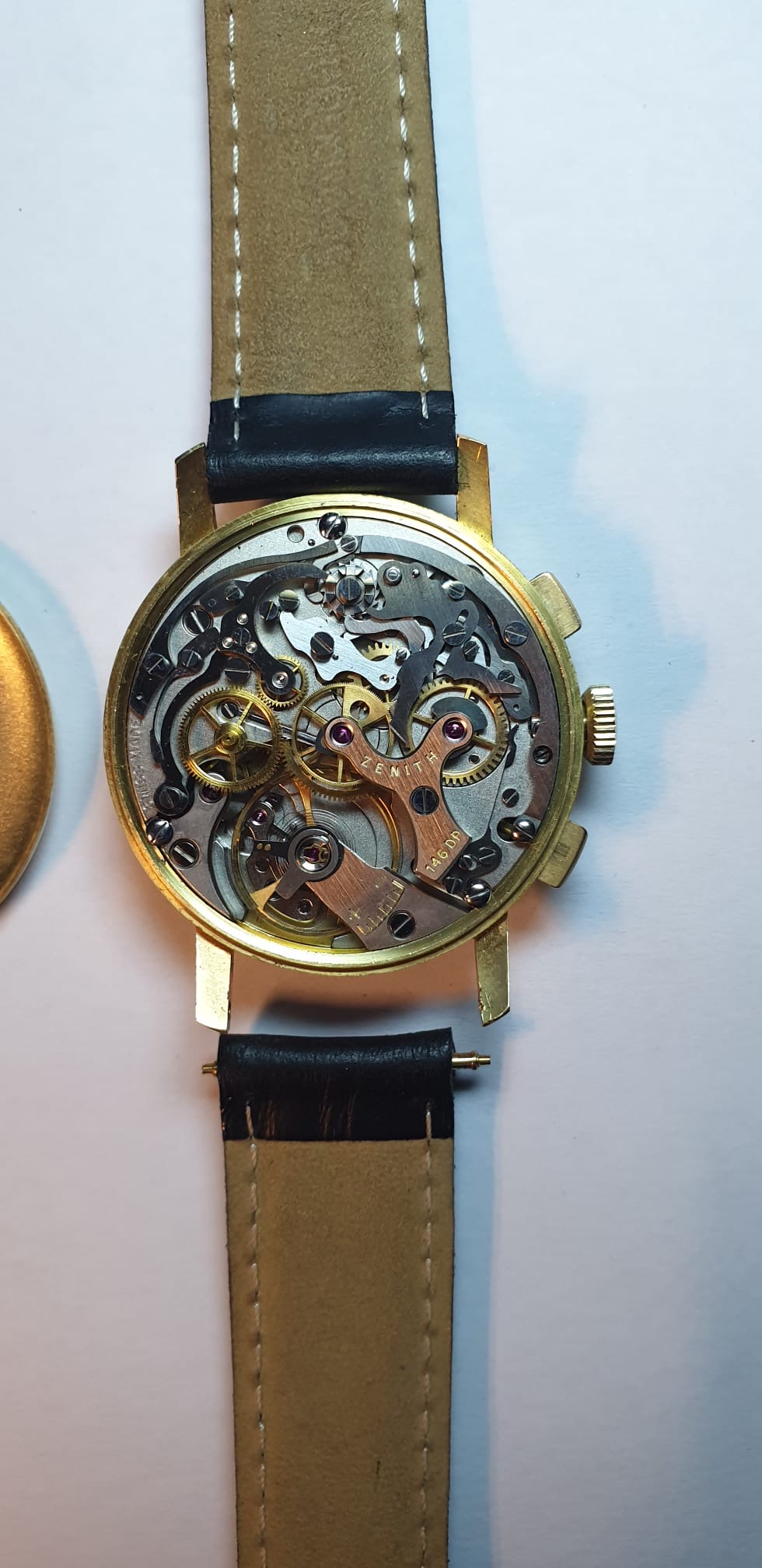

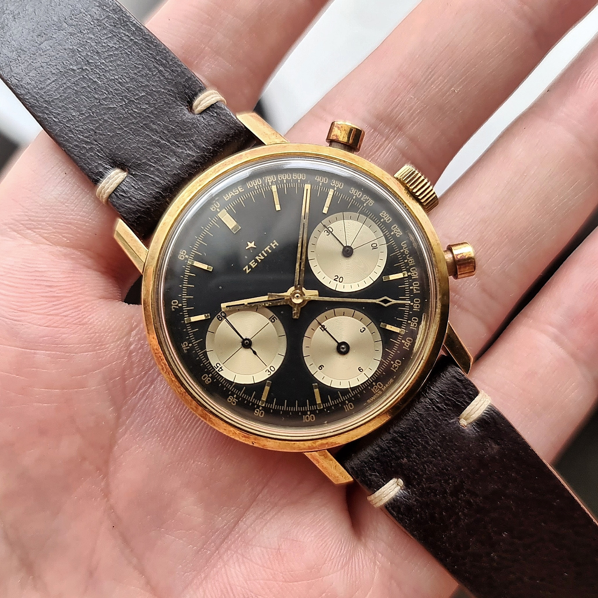

One more observation to add - my A271 service history was unspecified, so I'll need to sort that. But I'm amazed at its timekeeping. The late '60s 146 movement is outperforming my 1978 Speedy, which has been serviced recently. So Martel is outperforming the 861 so far....
209
441
caliber 146 is one of the best ever produced, who owns it knows what I'm talking about.
As I said...
However, have it checked by your trusted watchmaker
339
473
As I said...
Good advice - not sure if its a good or bad sign, but the 'ticking' sound of the movement (the sound of the balance wheel oscillating I presume) is so much more audible than any of my Omegas. This might be the thinner case - but its a wonderful sound
209
441
it is one of the features of the 146, I think it depends on the large balance wheel, as you said it also depends on the simple case, your a271 is not a professional watch. my a278 has a case similar to yours and the ticking is very audible, on my a277 it is less audible.
among the things you will appreciate are a good power reserve, the accuracy of both the watch and the chronograph, and great reliability.
some time ago I bought a 146 which had been in a drawer for about 30 years and it worked fine!
The only drawback is that the movement is usually not very refined, although the quality of the materials is at the top.
your 146dp is the latest and most up-to-date version, it has a plat spiral, all the regulating organ is revised for greater precision, micrometric screw adjustment, different shaped balance bridge, glucydur balance wheel without adjustment screws
