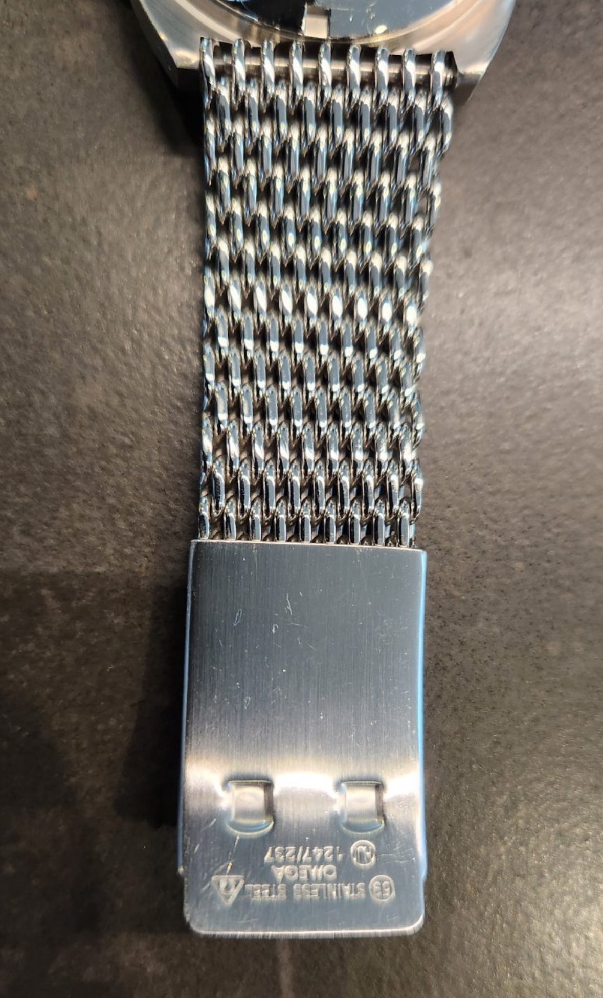

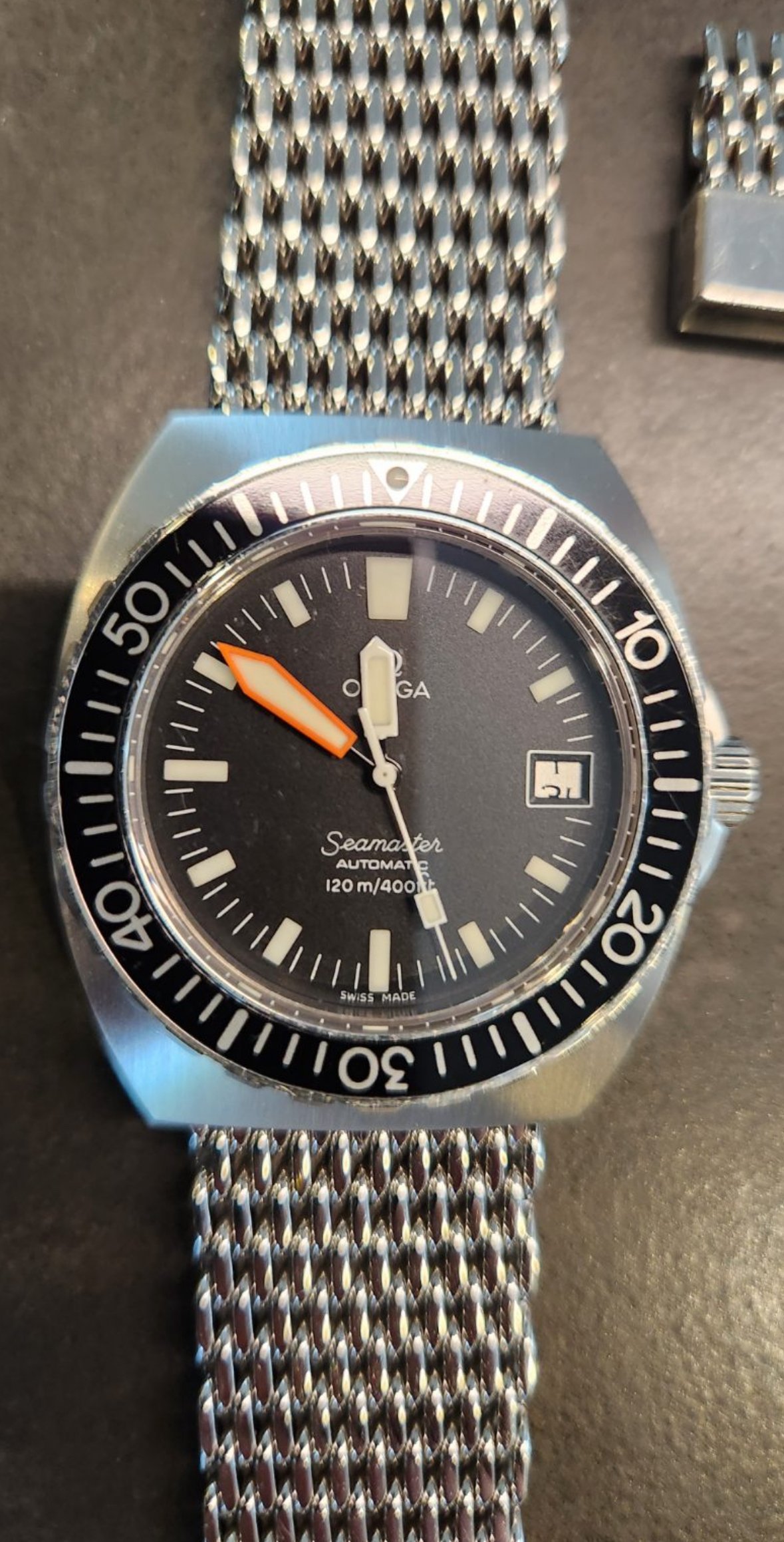

I come to you today to ask your opinion of this 1980ish Seamaster 120 166.025 which has come up for auction here.
The watch itself seems to be in impeccable condition which is probably the result the refurbishment that the seller has mentioned in the listing. The dial has obviously been replaced as it has the full, rather than split, lume at the 12 indicy mark and I'm assuming the hands are also new as they seem simply too clean and unfaded for their age.
I have asked the seller to provide a picture of the crown and the movement but this request has fallen on deaf ears. As such I'm interested in your opinions about the state of the watch, if you can tell from the few images provided whether it's a genuine crown and if you think this is actually a possible Watch Co Seamaster.
Bidding starts at $3200 USD and the buy now price is $3740 USD
Thanks in advance,
Matt
1,514
2,441
Price seems high to me for a replaced dial, hands, and refurbished case. Look at the Japanese auctions as they always have various examples for sale
13,505
31,838
Not a reference I specifically know that much about, but my gut says that it's a put together, Watch Co or otherwise.
261
195
I think for $3740 USD you can get something better. I would pass.
