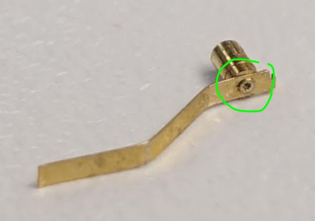

As planned, finally repaired by my watchmaker...😁😁
Better than my Aluminium paper...
He has worked with a lathe to increase the height of the pin, and crimped the contact.
Good job... because this part is really really small for my eyes...
I recovered my loud alarm 😁😁!!!!
Total cost: 55eur... !

How did you repair it? What sort of aluminum paper did you use and how did you attach it to the battery module?
1,583
10,359
Aluminium paper from my kitchen...😁
It was not attached, but only pressed by the back of the watch... When electric contact is done between the back and this golden plot, the sound alarm works...
But as I said, my watchmaker repaired it properly, by re-attaching the broken golden finger... I don't know exactly how...
