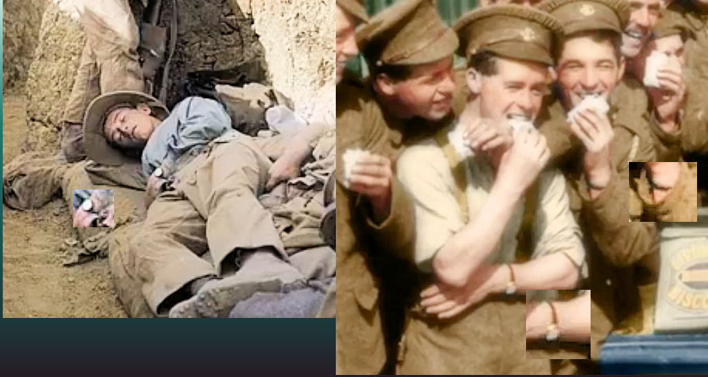

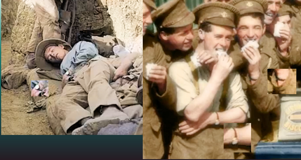

The youtube video is a collection of colorized stills. The one of note is at 7:06 and shows soldiers around an ice cream cart. One soldier is prominently wearing a wrist watch. I am pointing it out because I was under the impression that in 1915 watches were only beginning to be worn on the wrist and that they were very expensive. Maybe that's why he's the only one not wearing a jacket.
The photo doesn't show enough detail to identify it but knowing some of you guys I'm not sure.

Dedicated wrist watches were expensive, but having the unit gunsmith weld a couple of lugs to your pocketwatch so you could put it on your wrist was not.

There also appears to be a watch on the wrist of the soldier in a blue shirt at the 5:29 mark.

There definitely is. It seems to have a similar strap. It's maybe a little bigger? Perhaps a modified pocket case as connieseamaster mentioned.
They are both the only ones not wearing sleeves.

I think the watch on the wrist of the soldier at 7:06 is too small to be a marriage. It looks smaller than the width of his little and ring fingers together so not much more than 30mm.
At 9:05 the soldier lying down in the blue shirt has a wristwatch on too.

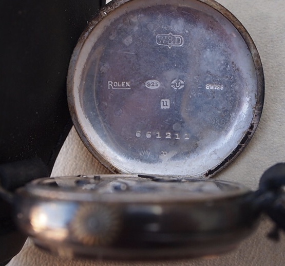

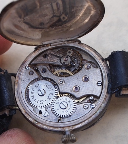

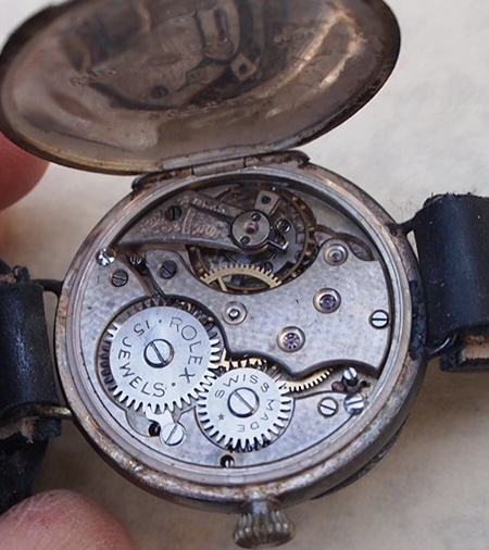

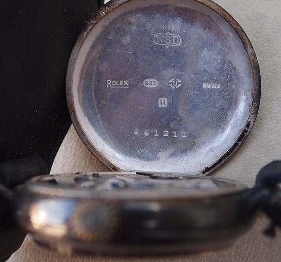

I don’t fully understand the hallmarks on this Swiss made case marked W & D (Wilsdorf and Davis, Rolex), but I believe the date letter to be 1915-16. Wrist watches were around prior to WWI.

The fellow soldier looking over the left shoulder of the soldier with the watch at 7:09 looks like he may also be wearing a wrist watch. The watch is not visible but it appears there is a strap on his left wrist. It doesn't look like a shadow.
Yes good, and I just noticed the guy further back in the trench is holding up a helmet with his rifle. These guys are all deliberately letting the camera see their watches. I could make a Rolex joke but rather think they are deliberately sharing them with us over 100 years in the future.

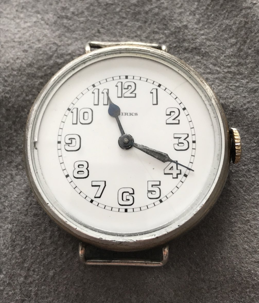

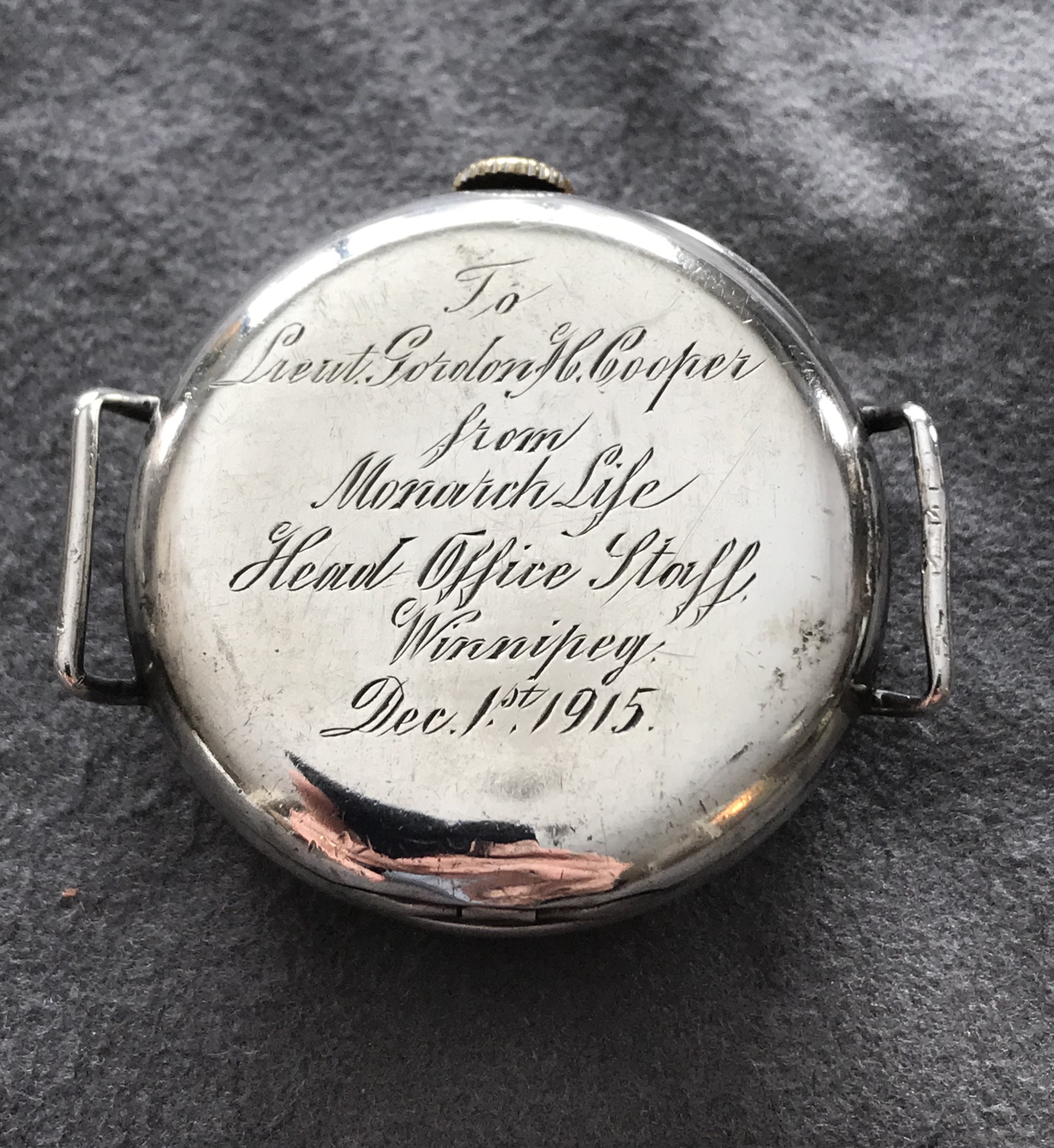

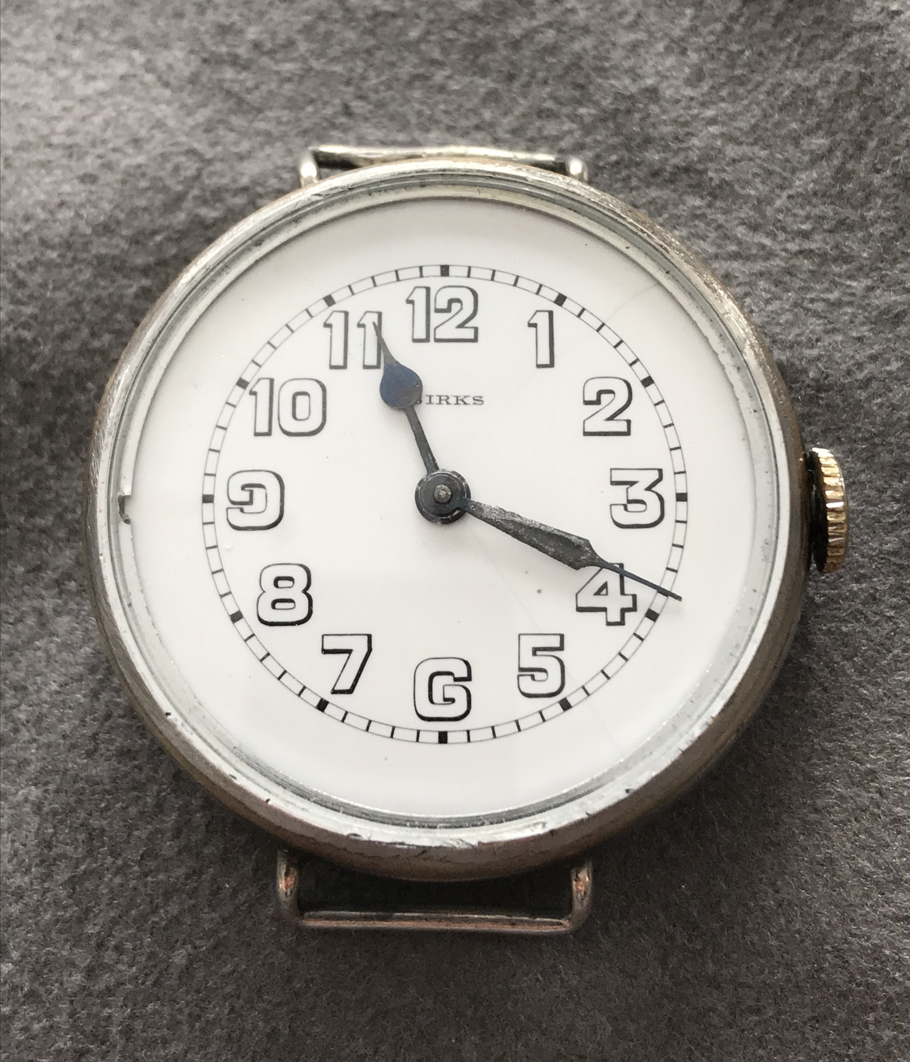

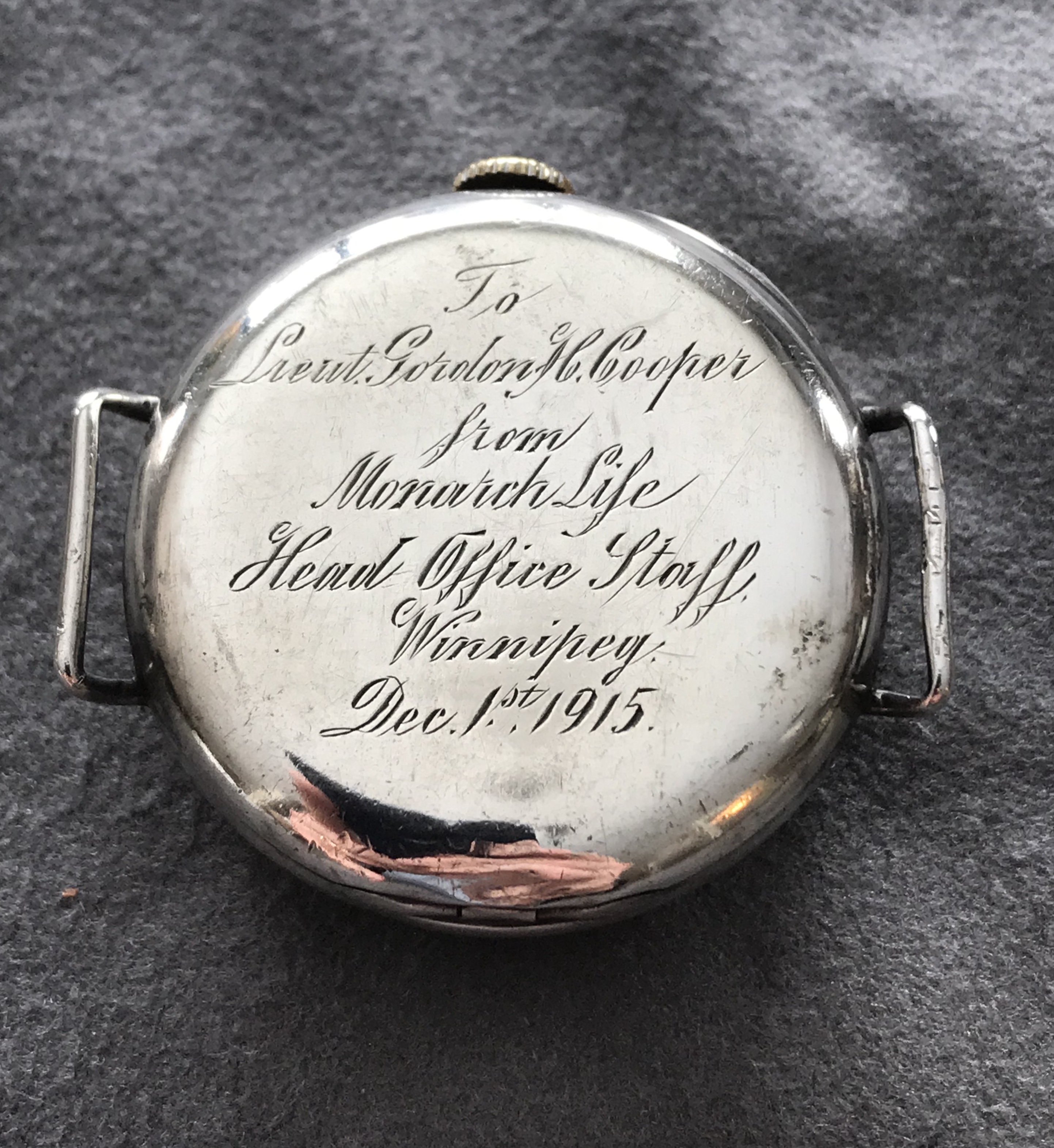

Here is an example of a Birks signed watch (wristlet) bought by workplace colleagues for one of them as he went off to the front. Silver case, nicely done inscription, clearly 1915.

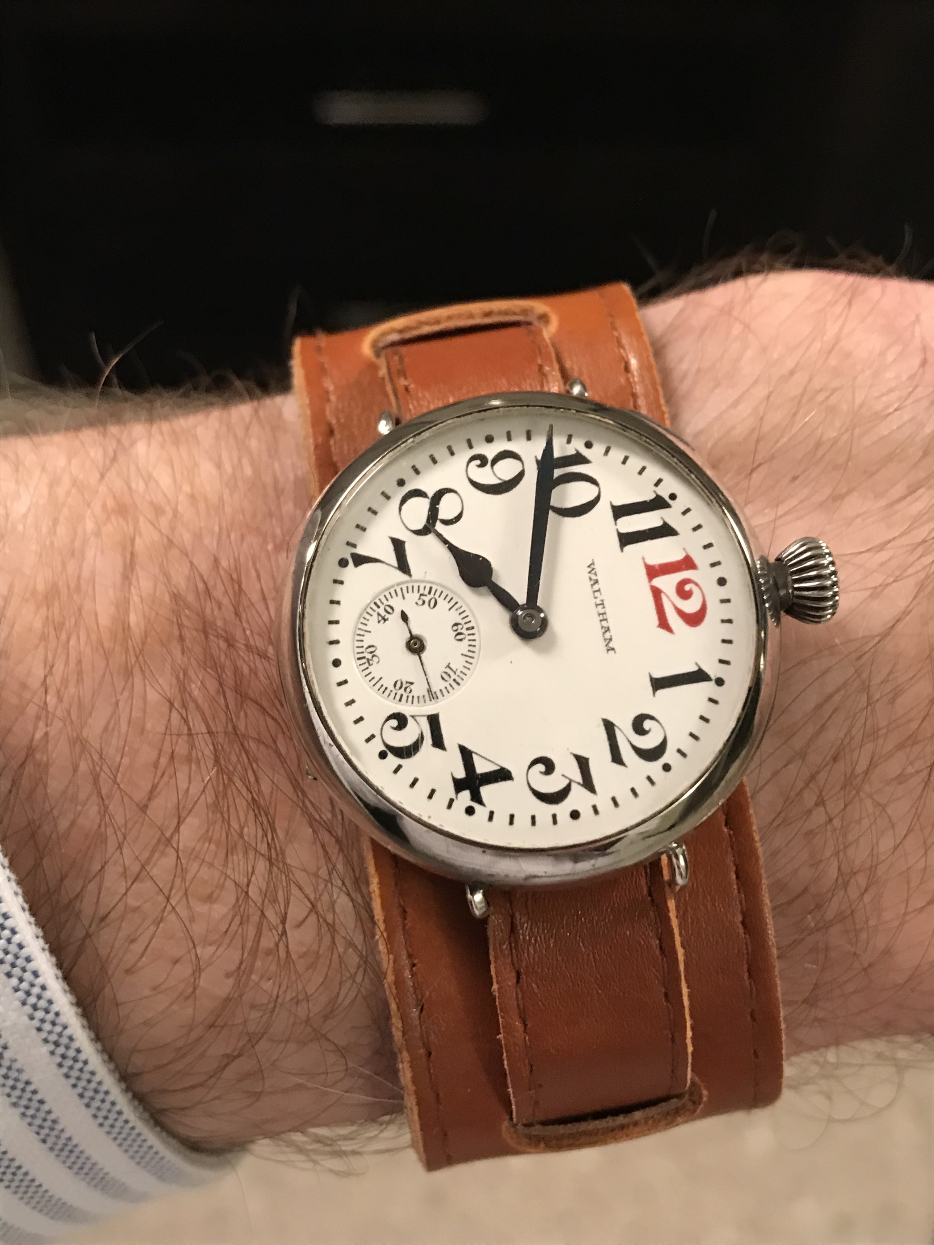

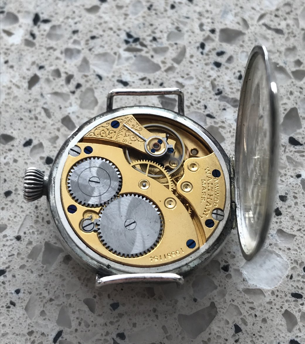

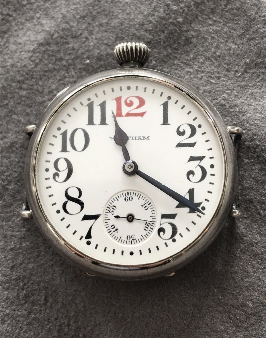

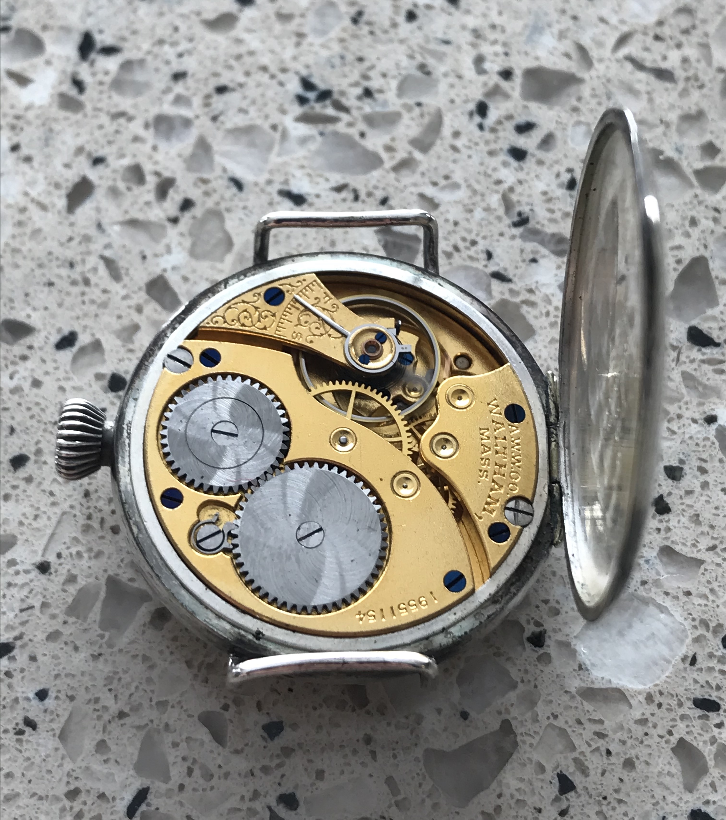

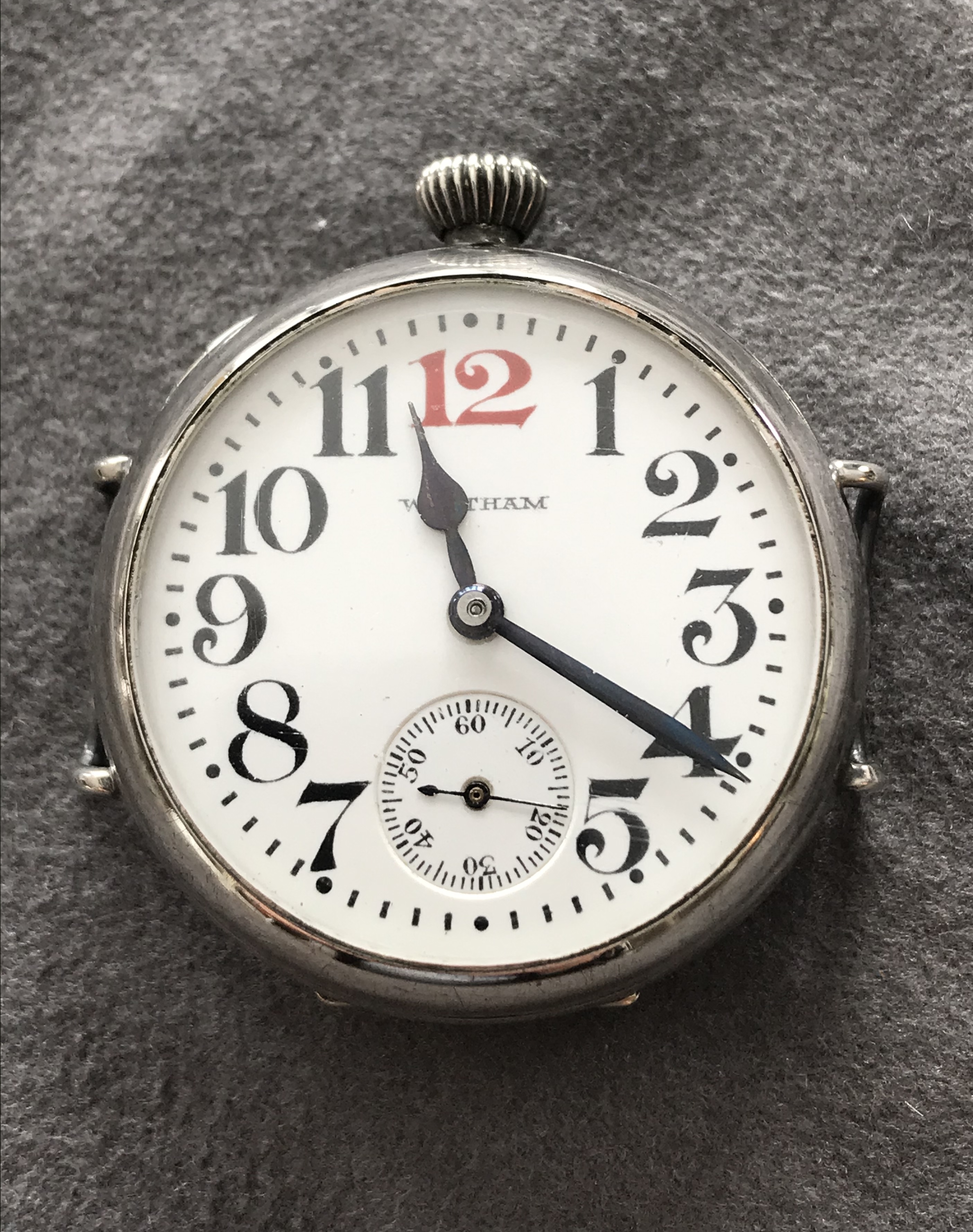

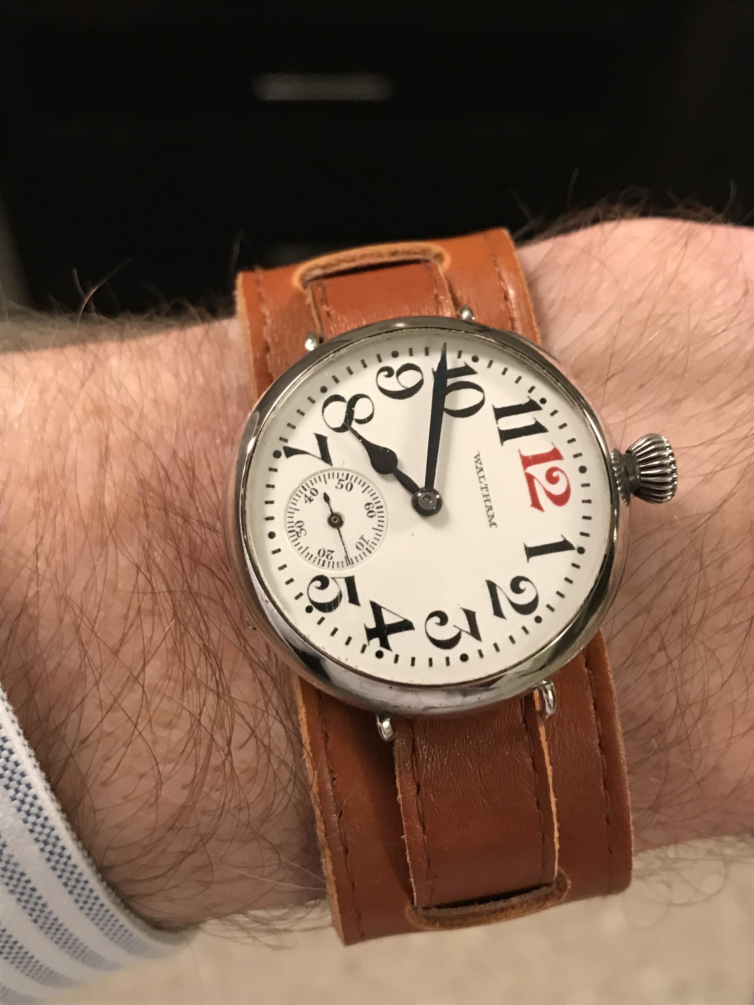

This is ad for a Waltham wristlet dating to 1913, indicating these were available before the war. Followed by a Waltham wristlet, likely from a similar era, with the lugs adjusted to 90 degrees. Looks great on a modern replacement Kitchener strap!
The marks indicate that the case was hallmarked as "imported silver" at 0.925 quality and assayed in London in 1915/1916, so you are on the mark.

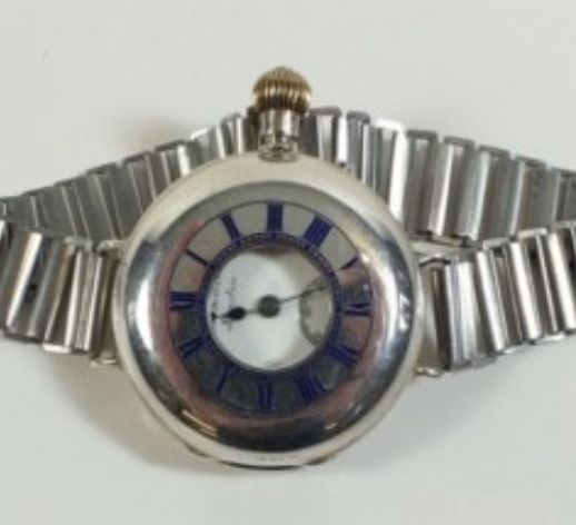

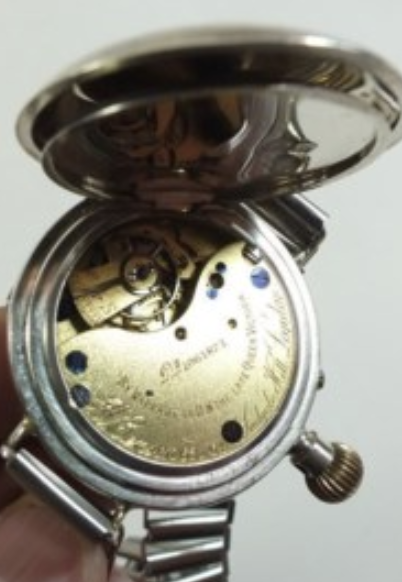

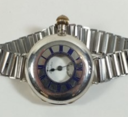

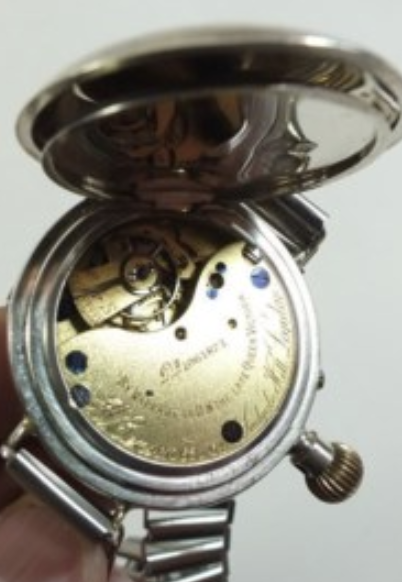

Like this slightly obvious lapel watch conversion floating around . interesting that the three quarter plate configuration doesnt necessarily mean it is a cheap movement!
