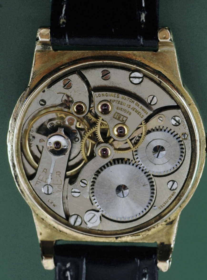

Hmm, I like it, but also don't want to buy a frankenwatch.
Here are pictures of the inside and case back photos.

The bezel is correct, it’s a 1940s gold filled model indeed- and it shd be 30mm with a 12L movement inside. I believe those were marketed as pilots watches (civilian) among other things.

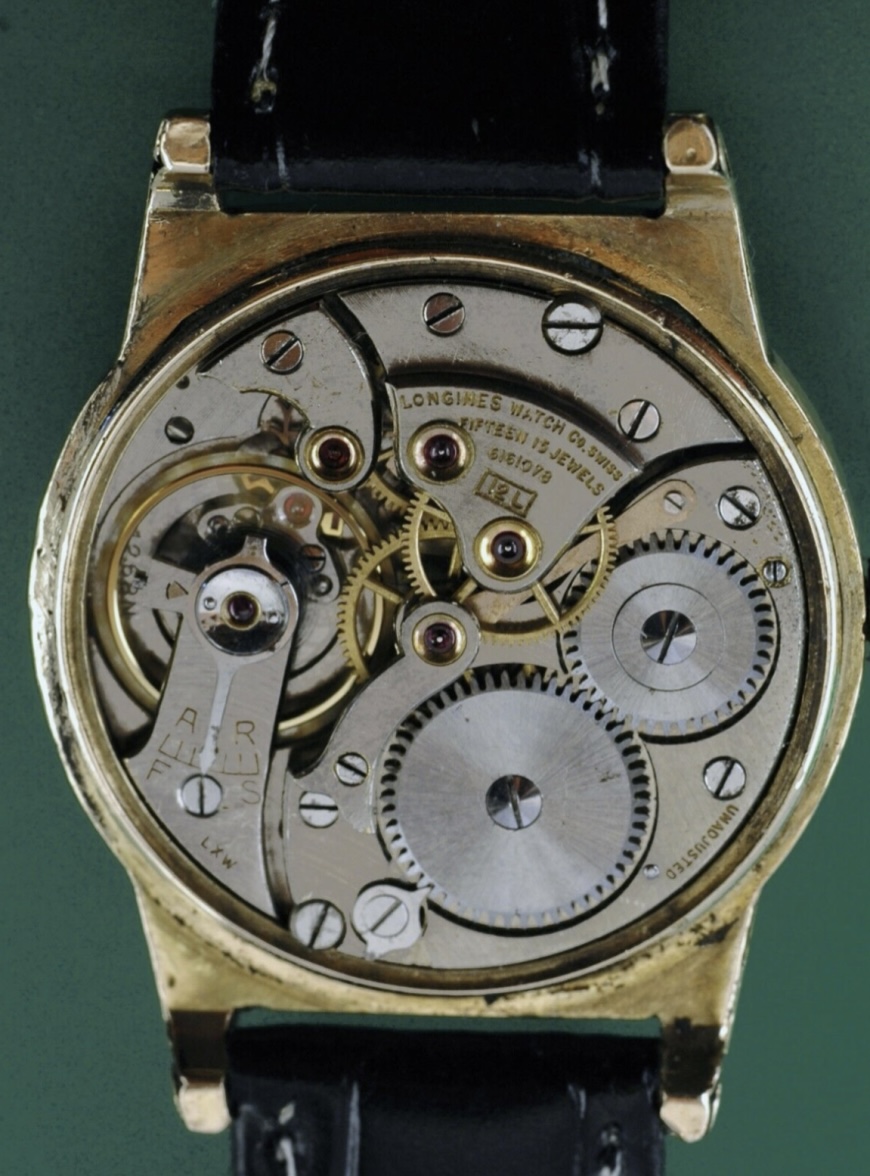

A couple of more things about the watch:
1. Here is a closer view of the movement.
It is a caliber 12L per the US designation, but is also marked 12.68N, which is the Swiss caliber number. This is common on early US imports.
2. It is a U.S. market watch. You can tell by the full name of the importer on the movement, the “LXW” import code on the balance bridge (for Longines-Wittnauer) and the word “Unadjusted” stamped on the movement.
3. I would suggest going over to the Vintage Watch Resources website. You will find a serial number database over there that will tell you that the serial number dates from 1940, or before US entry into WWII.
4. Longines used several different logos during this time. This makes authenticating the dial very difficult. I would assume a redial unless one can document other examples with the same dial.
Hope this helps,
gatorcpa
