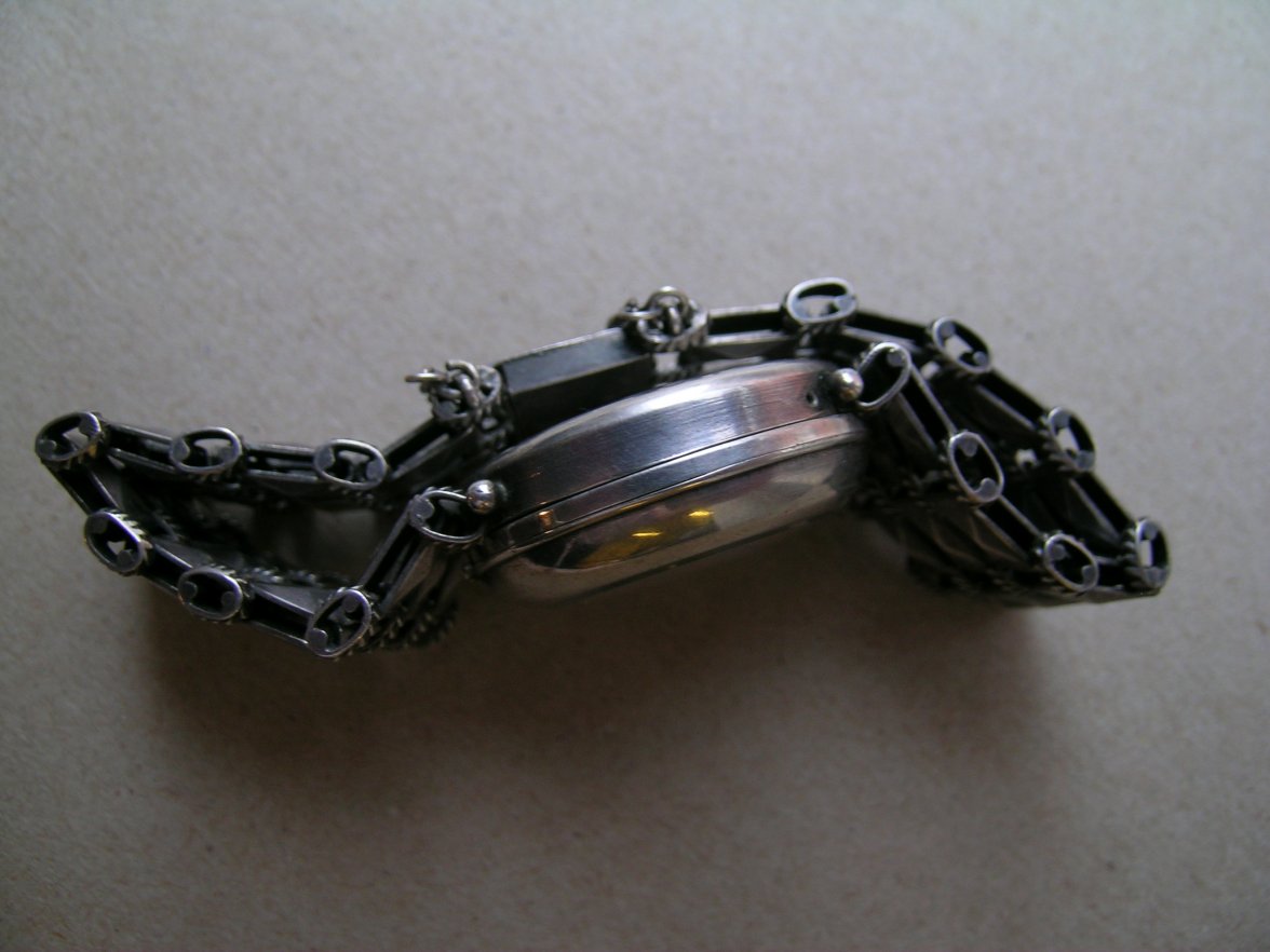

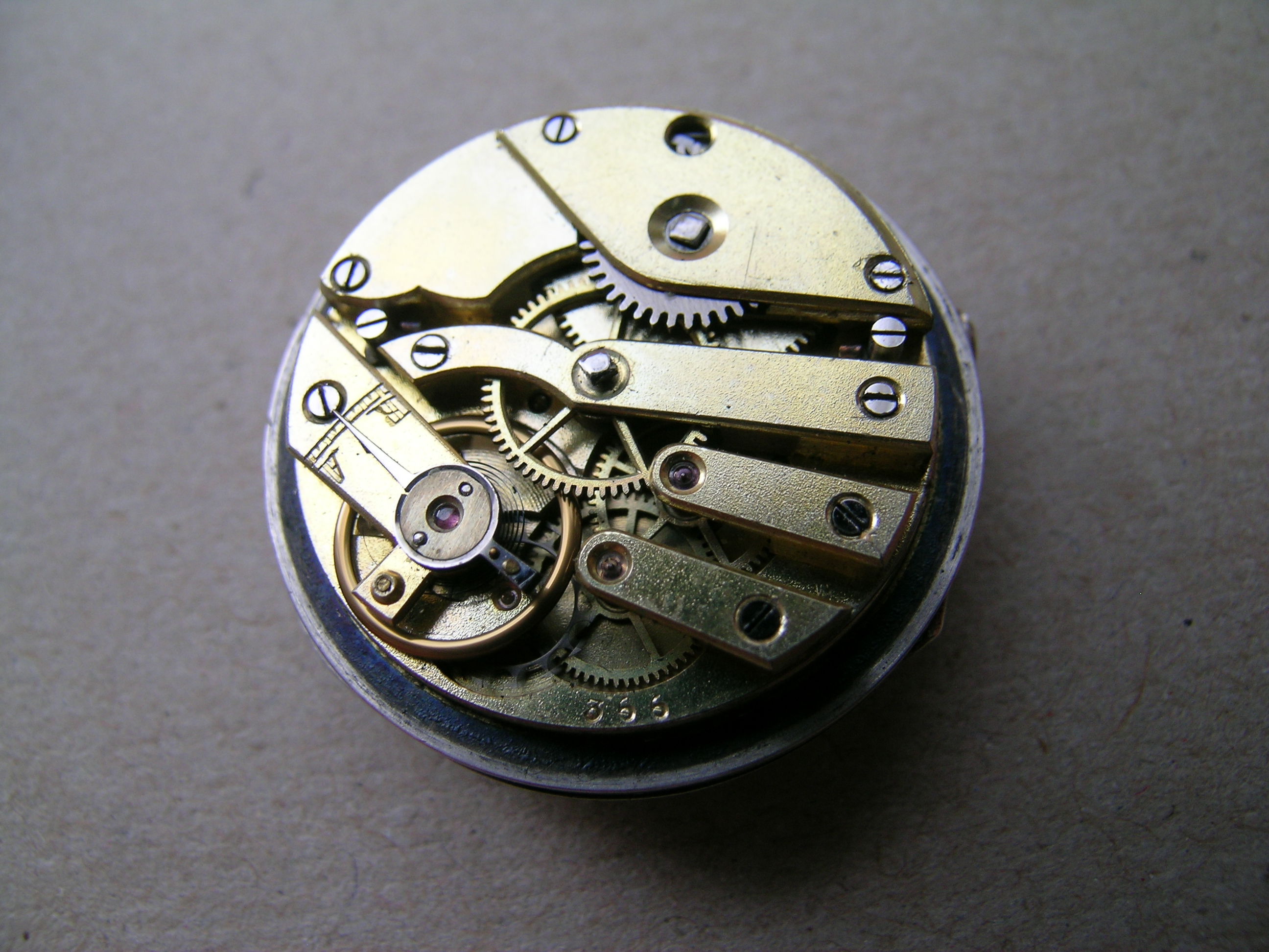

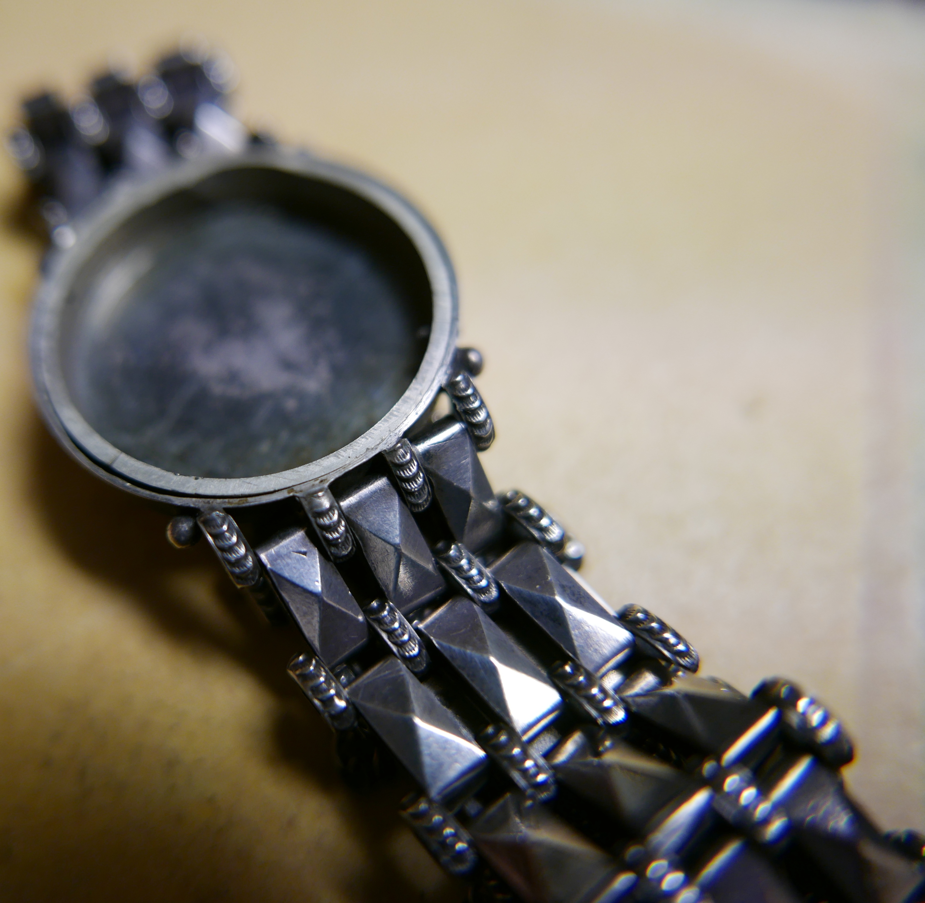

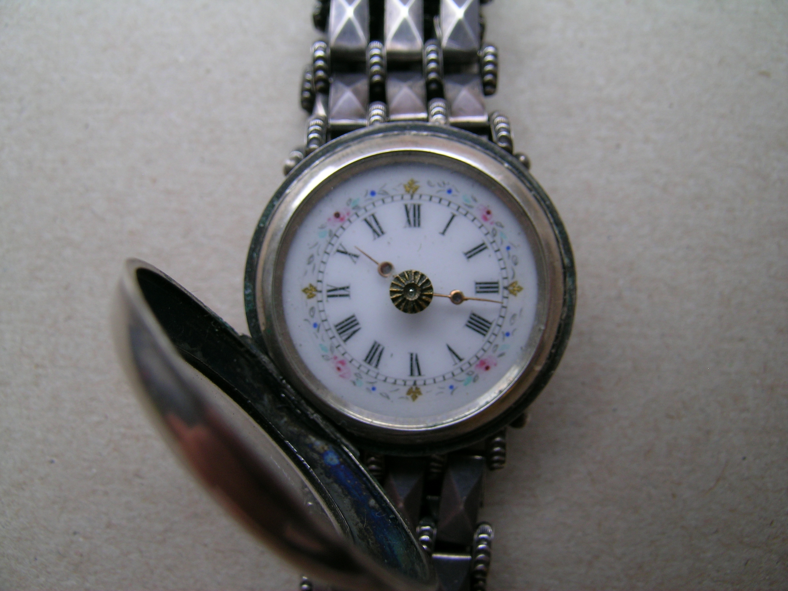

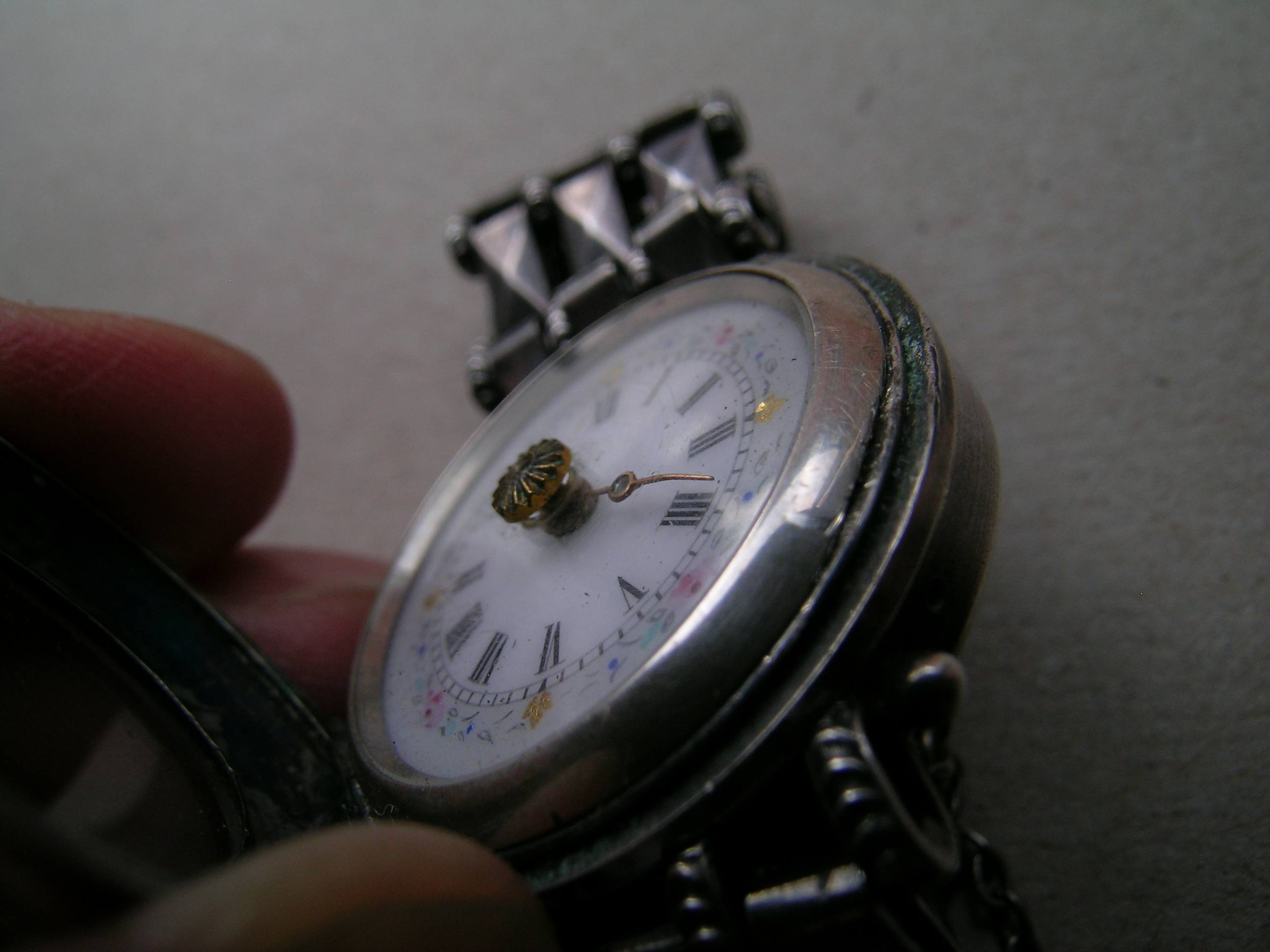

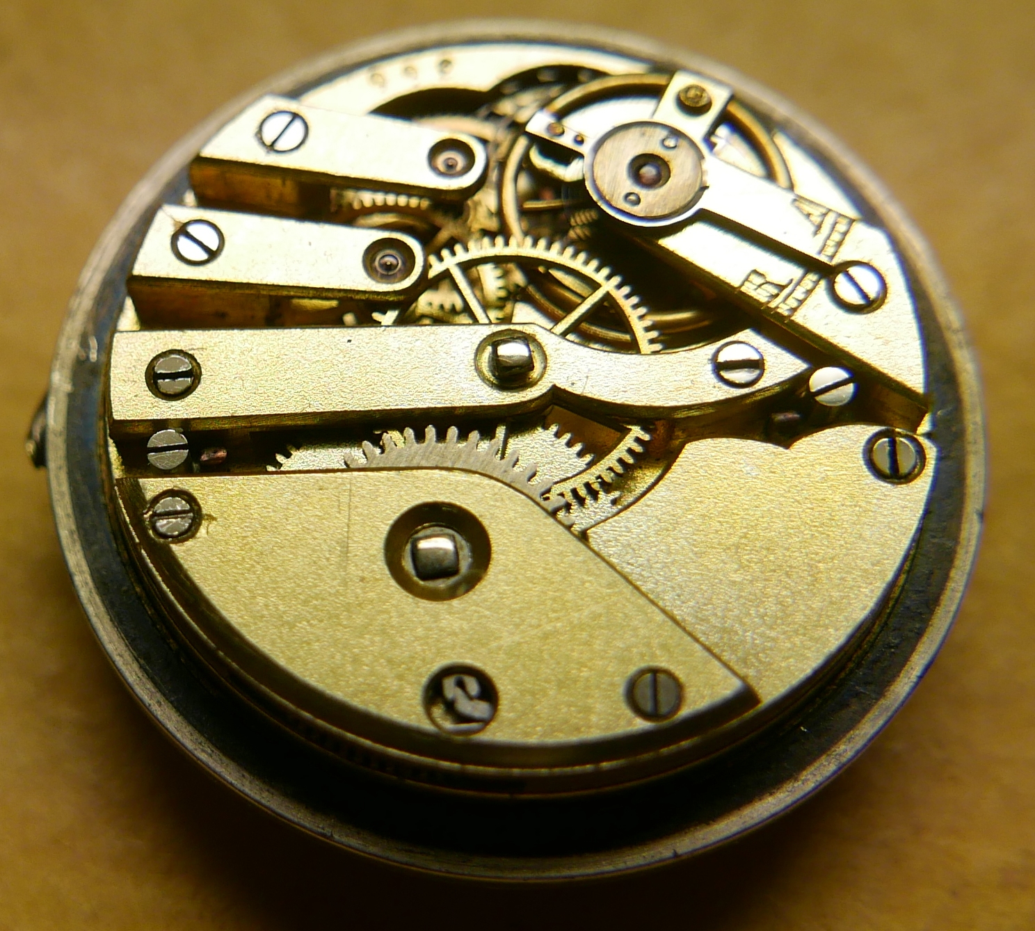

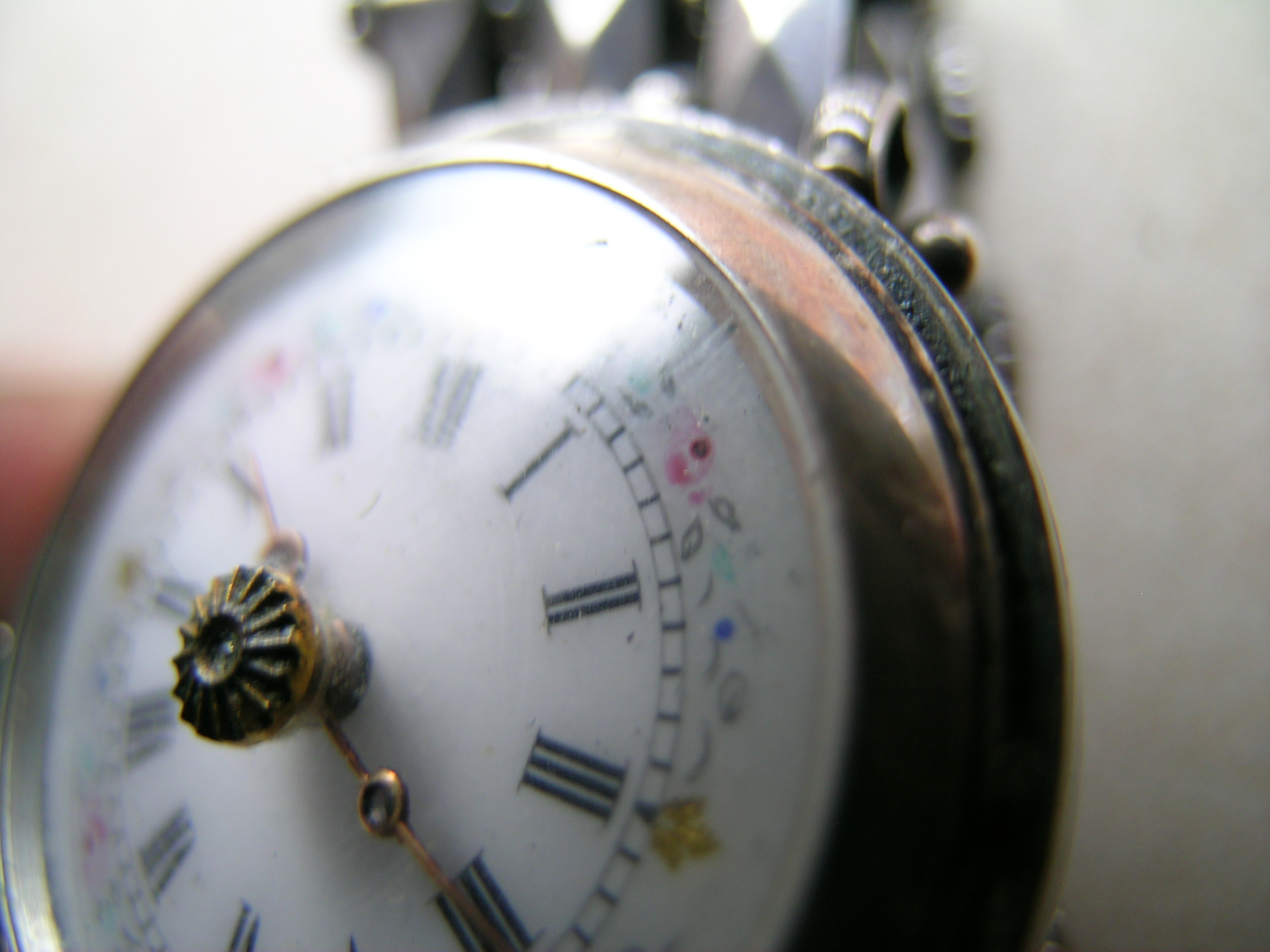

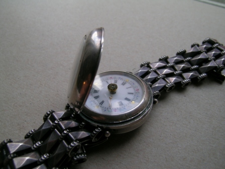

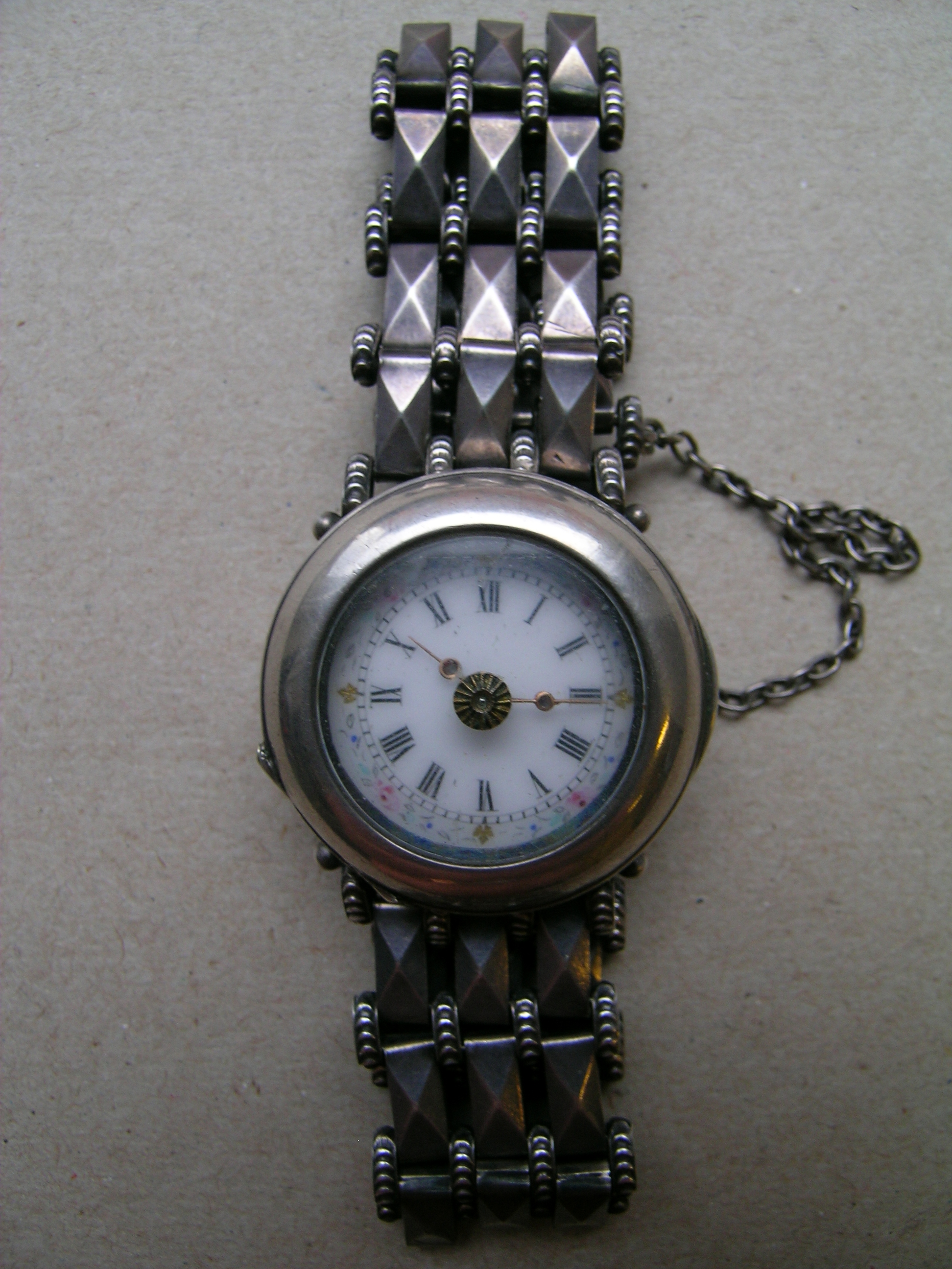

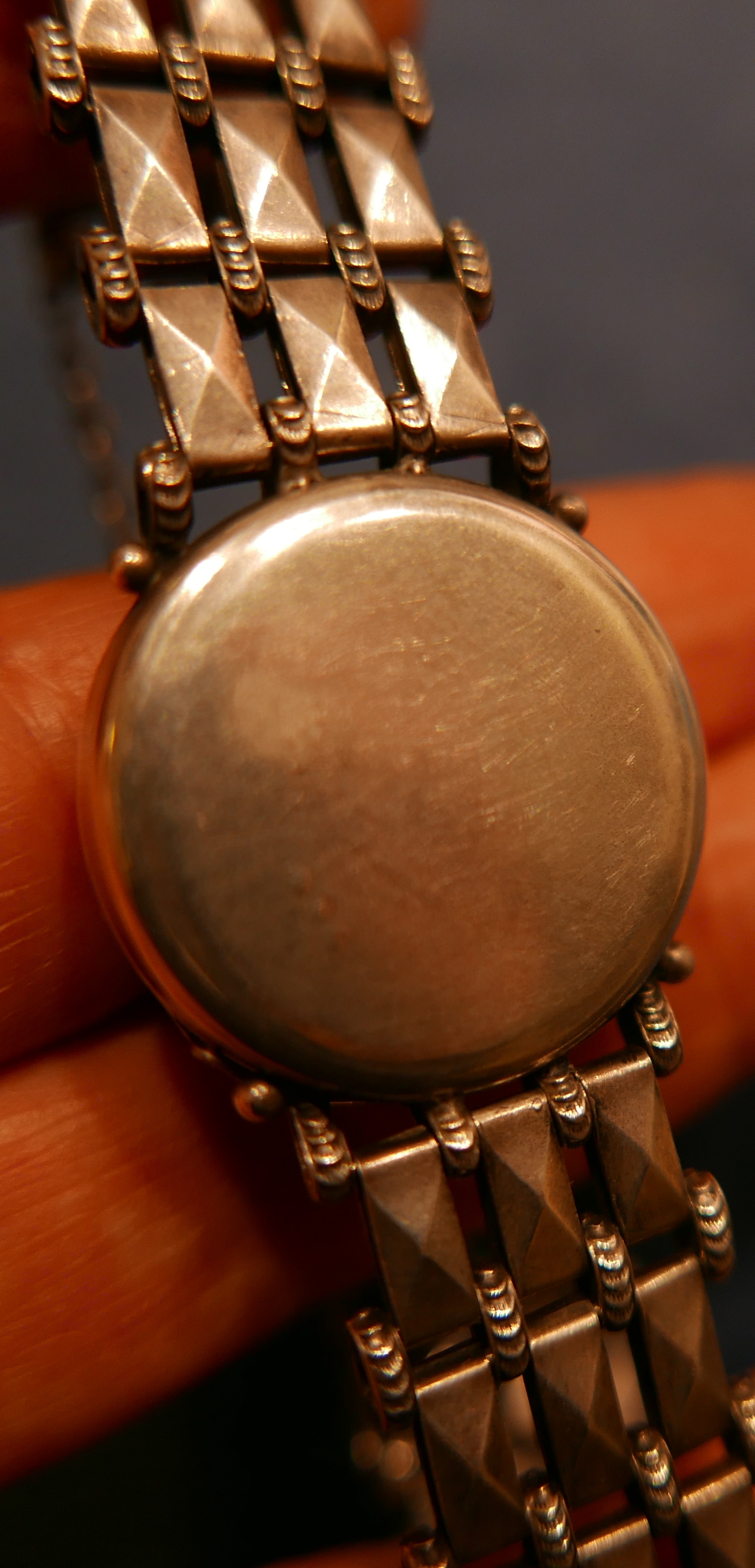

    I belive this is a very early wristwatch, perhaps made before 1900....
    No signature (haven´t checked under the dial).
    - Winding with bezel
    - Hand setting with knob in the center of the dial under glas no 1 (there is two glasses).
    - Bracelet and case, all looks original, made of silver.
    I am searching after any further information .................
    Regards
    Peter
    Klocksamlingen 5 005.jpg Klocksamlingen 5 009.jpg Klocksamlingen 5 016.jpg Klocksamlingen 5 018.jpg Klocksamlingen 5 001.jpg Klocksamlingen 5 026.jpg Klocksamlingen 5 028.jpg Klocksamlingen 5 028.jpg Klocksamlingen 5 036 - Kopia.jpg Klocksamlingen 5 025.jpg Klocksamlingen 5 030 - Kopia.jpg Klocksamlingen 5 030.jpg

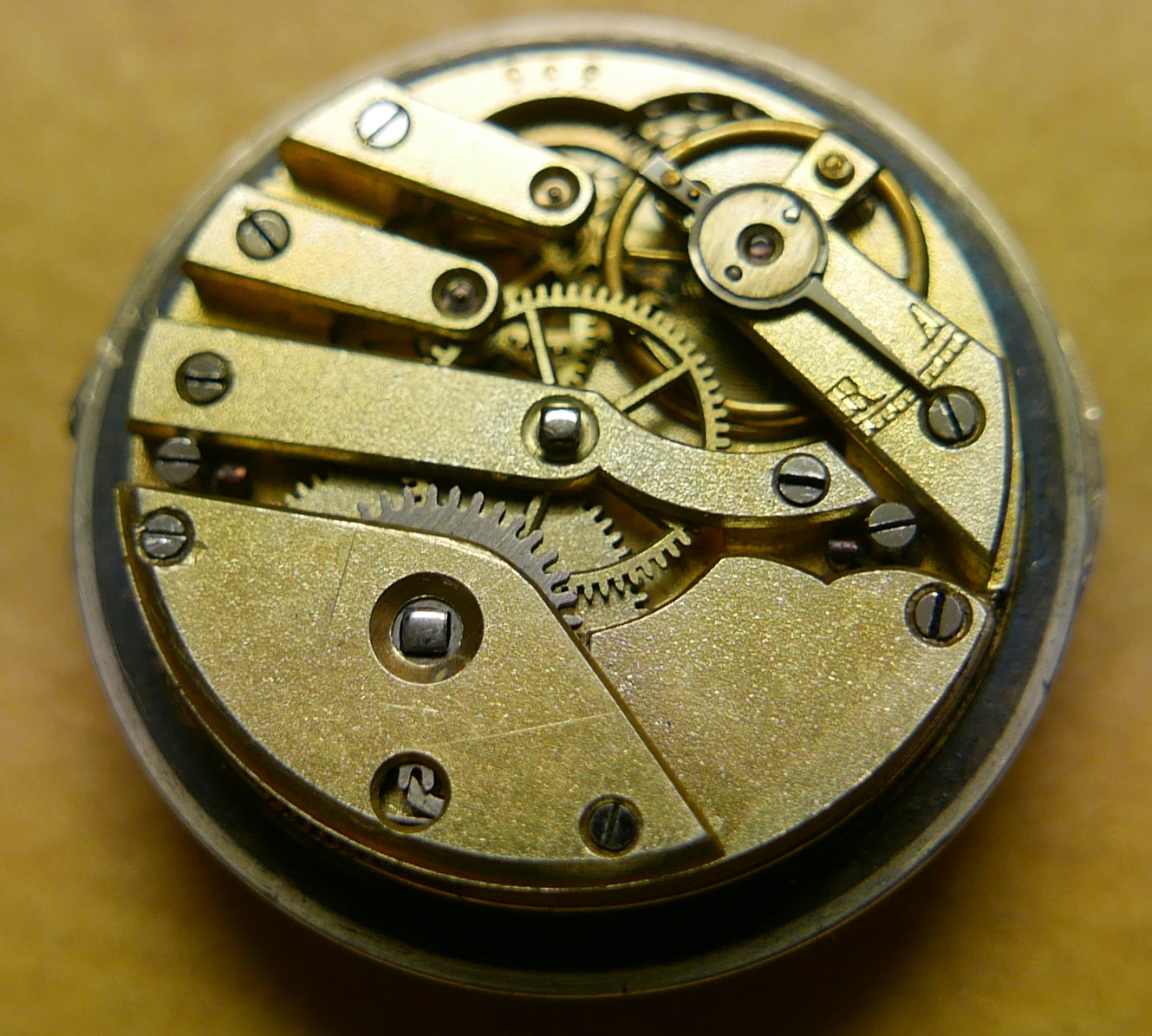

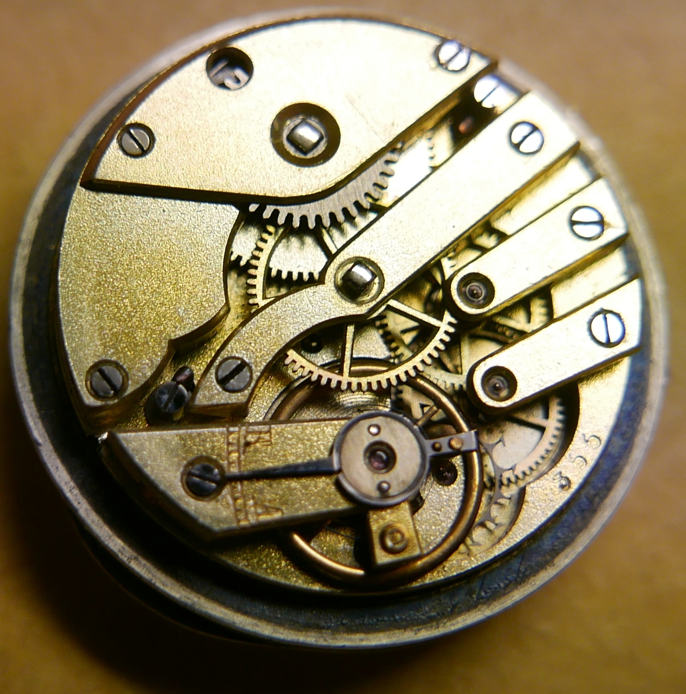

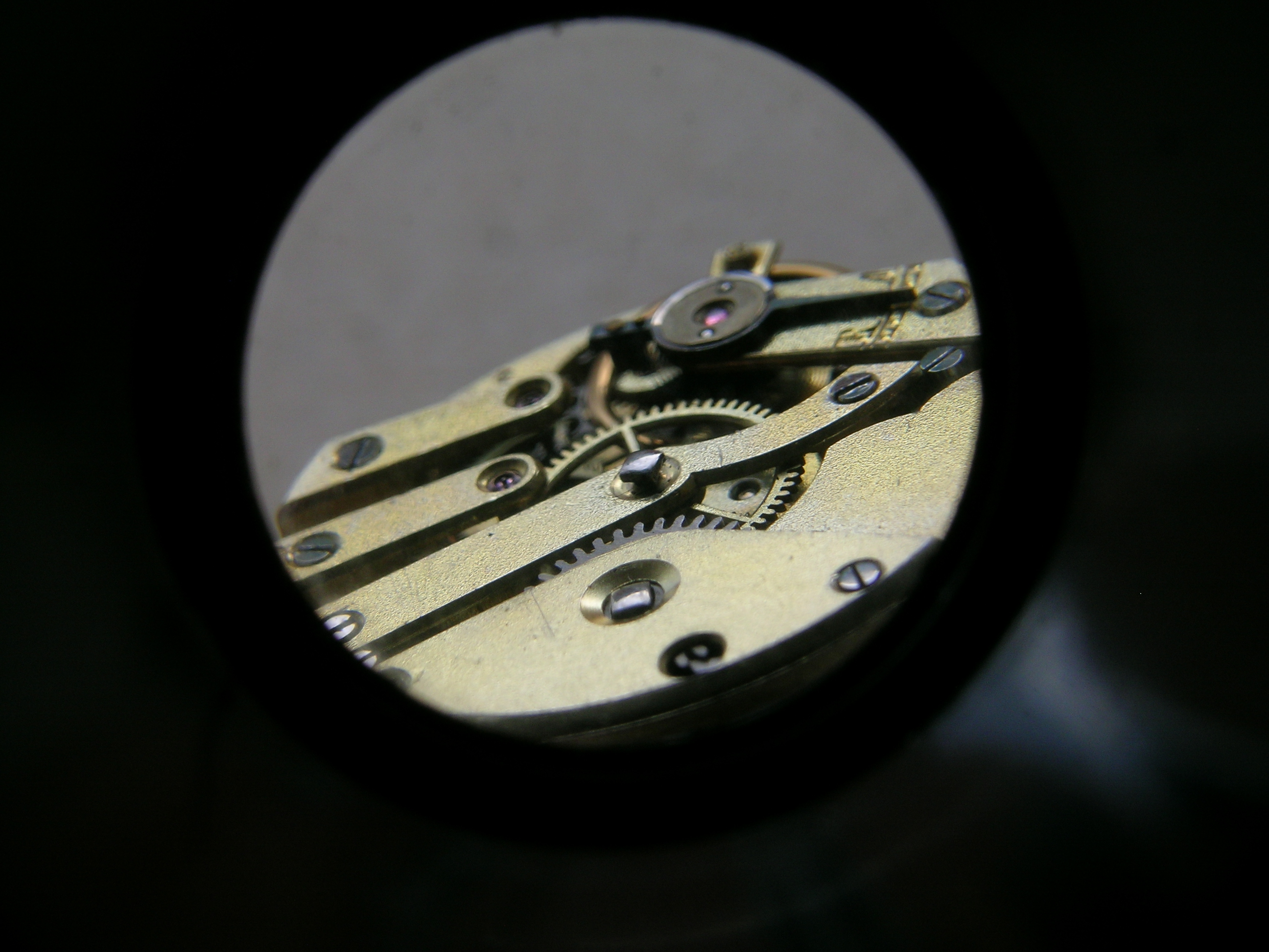

    Very unusual. It has a cylinder escapement which was normal for the mid to late 19th century and even a bit later in many French and Swiss pocket watches.

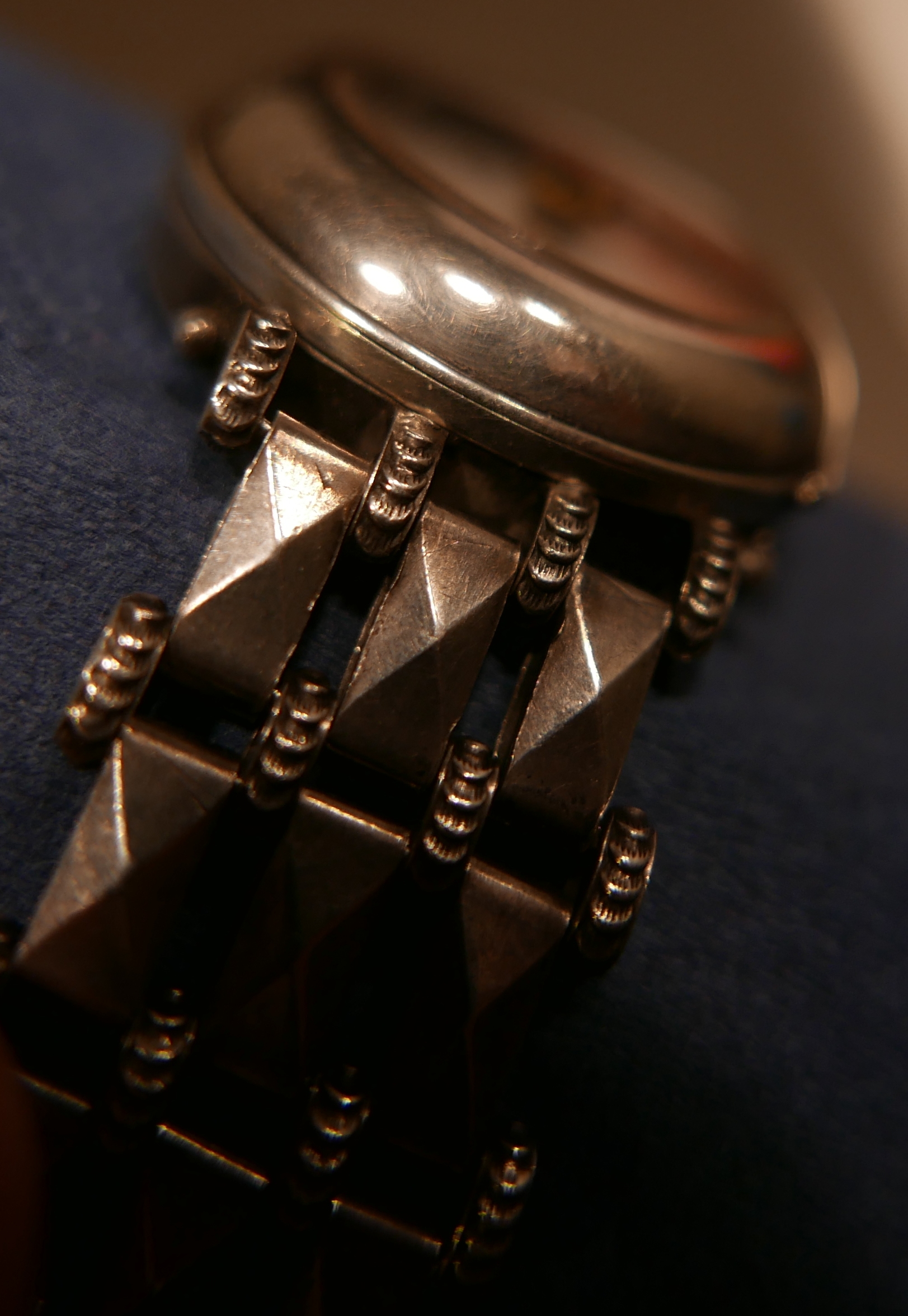

    The bracelet was probably added to a ladies pocket watch at a later date IMO.

    1930's looking bracelet, eh?
    Feminine dial in beautiful porcelain seems more a broach than a pocket......may I ask the size?
    Don't throw it away just yet!

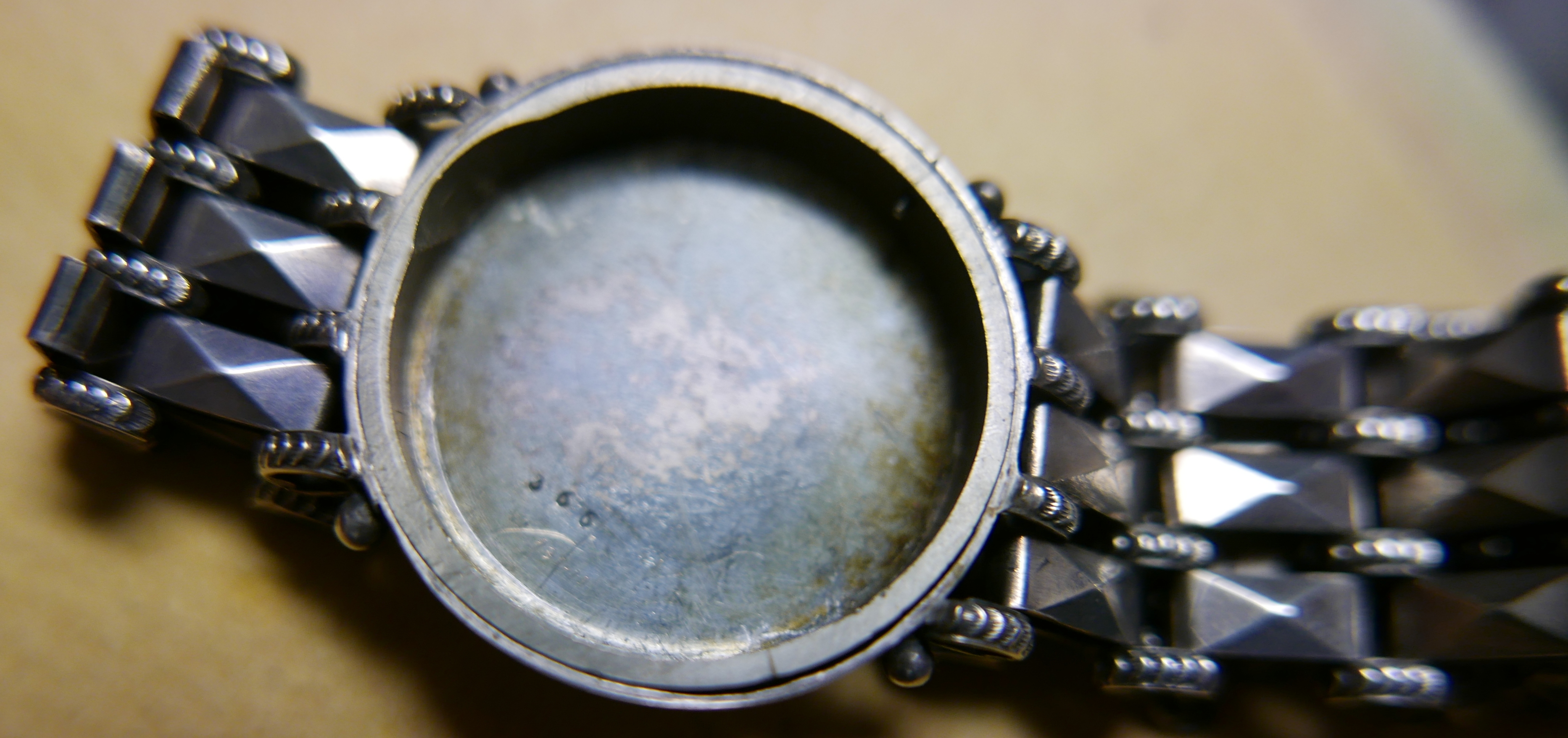

  4. UncleBuck understands the decision making hierarchy Dec 30, 2017
    3,420
    7,745
    The ladies didn't have pockets then, did they!
    Jim, any guess as to the make or the area of origin? Looks Continental, not American.
    Could well be a base movement, finish crafted one-off at the bench. I wish we could hear the story.

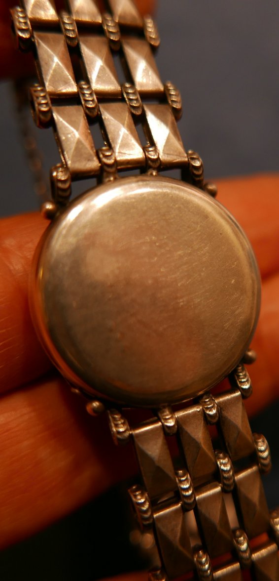

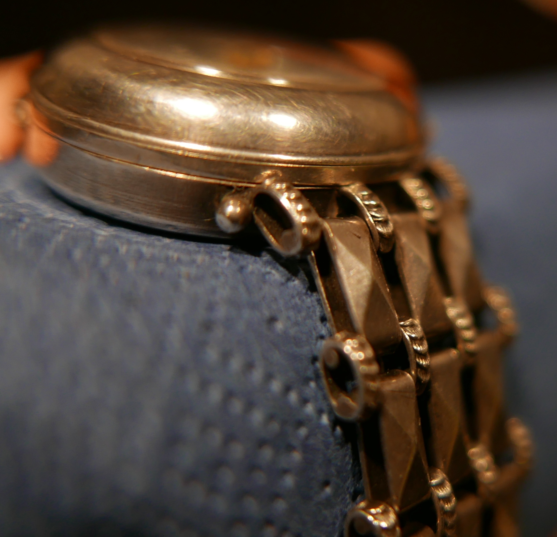

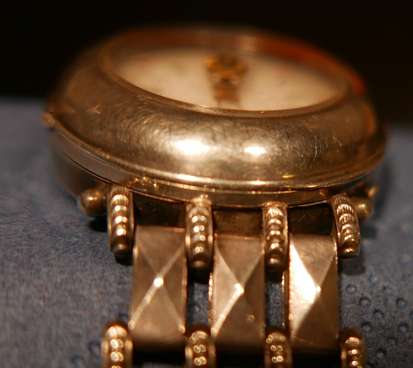

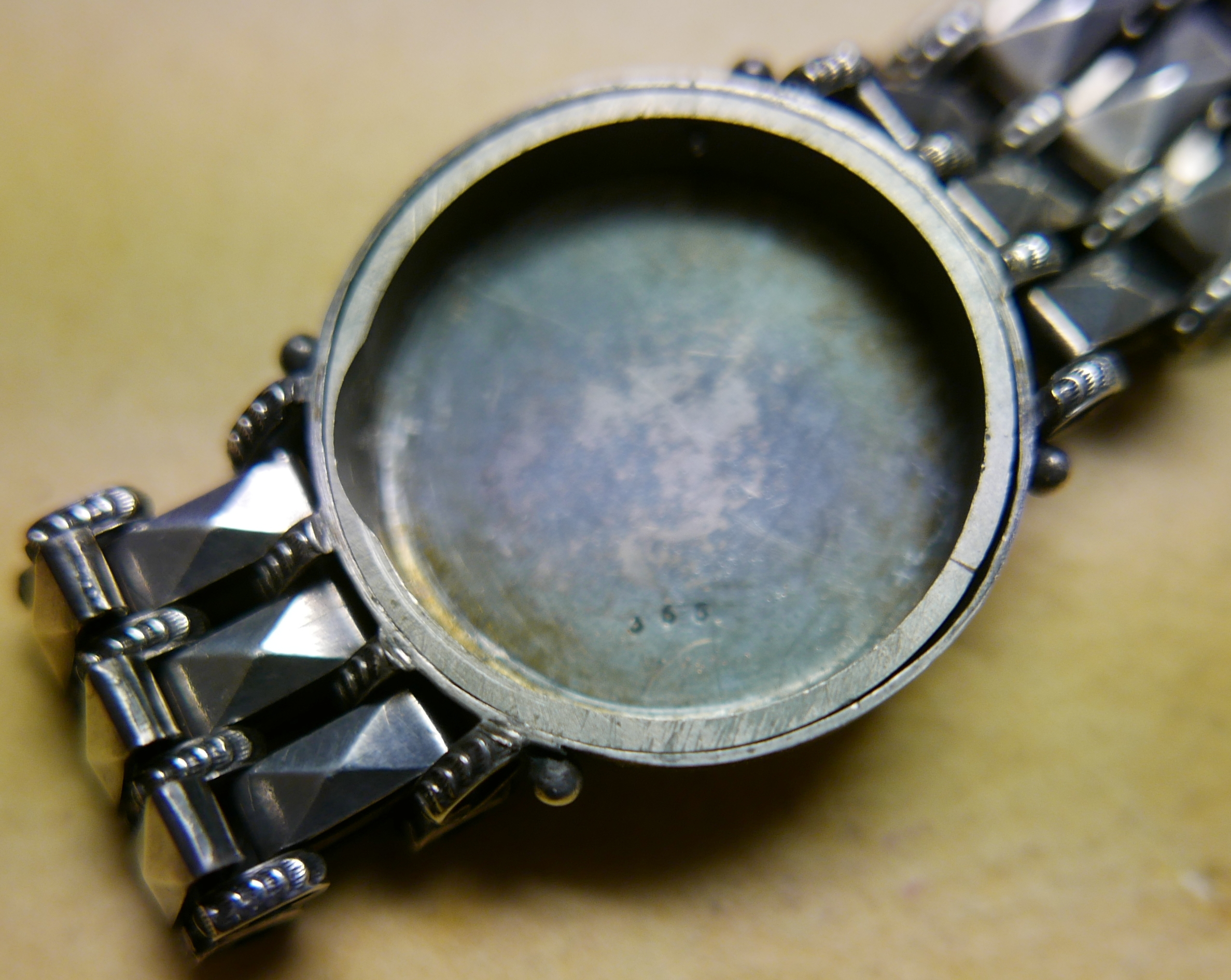

    Initial thought is that it's a late 19th century fob watch that has a later bracelet added. That's just my initial thought, though. Any detailed photos of the case above the 12 where the bracelet now fits to see if there is evidence of alteration?

    Weren't they more casual/sporting for the ladies of this period?
    The floral porcelain seems more formal to me.

    I regularly see examples of fobs from that era with that style ... might even have one in my "projects box" with a similar cyliner escapement movement.

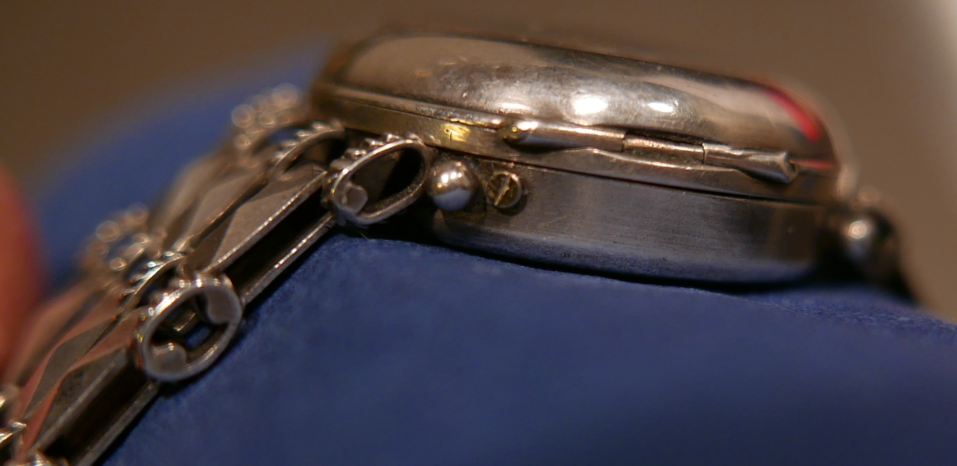

    I've just had another look at the photos and what's struck me is the hand-setting "device". I've not seen that before. This watch was obviously always intended to be stemless and keyless ... ladies wristwatches did predate mens in usage so ... this could be correct and original.

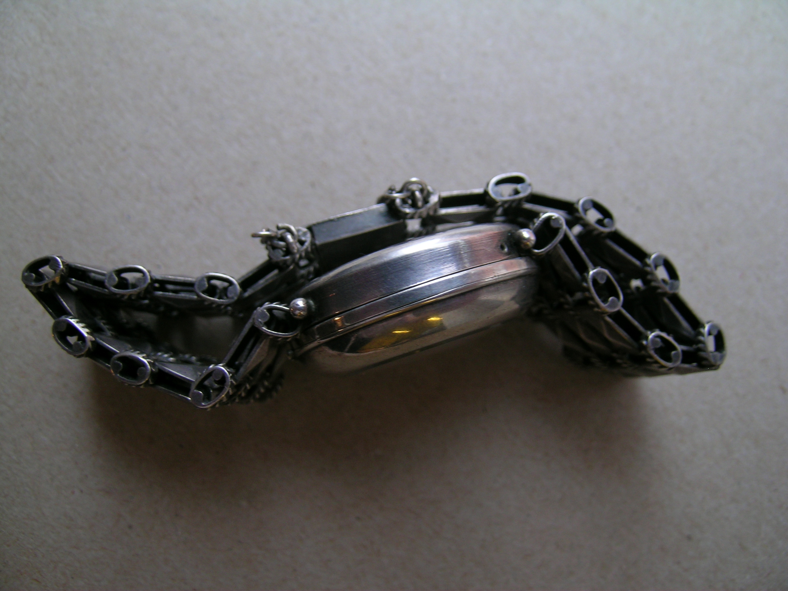

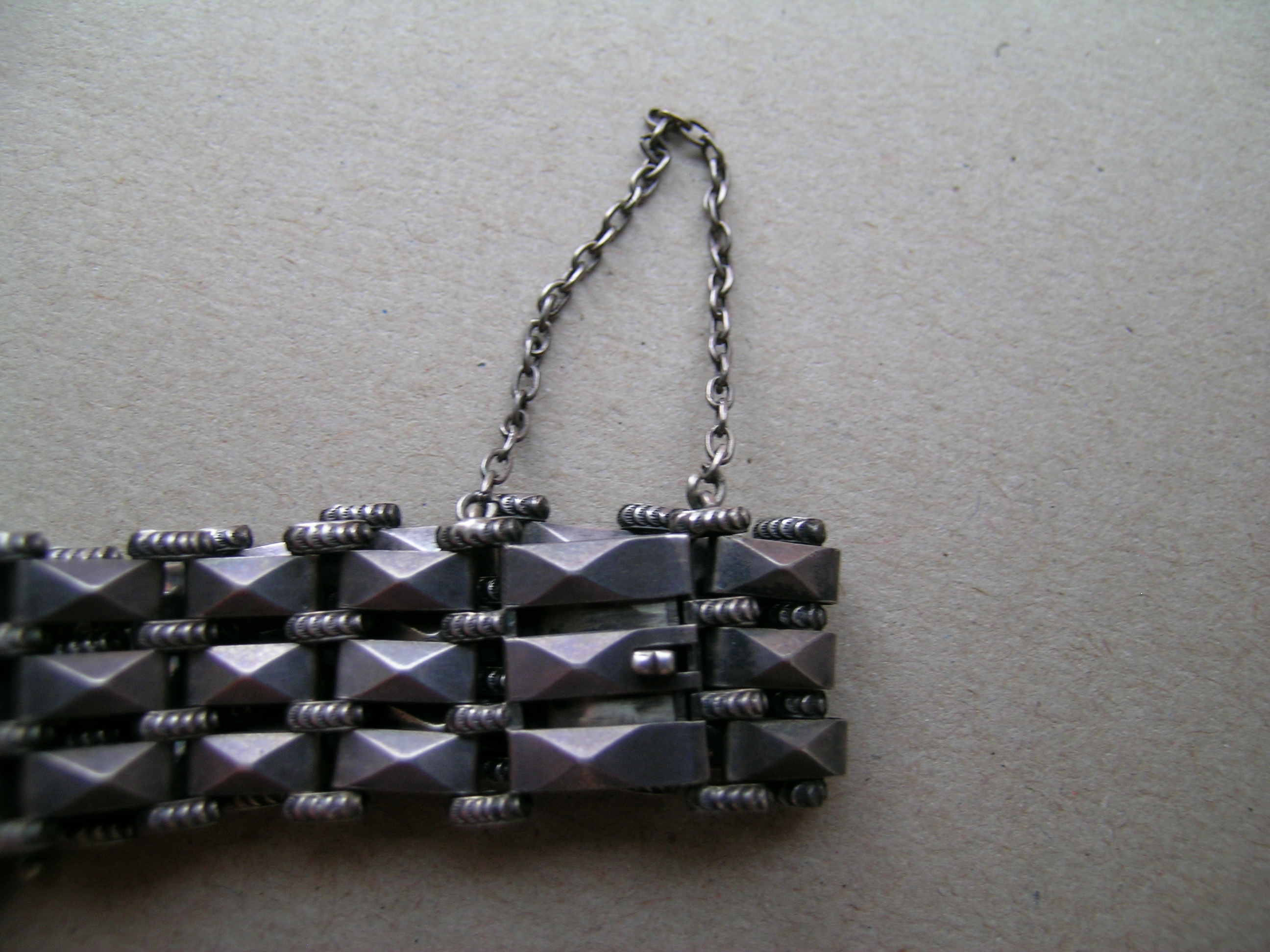

    That bracelet is much later.
    We would need some good photos of the lug attachment and would love some provenance.
    I am skeptical.

    True ...
    .... yeah, really need to see that case detail. It's certainly interesting.

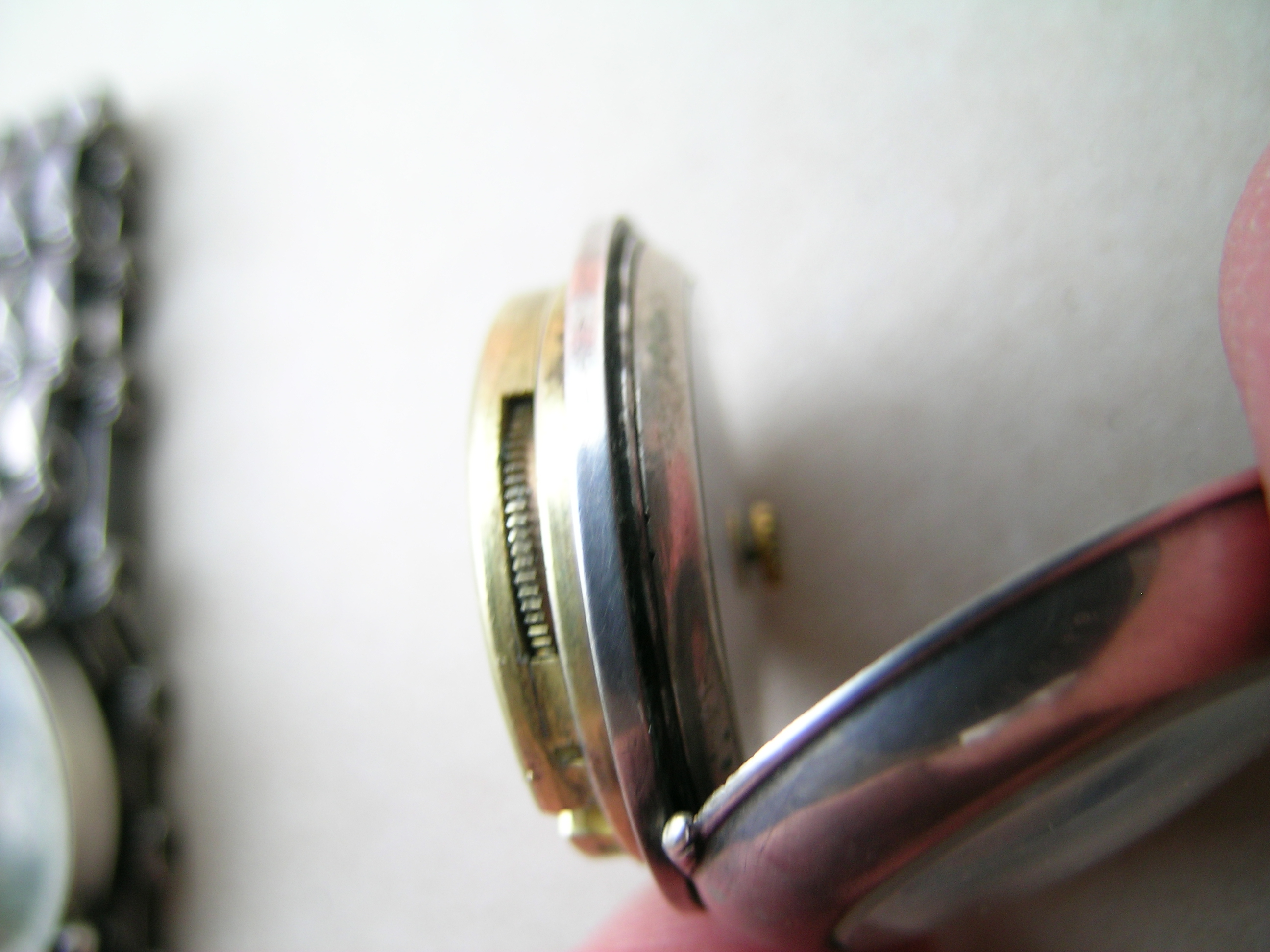

  12. Mr Watch Dec 31, 2017
    70
    163
    Hello!
    Thank for all replies.:)
    I have a collection of early wristwatches and there are some other watches woluld like to show and have" feedback" on. I will publish some of them in separete threads.

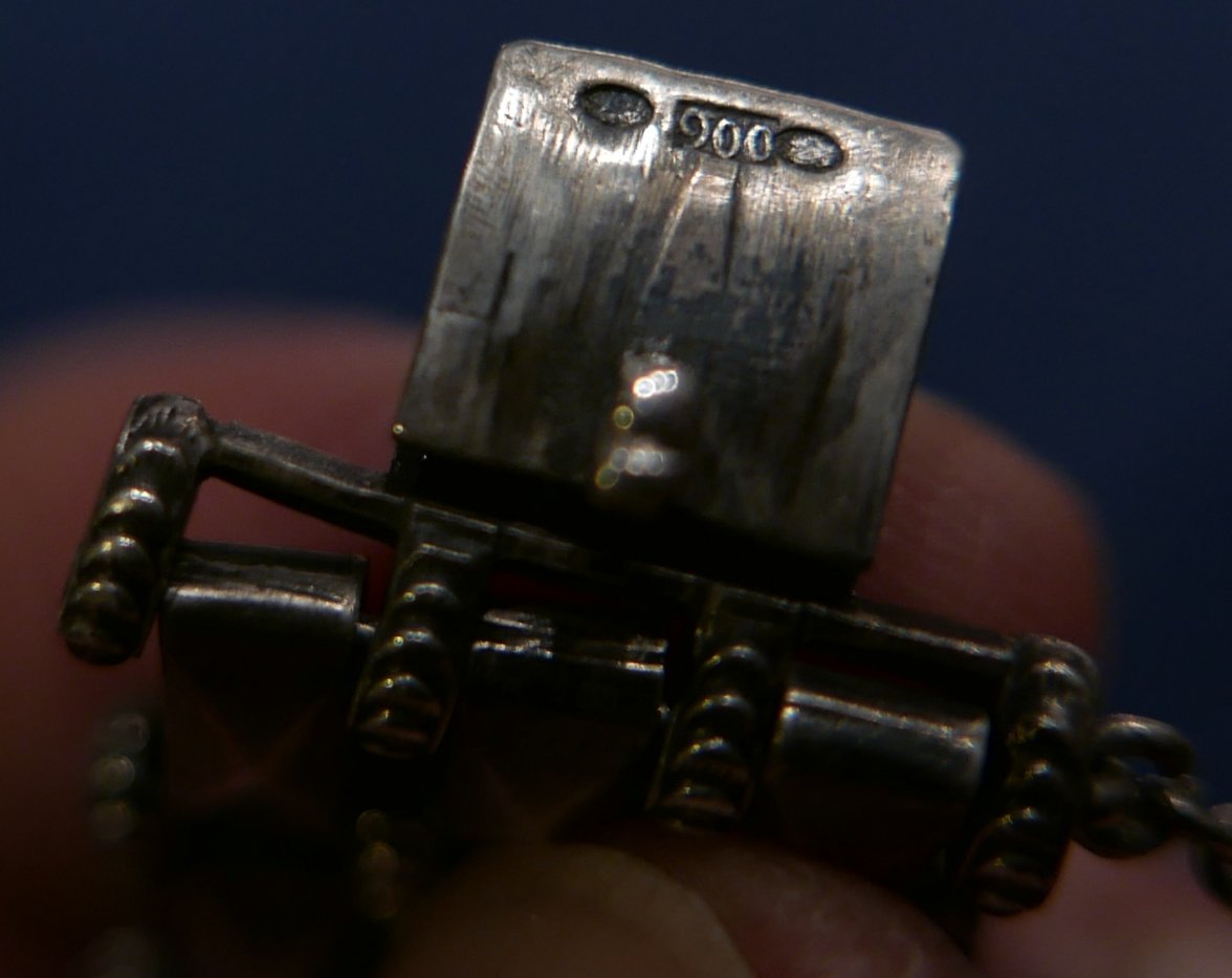

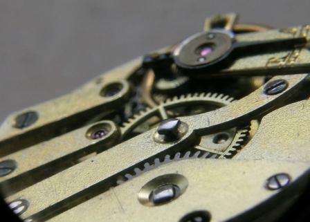

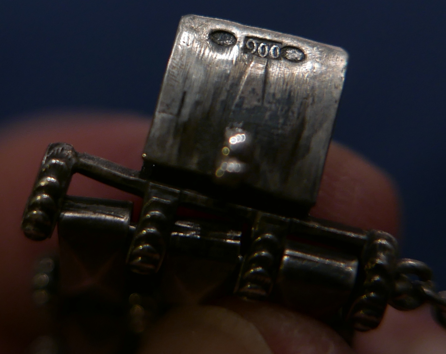

    Some new pictures. The diameter is approx. 29 mm. Winding- and handsetting mecanism is very special. Movement and case with production number(?) 366. No marks or name (I haven´t checked under the dial)
    The case has extra space inside for the winding barrel. Bracelet mark 900 (silver) and some other stamps wich are hard to read..
    No traces of altering from a pocket watch.
    Regards
    Peter

    I wouldn't bet it is a 1930's style.
    Look for example on this Omega metal bracelet in catalogs from 1906 to 1917 :
    French 1906 Kirby catalog (which also displays women's Pocket/fob watches) :

  14. Mr Watch Dec 31, 2017
    70
    163
    Yes the bracelets in these catalogues looks a bit similar in style. Very nice and interesting pictures..Thank you!
