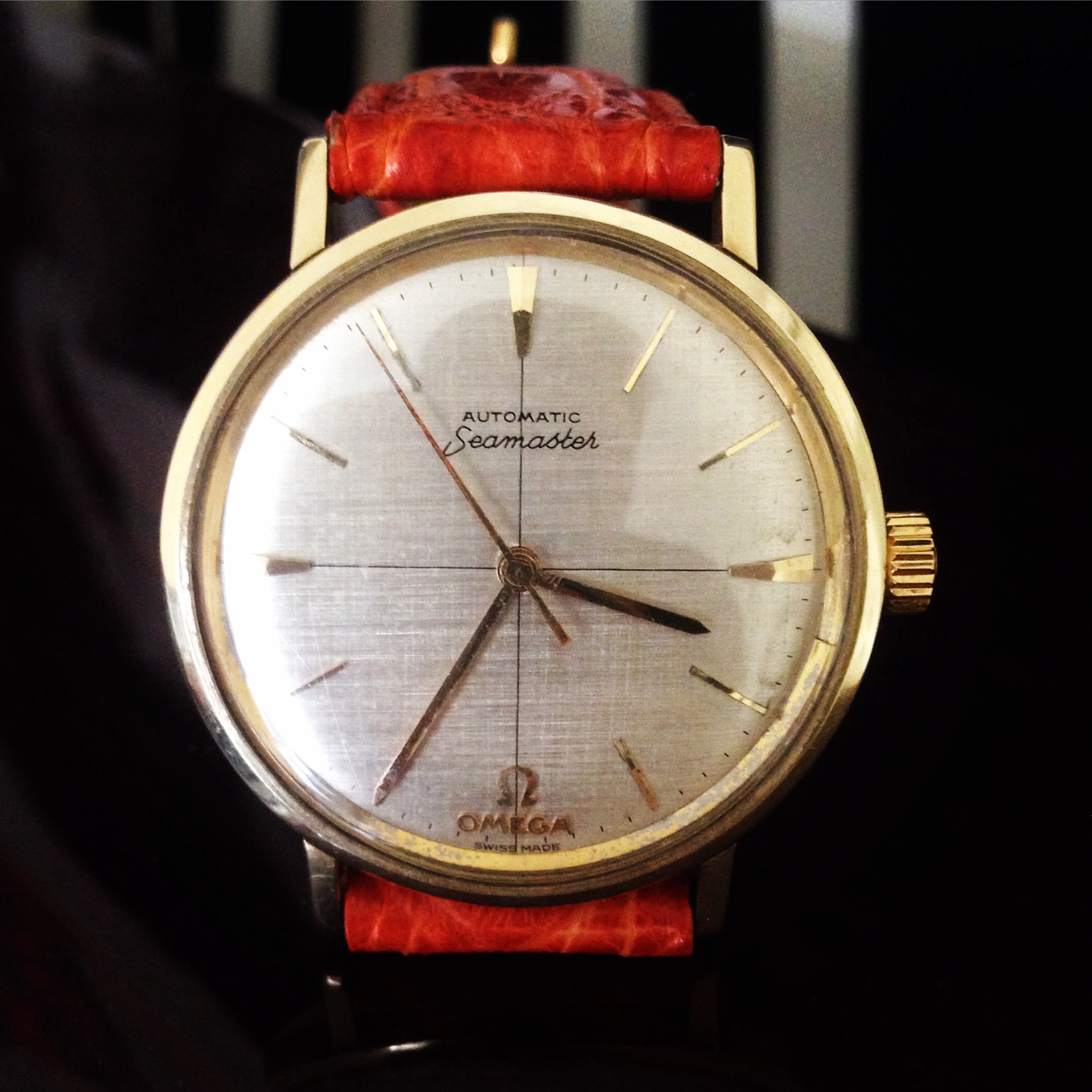

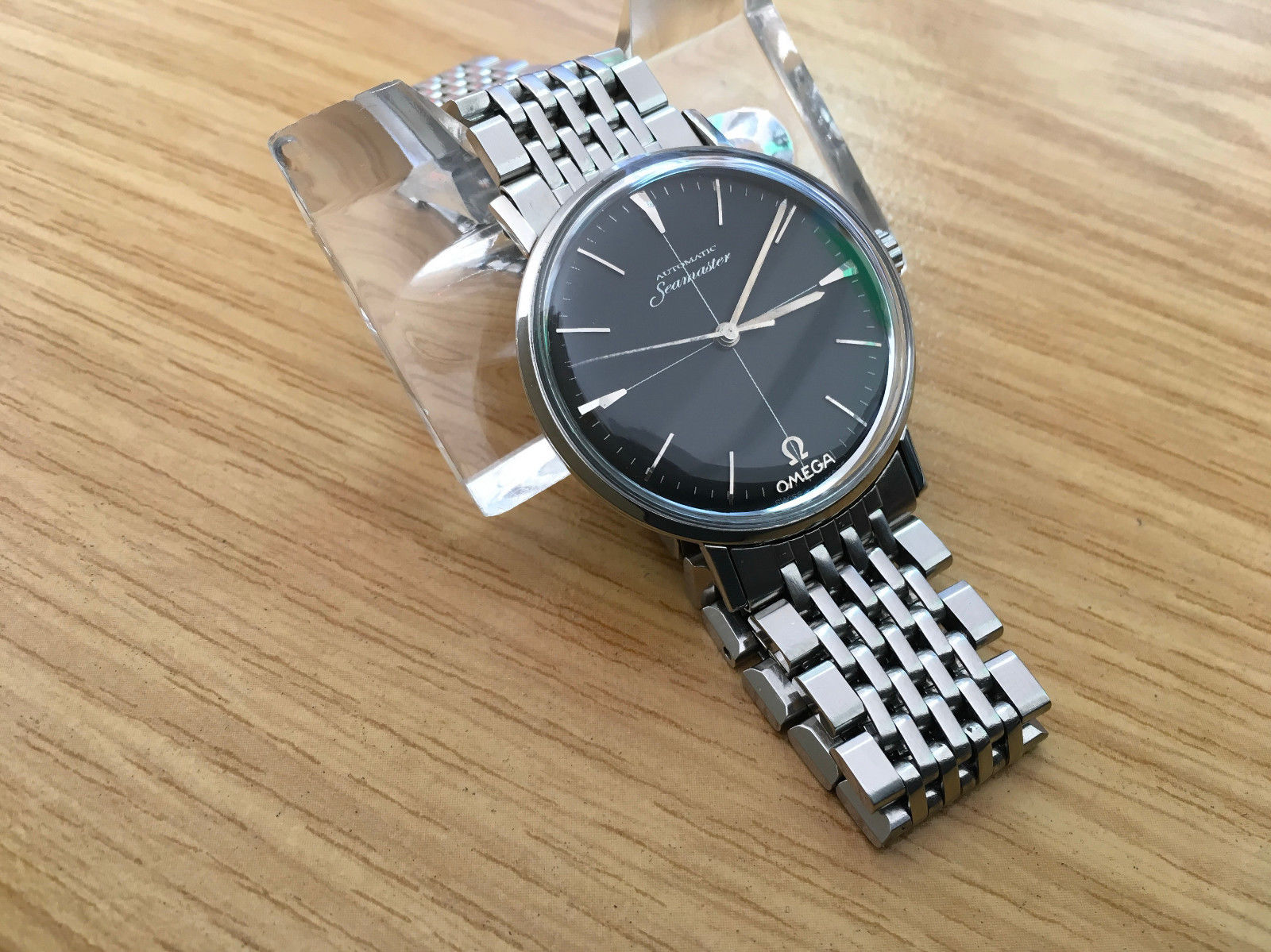

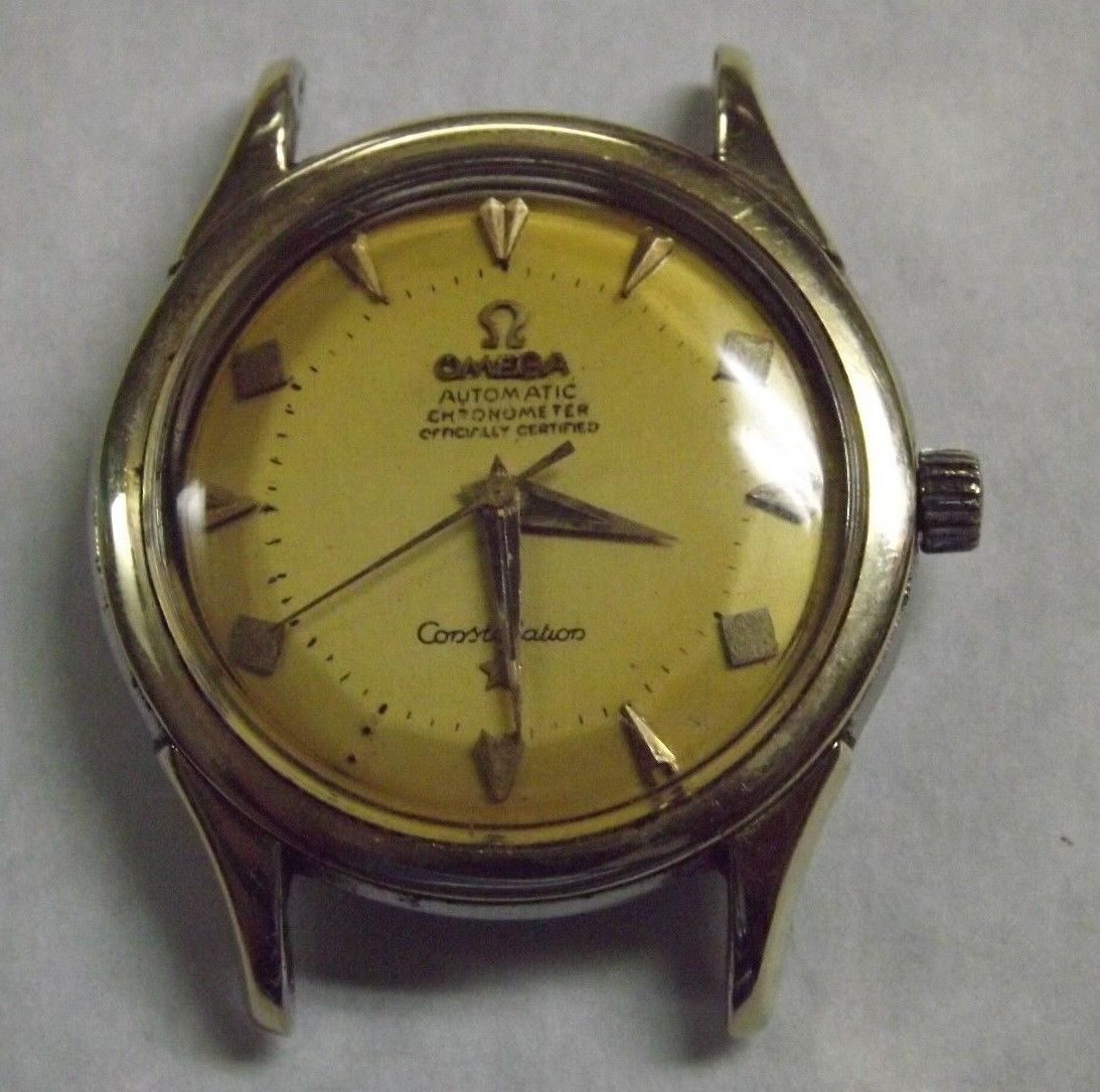

This appeared on my Facebook feed today. Although I can't be certain, and it's not the ugliest dial I've ever seen, I think it is a re-dial. the giveaways to my eye are the slightly uneven looking minute markers, the cross hairs not appearing aligned with the Omega symbol, and the generous amount of modern lume on the hands. Could all be an optical illusion or my own inexperience though, in which case I unreservedly apologize to the owner.

Yes, clearly a redial. No doubt there. Pretty bad if you ask me.

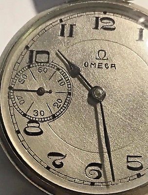

Pitiful they couldn't even get a clean Omega symbol.

"RARE DIAL WITH THE OMEGA SIGN ON THE 6 HOUR"
Never buy from someone who types in all caps....

The ones where it looks like it was hand written always cracks me up 😁

Although the dial has been refinished, the Omega logo and script at 6 o'clock is a genuine placement.
See discussion and additional links here:
https://omegaforums.net/threads/omega-seamaster-converted-logo-at-6-oclock.43164/
Ahh, something I never knew, thank you for the links! If the dial wasn't black, and Seamaster wasn't in such a unusual font, I probably would have done more research about that dial. The Omega sign in this one looks particularly low too, over the minute markers.
