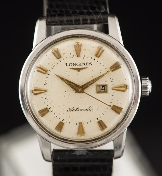

One for Dennis. Long-car? En-gines?
http://www.ebay.com/itm/151062770305
To screw up in so many ways is marvelous! As if it weren't bad enough to redial an Enicar as a Longines, they used the name of a battery powered watch on the dial of a basic 17j manual wind.
Well, it wasn't all THAT bad. The "Ultrasonic" label is seen on most Enicar watches from the 50's-60's, referring to the ultrasound cleaning of mechanical watch parts before assembly, which - Enicar claimed - enabled their watches to go a full THREE YEARS before the first oil change.

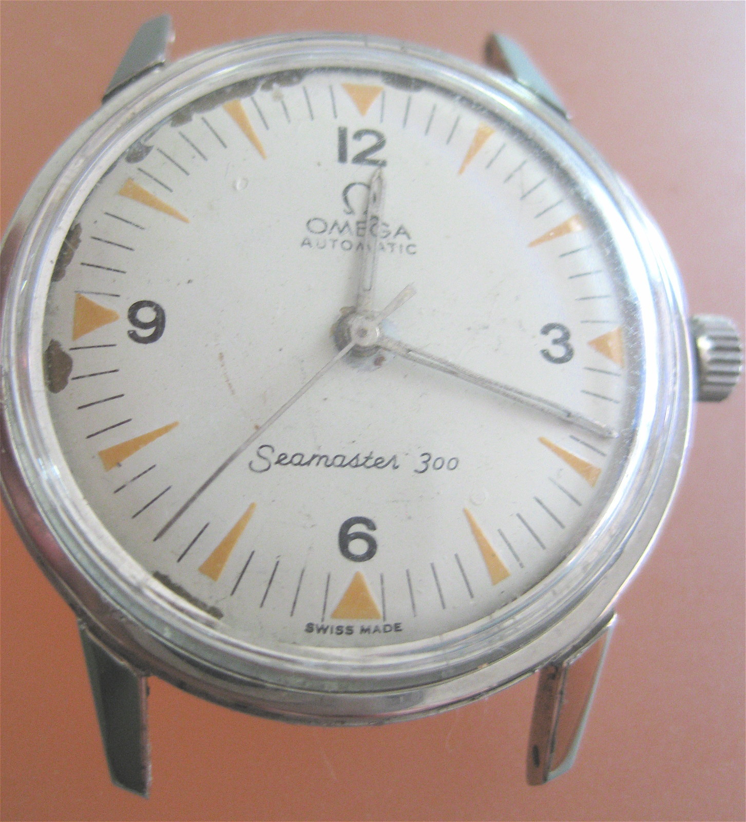

The Submariner Blue color (it's not paint - it's either a tint or a plate) is not really the biggest problem here.
I suspect it shouldn't say "T Swiss Made T" on a dial of that era - likely rather "- T SWISS T - " or even just "- SWISS - " (even then, that sometimes ends up under the crystal tension ring anyway). The luminous material is missing in any event (sometimes it never came on gold dress watches), and the minute track looks wrong. Nothing that a trip to International Dial can't fix for $50.
Luckily, Omega owners don't generally try to exercise as much, ahem, creativity as Rolex people!
D
I accept the sealmaster wins hands down, but I do find this sort of thing sad and hilarious as I watch the bay....I mean repaint OK, but do you have to use flouro satin blue? I guess it makes it easier for newbies like me to know it's a redial and saves me posting threads starting "what do you think of this...."

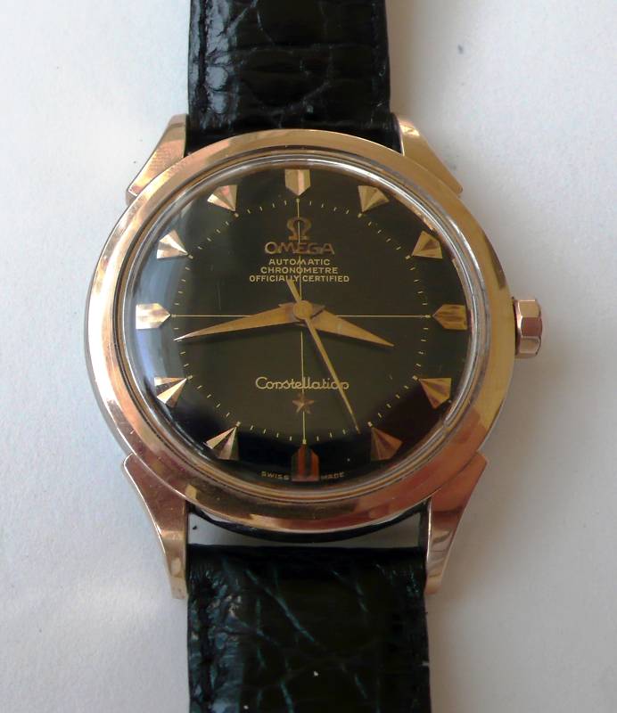

ok, i need help with this one. The only thing that looks wrong to me is the hands don't reach the minute track. What am i missing?
5,613
6,386
To me, the As in automatic are wrong, the e and a in constellation is wrong.
OK, where is the minute track and where should it be?
25,980
27,725
Hint: the hands are the right length.

So to be clear and for future decision making the hands should always just reach the minute track, no exceptions? Thanks, that's helpful....
15,046
24,049

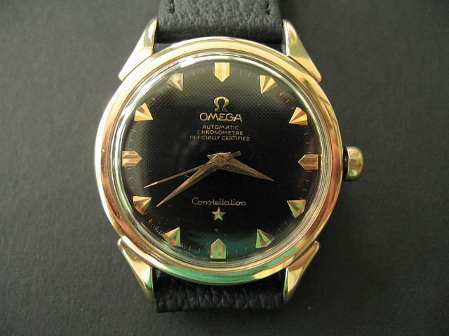

No, there are exceptions with various Omega models. Like I indicated, the problem here is the minute track. It should look like watch A. Not like the subject watch B.
You will not find these arrowhead Constellations with tracks behind the arrow points if the dial is original/ not refinished.
A.
B.

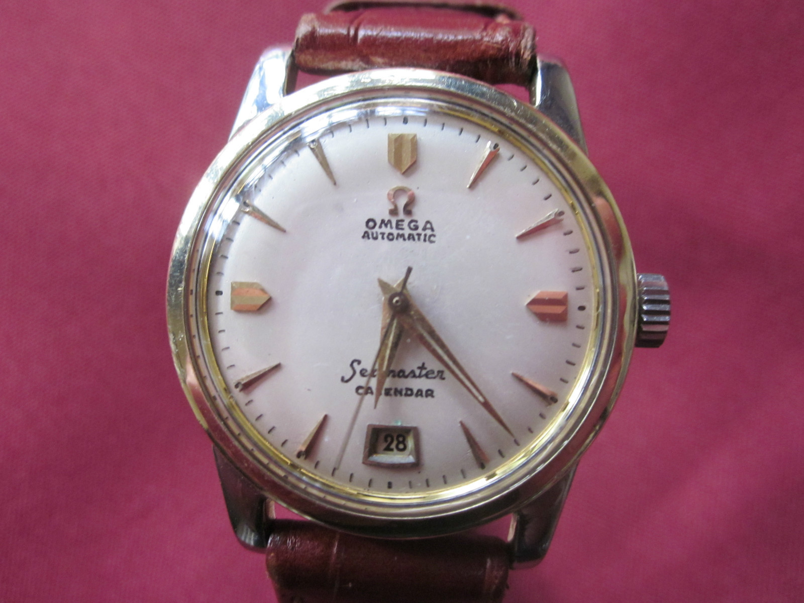

18,864
39,238
It is a bit different, but it's not a redial. It looks genuine to me but I wouldn't offer more than $800 for it, even though it's in great condition.
