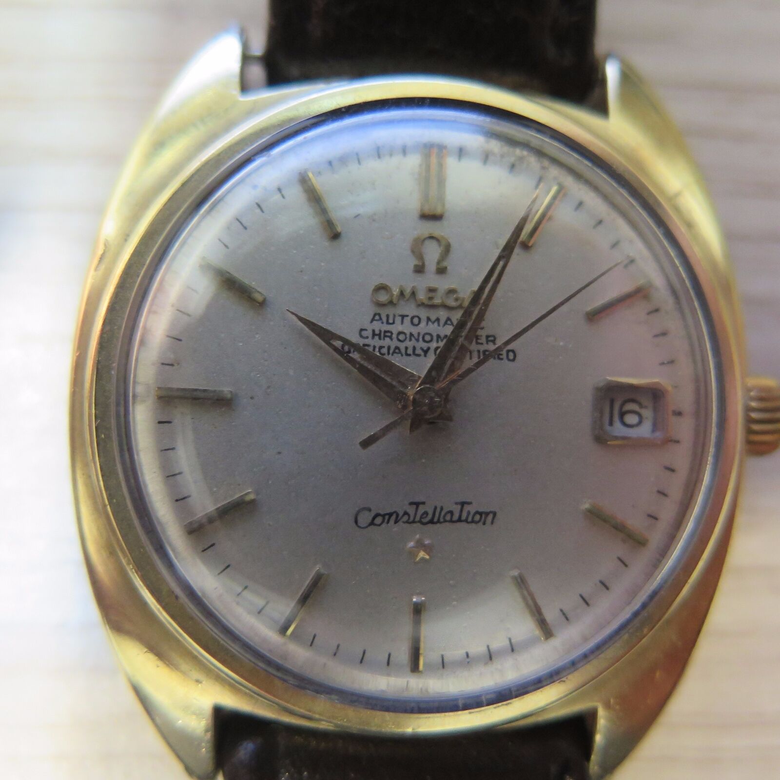

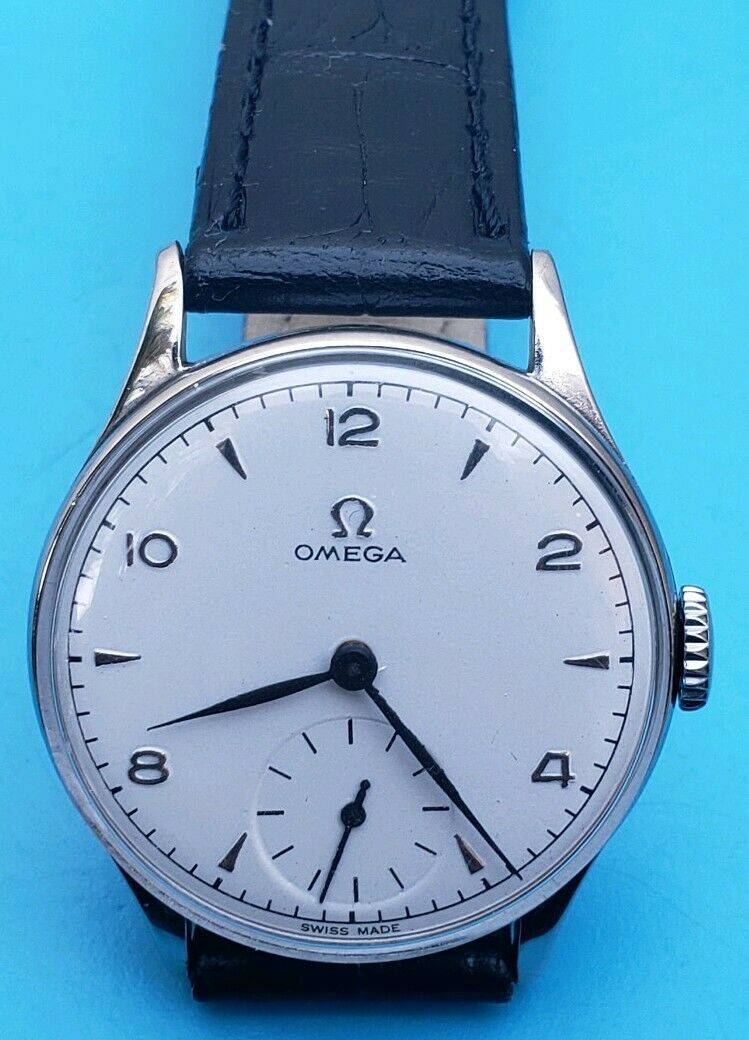

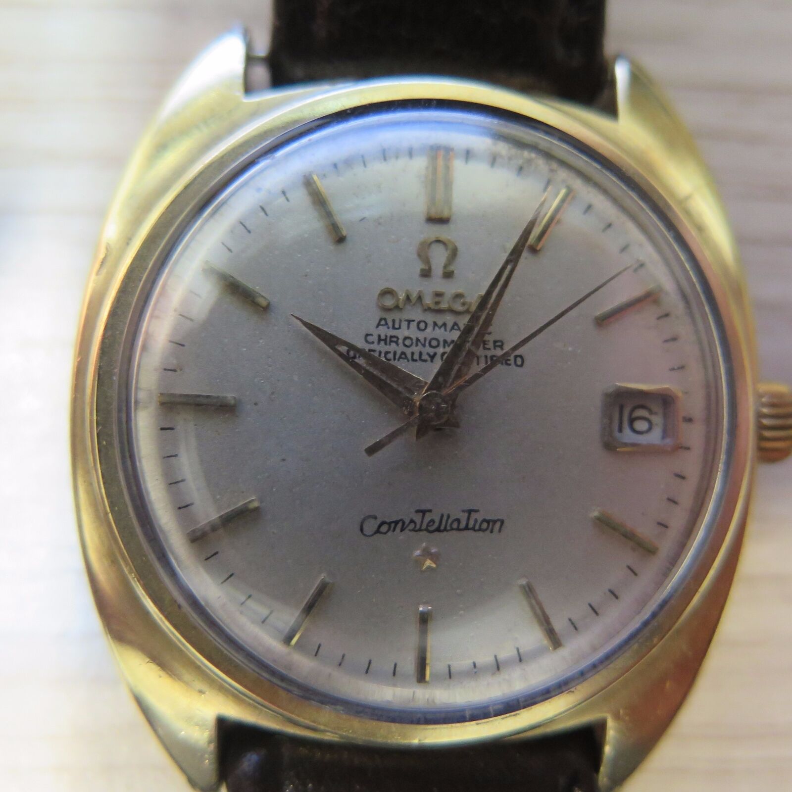

This is up there as one of the worst Constellation redials I've seen to date.
You mean Omega didn’t use Helvetica???
1,787
2,000

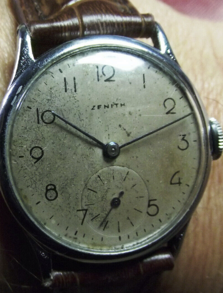

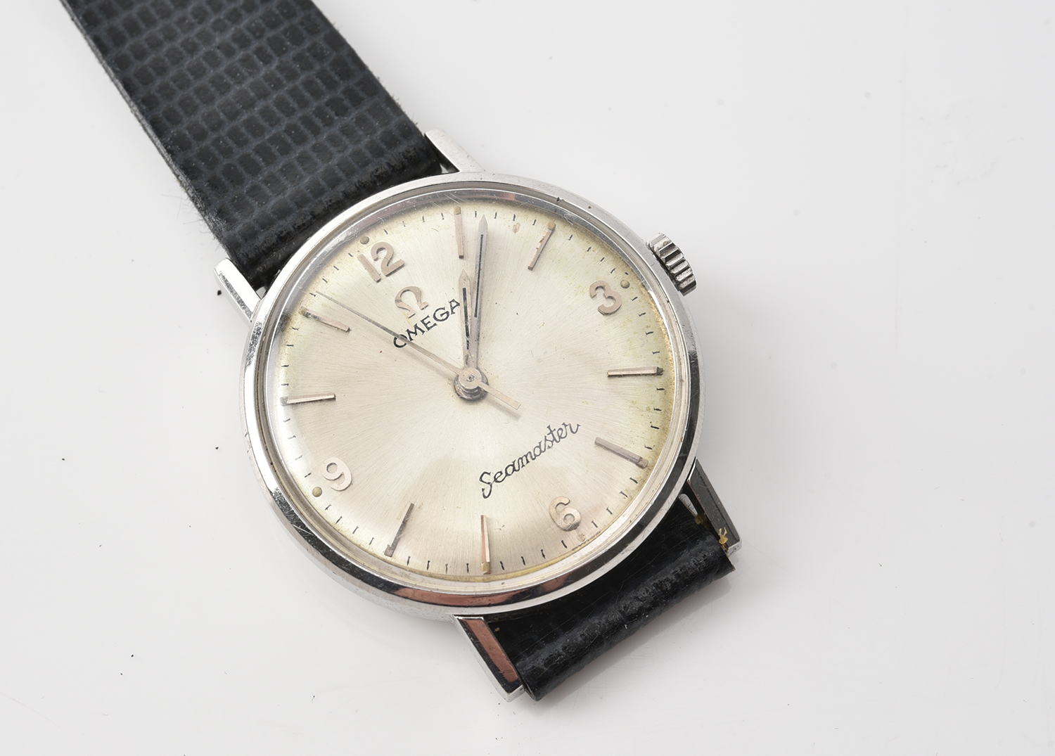

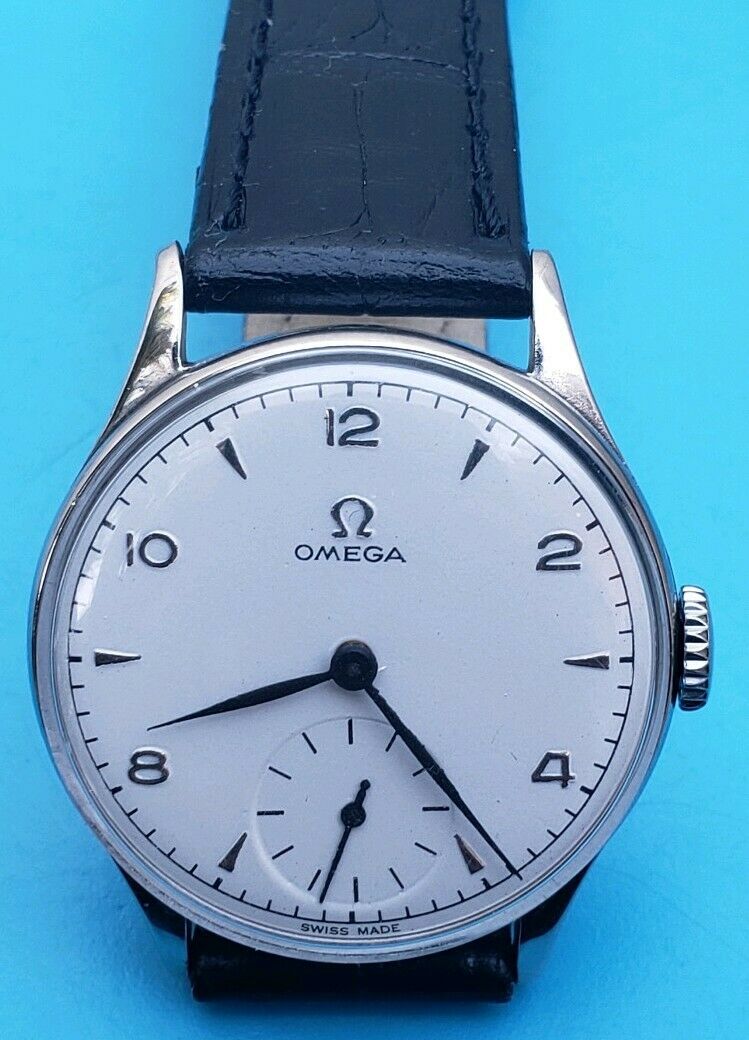

Cool config. What’s wrong with it?
It has been repainted. See the shiny white paint creeping up the sides & onto the tops of the dial furniture? Especially the 10, 12, & logo.
There may be some paint on the side of the minute hand, hard to be definate.
Also the edge of the subdial has no sharpness, due to paint infill.

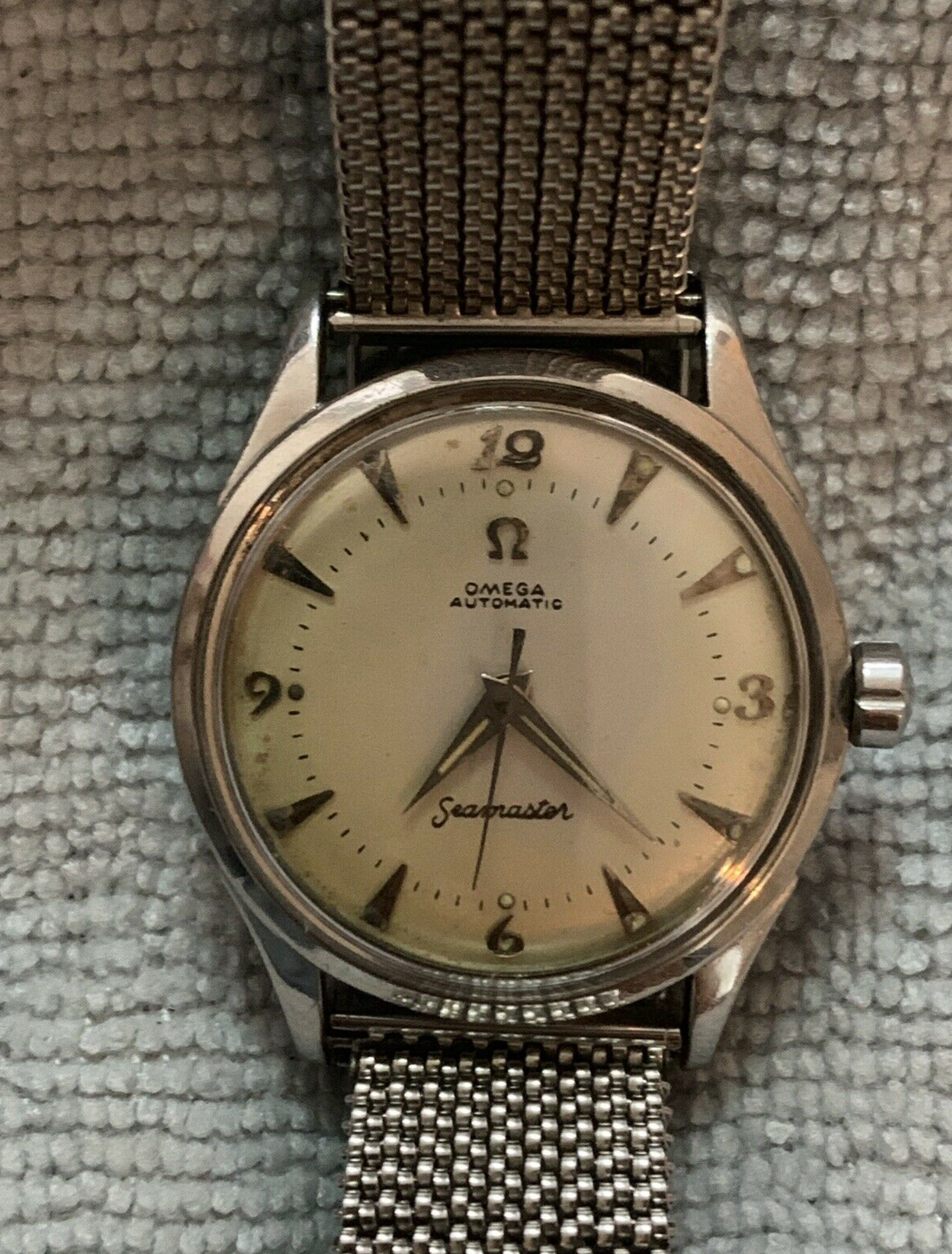

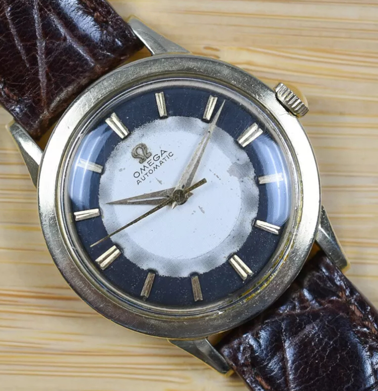

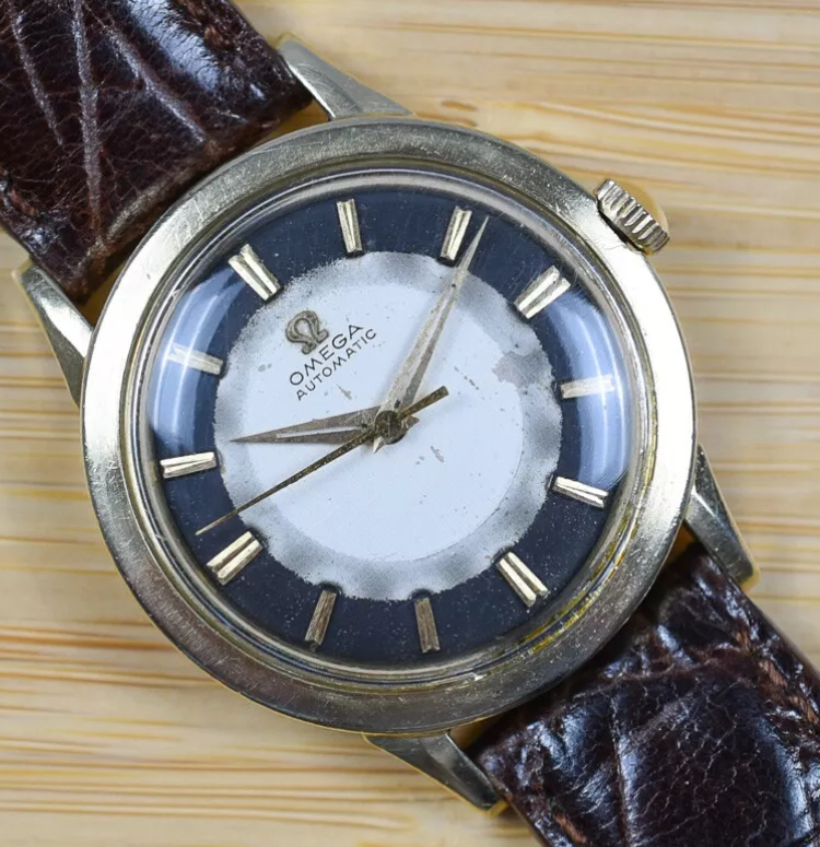

I just was about to post this ultra rare Sea Urchin Omega. This may be the winner for creativity.
Looks kinda like an oil stained pizza box

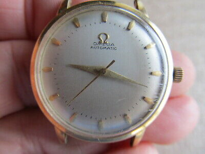

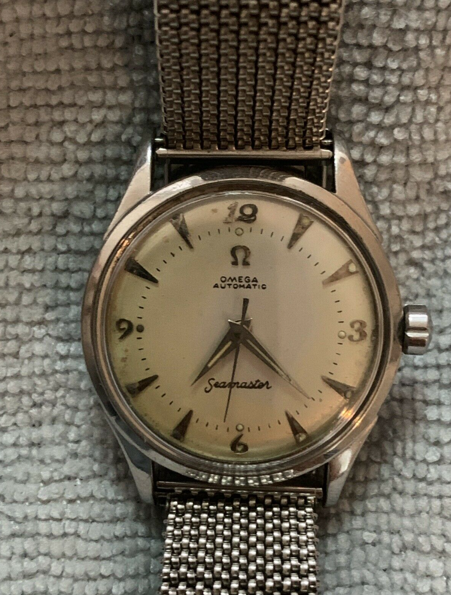

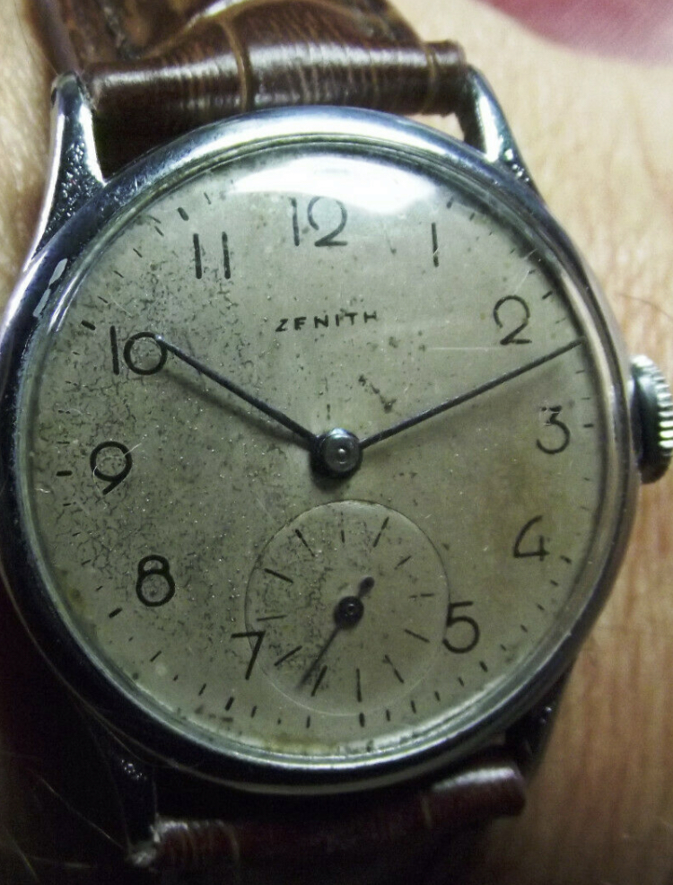

Not Omega but really bad
Watch is in GOOD working order, all original. Rare in this condition. Keeps good time.Guarantee as described!
16,305
45,031
That hurts ……… 🫨
Those fine point Sharpie’s are amazing! Look at how small they can write.
