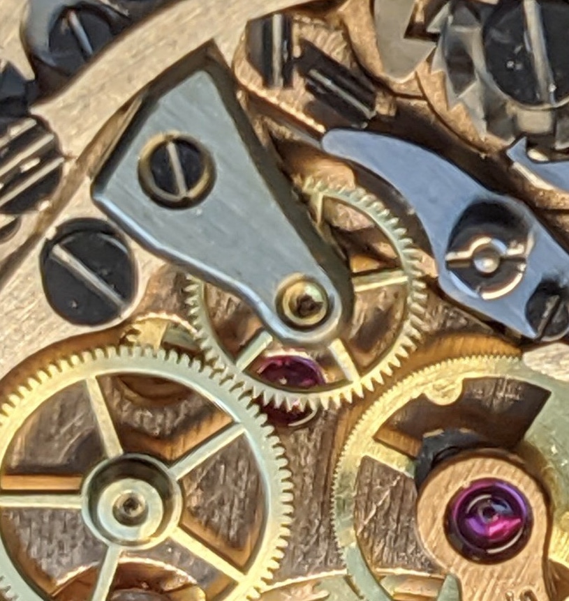

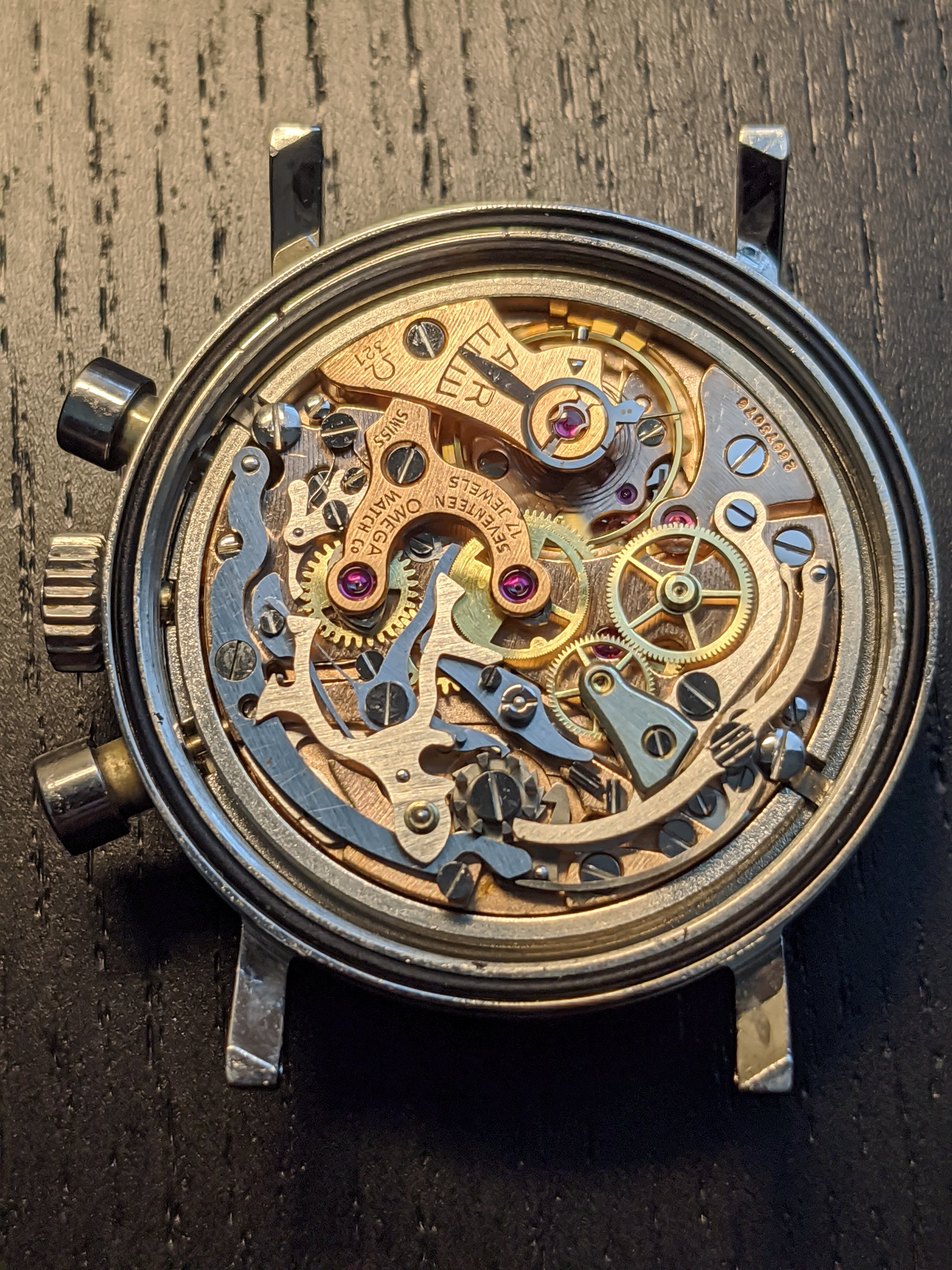

I have an issue with a 321 Seamaster I just acquired where the chrono hand stutters/stops as it goes around the dial.
When I look at the movement through a 25x lens I can see the coupling yoke moving the coupling wheel into the chrono runner but the coupling wheel slows/stops occasionally, leading to the hand problem. The small second hand gear seems to turn smoothly so I'm wondering if the coupling wheel is loose in the yoke and/or wobbly? Is there meant to me a jewel holding in the coupling wheel as when I look closely to the center of the coupling wheel shaft (top of) all I see are what looks like 3 weld/braise dots.
Thanks in advance to those knowledgeable 321 folks & pros for helping out!

It does look like the bushing in the coupling yoke in your watch is enlarged or misshapen.
Yours

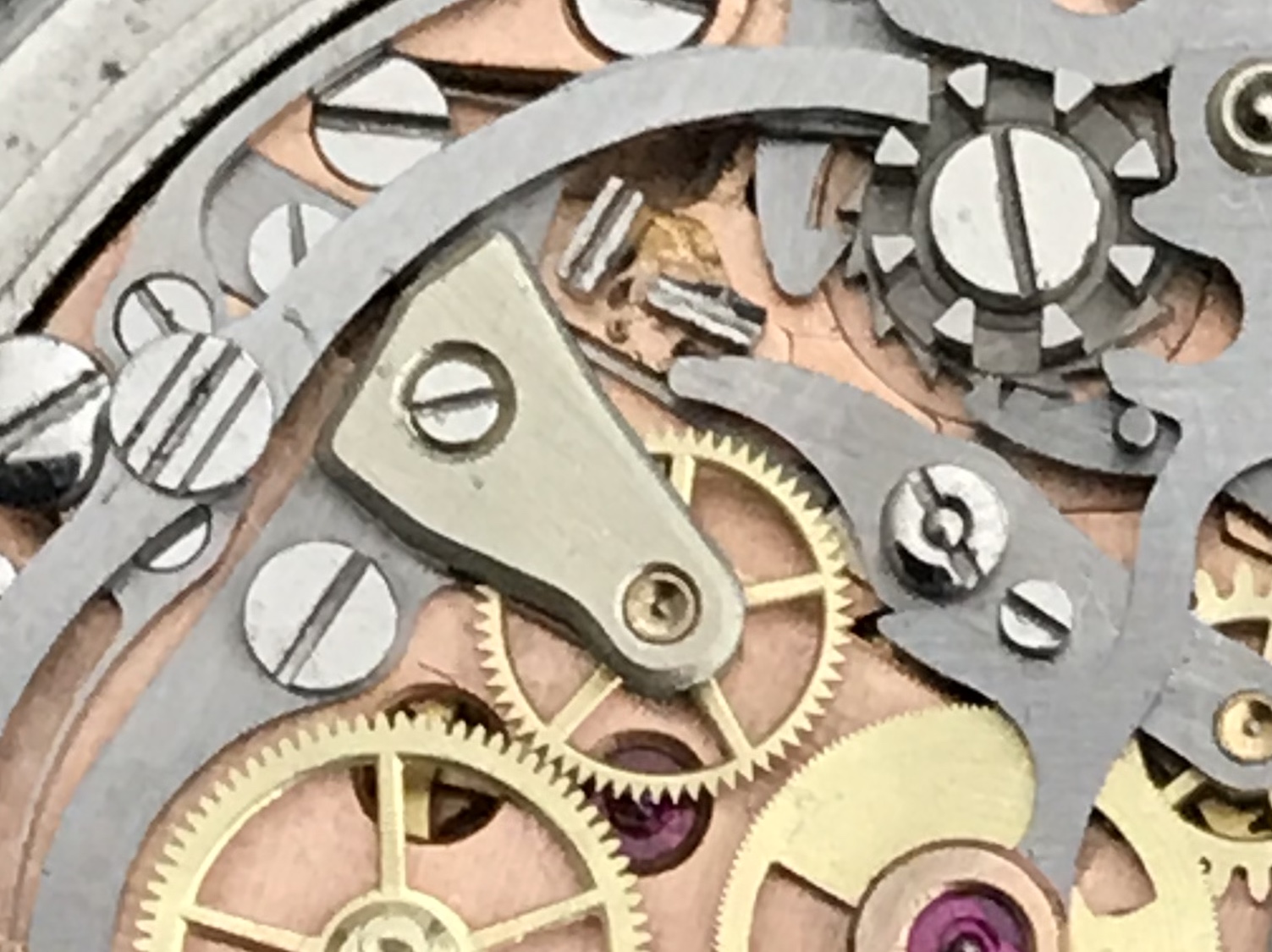

One of mine
I bet yours is a ‘watchmaker’s’ attempted repair of a worn bushing.

Can't see the detail of the coupling wheel bushing well enough to comment, but if that's worn, it should be replaced. Easy to replace the bushing with a new one.
