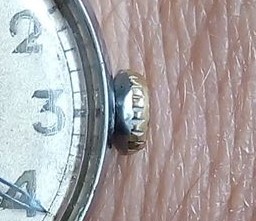

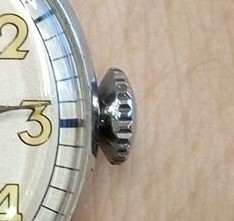

Depends how long you plan to keep the watch. You will put unnecessary stress into the keyless works, stress is proportional to strain. If you don't wear a watch day in, day out, that's probably OK, but if you plan to keep it on your wrist daily for the next 30 yrs, just take it off your wrist. These two crowns used to look the same - the worn one was a wrist-winder, the pristine one was off-the-wrist winding only. I am joking, but if your fingers can do that, then metal on metal can do much worse. Don't rely on your lubrication. All friction produces particles you don't want in your watch. I build sterile clean rooms, what I know about particle shedding leads me to take my watches off - unless it doesn't have a crown. Ultimately it's up you.
