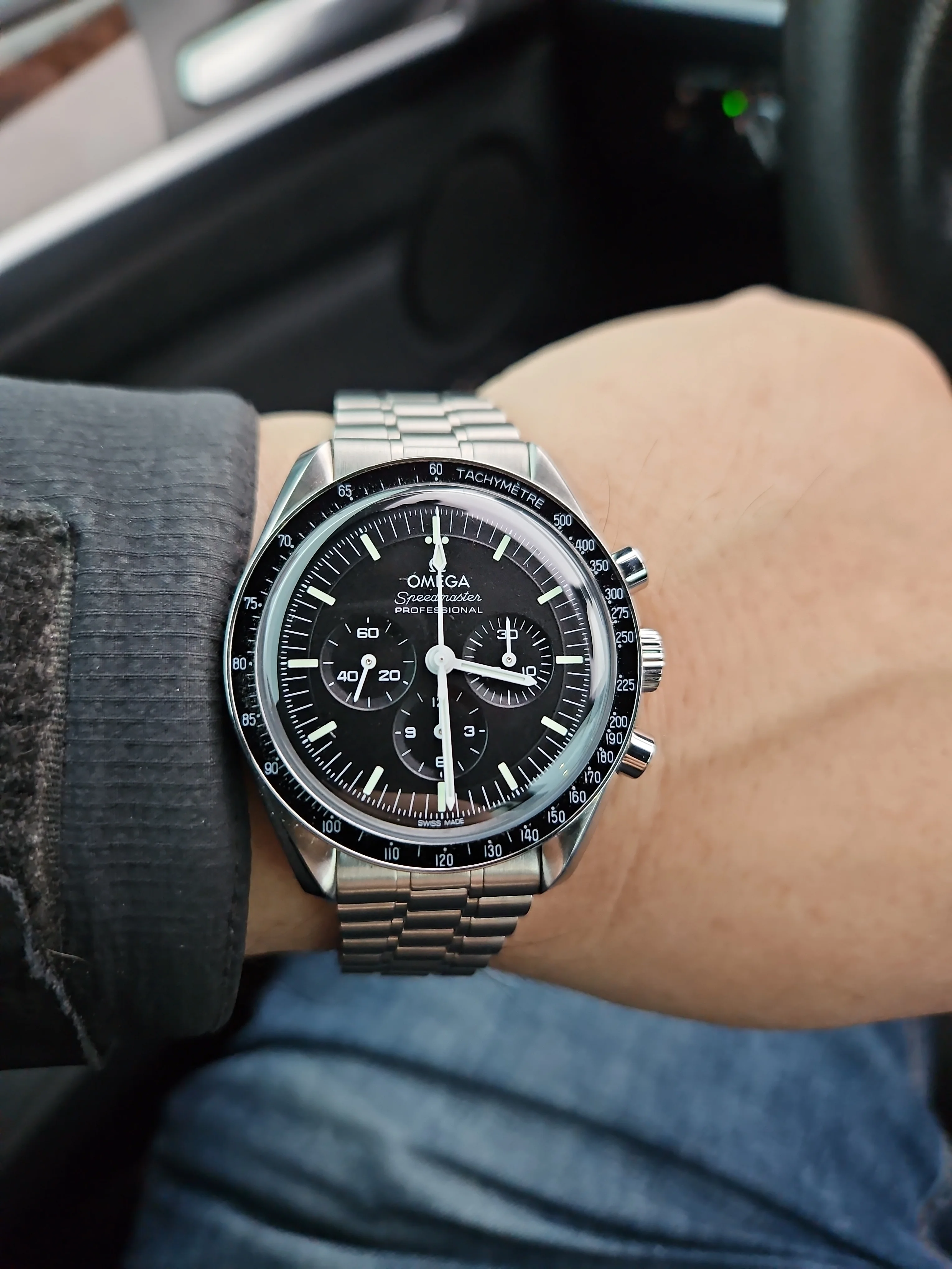

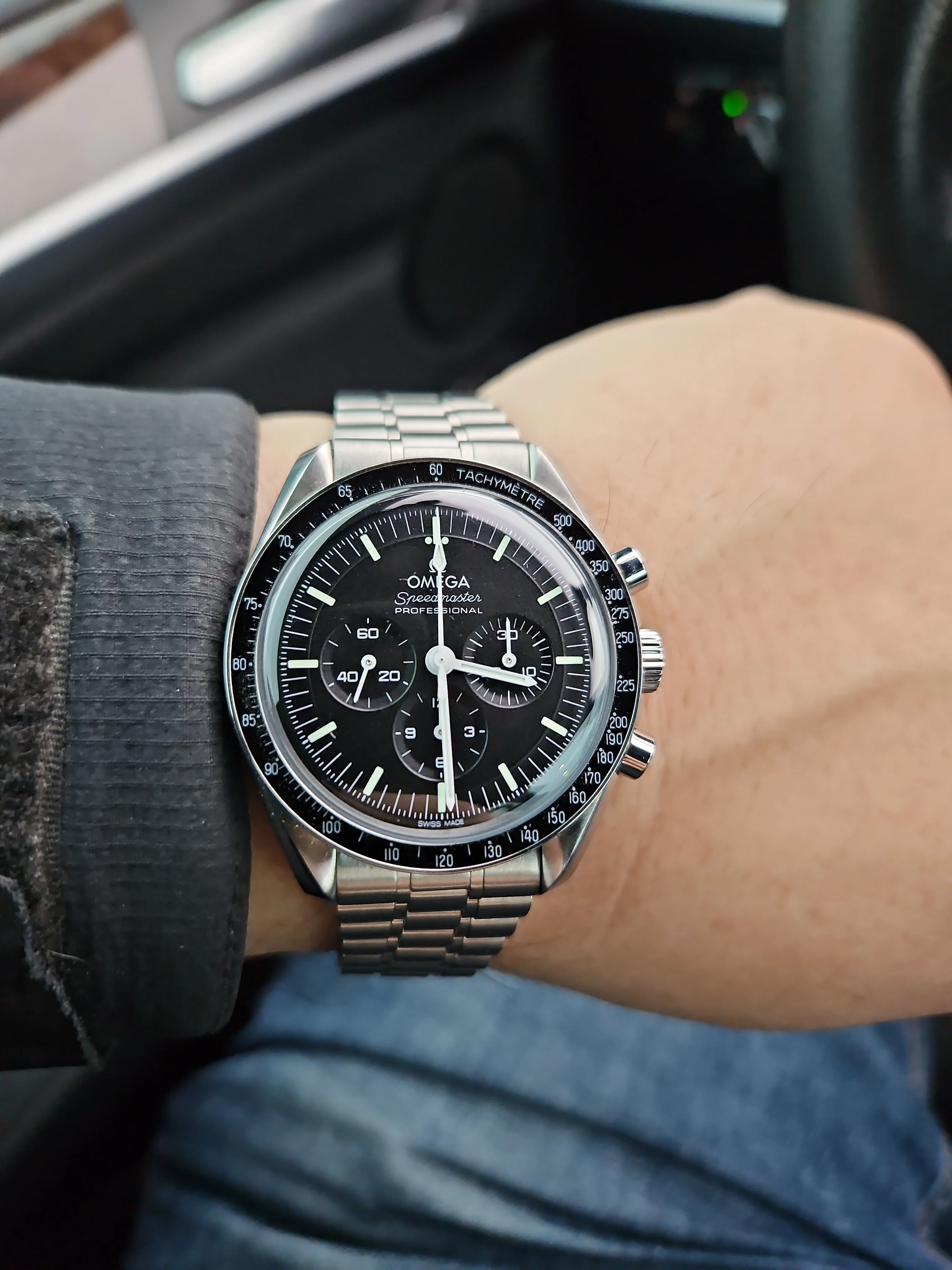

Here's what the 57 looks like on a 3861 case. No gap but the end link protrudes just a bit. But not enough for even my OCD to care.
1,574
3,141
That looks very good. Thank you.

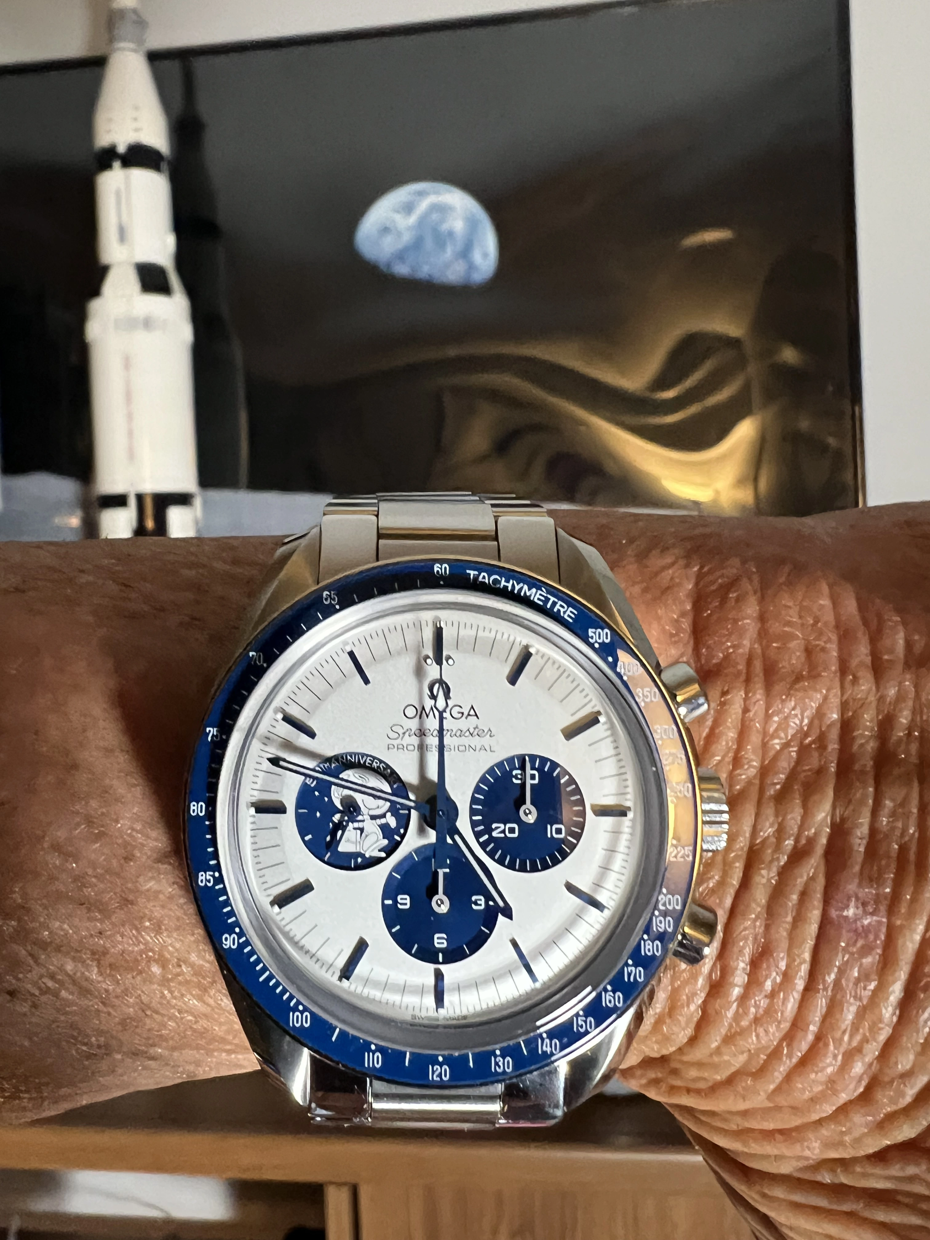

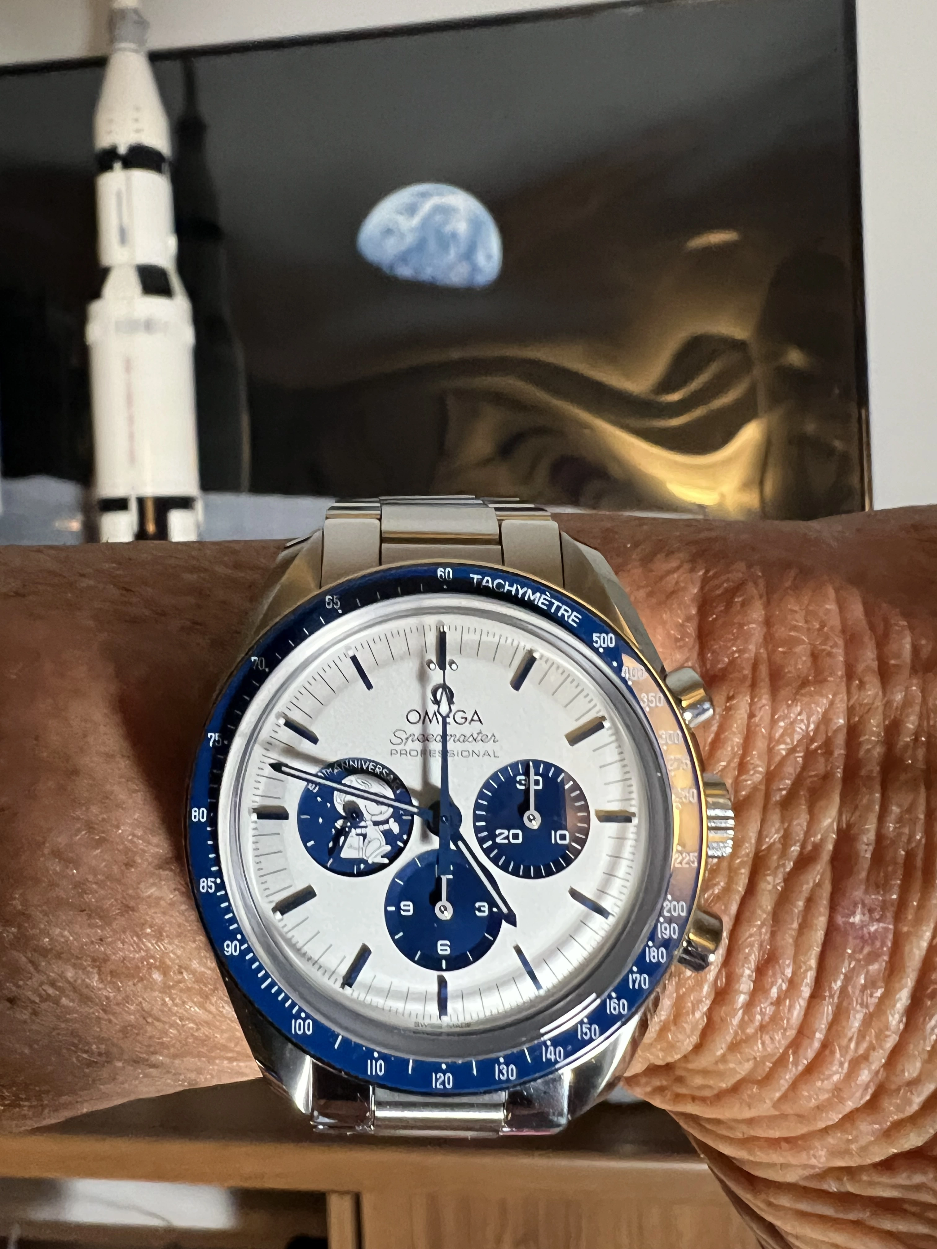

The A11 bracelet will be here in a couple weeks. They also ordered an extra link for me. Omega is pulling their watches from this store sadly. Incidentally, the nearby OB is performing quite poorly. Rolex is pulling their watches from another jewelry store nearby this one because the location isn't "luxury" enough. Jeez. They pulled that stunt with a chain of local stores near me but stopped at the eleventh hour when they found a location that pleased the crown.
Sold my 145.022 69ST for $6000 and got this one that looks very much like it for $6600. I can wear it without fear which is what I wanted.
