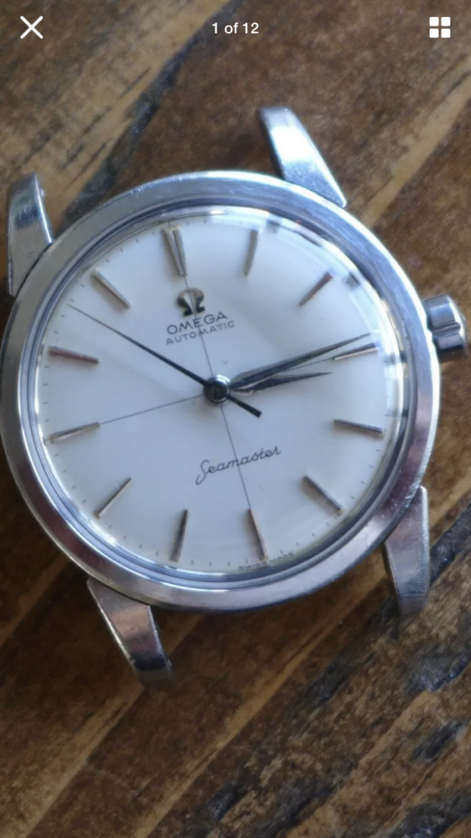

Wondered. If anyone might be able to help?
I have a 1958 seamaster 2846 and wondered if an early 60s beads of rice might fit?
Bracelet stamped 1444. Ends stamped 80

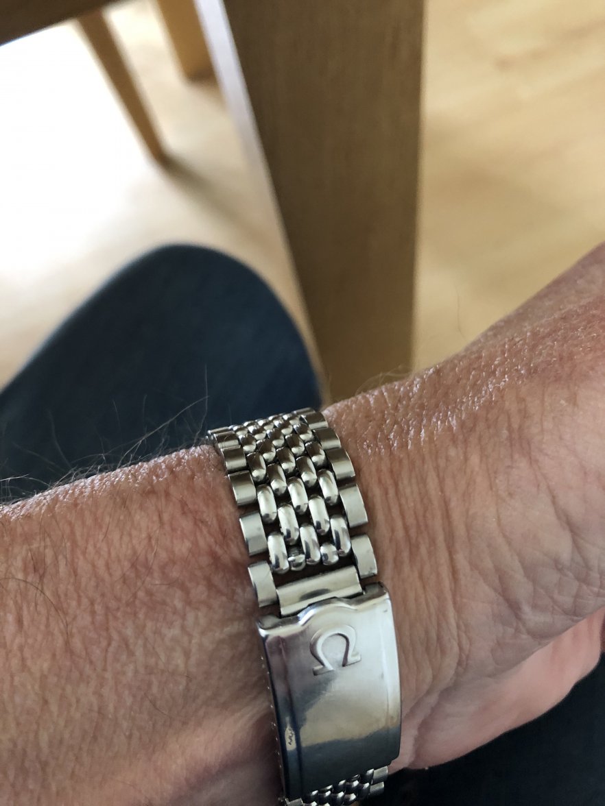

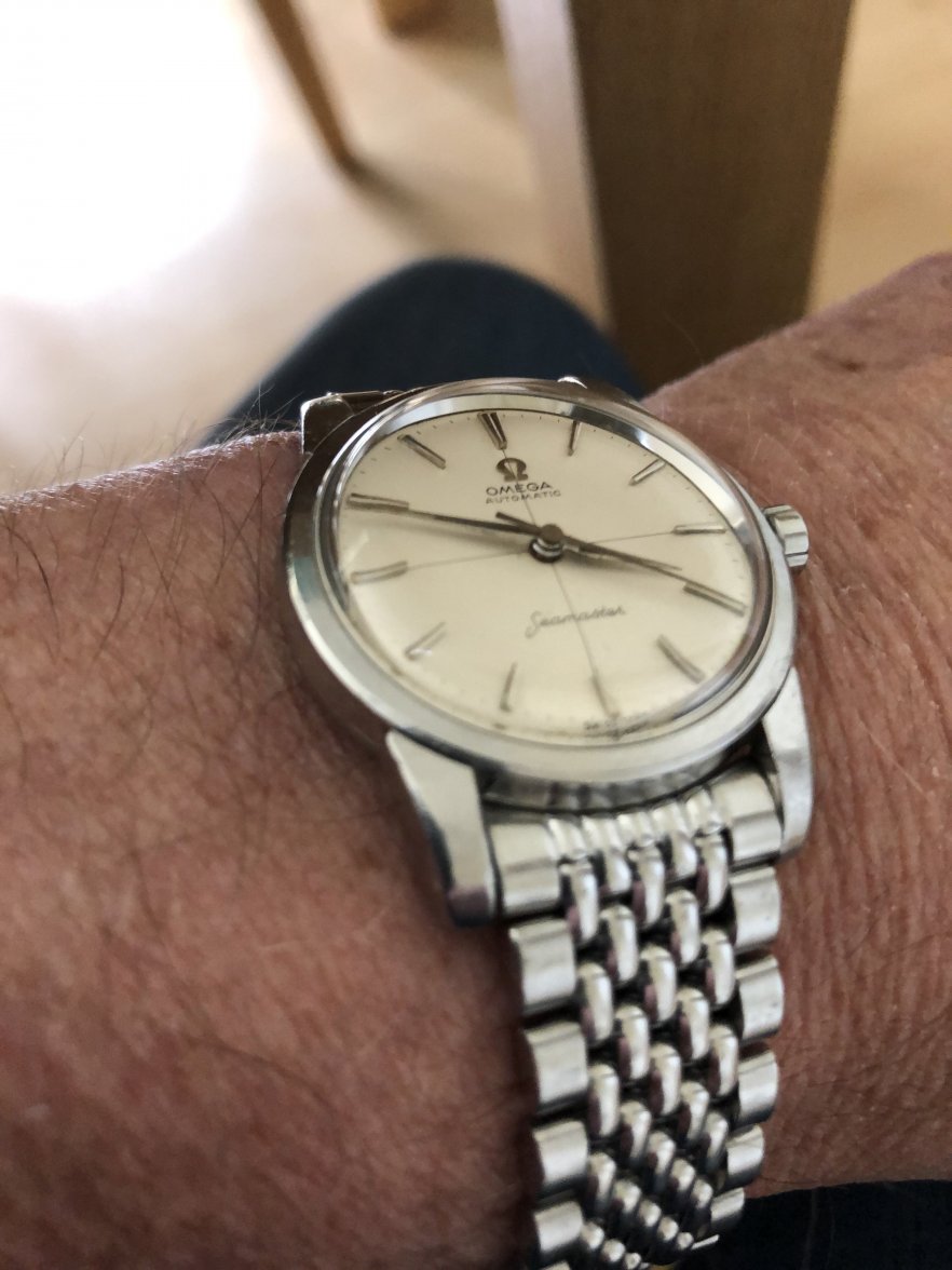

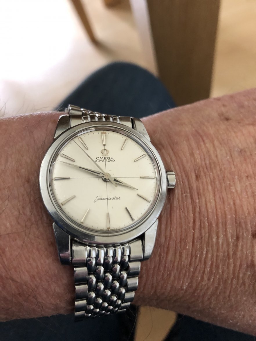

Happiness is a Seamaster now happily united with a fabulous beads from @NoMercy
Many thanks for all that helped
It is much appreciated
1,501
5,694
Great combo! Wear it in good health.👍
