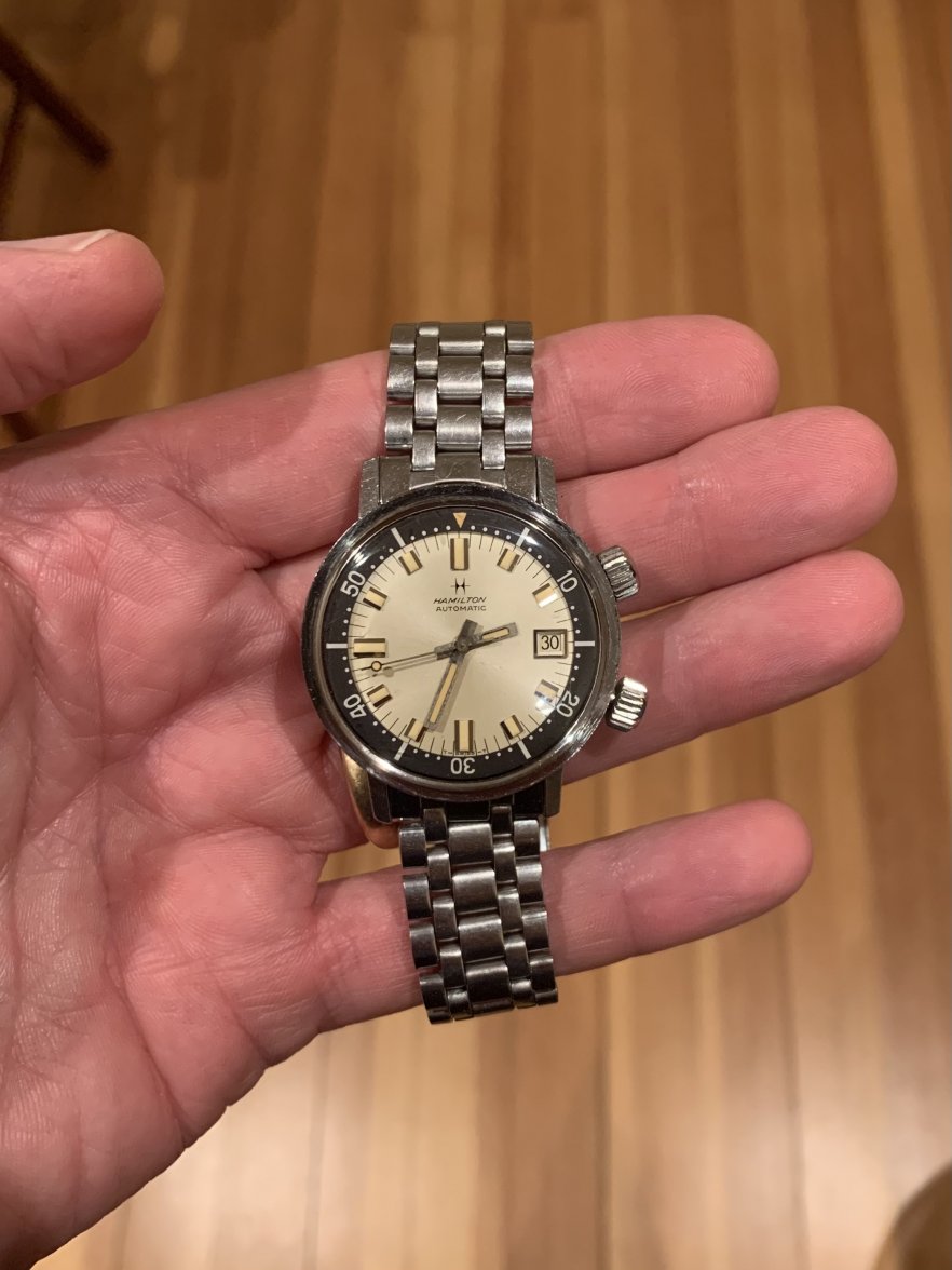

Just acquired this watch with claim it had been recently serviced (yes, I know) and it’s running incredibly fast.
Second hand makes it around in 48 seconds. Timed over an hour and it gained 12-13 minutes. That’s fast!
It’s in beautiful condition so may decide to keep it.
Any guess at what’s going on? Is it conceivable that something happened in shipment to cause that? I’ve never had a working watch that ran so fast.
Thank you.

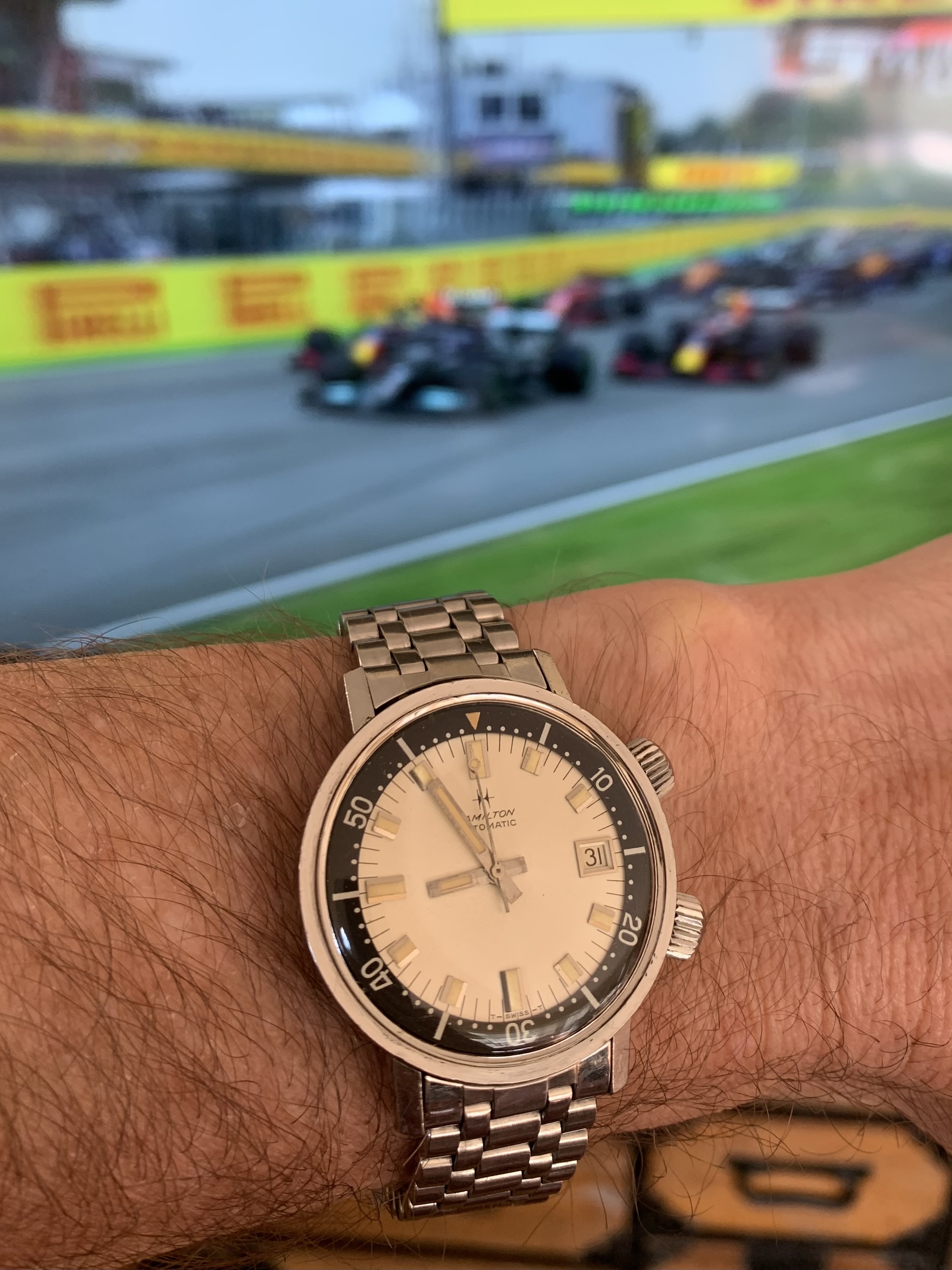

These 36mm Super Compressors wear perfectly. I know we have a few collectors of the 42mm but those to me would seem massive.

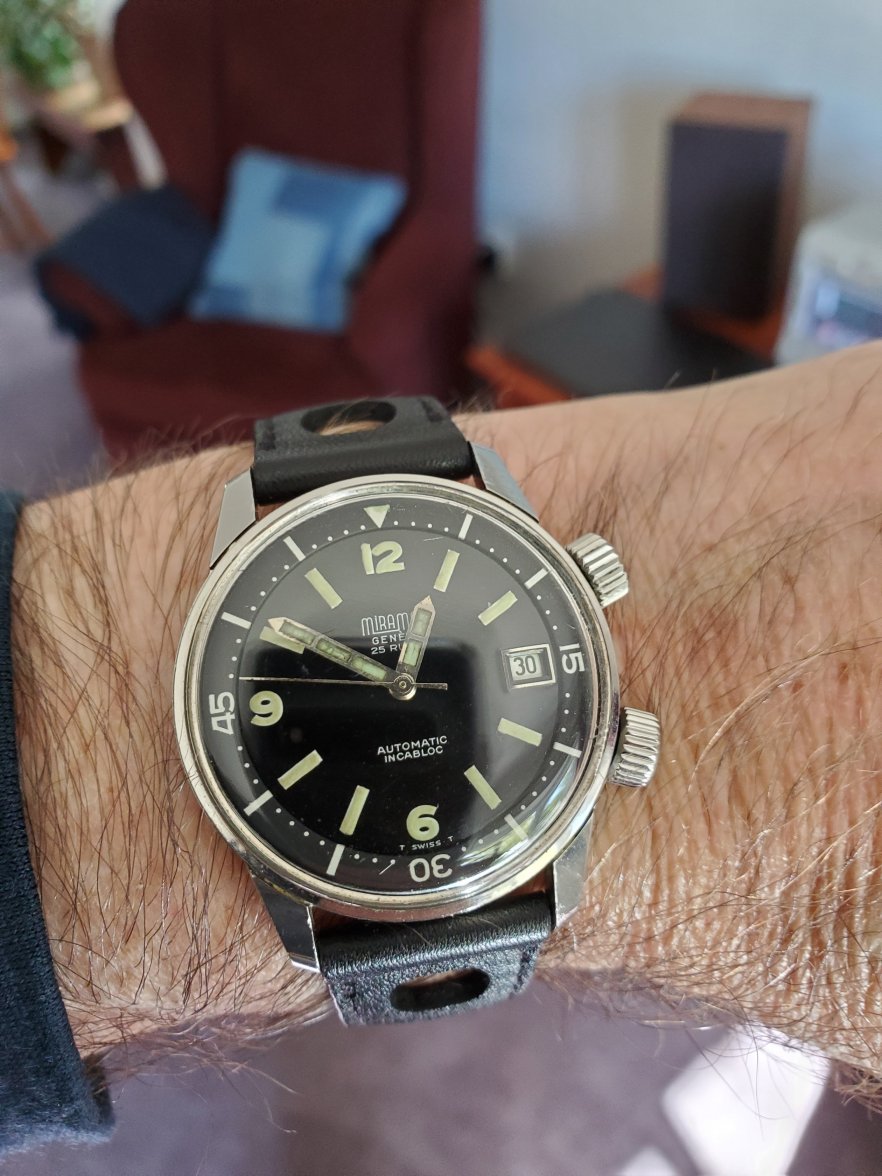

36mm is the best size EPSA case IMO. I settled with a secondary brand as the major brands like Hamilton have really shot up.
