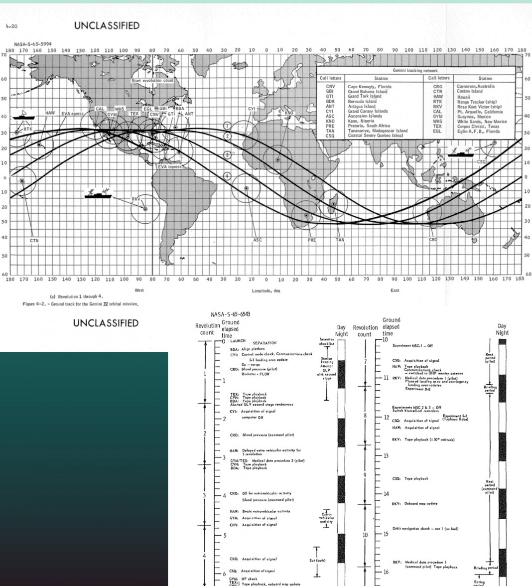

They did have a lot to deal with - crossing many time zones, tracking stations and planning activity around rapid day/night periods, specific locations and ground elapsed time (66 orbits in four days).
4,719
17,867

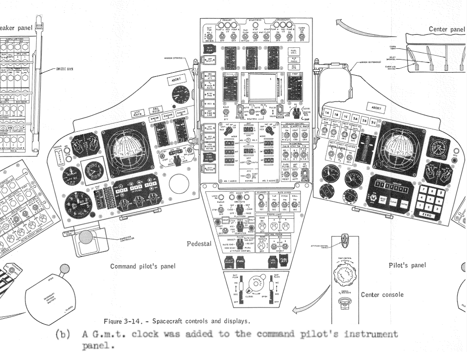

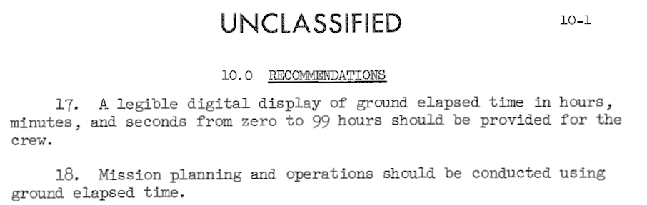

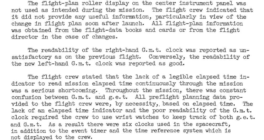

There were other clocks on the space craft aside from watches - but clearly the watches were very important. Findings from the mission recommended improvements to the instrumentation (an extra GMT clock had already been added to the pilot console for the Gemini 4 mission)

They used GMT and military (Alpha time) which is GMT+ 1 as well as GET (Ground elapsed time). There was some confusion which, looking at the orbit charts already posted and time chart below, is understandable. This was also increased by a mission delay of 1:24 hours.

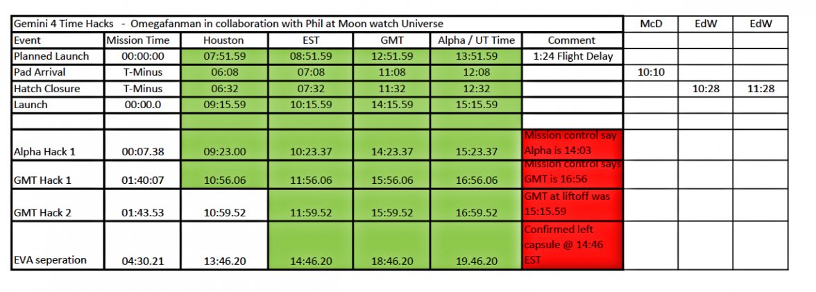

This time chart appears to show some errors - GMT times mixed up with Alpha / Universal time. Also an incorrect Alpha time call (which could also be a tape/transcript error). Taken from enhanced photos the chart also shows the 'estimated' actual times from the worn watches. This would seem to indicate they were attempting to set them for GMT and Alpha time + use a watch Chronograph for GET time

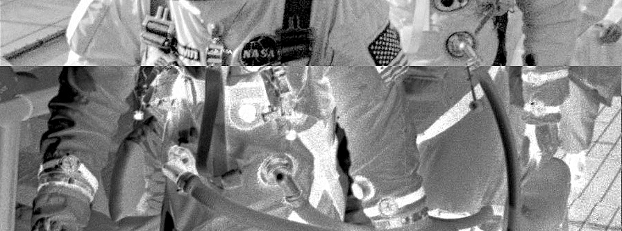

Too many posts I know - (I am taking up your time) but the devil is in the detail. Here are some reduced quality versions of the actual wrist shots (thanks again @SpeedyPhill for the help and collaboration on this).

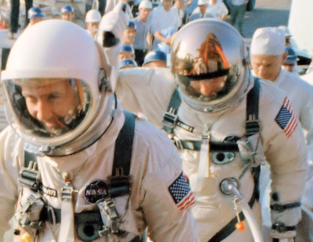

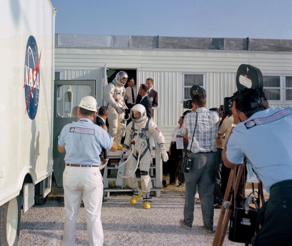

Indeed, the transcript showed the crew was awakened at 04:10 EST followed by breakfast and physical examination...
After suit-up in the trailer at Pad 16, the astronaut took the little NASA van to launch Pad 19 where they arrived at 07:08 EST...
A few minutes later both astronauts were met by a crowd of technicians & journalists, and photographed several times while walking up the ramp to the launchpad at 07:10 EST while McDivitt lefthand Speedmaster was at 10:10
... walkout up the ramp of launch complex 19 sequence photos are very interesting 😉

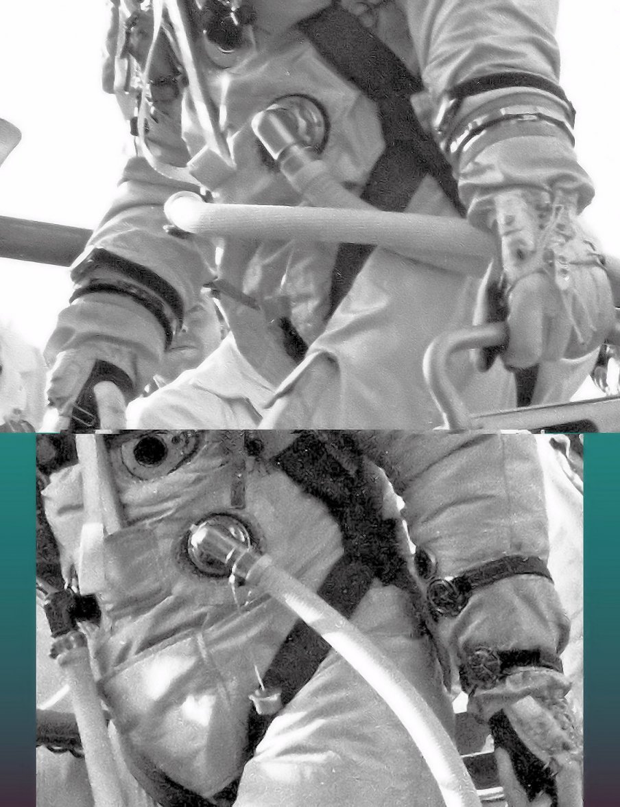

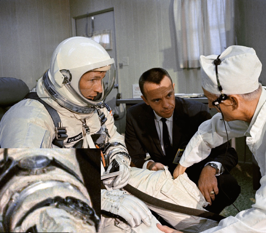

Unfortunately, we didn't find NASA photos of the watches being put on the spacesuits of both astronauts... on launchday June 3, 1965

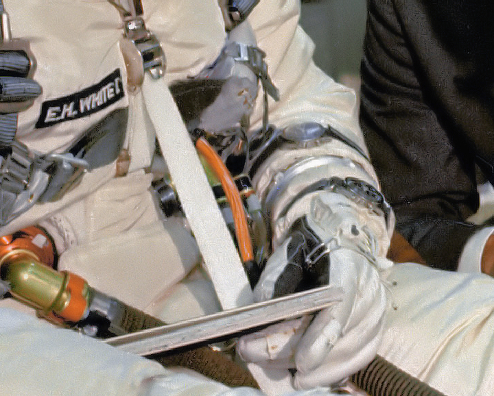

The first NASA photo clearly showing the Omega Speedmaster chronographs is S65-29646 showing Alan Shepard talking to Ed White & suit technician Joseph W. Schmitt who put something in Ed's left knee lower spacesuit pocket...
Suit-up started at 05:35 EST and the astronaut left the trailer at 06:55 EST to step into the NASA van at 07:00 EST
Compared to other photos, we see Edward White was completely ready, finished pre-oxygenation to purge his body of Nitrogen, completely suited gloves attached but still without the Gold visor helmet of the Gemini spacesuit...
His wrist Speedmaster shows approximately 09:44 while this photo was taken at 06:44 EST ... the other forearm Speedmaster differs one hour !

By The Way... did You notice ?
It looks like in the photo here above, the chrono hand was running on the White's forearm Speedmaster...

Moreover, the Mission Control Center was equiped with a Real-Time Computer in order to keep track of telemetry data & mission events stored in the little computer of the Gemini capsule. As suggested by the Gemini III crew, the Gemini cockpit got a clear GMT clock at the leftside control panel of the command pilot, in this case James McDivitt.
NASA photos of the windowless Mission Control Center in Houston do not show any analog clock on the wall...
Instead digital information displayed GMT - Greenwich Mean Time ( "Zulu" time ) on a worldmap with the track of the spacecraft and the radio ranges of each of the tracking stations... so every tracking station used GMT for the whole flight !

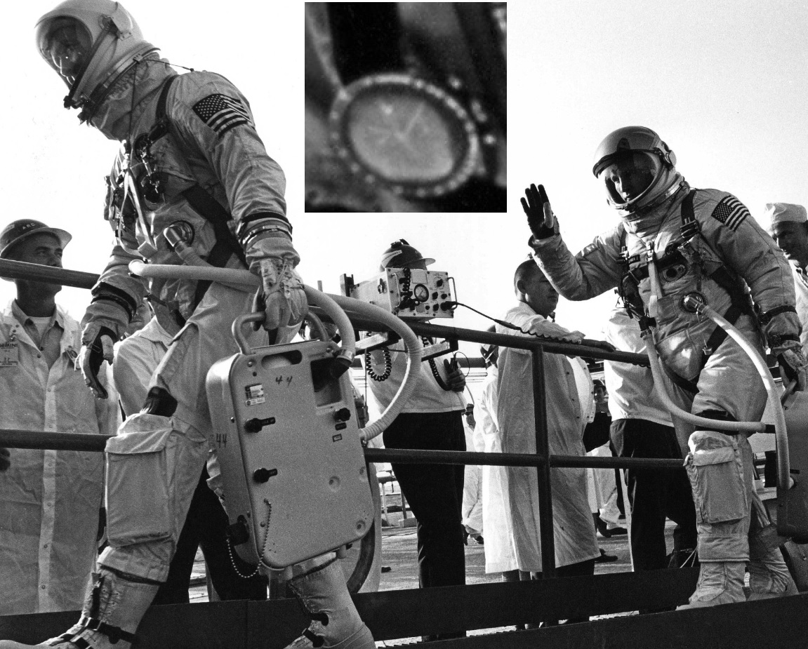

June 3, 1965 06:56 EST James McDivitt & Edward White left the suit-up trailer at Pad 16 to board the NASA van for the drive to Launch Pad 19...
Note White's helmet has the Gold over-visor clipped on... a design that would be changed post-mission to a single visual-protection visor unit.

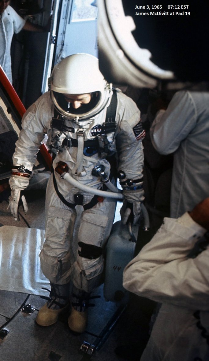

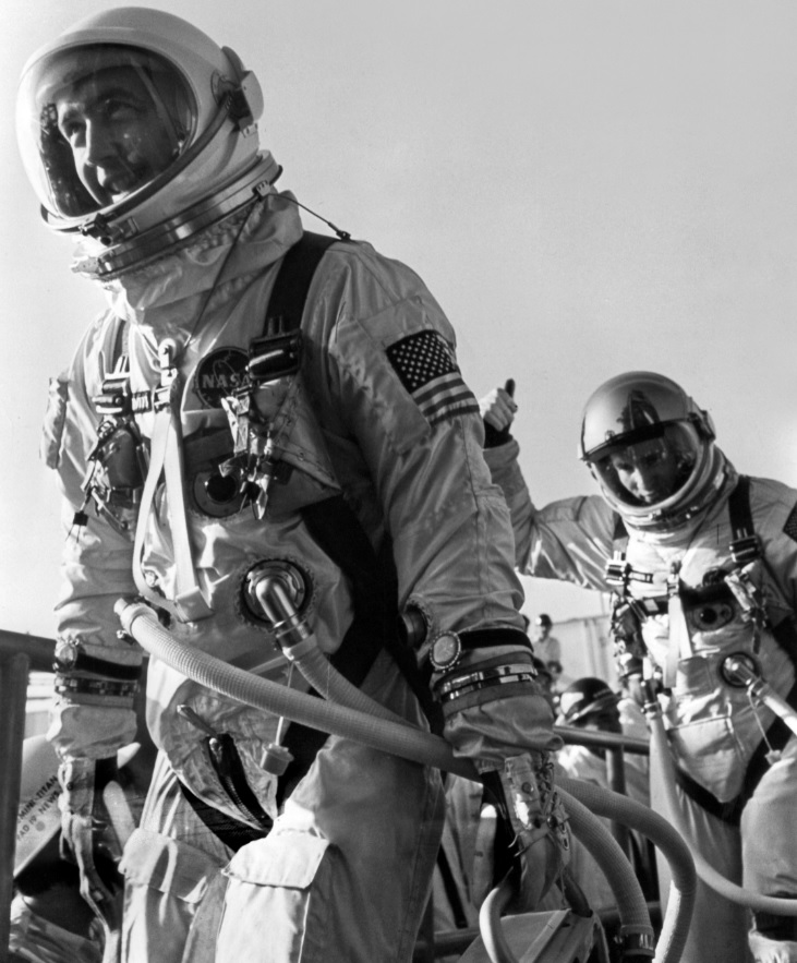

Command pilot James McDivitt arriving in the tiny "white room" around the Gemini IV capsule atop Launch Pad 19...
Note this is a June 3, 1965 launchday photo as he wore the US flag "Stars & Stripes" on his spacsuit, and 2 Omega Speedmaster 105.003
(NASA photo S65-29641)

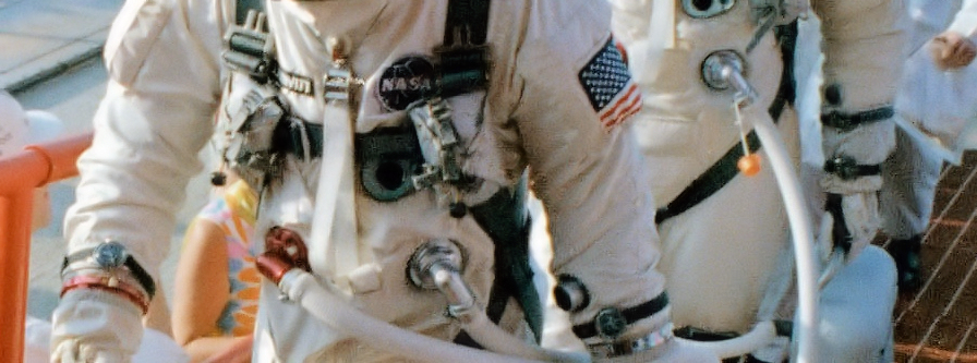

Five years ago, when MoonwatchUniverse launched the artwork commission for a "" 50 years Gemini IV "" painting, we gave full artistic freedom and the finished work became available early 2017, the artist beautifully put the hands on both Speedmaster chronographs in the laughing 10:10 position... something we could correct in photoshop so there's a one hour difference between the two NASA-issued Speedmaster chronographs.
"" 55 years Gemini IV "" and we had to update our lecture slides, etc... as it looks like these were 105.003-63
