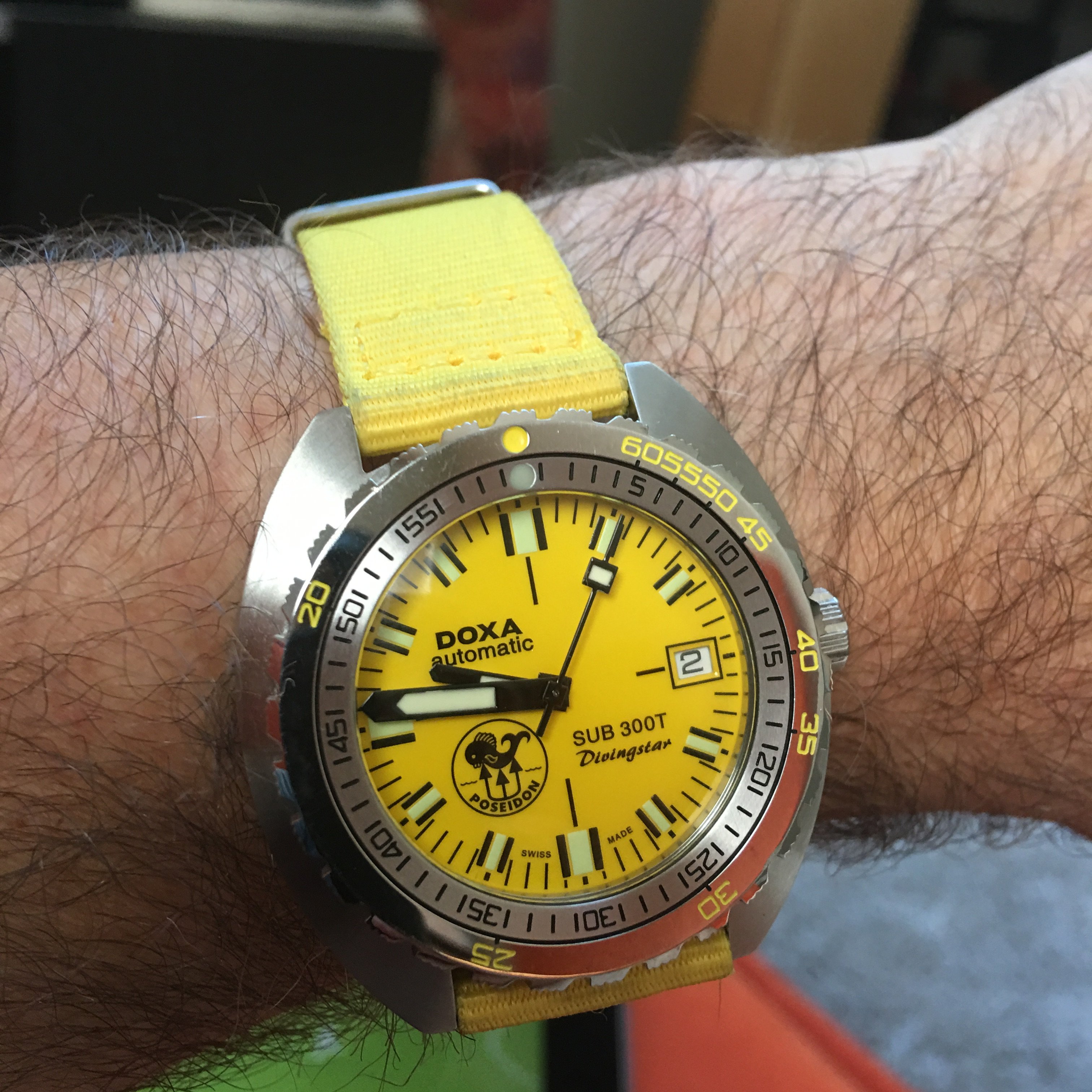

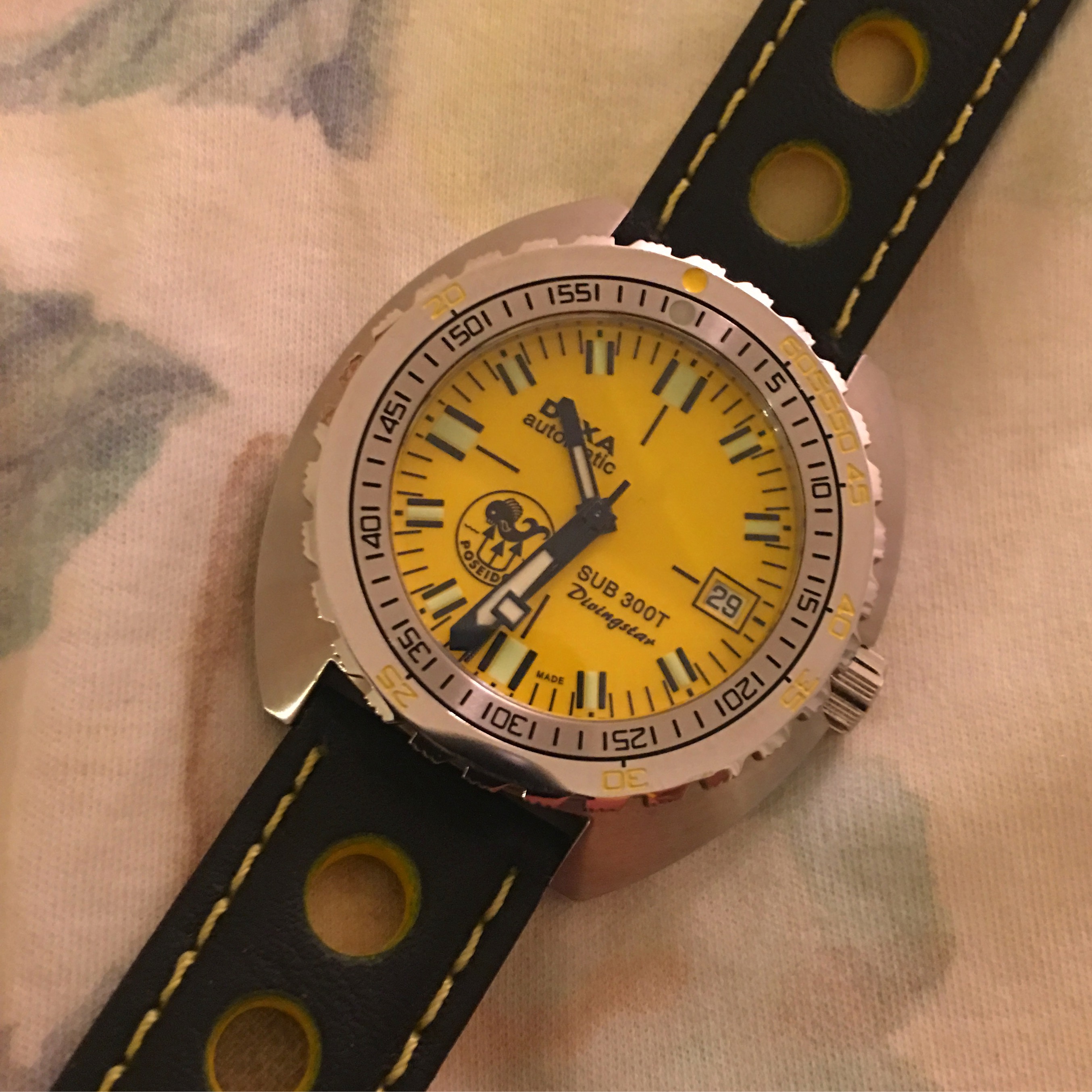

So... what do people wear theirs on? I don’t like the BoR, just a bit too bling for me, and the yellow isofrane was great by the pool on my summer holiday but tends to melt my eyeballs otherwise .... So I’m now thinking maybe black rubber with a hint of yellow? Any ideas?
2,491
6,755
Yellow Perlon for summer and black racing strap with yellow accented holes for autumn.
