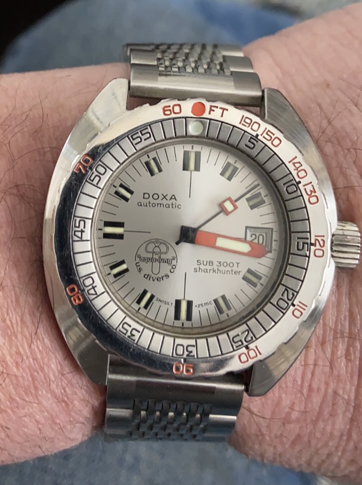

take a look at my Doxa sub 300T
another c-cased watch ...
good hunting
Bill

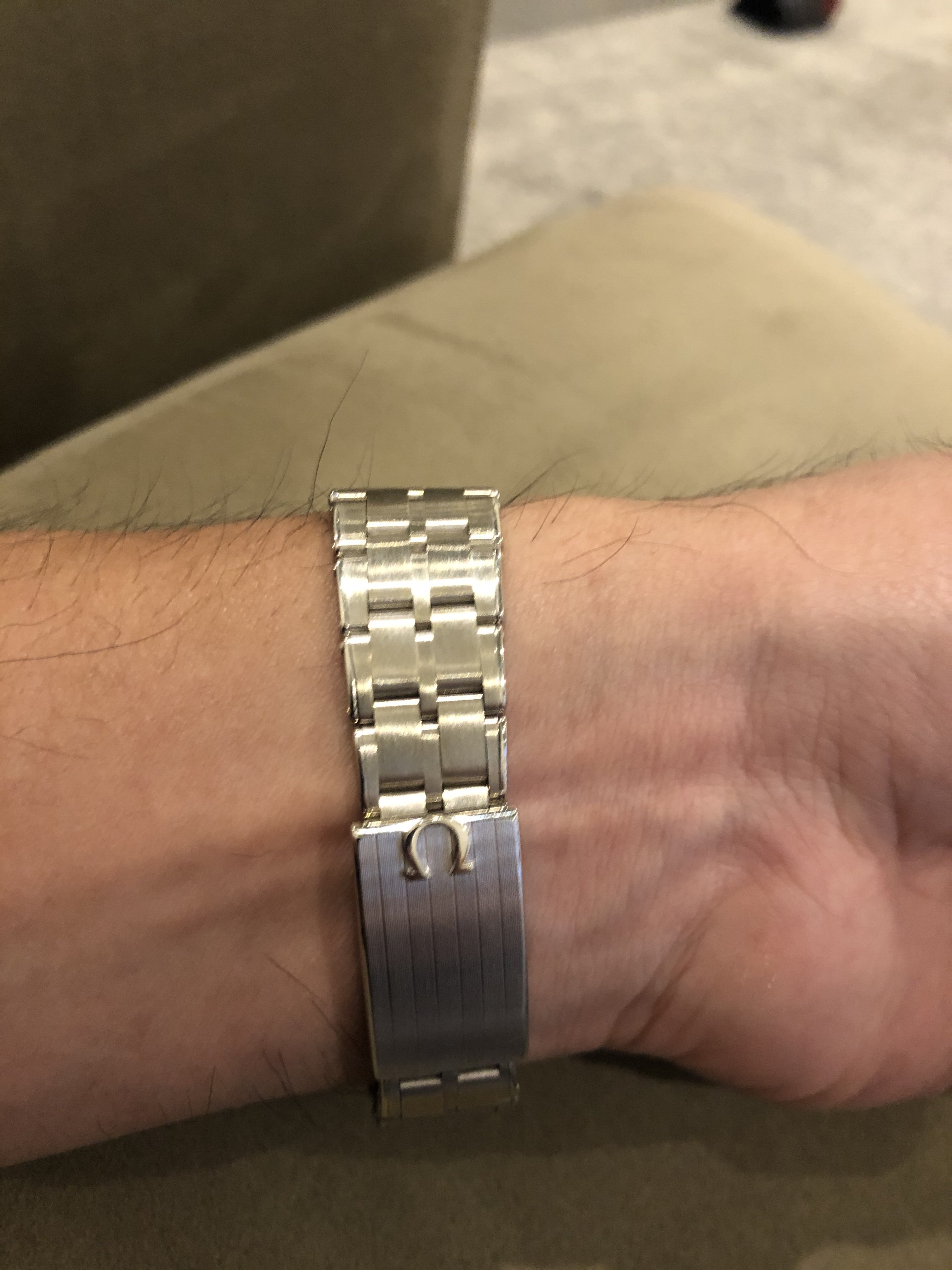

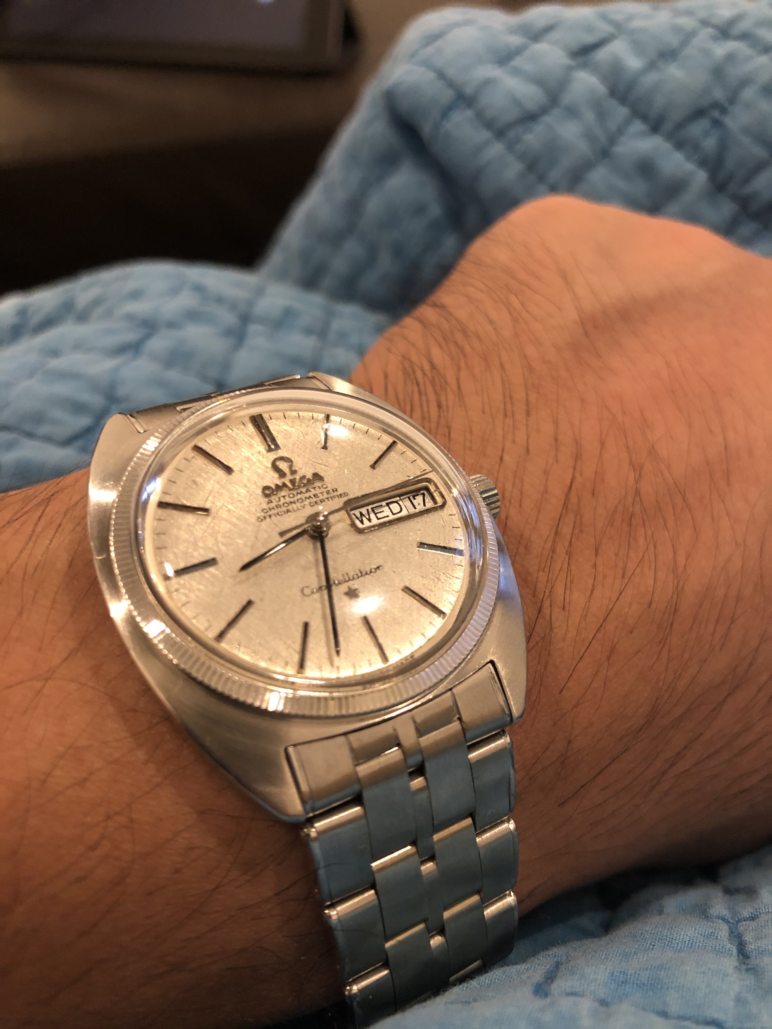

I can comment on the look and feel of white gold which is very different than steel. Once you see and feel it in person, unlikely to get the two confused. Here’s my WG C case on WG bracelet. The hue is definitely warmer and there’s a heft/mass to WG that most steel doesn’t have, especially steel watches made in this era. The thing also just glows. Gold reflects light in ways steel does not.

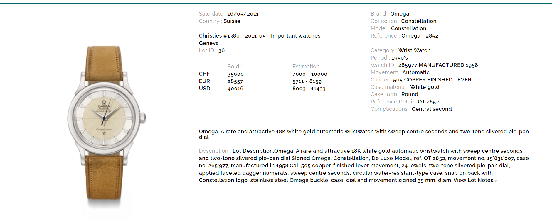

Lyre lug Constellations are rare and when they come up for sale cost a fortune, here's one from 2011, it sold for €28557
Wow, a new grail to add to the list. Still looking for a rose gold black dial constellation. Also seems impossible to find.
