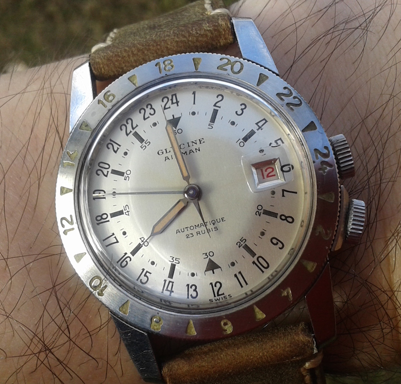

Believe Felsa was the first manufacturer to produce a bi-directional self-winding movement in the cal.692 "Bidynator". I may be wrong but it is an excuse to post a photo of watch fitted with a Cal.692.
