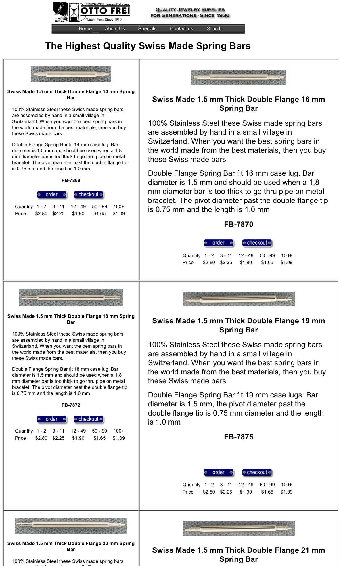

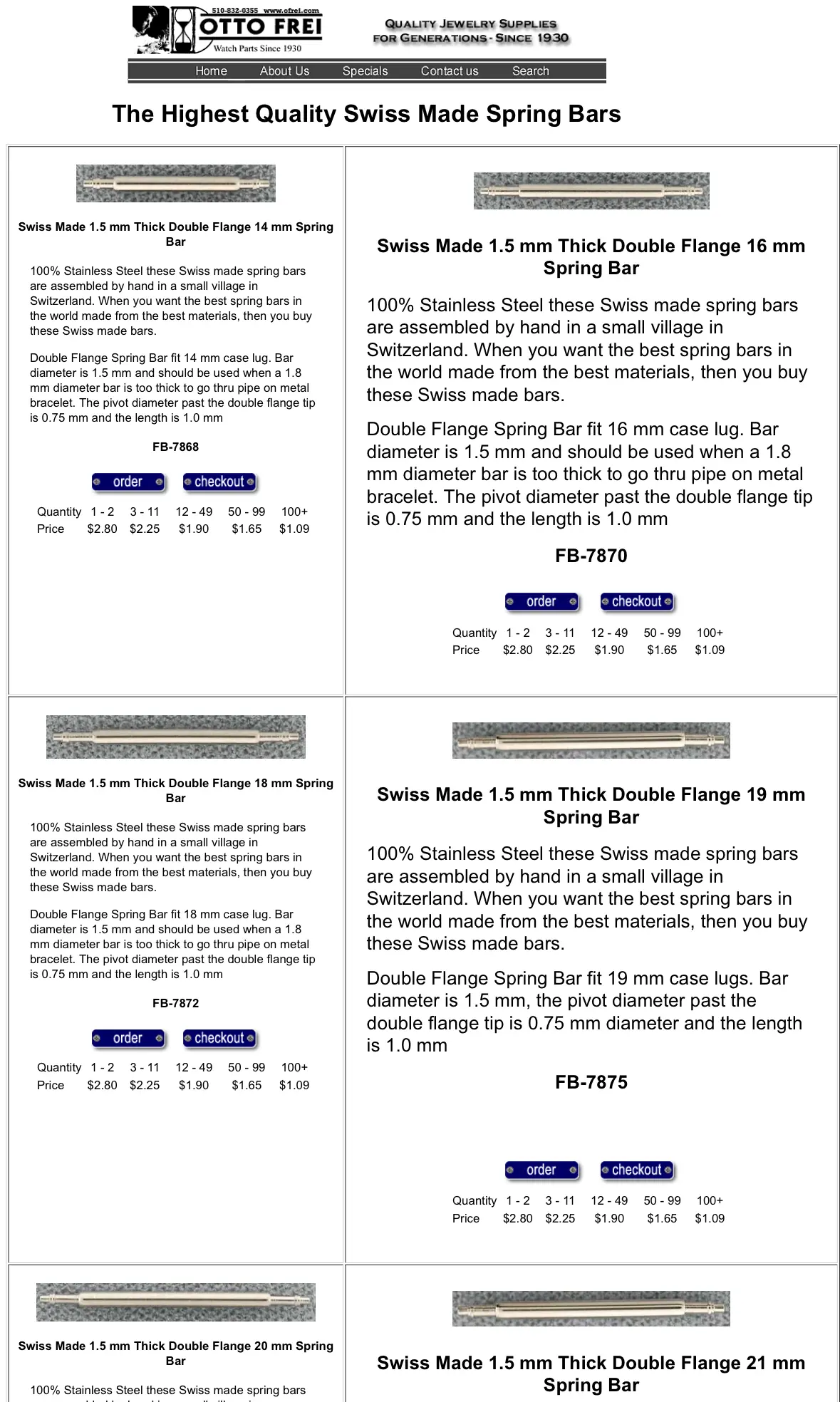

I use OEM when I can, but in instances when OEM isn’t an option, I use this selection from Otto Frei. I have also used these when I used up my last OEM bars and waited for more.
Good callout! I’ve also heard good things about Otto Frei from several watchmakers seeking occasional replacement parts no longer manufactured by the OEM.
