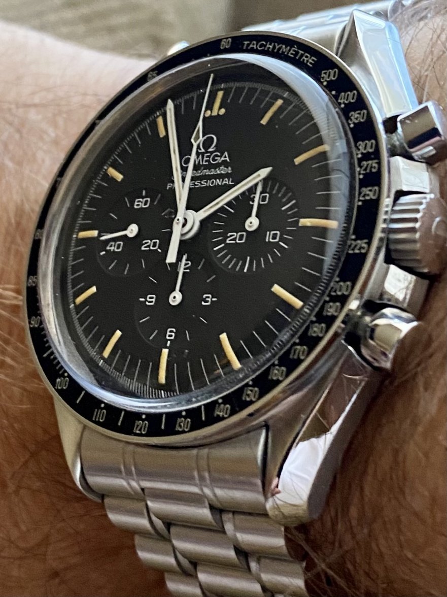

If you want a “Professional” model (a/k/a the “Moonwatch”), you’re going to be hard pressed to find something decent at under 3k. Your best bet would be a 3570.50 in the 3.5 to 3.8k range. Personally, I would save more money and go for a 3590.50 as it has the tritium d[al and handset that the 3570.50 lacks, but it will cost you at least $500 more.

thanks. I did see a 3590.50 for about $4K, My question about the tritium is: won't it be past it's half-life and not glow at all? maybe that doesn't matter or maybe it just gives a non-glow nice look???

There may still be a faint glow in the dark, but certainly not as bright as when the watch was new. The reason to buy a watch with a tritium dial, though, is for the way that aged tritium appears during the day. It’s beautiful stuff.

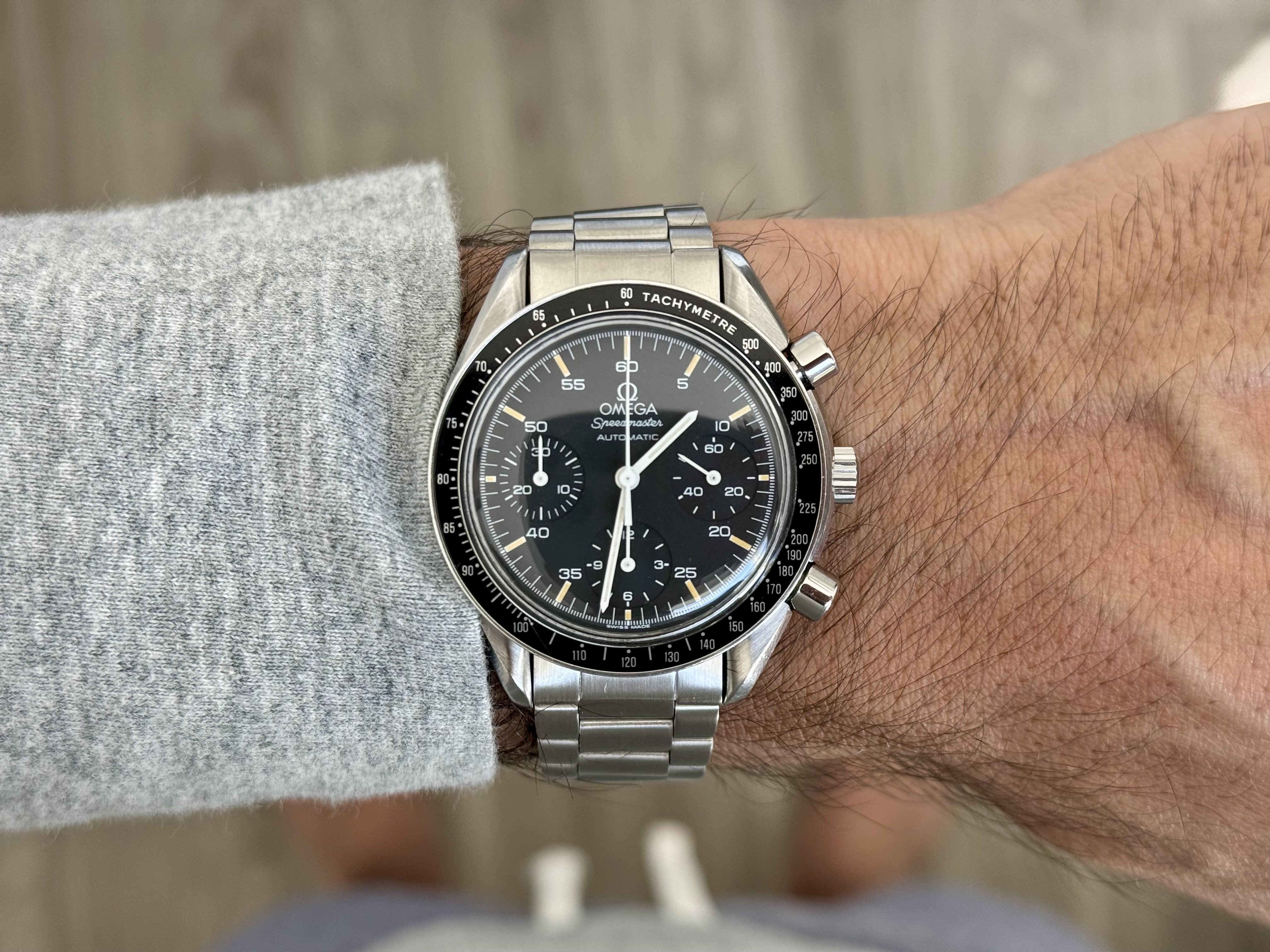

Solid Reduced's can be had for ~$2-2.5k, especially out of Japan with the USD currently strong against the Yen, so if that is your budget, then I personally think the Reduced is a nice option, just as long as you view it on it's own terms and not as a Moonwatch "alternative".
But if you can stretch the budget a bit, you can find *decent* 3590.50's for ~$3.5k currently on Chrono24 out of Japan too, or if you're patient, better condition examples for around that here on OF: https://omegaforums.net/threads/omega-speedmaster-ref-3590-50.171661/

You mentioned one preference being a manual wind. That would rule out any of the 39mm/ reduced options, such as the 3510.50.

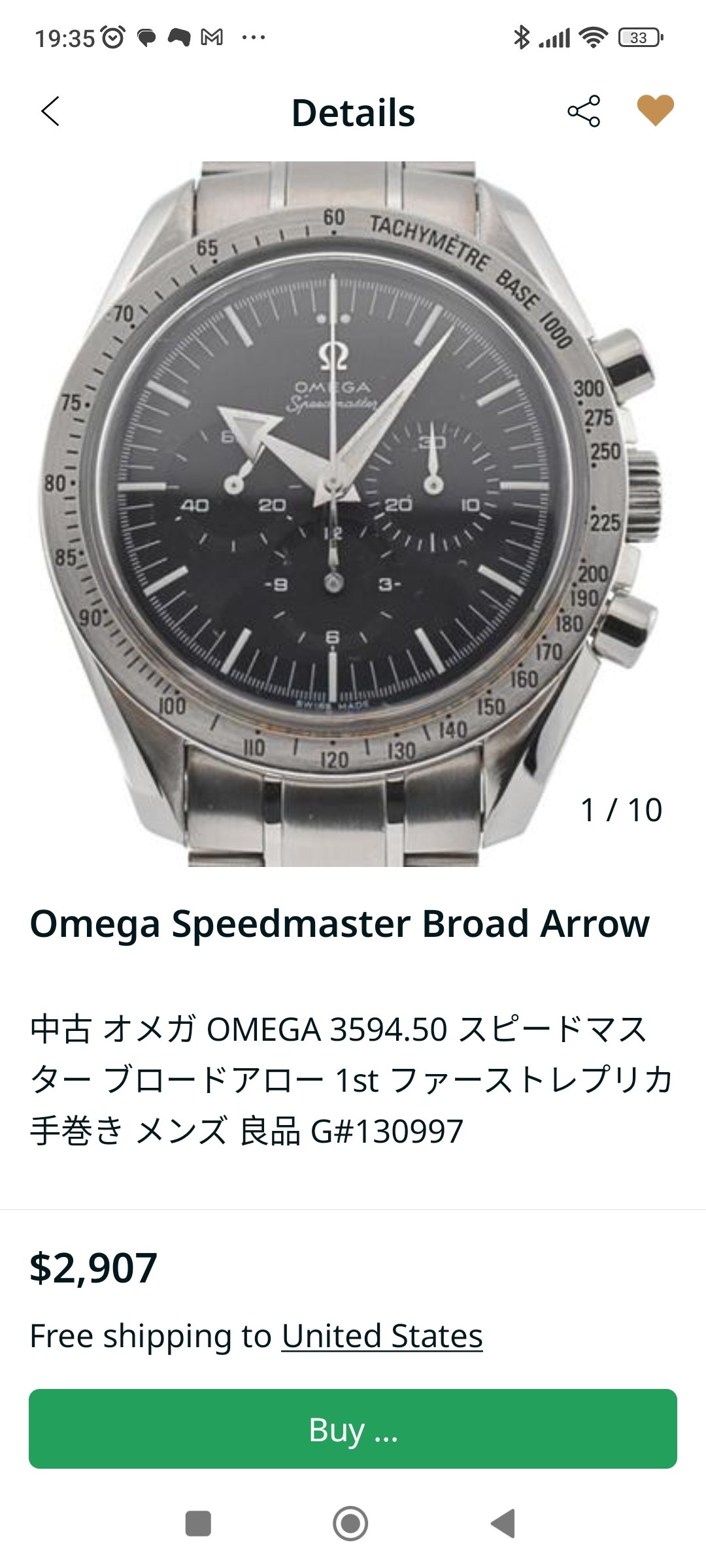

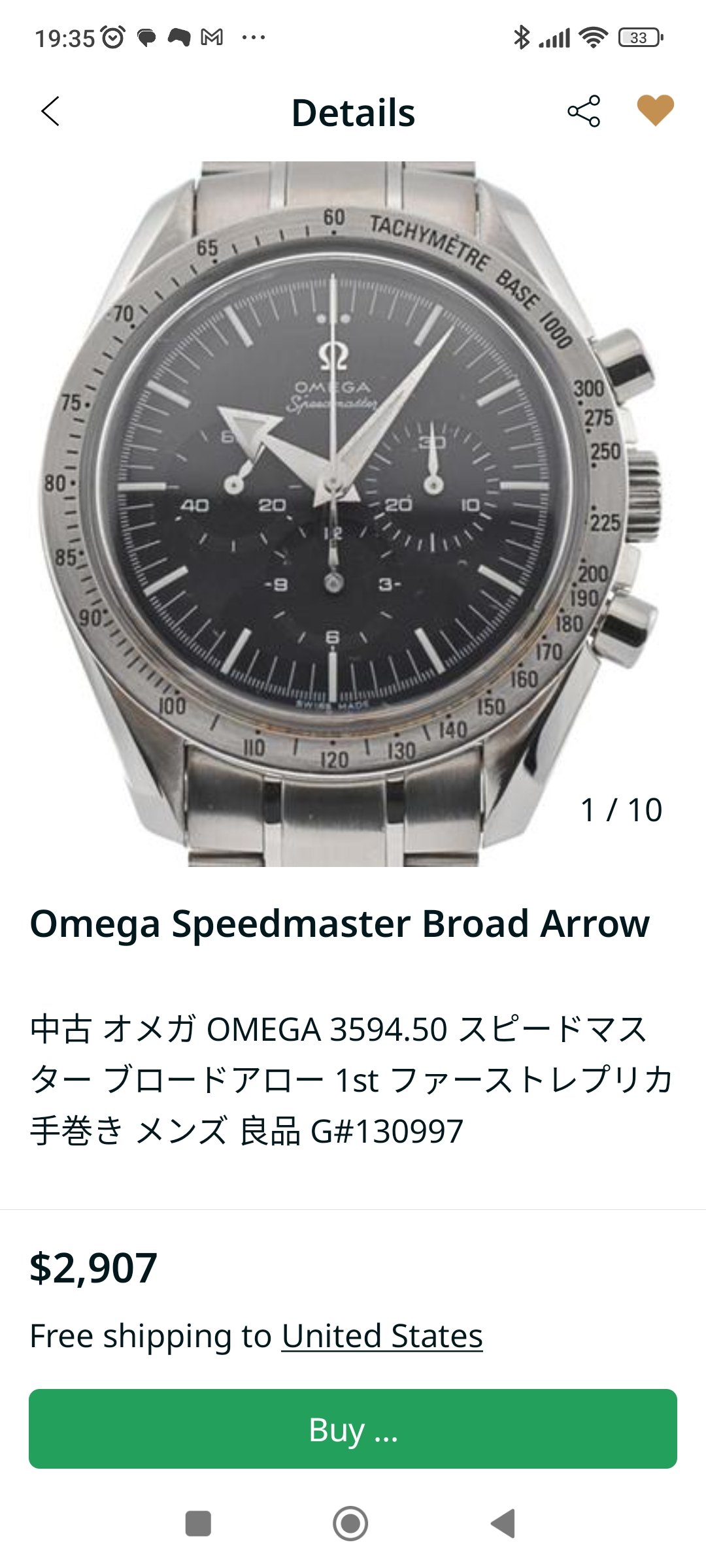

Just buy the Omega Speedster Broad Arrow from 1999. Made by Omega to commemorate 30 years since Moonlanding. Original Moon movement. And many features from the first model from 1957. On steel band as well. This is one of the nicest versions, you can still buy 2. Hand. Best from Japanese dealers, much cheaper. Chrono24 gives you the security and Japanese are mostly meticulous. Win-Win. That's all you will ever need to scratch that itch. And very sturdy model for everyday use !

I was going to suggest that too, but black bezel was in the non-bonus-point criteria...

Can the bezel be swapped out for a Speedy Pro bezel? I’m sure the question has been answered many times.

Sure. A 10 minute affair. And only a few 100 Dollares... The surplus steel bezel is easy to sell as well . I might buy it ...

Thanks much. I thought that all Broad Arrows had a date since all the ones I’ve seen did. Maybe giving up on the idea of a black bezel should be the first of my compro.
