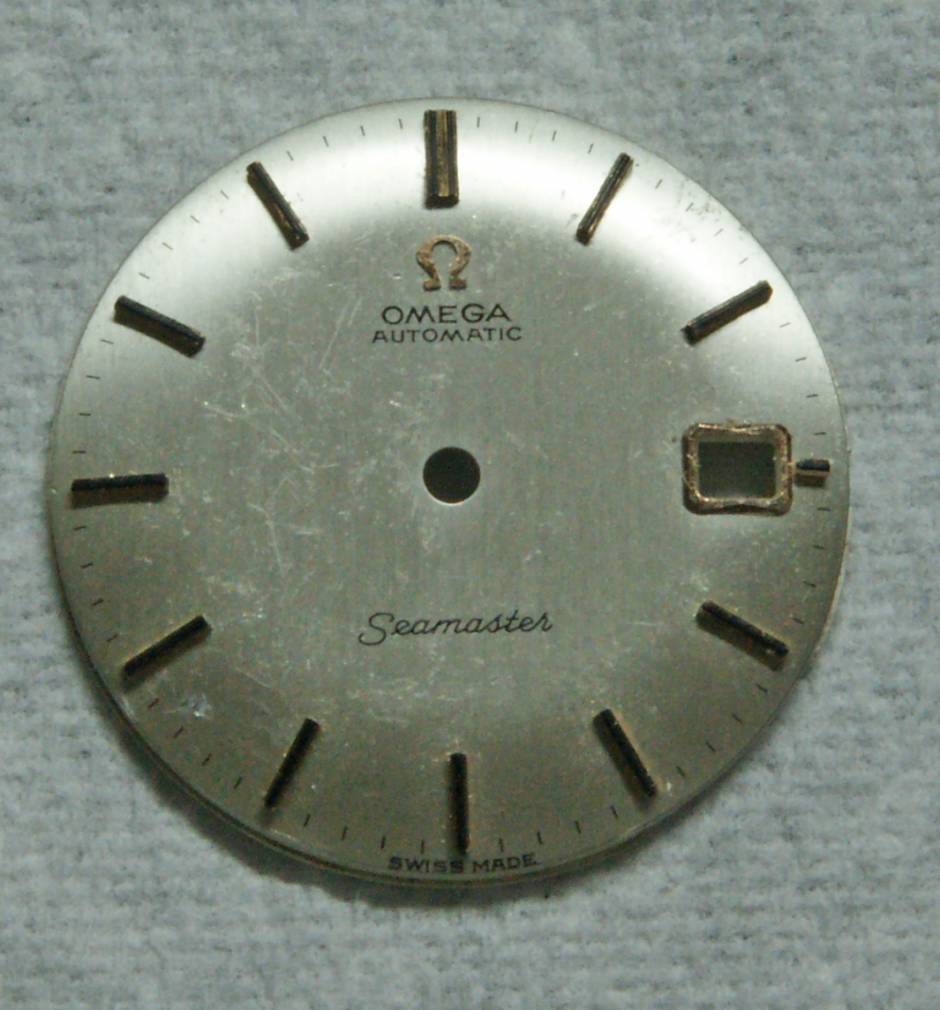

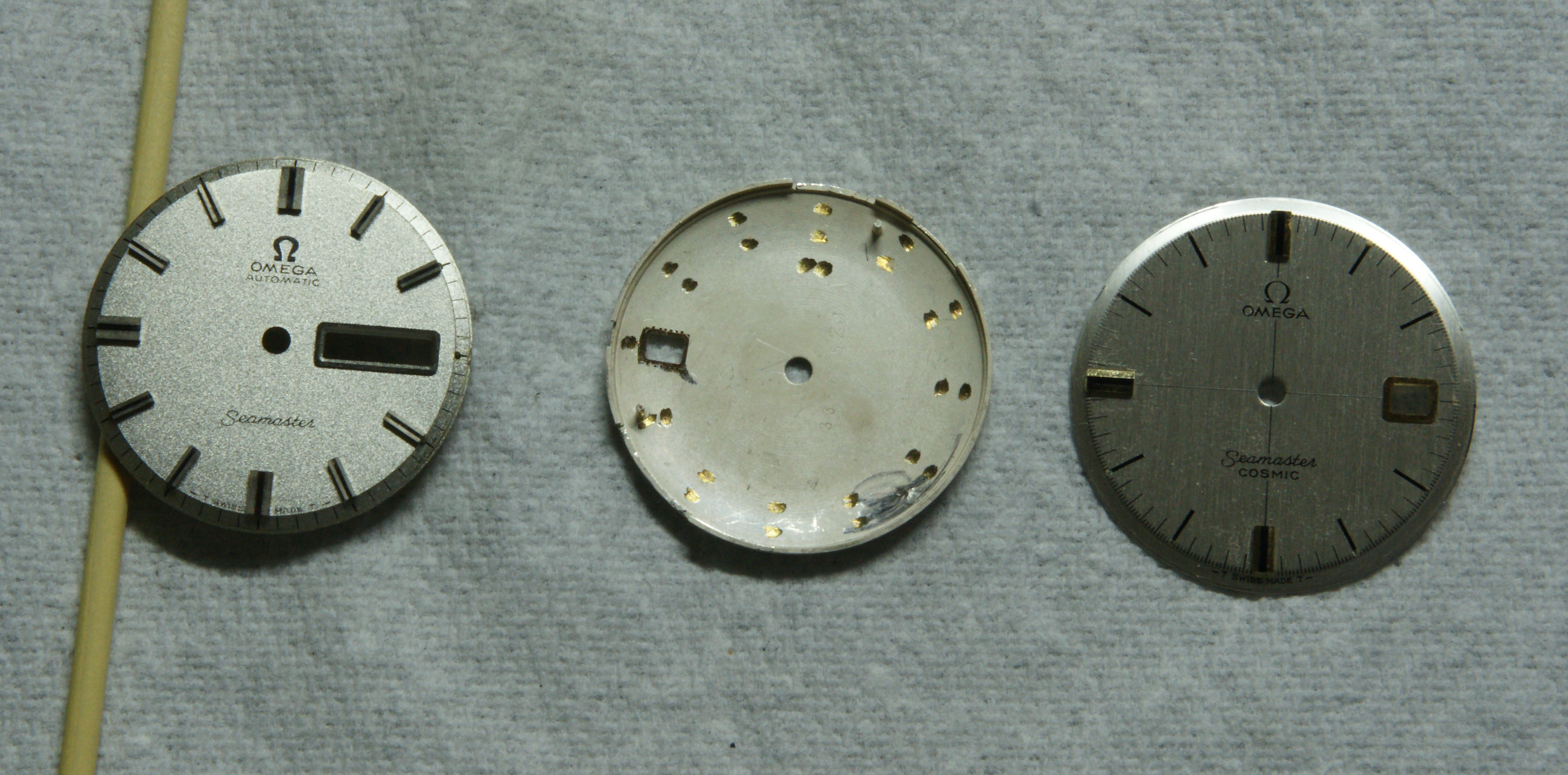

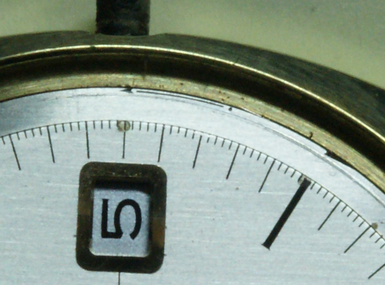

    As I have 3 Seamasters in pieces at the moment, I thought I'd conduct an experiment. With the ability to examine the dials in minute detail, I can categorically say that two are originals and one has been refinished.
    The candidates are (left to right):
    Cal 750 sparkly dial
    Cal 562 dial from the donor movement for my 1960 resurection.
    Cal 613 from a Cosmic.
    So which one is it? Answer tomorrow.
  2. ulackfocus Jun 4, 2013
    25,983
    26,974
    I'd say the Cosmic is the refinised dial. The SWISS MADE is split by the 6:00 marker, while the whole phrase should be centered which should slightly push it counterclockwise so it looks more like the center dial, leaving the last S in SWISS almost under the 6:00 marker.
  3. cicindela Steve @ ΩF Staff Member Jun 4, 2013
    15,047
    23,791
  4. JimInOz Melbourne Australia Jun 4, 2013
    15,492
    32,385
    I'm for the Cosmic, the Seamaster and COSMIC font print looks too heavy and just "not quite right".
  5. CanberraOmega Rabbitohs and Whisky Supporter Jun 4, 2013
    5,570
    6,208
    agree, cosmic. the cross hairs look wrong, and I think the omega logo is too recent for the period.
  6. Privateday7 quotes Miss Universe Jun 4, 2013
    5,753
    2,903
    +1 Cosmic. font, hour marker, cross hair are suspicious
  7. LouS Mrs Nataf's Other Son Staff Member Jun 4, 2013
    6,713
    18,260
    ..and another for the Cosmic

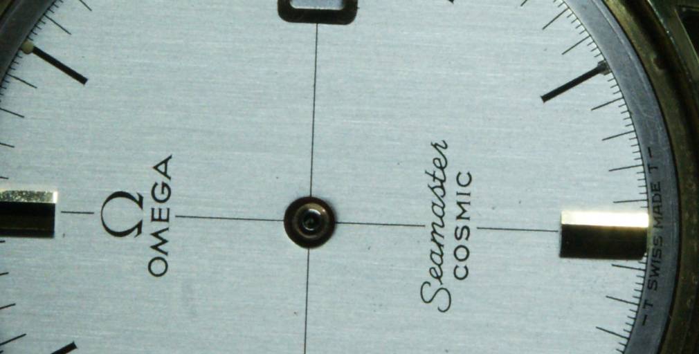

  8. jud Jun 4, 2013
    613
    325
    I need you guys in my back pocket when I get on ebay. I sat staring with the screen two inches from my face at the blown up picture. The "O" in omega on the Cosmic is wrong and I can see the "S" in Seamaster, but in an ebay picture would have just been taken.

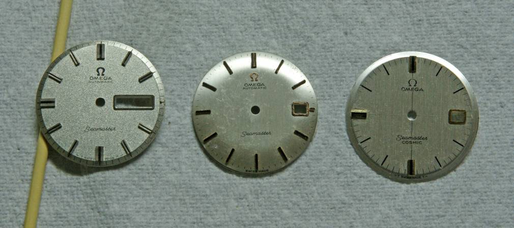

  9. Stewart H Honorary NJ Resident Jun 5, 2013
    3,070
    3,510
    As you all seem to have gone for the Cosmic, here are a couple of close-up photos for anybody who might want to change their mind:
    In this second one, note the arrow and dot to show the direction and extent to turn the movement to release it from the case. This is hidden beneath the tension ring.
  10. Stewart H Honorary NJ Resident Jun 5, 2013
    3,070
    3,510

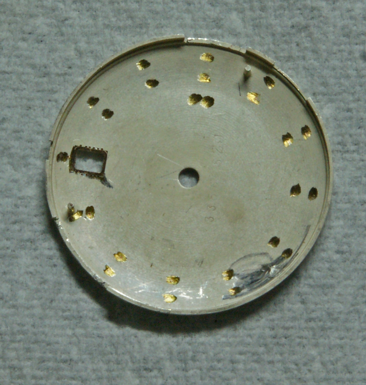

    OK, so here is the answer:
    I think that, at worst, the Cosmic may have been a service dial before they stopped using tritium., but the real re-finish is the one from the donor movement.
  11. ulackfocus Jun 5, 2013
    25,983
    26,974
    Wow, that's a pretty damn good refinishing job. :eek:

    Cool thread :cool: It had me stumped but that doesn't mean much. I'd like to see a better pic of the re finish for future ref

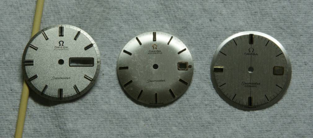

  13. Stewart H Honorary NJ Resident Jun 5, 2013
    3,070
    3,510
    As requested:
  14. Central Scrutinizer hangs out in Joe's garage Jun 5, 2013
    440
    265
    Thanks, that would probably nail most people, especially with the aged look.
  15. CanberraOmega Rabbitohs and Whisky Supporter Jun 5, 2013
    5,570
    6,208
    so how can you tell it is refinished?
  16. Central Scrutinizer hangs out in Joe's garage Jun 5, 2013
    440
    265
    The center line in the E in Omega is the only thing that looks a little off to me and maybe a few TINY variations in the Seamaster but I'm not sure TBH.
  17. Stewart H Honorary NJ Resident Jun 6, 2013
    3,070
    3,510
    It is a very good re-dial,,but close inspection reveals its faults. To make it look as good as it could, the furniture was removed prior to re-finishing but the E and the G in Omega are not right.
    It will now be destroyed, including the black onyx markers - I don't condone frankening in any way, shape or form. Replacement of parts is OK but dials and identifying marks are a NO in my book.
