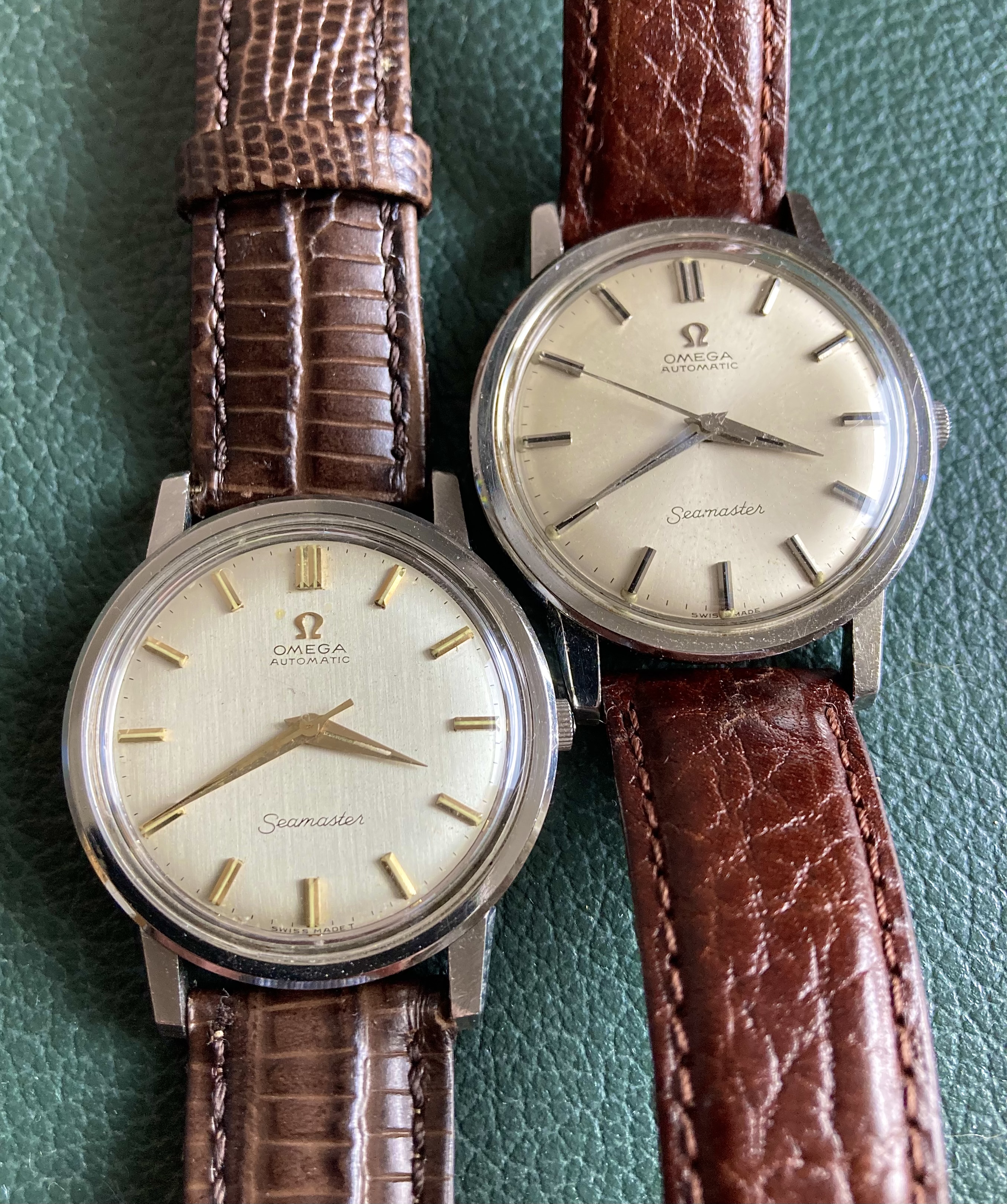

The 165.003 (or 165.002) may fit the bill. Constellations are also good.
These are my 34/35 mm 165.003s.

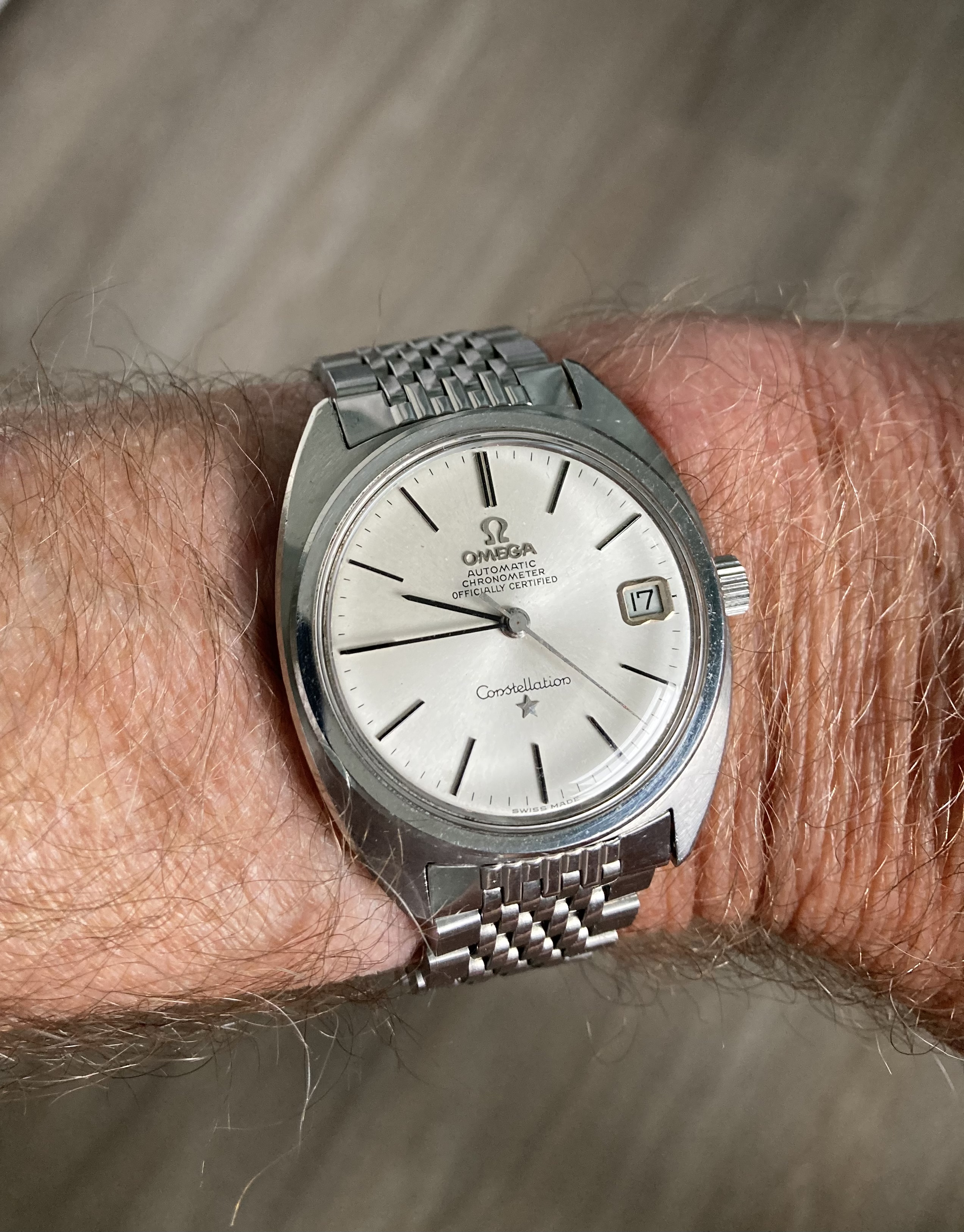

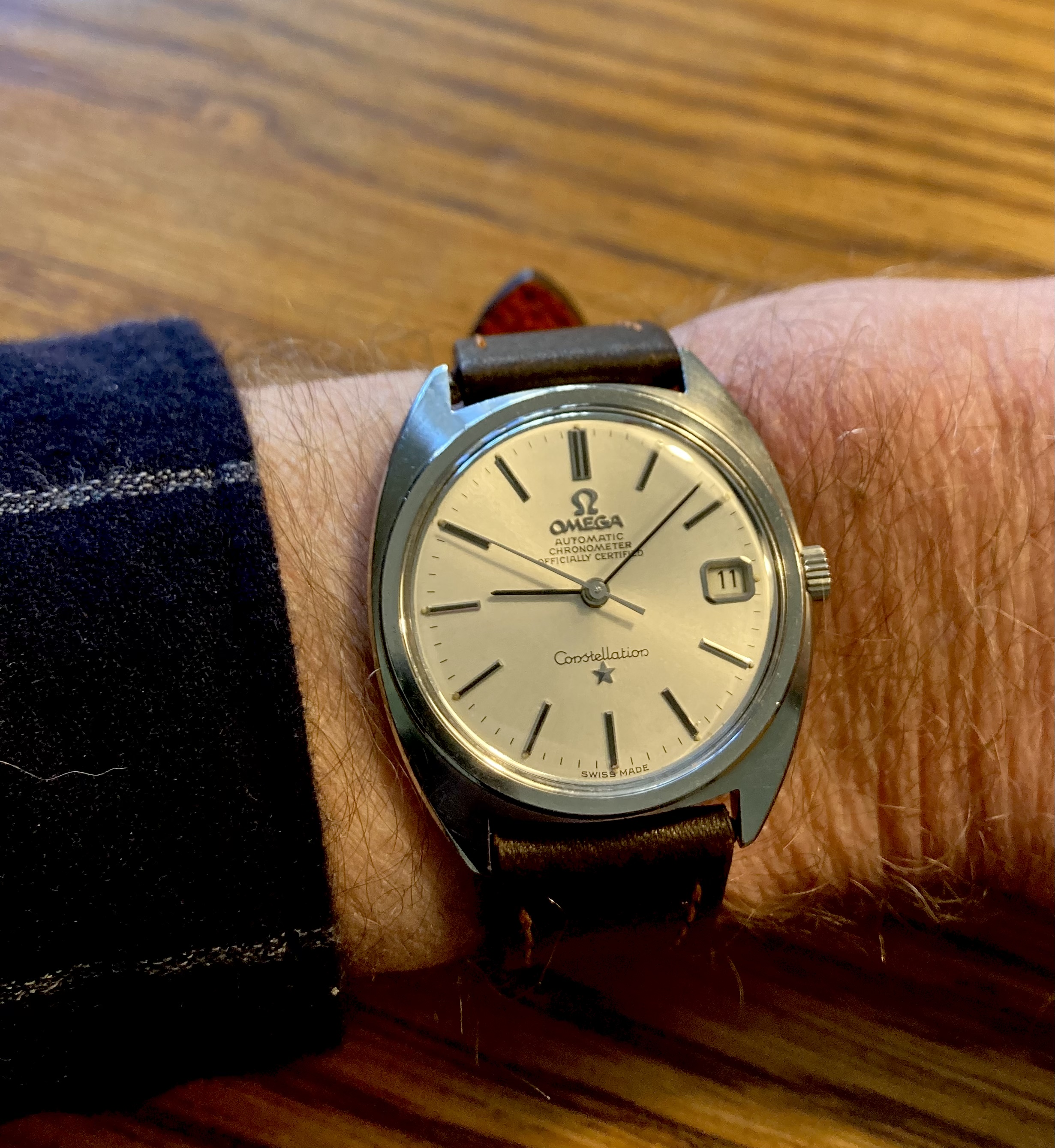

Some Omega actually wear bigger than their actual diameter, like C case Constellations (but all have a date window)

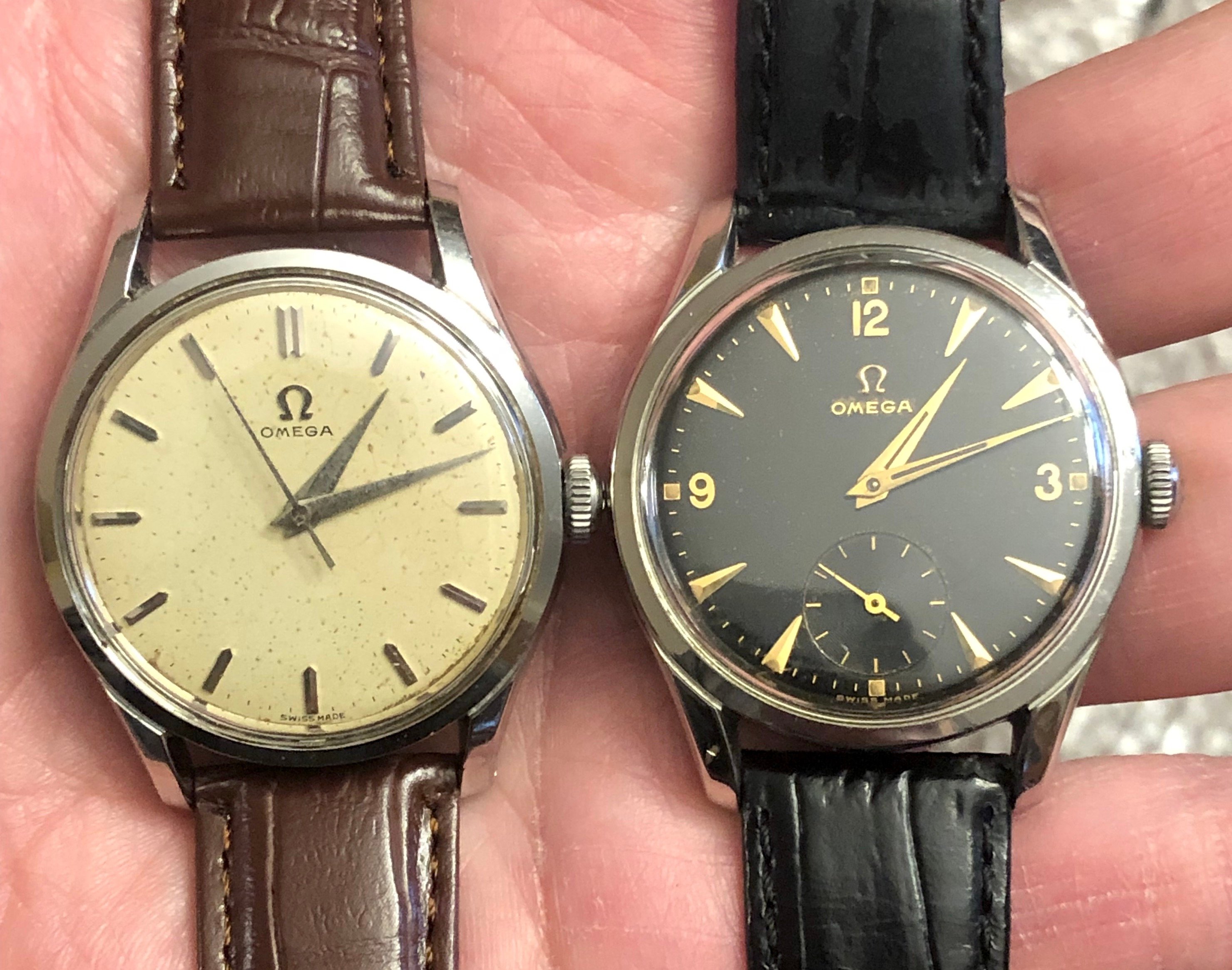

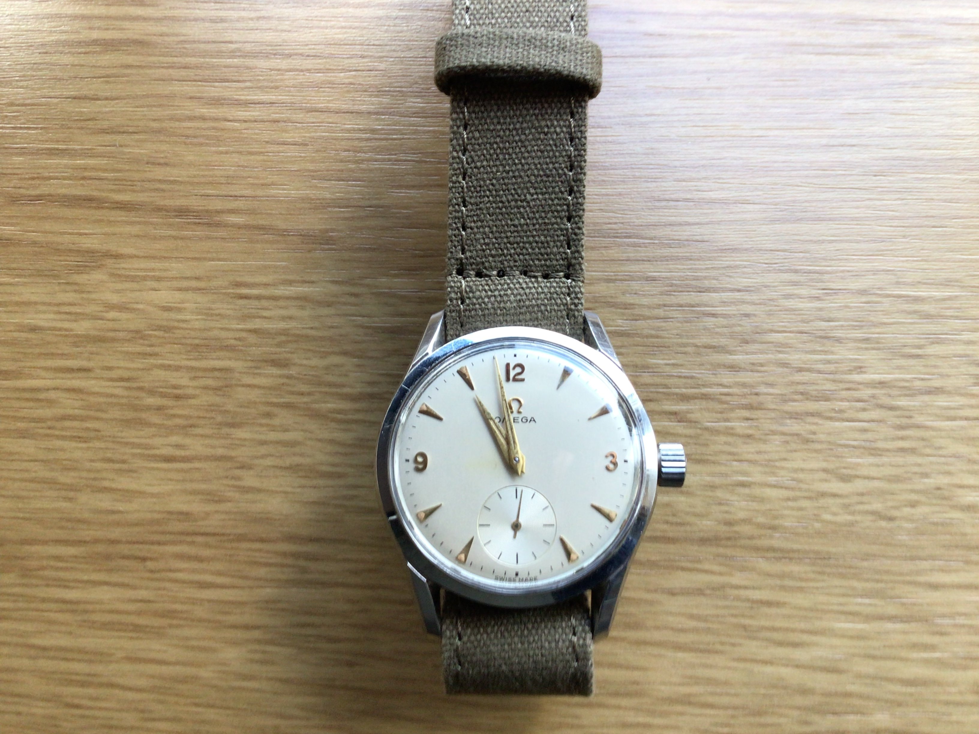

These are 36mm from the 50s (refs 2640 and 2639). Screwbacks, so more water and dust resistant than some.

Through my relatively short journey in vintage Omegas totally agreed with all above replies.
Just want to add that C case ones look slim on wrist (by their case design).

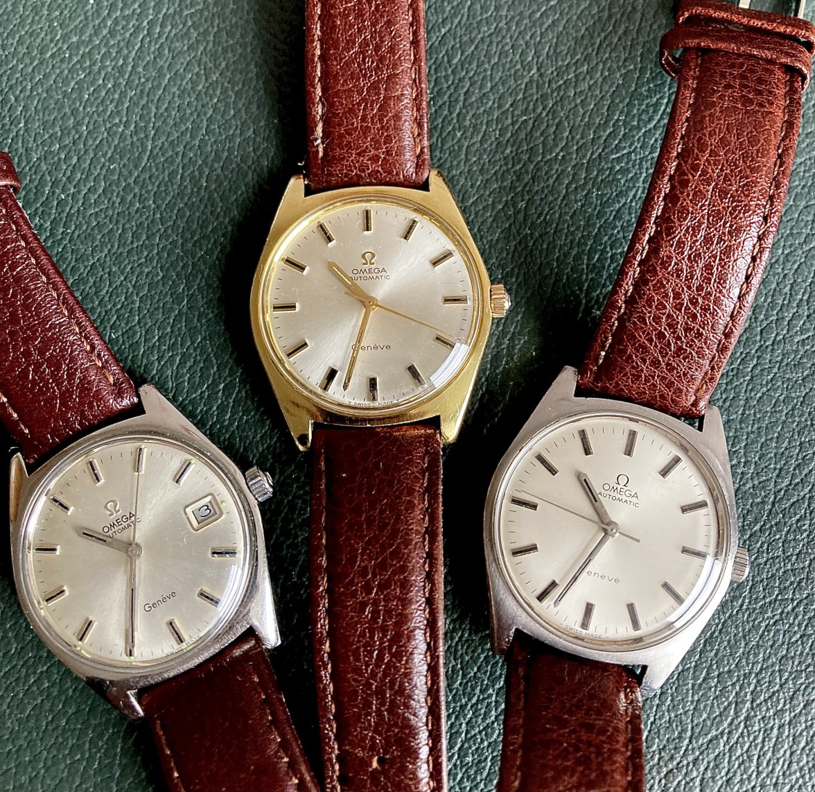

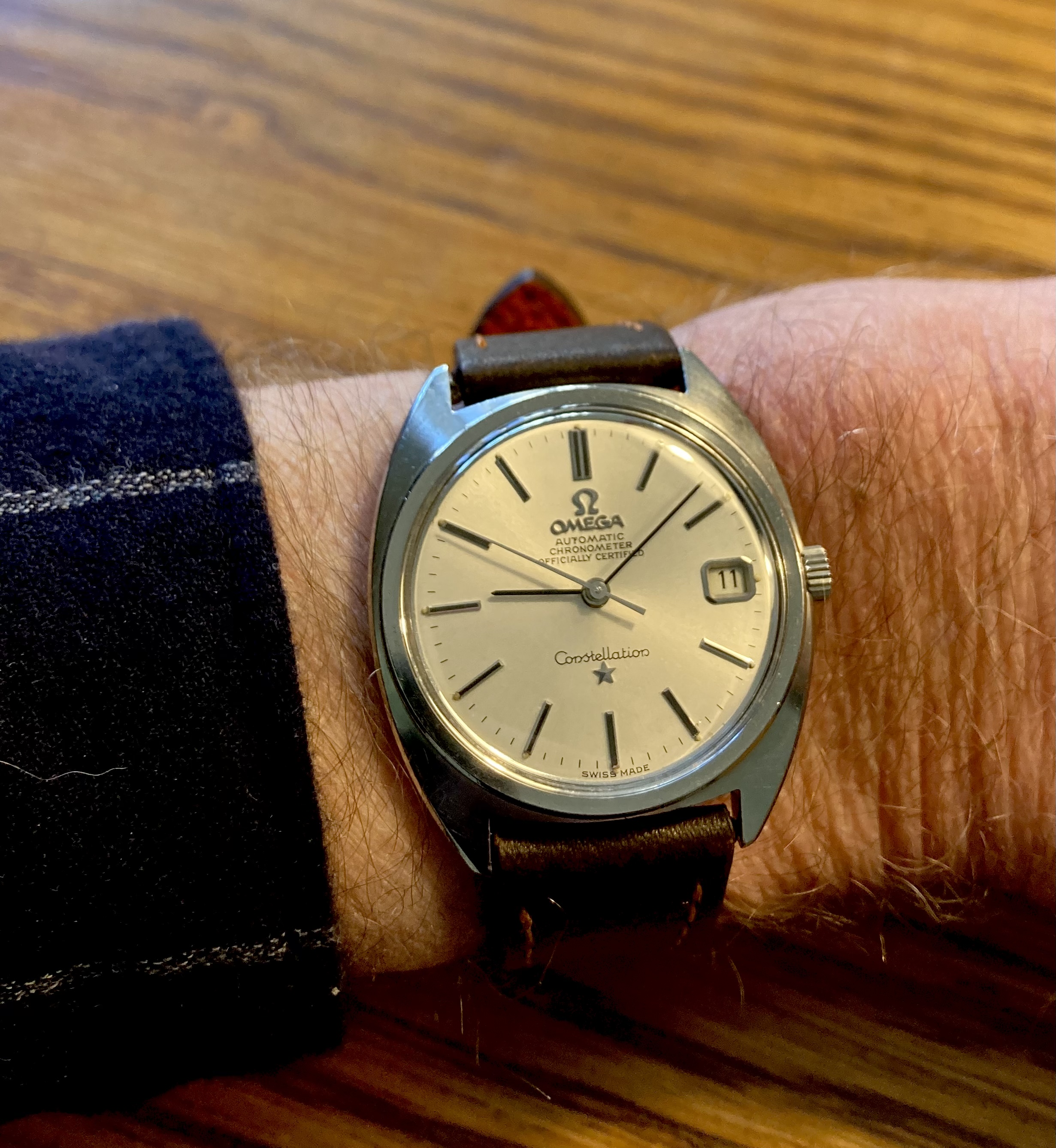

As @Davidt suggests, 1970 Geneves wear bigger. These are my three automatics with 552/565 movements but you can find a no date manual wind cal 601 quite easily
