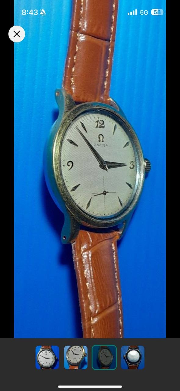

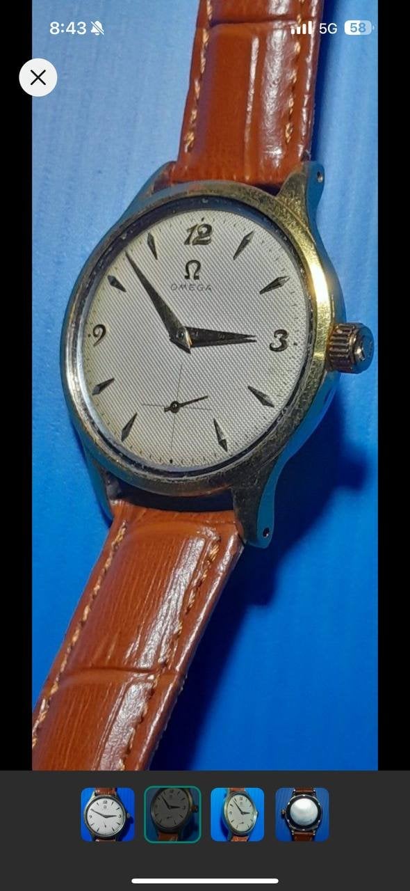

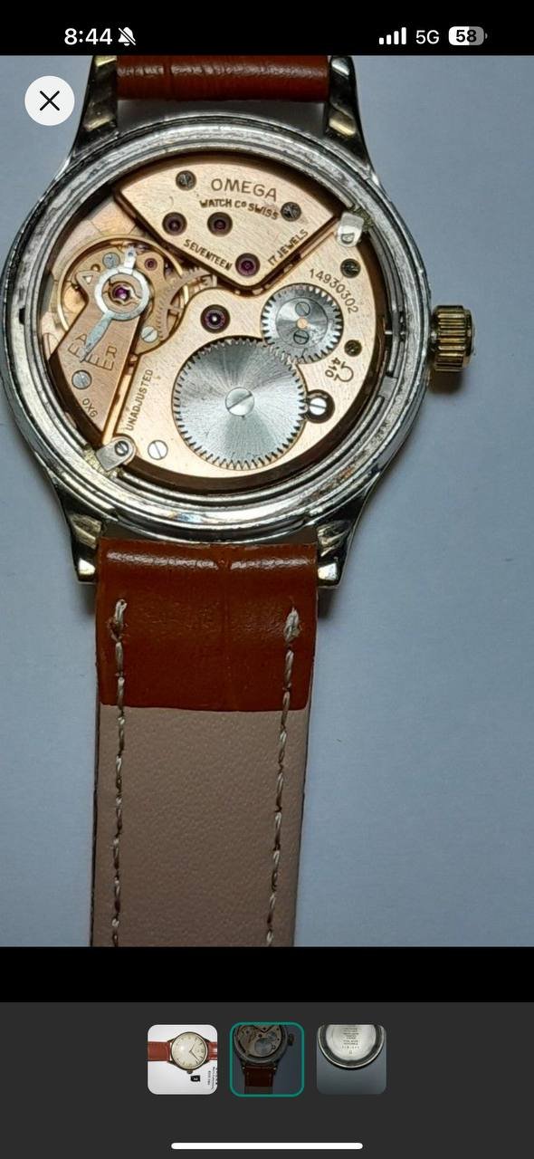

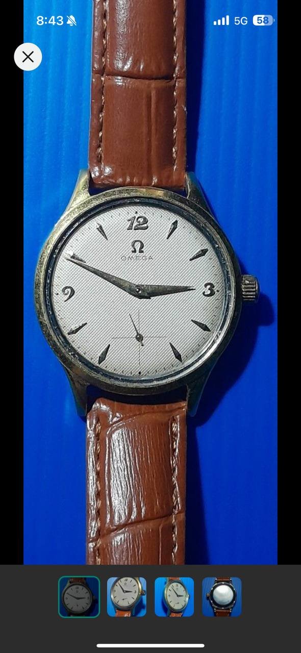

Which model is this? Can't seem to find much info about it.. Movement is Omega 410.
6

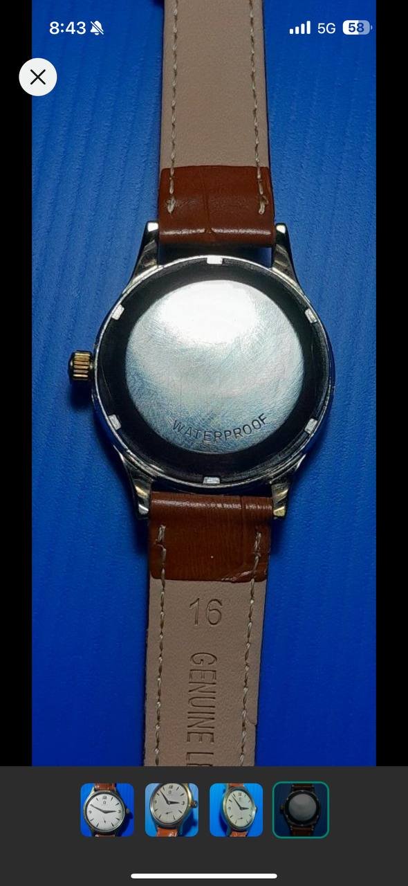

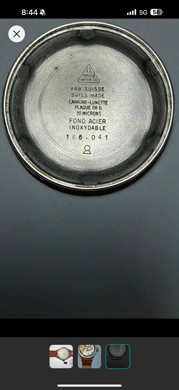

All I know is that the caseback is for an Omega Genève but I'm not sure if the watch is a redial or not.
Would love to get a second opinion before I purchase this watch.
Thank you!
907
1,742
Try a Google search on 166.041. I don't think that case back belongs to that case. The dial looks to be an original dial but not for that reference. This is a put together frankenwatch IMHO.
13,492
31,811
Put together from at least three different watches.
It would get a hard pass from me.
