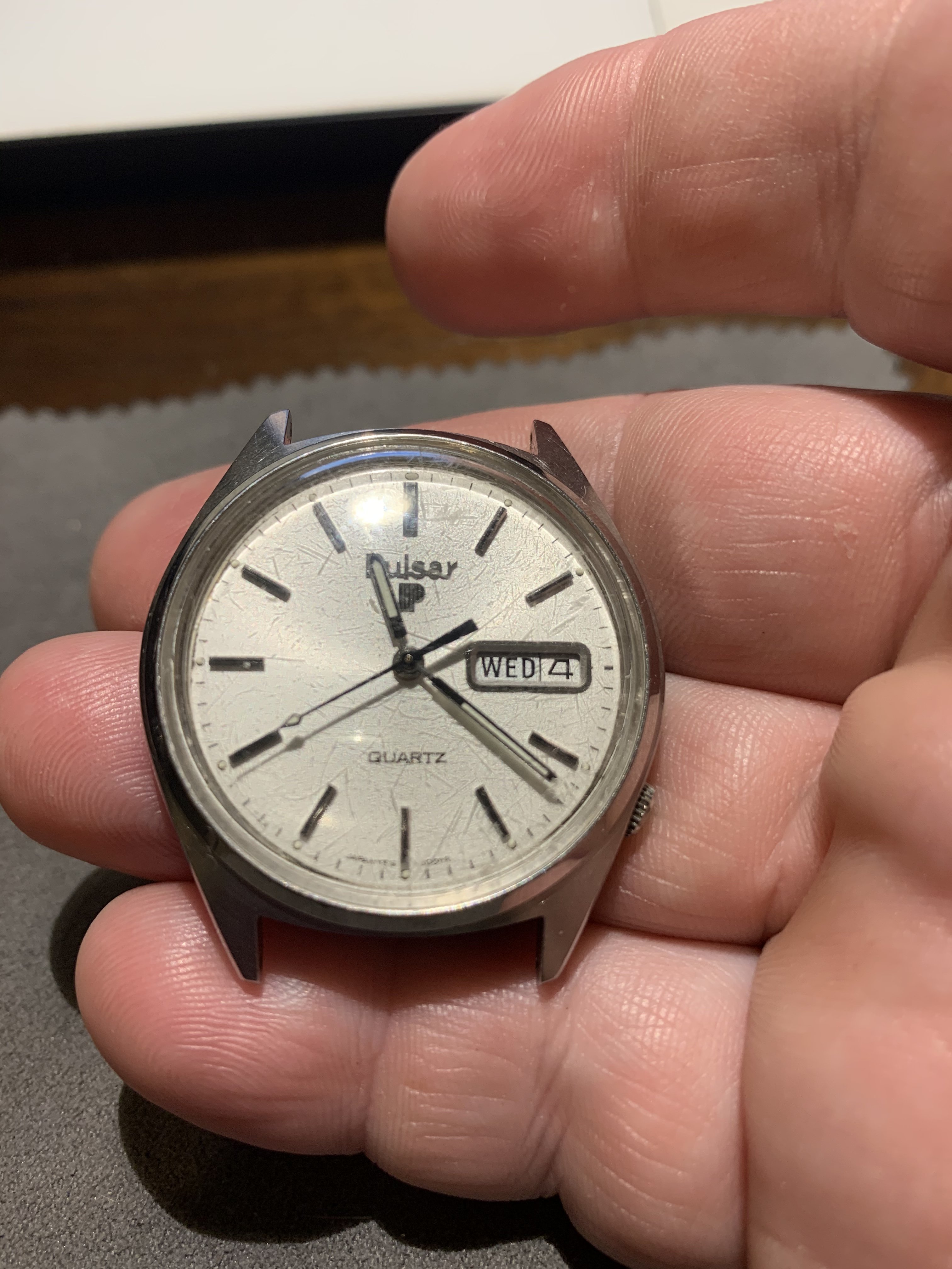

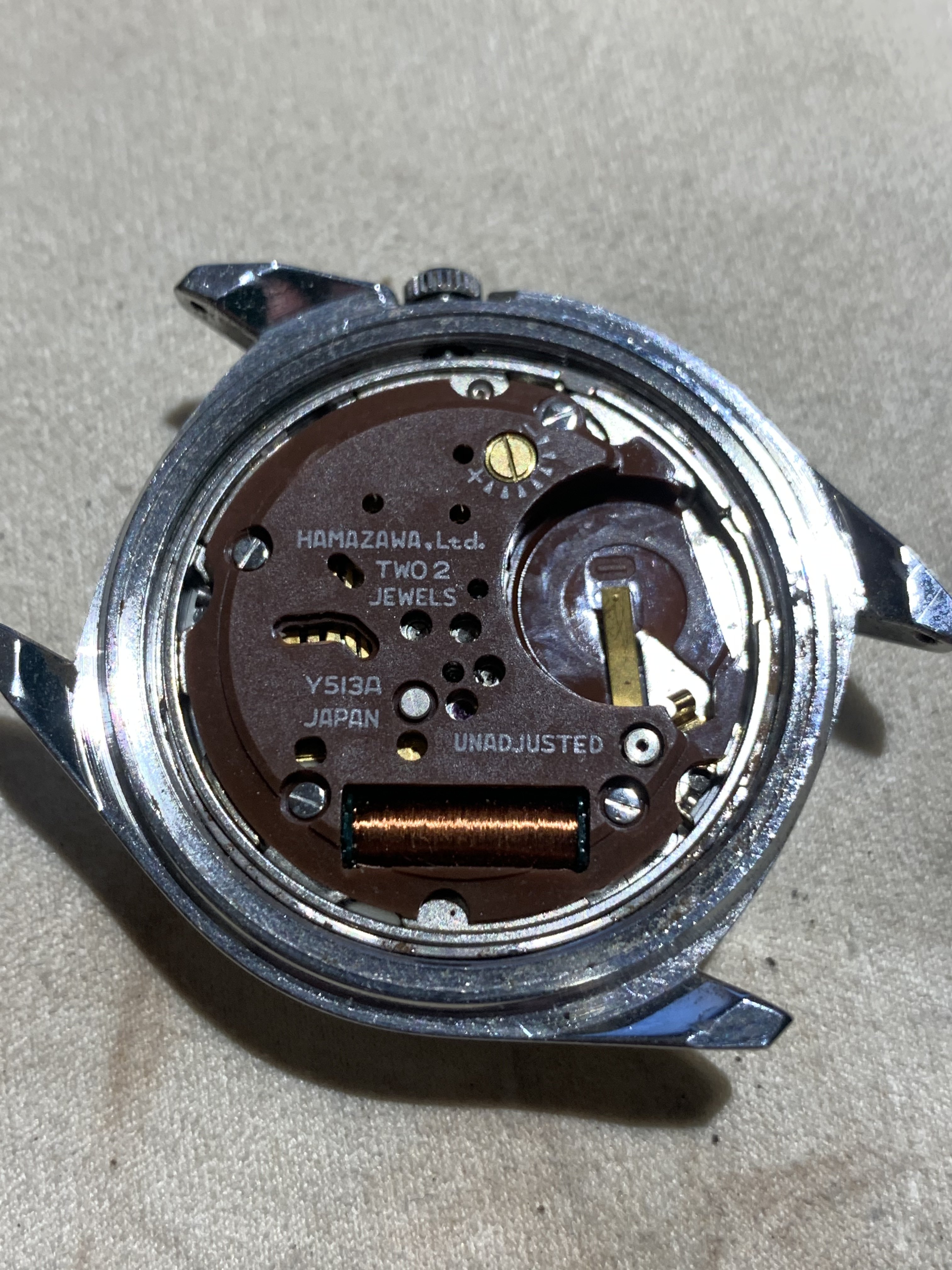

I'm trying to test an older Hattori Y513A movement, but I'm unsure of what battery it uses. Anyone know?

May I suggest you measure both the diameter and depth of the battery compartment and go from there.

It's a 301.

Sorted……now I guess the next step is finding one
Already ran to the pharmacy and bought 1 lol! Non running. Second hand just twitches. I have this bad habit of wanting to fix things that may not even be worth the cost of fixing, and this seems to be going down that path. It's got an engraving on the back, was a gift for Christmas, 1979. I'm sentimental, I want it to run. Already hunting for a replacement movement.

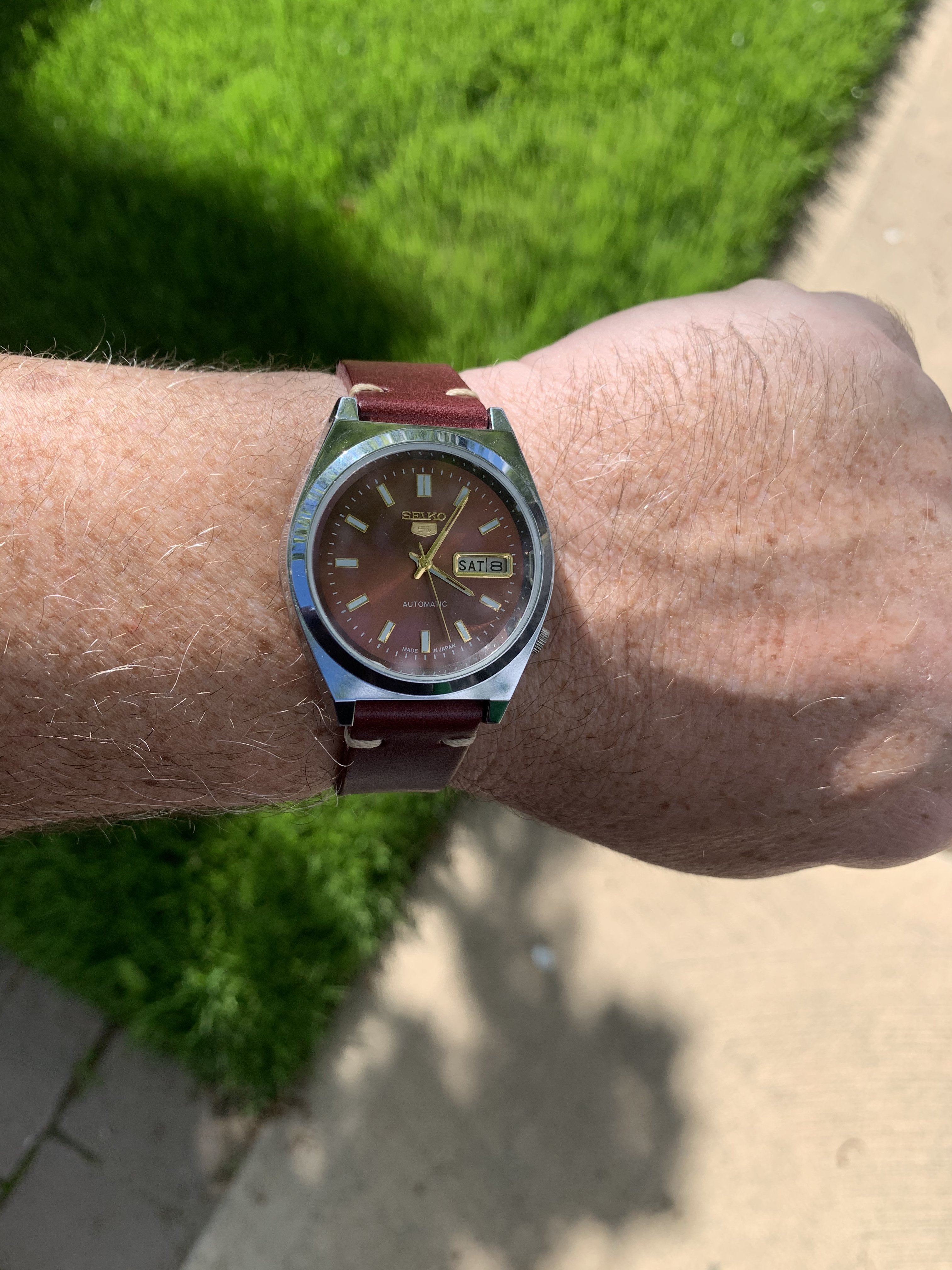

Sir, kindly take your well thought out logic elsewhere!! Kidding aside though, you are correct. But I'll still go ahead and jump into the fixing it. Watch cost me $5.00, the battery cost me 6. So I haven't wasted much yet. The good part is I also bought this at the same flea market, also for $5.00 (all watches were $5.00. This came on a cheap leather strap, but amazingly I had a strap that matched it perfectly. So I think I'm ahead overall.

Battery is actually an LR43 in the eBay watch. That's a 1.5 volt micro alkaline. There are a number of silver oxide 1.55 volt batteries that would also work. SR43W for example.

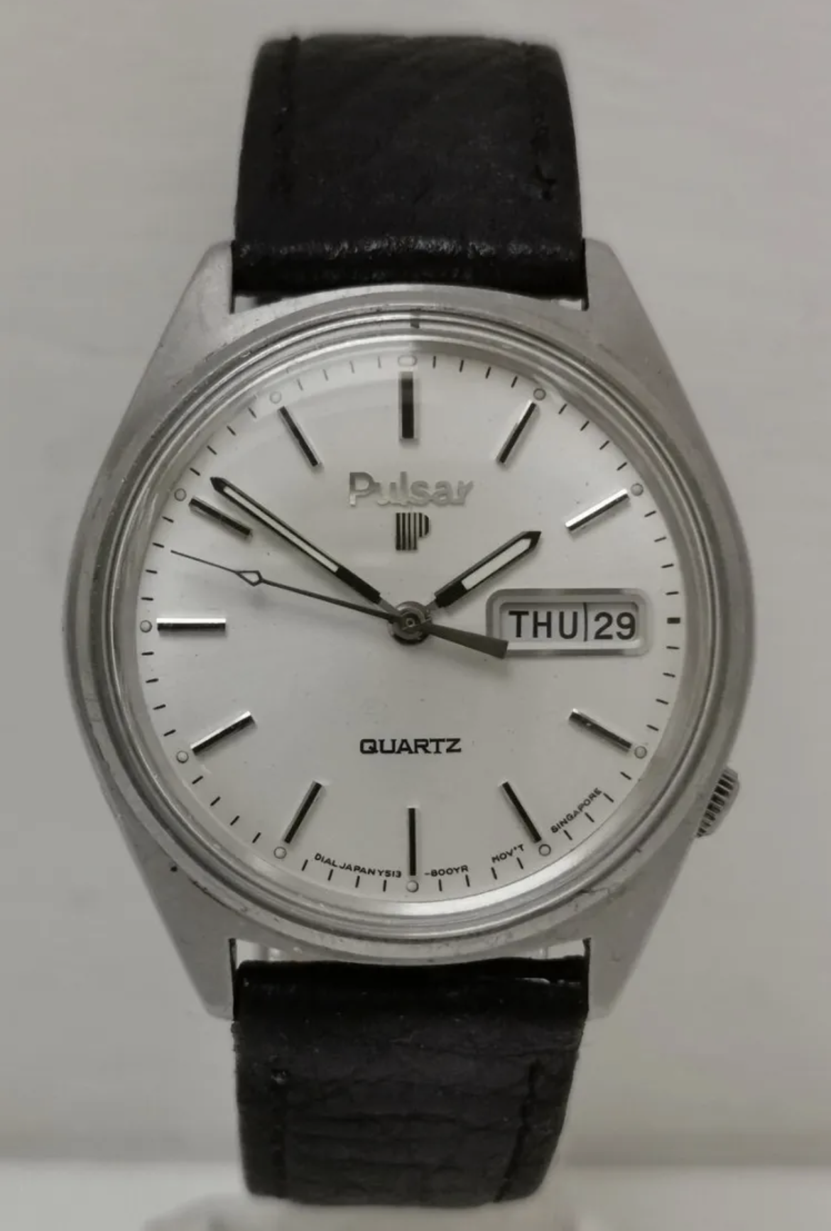

I found a similar watch on eBay.
https://www.ebay.com/itm/115606783880
There is a picture of the movement showing the battery to be an LR48. The equivalent is not a 301. It is a 393.
https://www.batteriesdirect.com/product/details/button-cell-batteries/toshiba/lr48
Might want to try that first.

Both the subject watch and the eBay watch have the Y513A movement. If the eBay one works, why bother messing around trying to make the subject watch work? Just sayin’.

I hadn't even considered that . I grabbed another watch that's very similar on what for $20, days it runs.
The added benefit of this is that this parts watch will have a crystal tension ring, mine should have 1 but it's missing. So I need that as well.

I disagree. You want functionality or originality? No one says you have to throw away the parts that you don't use. The watch I linked has the same case, movement, dial and crown.
In my experience, if the second hand is twitching it's usually just dirt somewhere. Often the step rotor attracts all the little bits of swarf which eventually stops it rotating. I love working on 7Axx movements from Seiko, made back in the day when quartz watches were made properly rather than to the lowest cost possible. The 7A28 was the worlds first quartz analogue chronograph and debuted in late 1983, the 7A38 was the same but with the addition of day and date and was released a little later. These were followed by 7A48 which either had moonphase or tide indicators depending on the model. I have half a dozen or so of them and have worked on quite a few more. Quartz done properly.

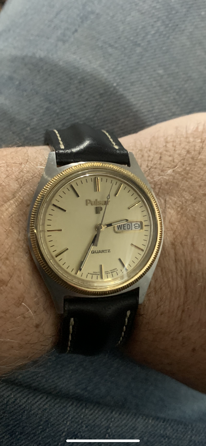

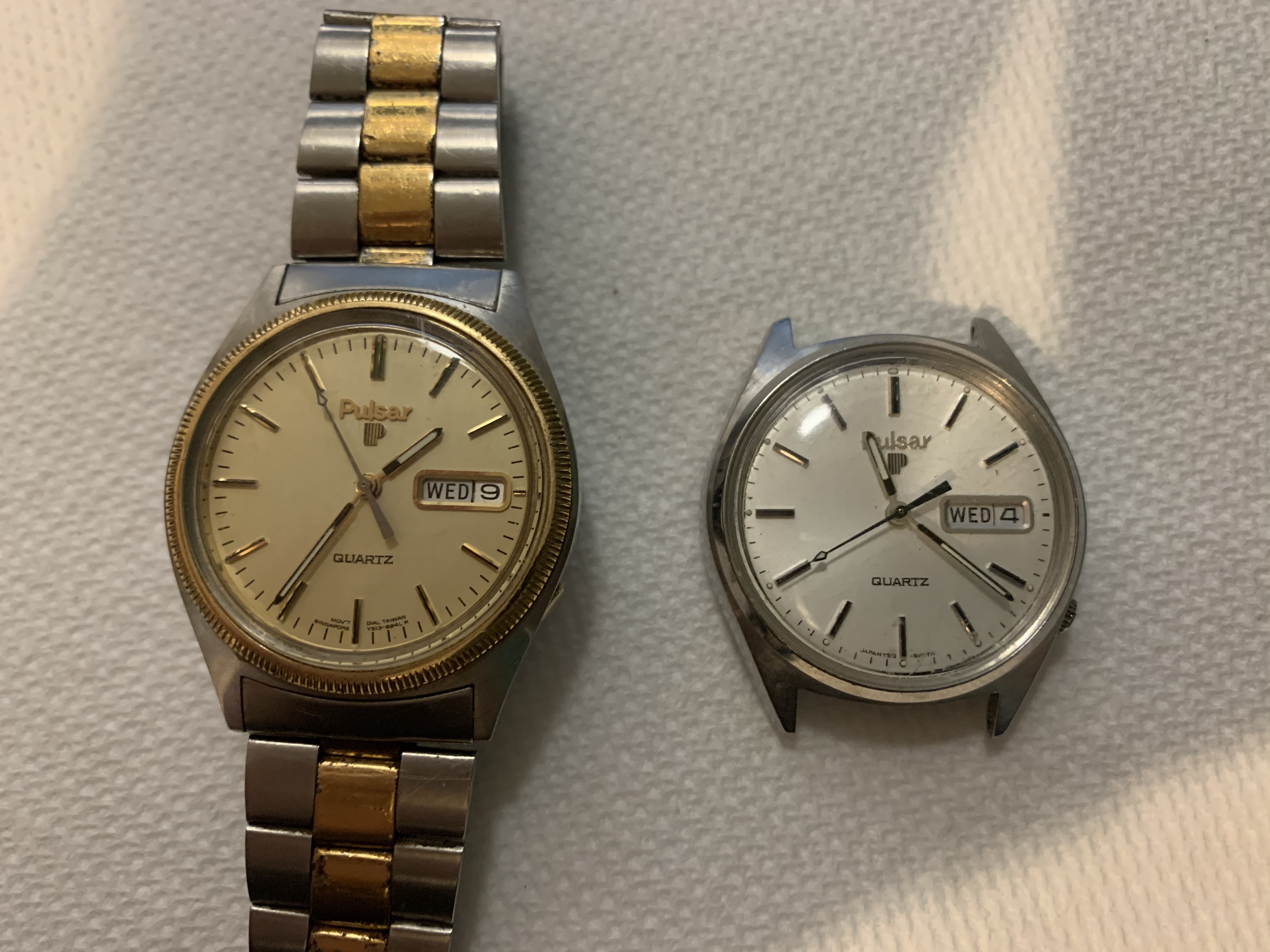

I'm hopeless. So as I said, I bought a donor watch with the same movement intending to swap them out. When the donor arrived today, I found it to charming to waste parting out. I like it's 36mm case and 20mm lugs. I really like the bezel as well. The watch I started the thread with is 34/18. So now I own 2 early 80's, quartz Pulsars. I have a weak spot for vintage watches that probably were never the "coolest" pieces. I'm gonna put the original watch that started this thread aside. I'll revisit it in the future. I'm not gonna continue buying and keeping donors .
Here's the "donor" before and after a cleanup. I need a better strap for it. I also need help.
