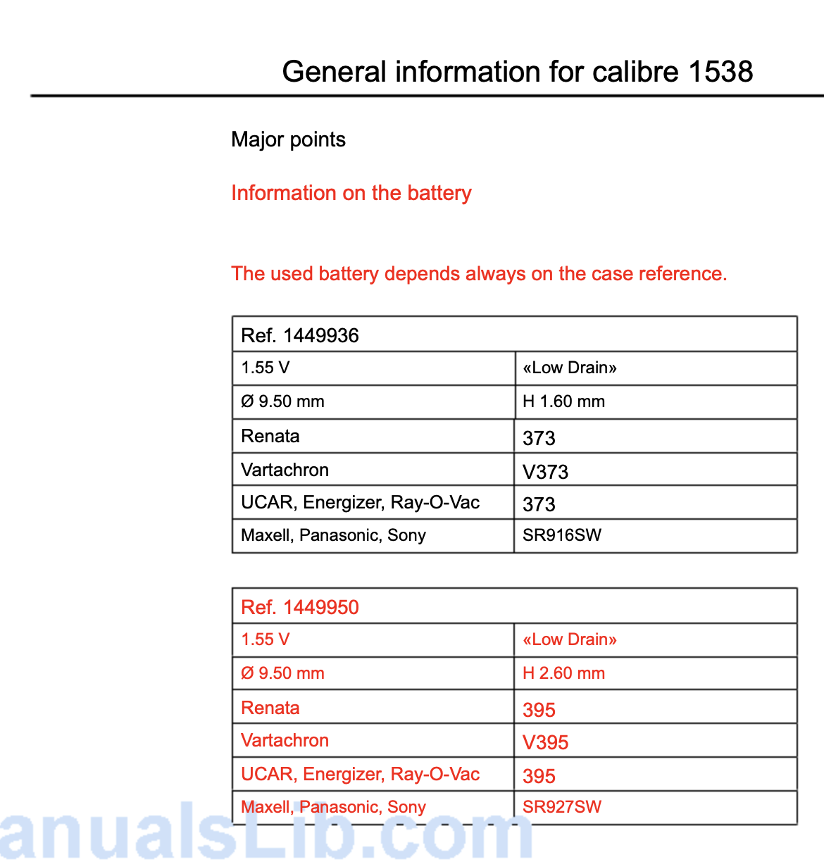

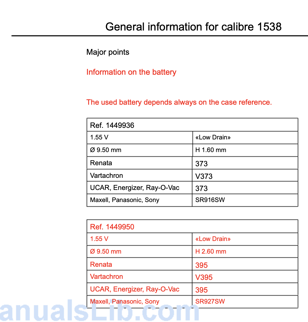

Just to wrap this up, the case can determine the specific battery. Here's an excerpt from Omega Technical Guide TG-19-C-013-E: Note the admonition on page 4:
The used battery depends always on the case reference
