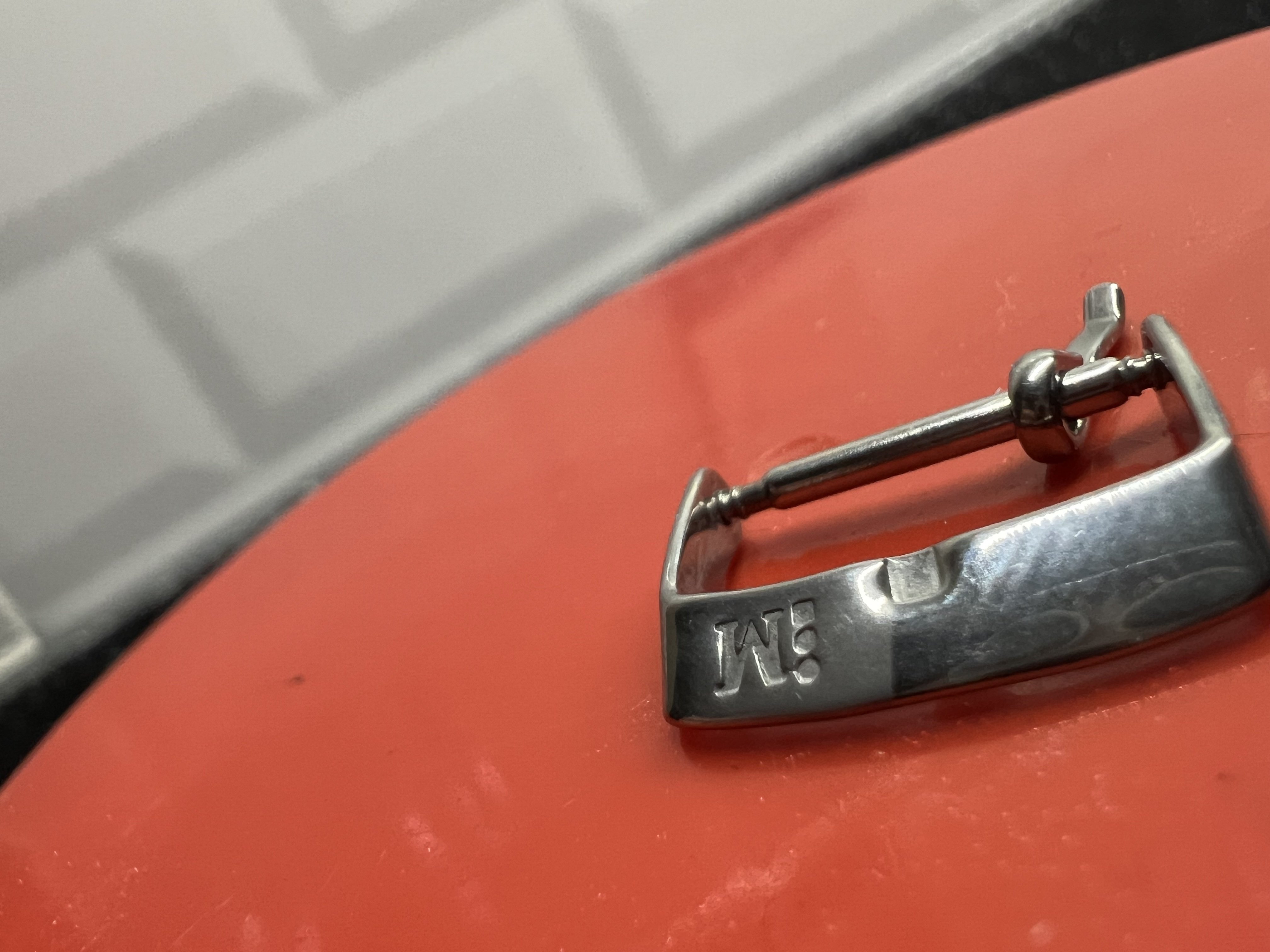

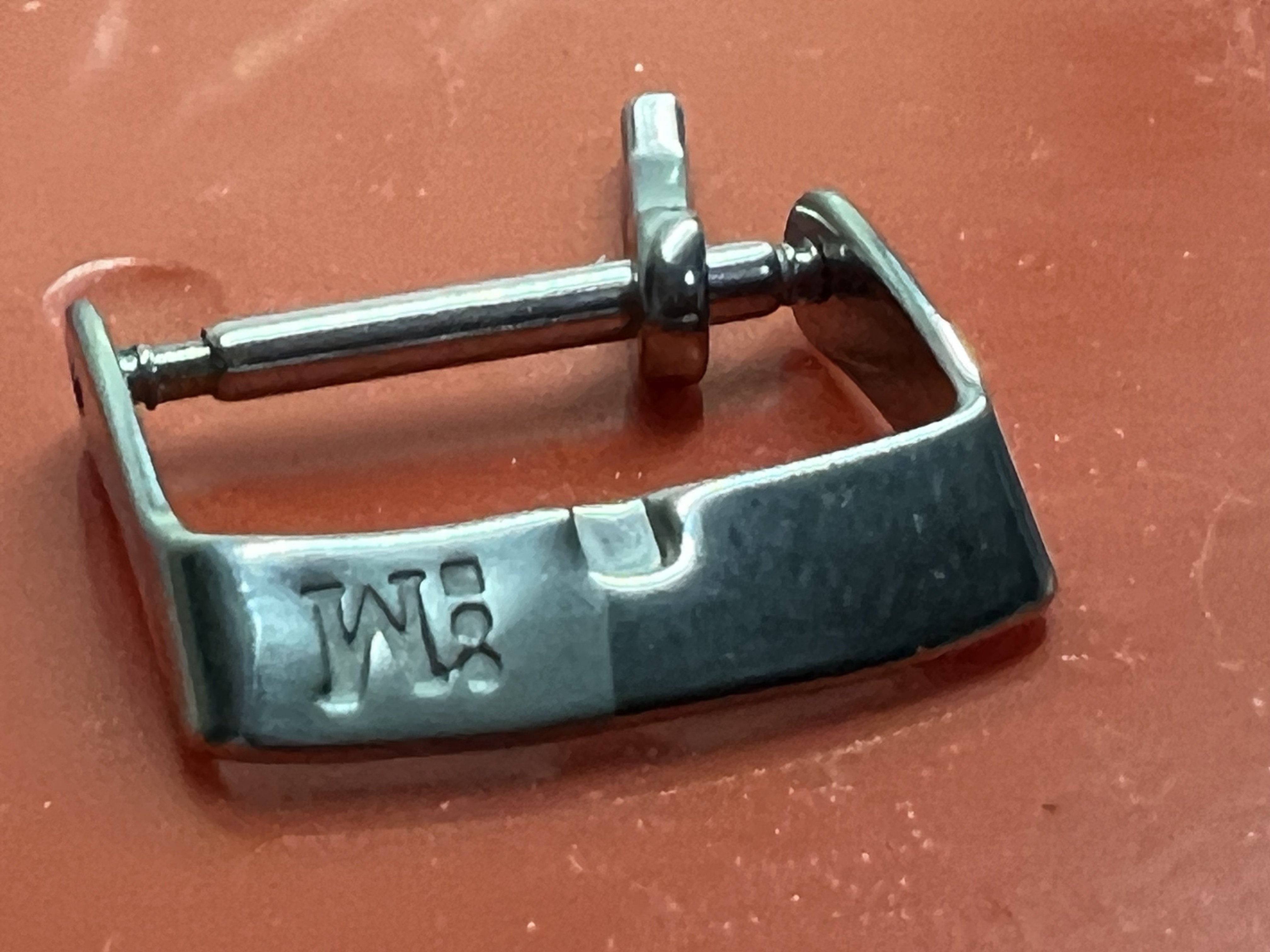

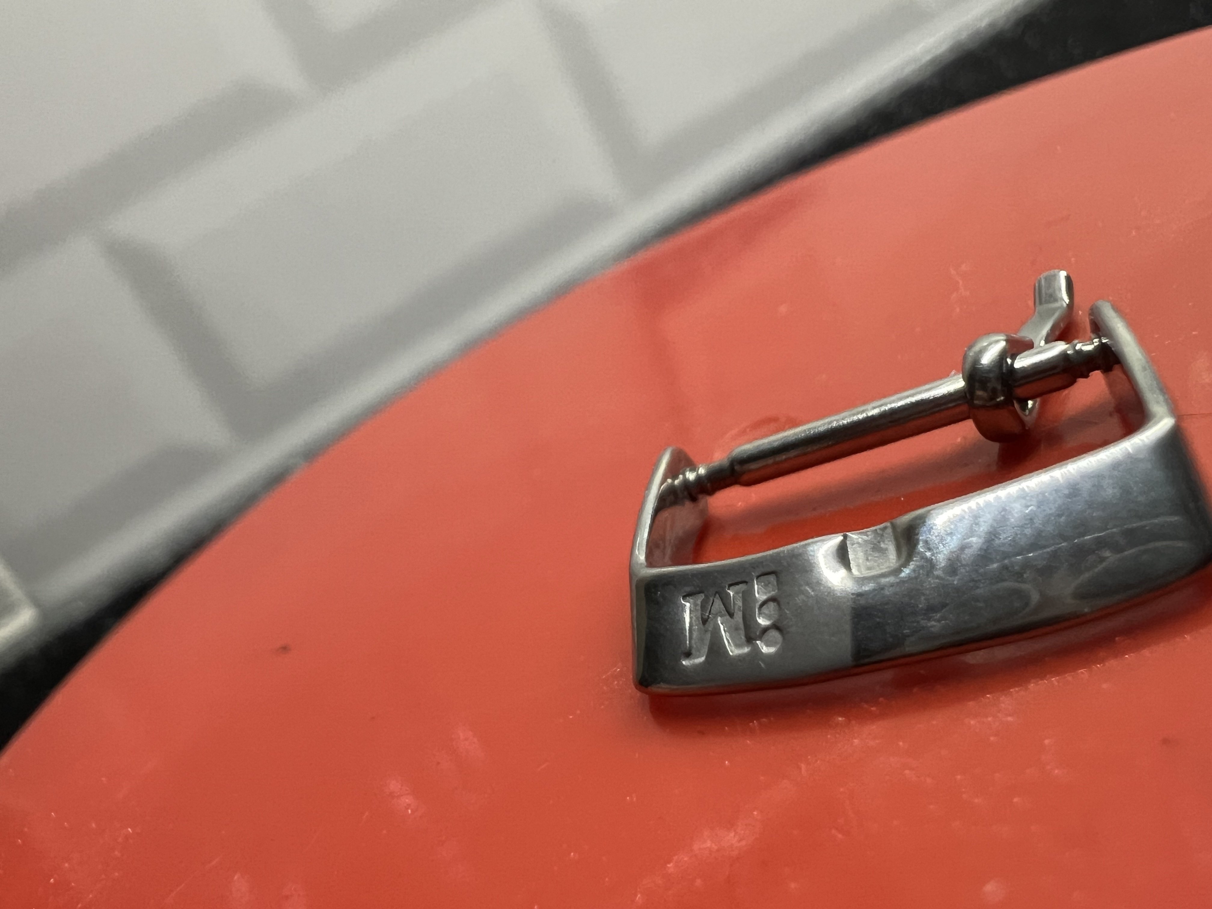

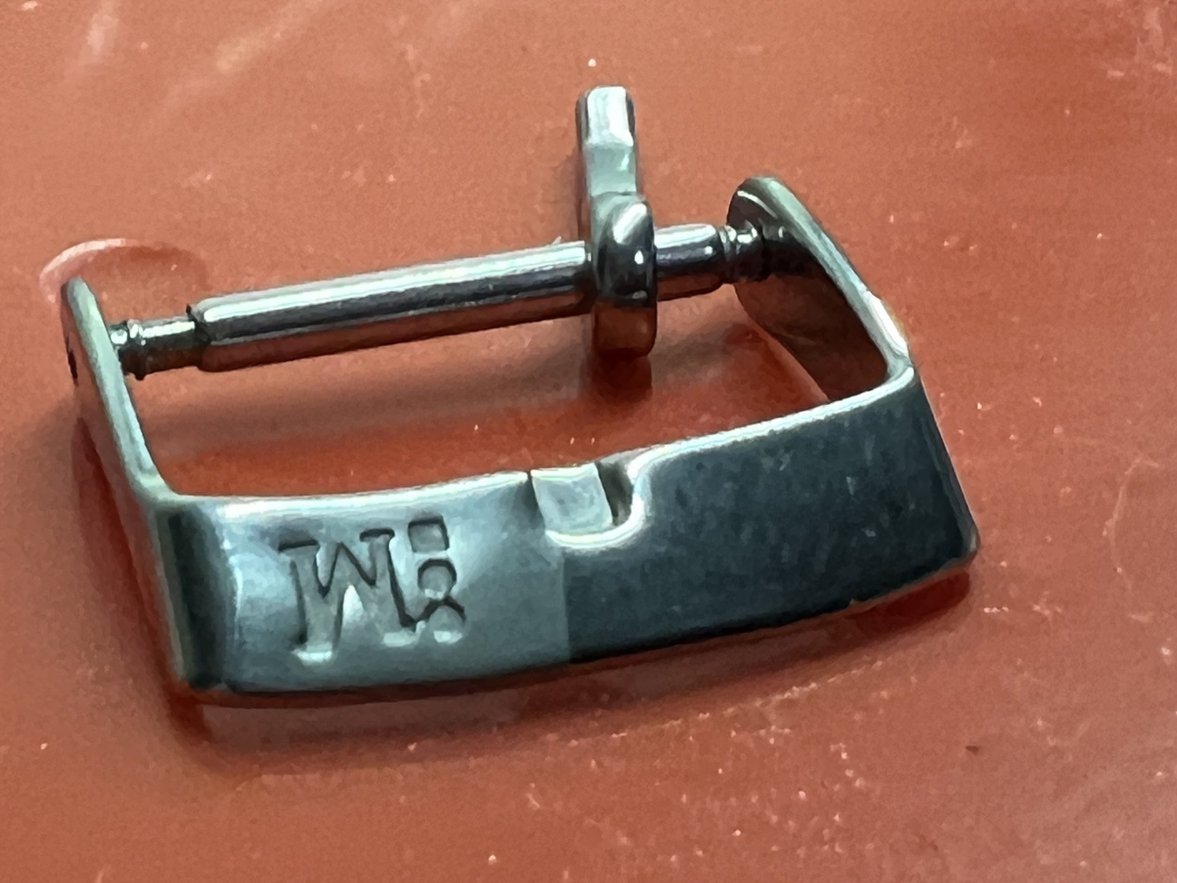

This is 180 grit with a weak blow, shiny part was masked
Not what I was imagining, but useful to reverse polished surfaces safely
I think anything noticeable would need a lower grit and a much stronger machine
