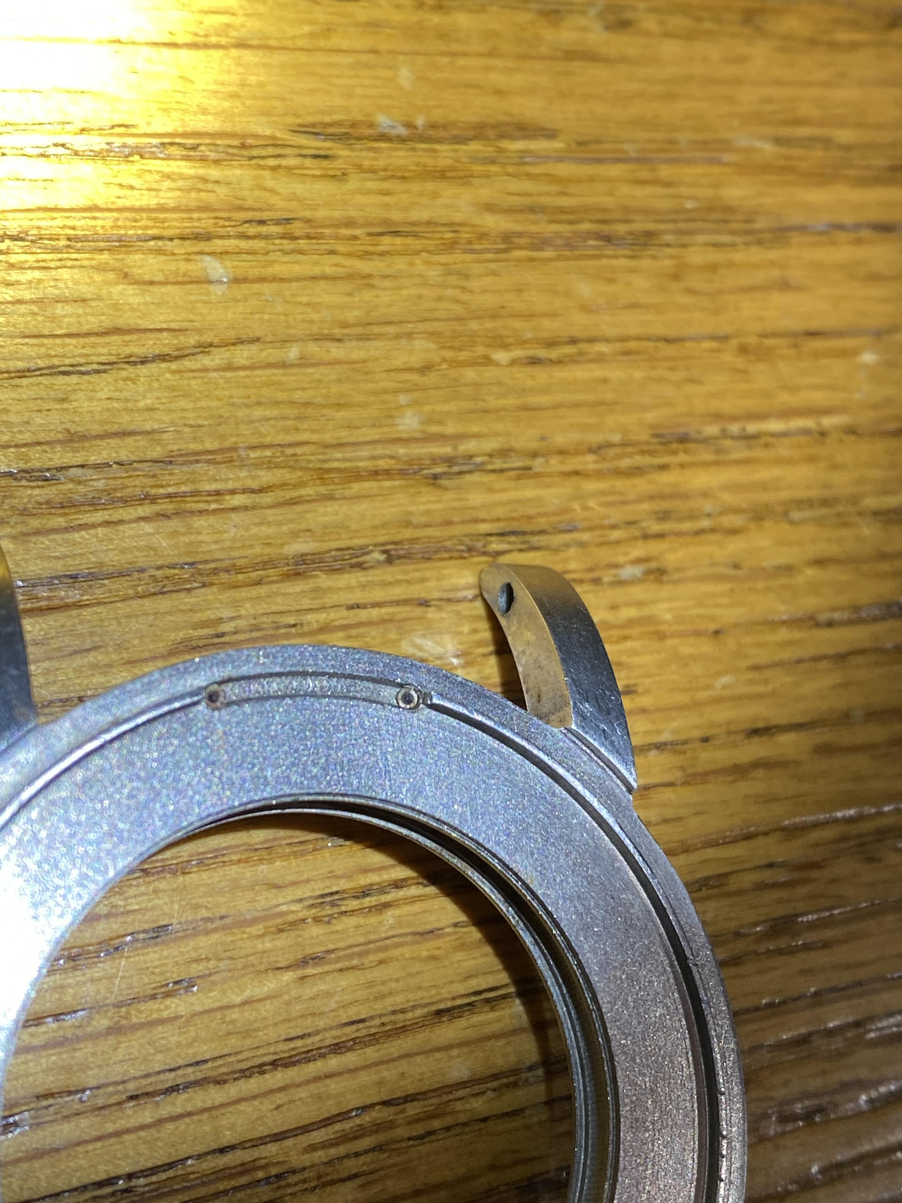

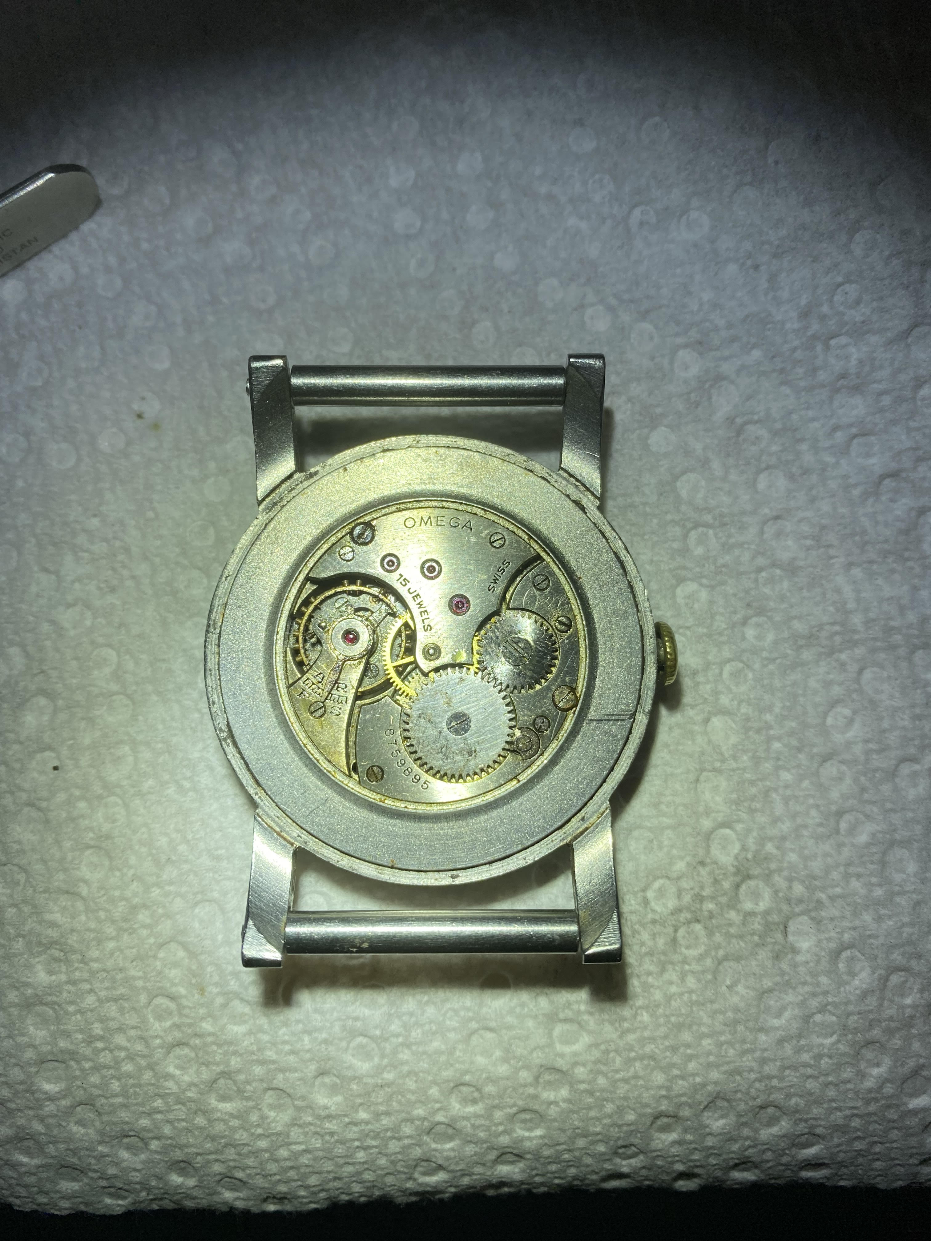

Hello all. I received this Old Omega watch in non-working condition and I was curious if any of you could give me advice on how to pursue repairs. I went to school for machining, and I am wanting to learn watchmaking for my own collective purposes. Hoping to work my way up to owning an old Constellation one of these days!
Anyway I don't know much about the watch other than it was brought to the US from France after WWII. I can tell obviously the minute hand and crown is unoriginal but I am not sure about the rest. The watch does not work and upon further investigation the hairspring is broken. Balance assembly and jewels all look good under magnifying glass and it spins freely. A little wind on the watch and the pallet fork is properly ticking back and forth (with a little persuasion since the balance is inoperable) The watch is incredibly dirty and FULL of old brown oil (it looks like rust but it is just dirt). When I removed the balance I saw it is movement number 26.5 but there is a B stamped above and I don't know what that means. Also on the front of the case there are two pins at the 6 o'clock mark and I don't know what they are for. Any suggestions with what to do with this watch would be great. I can see the case was originally brushed on the lugs and sides with the bezel and back appearing to be polished. Unsure as I don't have a true original to compare it to.
Also what would something like this be worth? It is not for sale as it is an heirloom piece.
If anybody has a parts movement they would be willing to part ways with I would greatly appreciate it. I am also looking for proper hands and crown.

whats the backplate like. are there any numbers. it loooks like it could be a weelms watch. but unsure. regards p

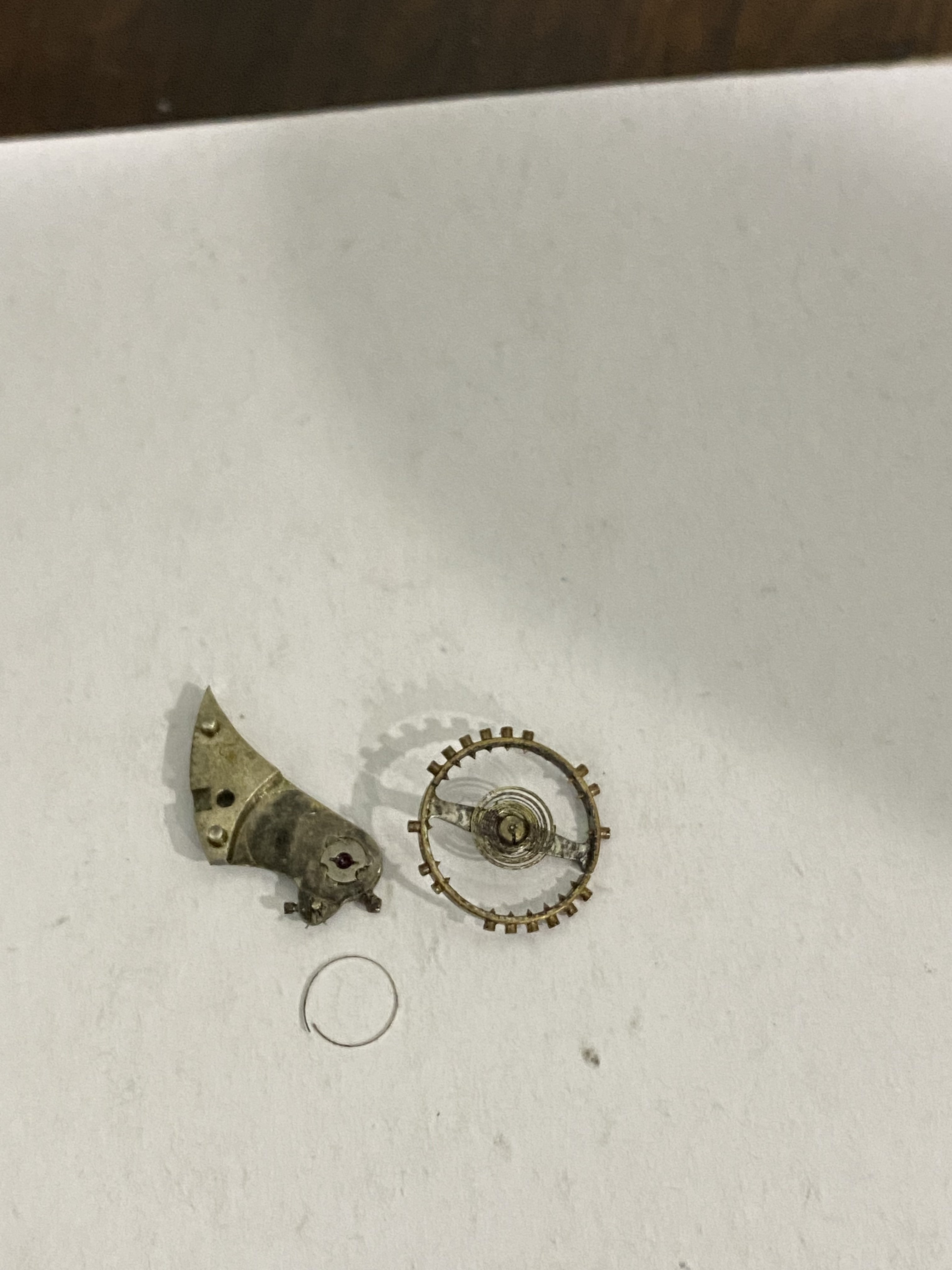

As I said the watch is absolutely filthy and I haven’t had a chance to clean it up yet. Her is a pic of the balance assembly. There appears to be about one full coil missing from the hair spring and it sheared from the stud

Too far gone I'm afraid.
These calibres will probably have different "balance complete" for plain or Incabloc designs as I think they came with both. As I recall there may also be bi-metallic and mono metallic balances. I also think that your watch is marked 26.5 SOB so should be a 26.5 T2 (there are a few variants).
Just be careful when buying a balance that you get the right one as they won't be cheap. You can't reliably switch hairsprings from one balance to another either as they are a matched pair.
For me, this will not be a good learning experience so, consider sending it to a watchmaker who will sort everything. Then, buy an ETA 6497 or 6498 movement to learn on.
Good luck, Chris
