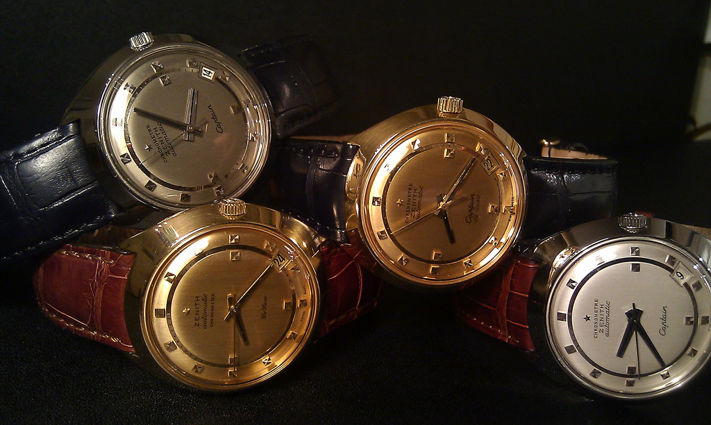

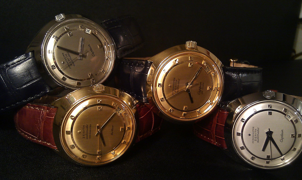

Those are the ones. I find the designs just extraordinary. They seem like they are designed in the past to represent the future.
16,918
48,150
Commonly known as the Zenith Turtle.
