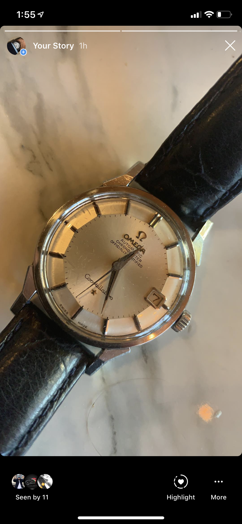

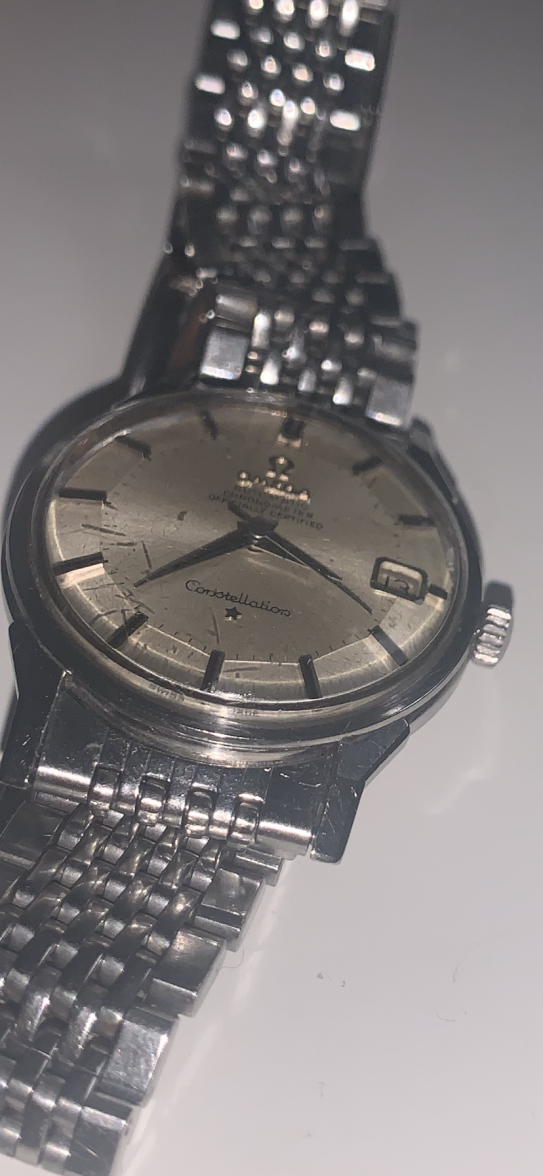

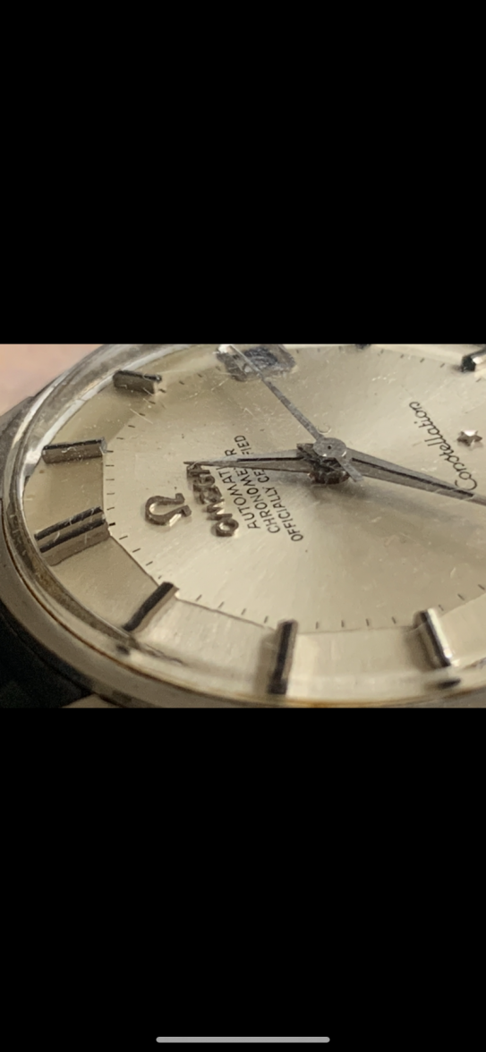

Typically it does the trick for my JLC Chrystal but I was told I should have it buffed out via machine. I was also told to use very thin sandpaper which I’m not comfortable experimenting with.
I’m inclined to just leave it alone at the risk of causing damage to it. Any advice?
I do enjoy a few scratches and character to the case. Wouldn’t mind a clearer view of the dial tho.
