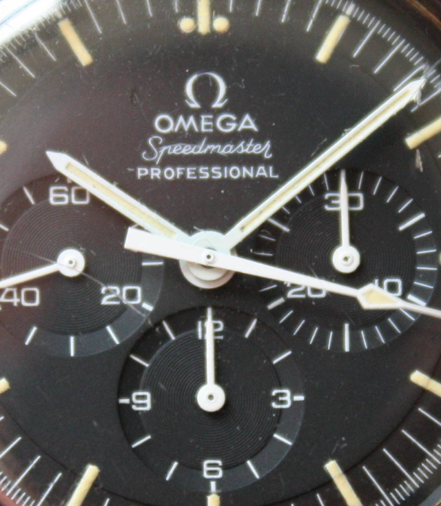

Anyone have personal experience with polywatch glass polish? Amazon reviews seem mixed.
Yes. That’s why I mentioned it. It works, but takes time and effort and as a say the results may not be the perfect clear view you hope for, removing a deep scratch may lead to a ripple effect where the crystal no longer passes the light uniformly. Results with sandpaper are better on plastic crystals as you are taking more material off, with glass or sapphire really you are just softening the edges of the scratch. It’ll look better than before but a new crystal is the real answer if a perfect outcome is required.

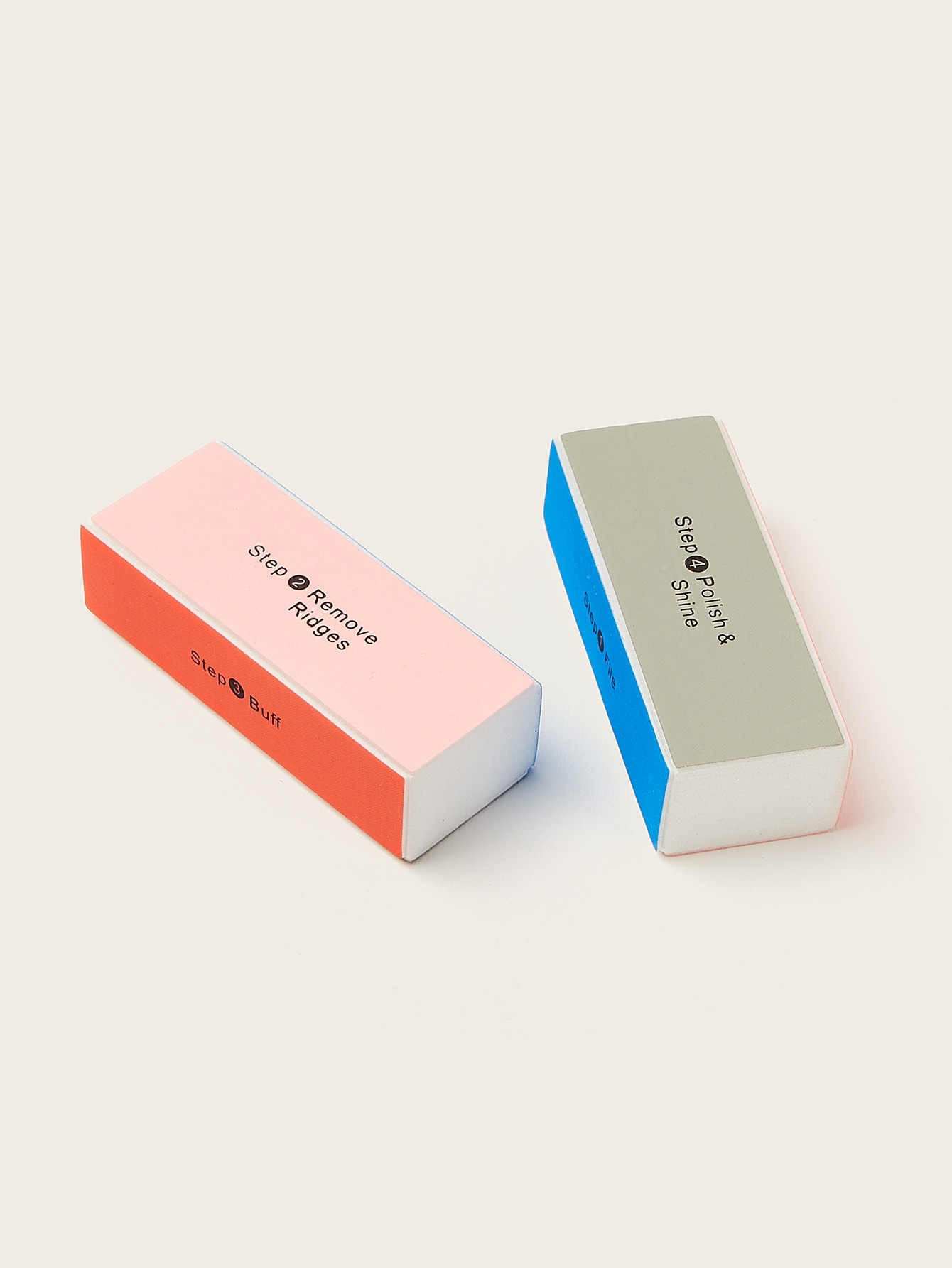

For plastic crystals I use one of these and Polywatch:
It’s called a “nail block” and can be had for around $1 at a beauty supply store.
As stated above, the idea is to remove a small amount of plastic down to the level of the deepest scratch. The friction from rubbing the Polywatch in will liquify the plastic to fill in shallow scratches. I find that once you are done, the crystal will look better the next day once the plastic has hardened again.
This technique becomes less effective with deeper scratches as it is difficult to remove enough material to allow them to fill in. In those cases, you have no choice but to replace the crystal.
Glass and sapphire crystals are too difficult for me to work on, so I would just replace those if possible.
Hope this helps.

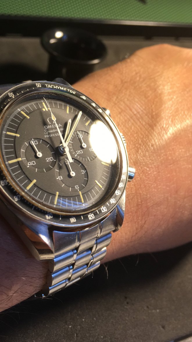

Me. I used it today on my speedy SW here is the result:
Before
After
Before
After
He’s taking about Polywatch for glass crystals. You presumably used regular Polywatch since that is an acrylic crystal.
