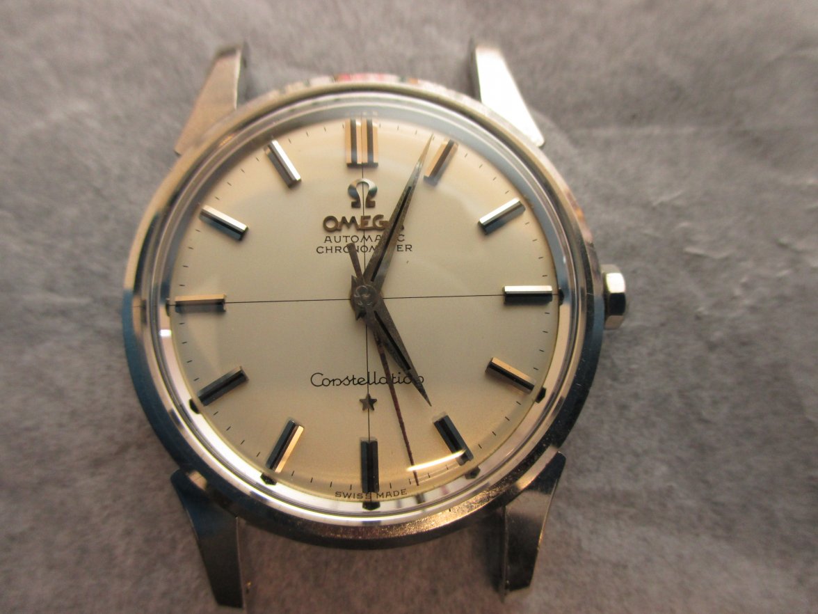

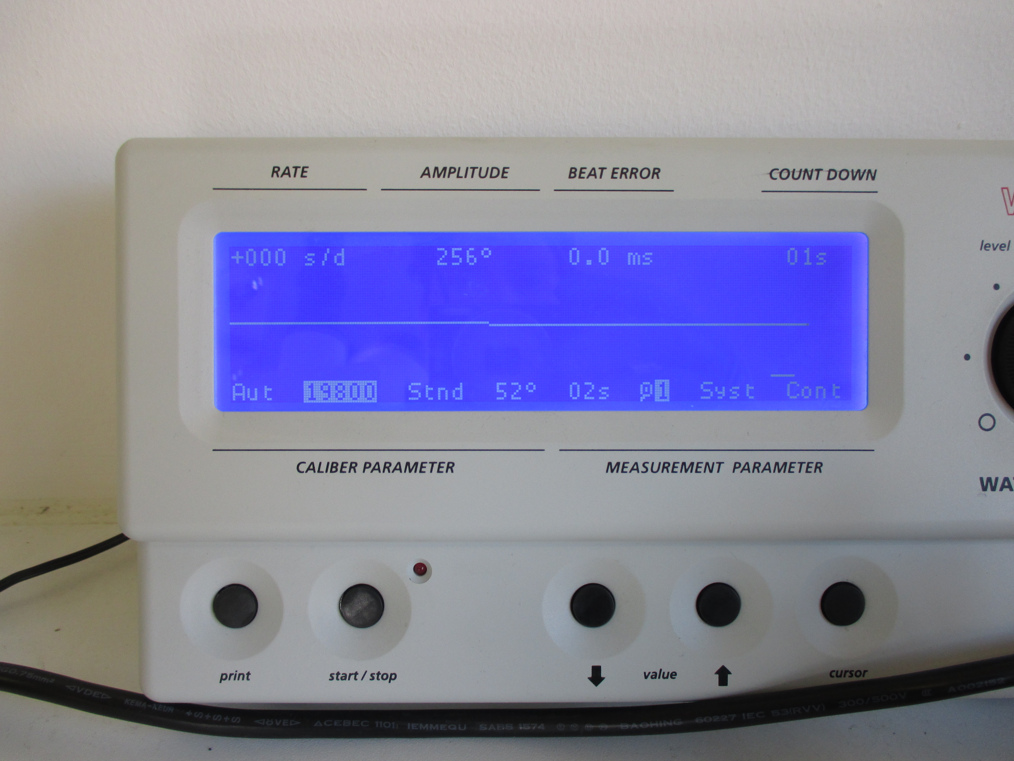

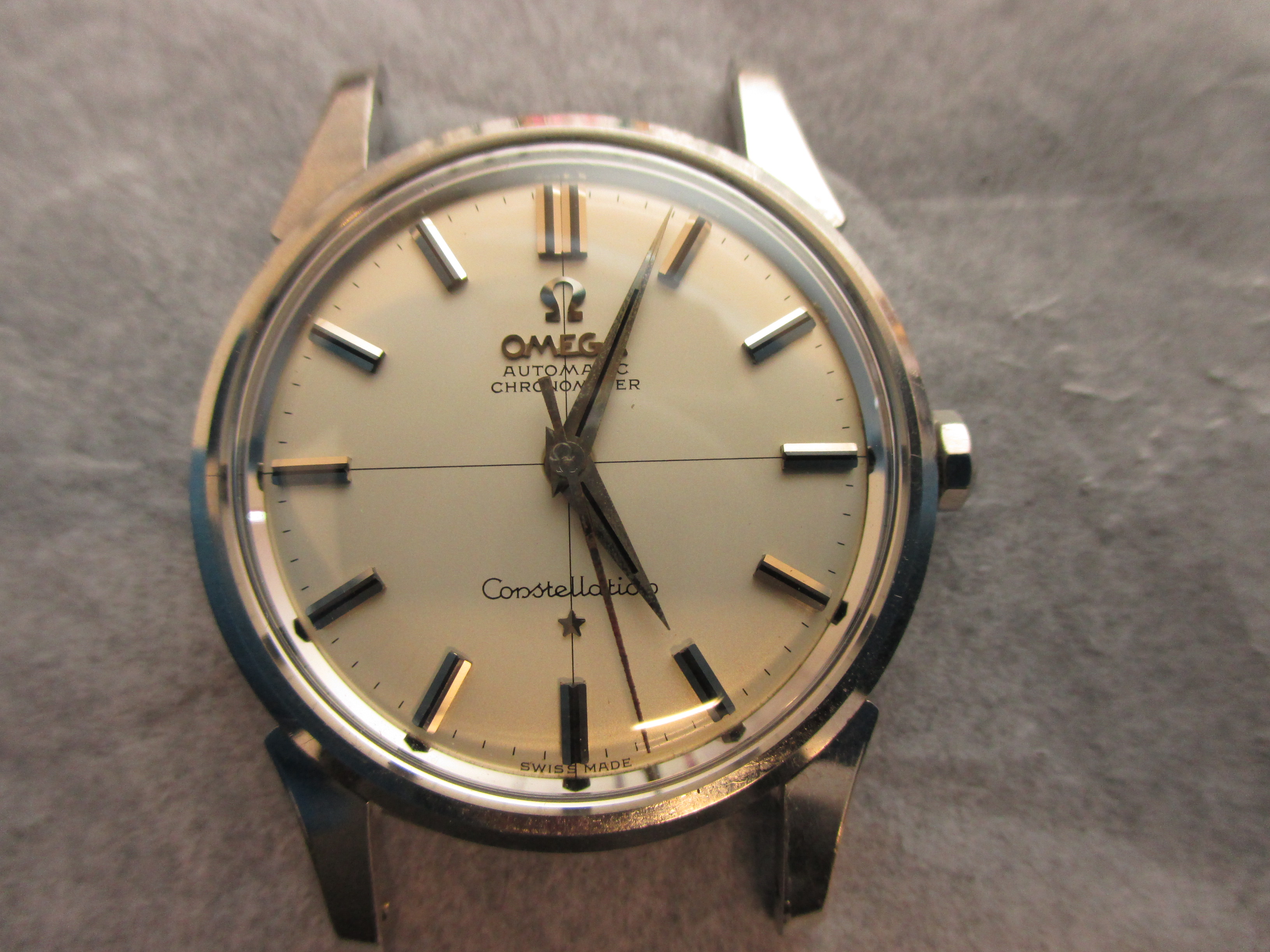

After servicing and regulation with 'Watchguy' (thank you Mitka) my new Constellation 14381 cal 551 is currently running at plus or minus zero seconds per day -51 years after production!
-eat your heart out Rolex...
Happy? -as a pig in sh*t
pics
I have succumbed -and the rusty seconds hand will be replaced
(but the tarnished 'Omega' will be retained)

A zero rate in one single position is certainly a good start...but definitely not the end...

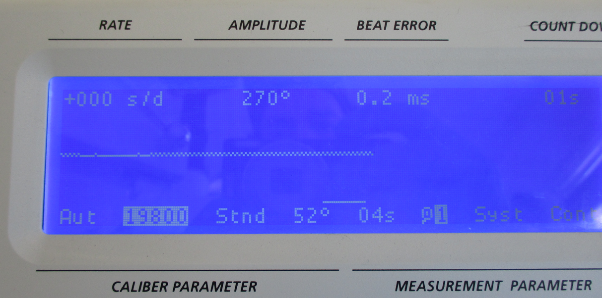

Here's my 564 after a visit to the same team:

The static reading in one position is going to be different than the dynamic timing and the timing when the watch is worn.
The BHI recommended practice for timing is always a gain, typically +3 s/day, then of course there is the timing in 5 positions and what those results are, and most of the time the vertical positions are quite different than the horizontal ones as far as rate goes. Then there is the reality, that being what does the watch do when the owner is wearing it, as with the variations in positions, the rate when worn is going to be different again.
The risk of timing to 0.00 rate is that the watch when worn will probably show a loss, and customers always consider a "slow" watch as having a defect or not being adjusted properly, whereas a watch that "gains" is considered as running properly.
Of course it's up to each watchmaker to adjust to the rate he's decided produces the best results.

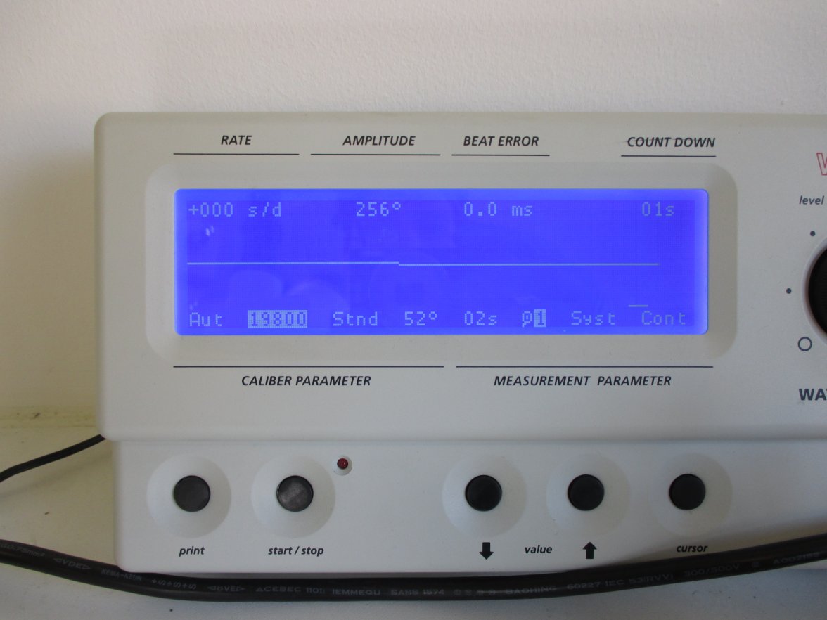

Look good, but remember to set your lift angel to 49 I can see is it set to default 52. It gives a lover amplitude at 49.
You can find the lift angels for Omega's here:
http://longines30l.com/wordpress/?page_id=597
-now if I only knew what a lift angle was......👎
The lift angle is the arc of the balance (in degrees) when the impulse pin (roller jewel) is in contact with the pallet fork, as the fork travels from one banking pin to the other. It is in this period of time that power is being passed from the train to the balance wheel.
The importance of this for the timing machine is that the lift angle is used to calculate the balance amplitude reading. If the lift angle is incorrect, as shown in both photos in this thread, then the balance amplitude readings are also incorrect. A rule of thumb for is that for every 1 degree the lift angle is in error, the amplitude will be in error approx. 6 degrees. So since the machine is set for 52 degrees instead of 49 degrees, the lift angle is off by 3 degrees, meaning all the amplitudes you see here are about 18 degrees lower than what the machine displays.
So the amplitude of the balance in your photo is not 256, but more like 238...if this is full wind dial down, that's a bit low for my tastes personally.

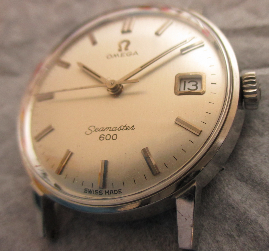

And, how about this for a '66 Seamaster 600. Excellent work from Christian and Mitka
6,078
9,415
nice watch -congrats on that beauty

I really appreciate the expert comments from our resident watchmakers -thank you so much (genuinely educational)
-especially the lesson on lift angles from @Archer
(although I perhaps liked M'bob's explanation a bit more 😉 )
I think we have to be a bit careful about comments on the info we amateurs have posted about Christian and Mitka's work without their knowledge or permission
the measurements shown are just one snap shot of the tests that the guys do immediately after service to show the difference between before and after
they certainly do not intend to pander to innocents like me
I know that the watches then spend several more days being tested in 'all five' positions before they are happy to release them back into the wild
I did say my post was a little gratuitous -and was intended for a bit of fun
I think I might avoid technical discussions in the future as they are obviously well beyond my current watch collecting skillets
-perhaps for the immediate future it might be safer if I restrict my comments to "ooh!, pretty!' 😟
