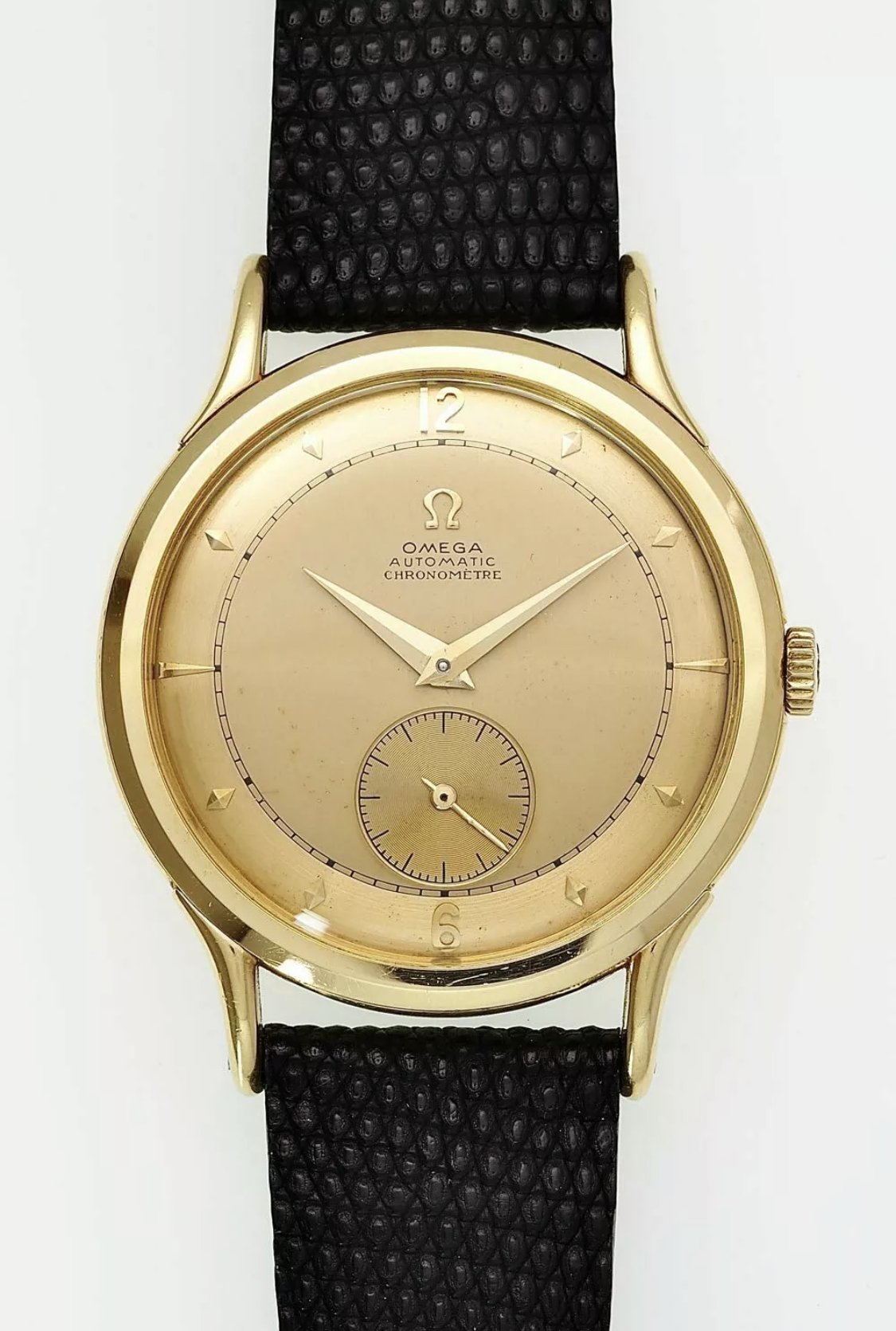

Omega Centenary from 1948 all had signed crowns, if that helps.
However, I think the signed crystals were a bit later.

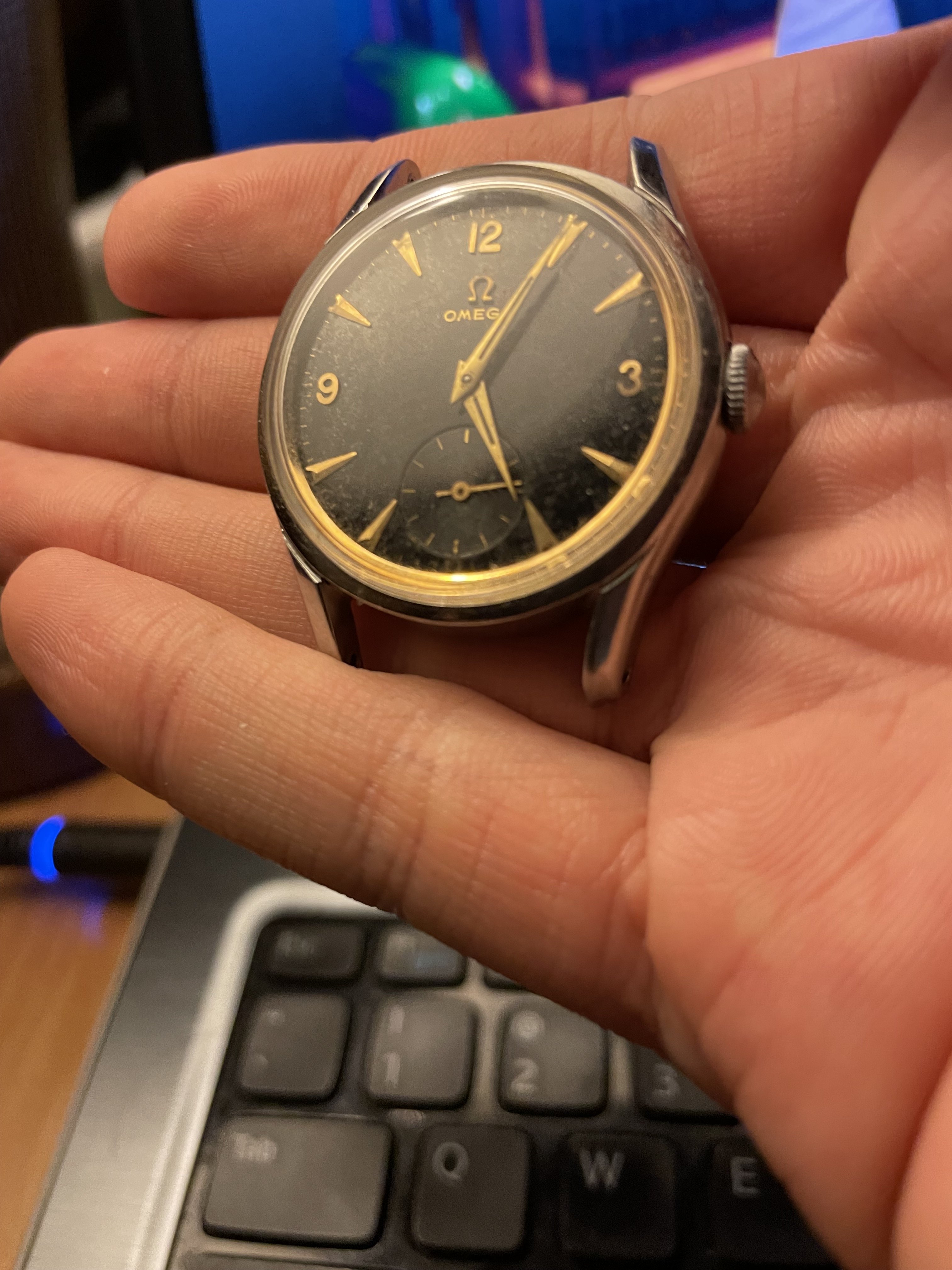

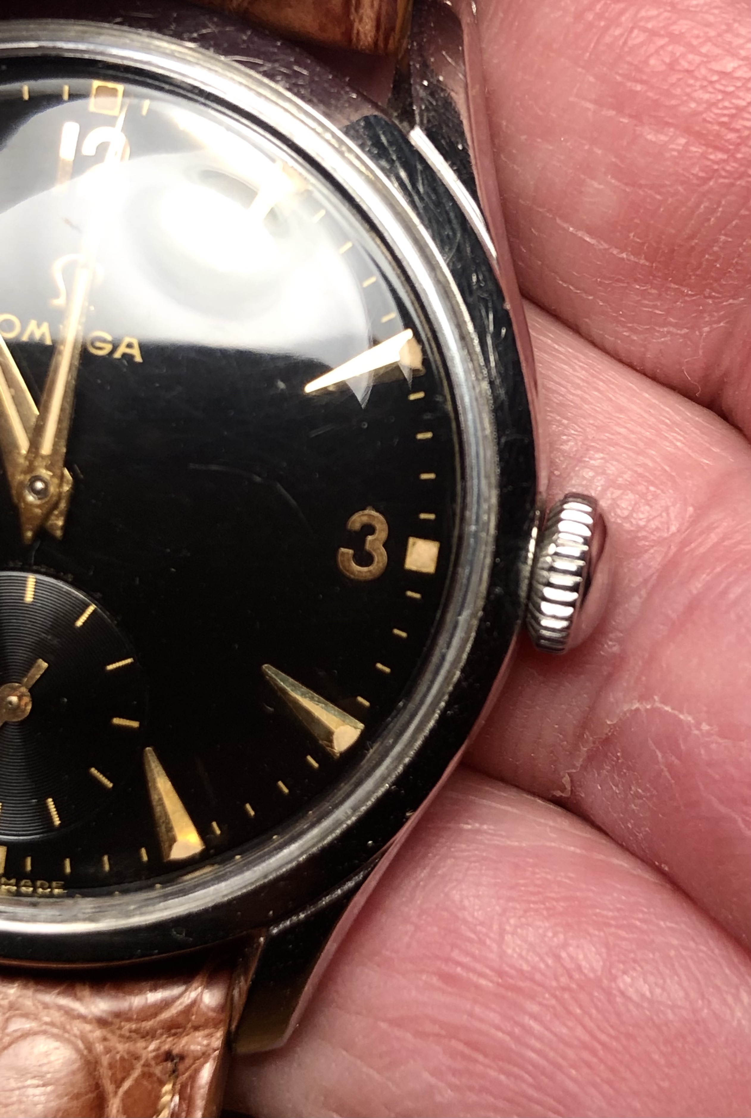

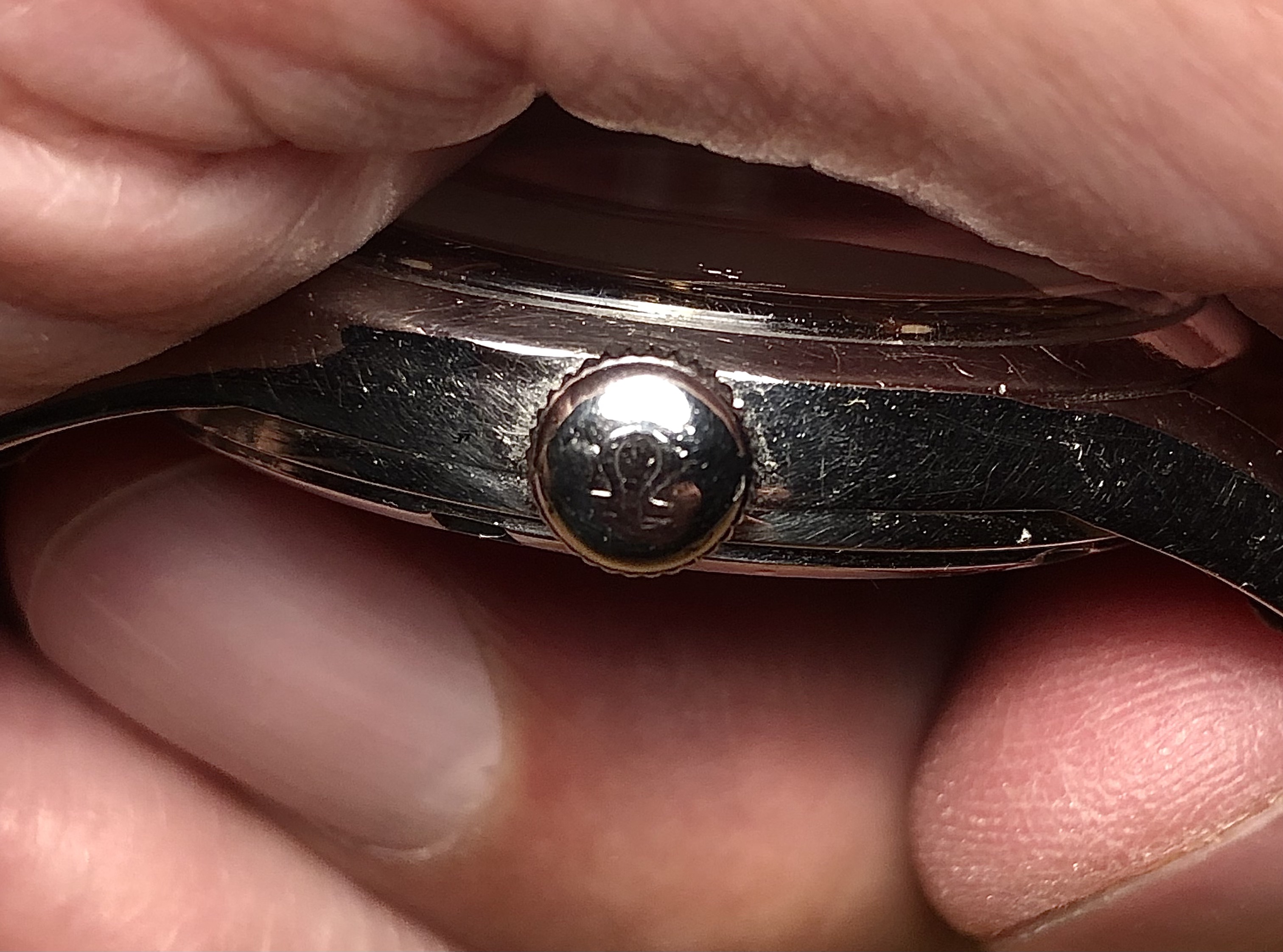

I got four 2639´s - one of them certainly has a replacement crown. Two, both from 1953, are at the watchmaker, but I am certain at least one of them has a crown identical to this 1952 model.
2,816
6,951

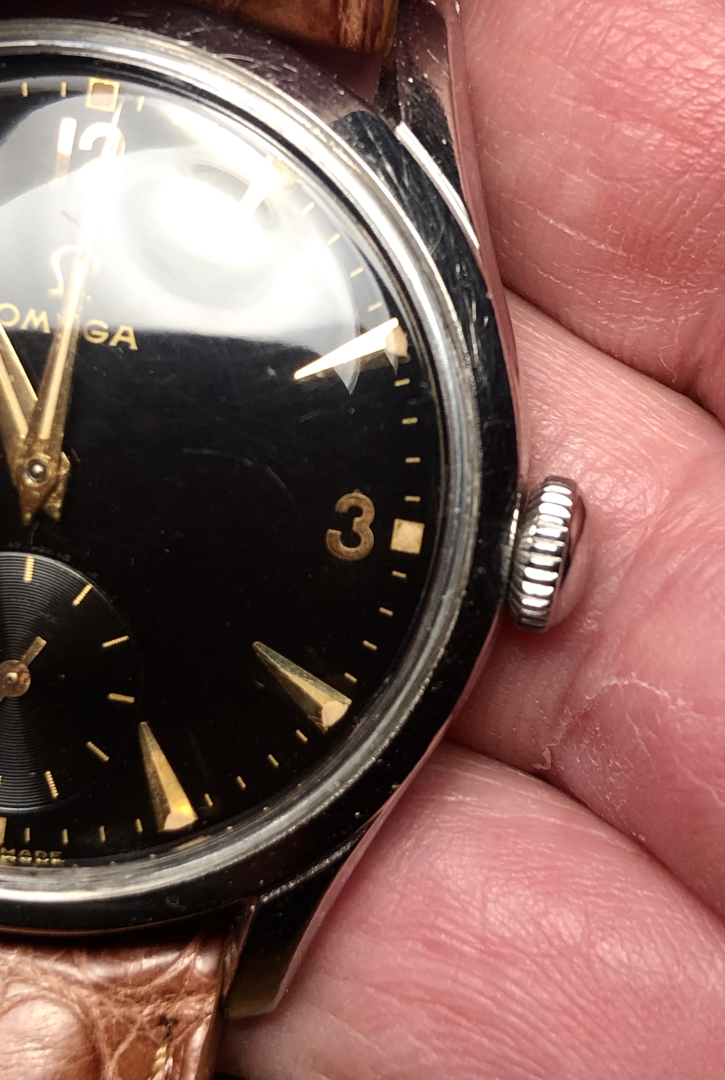

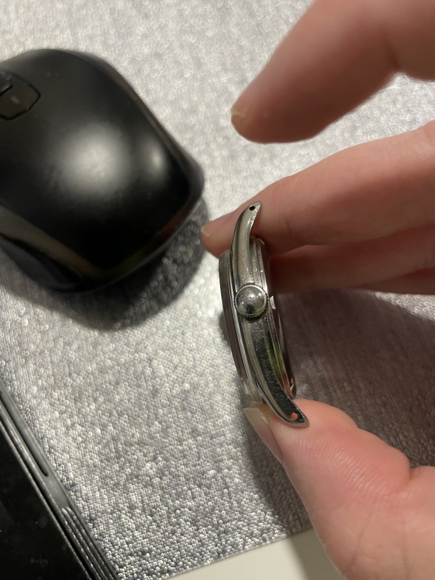

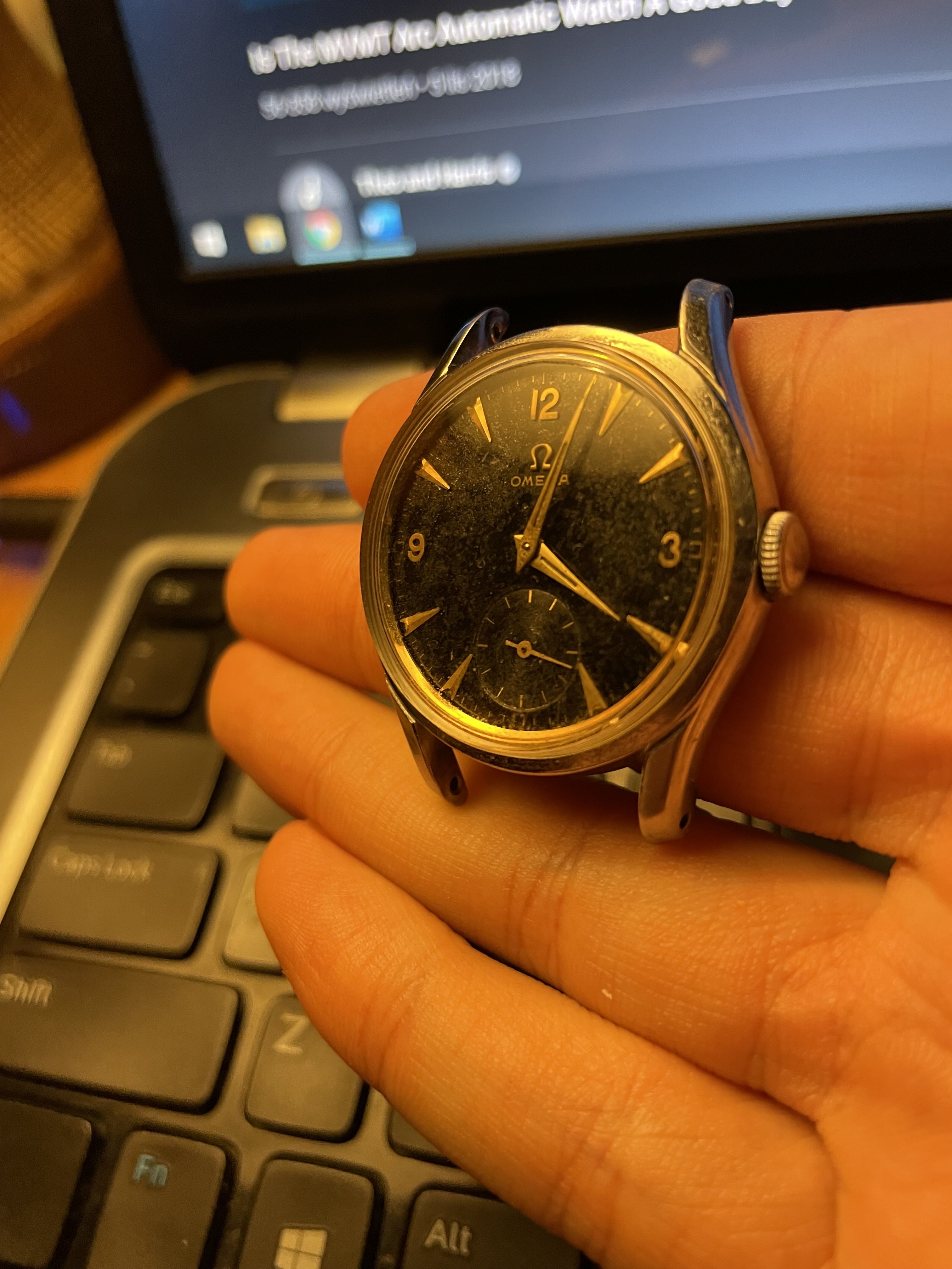

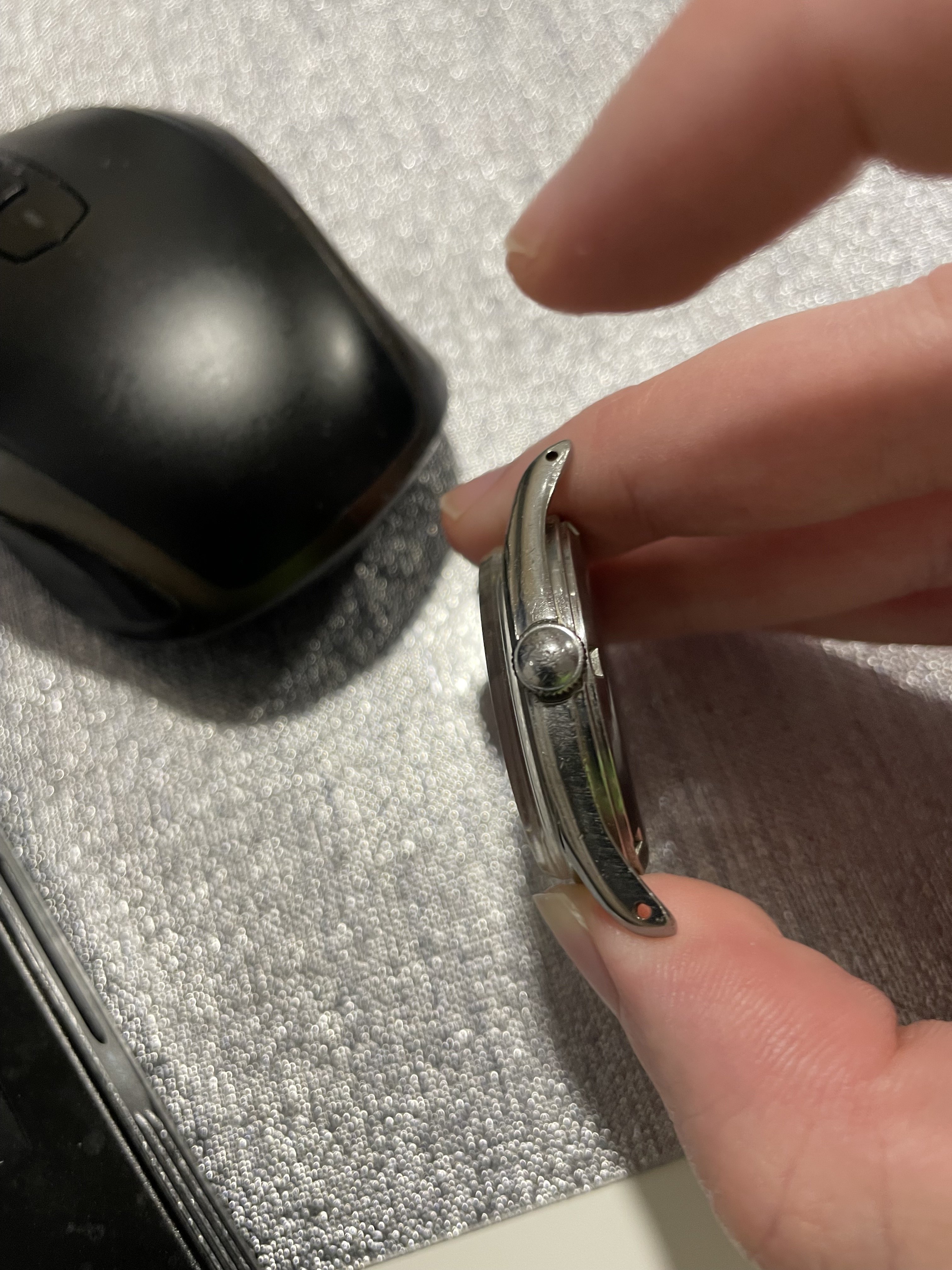

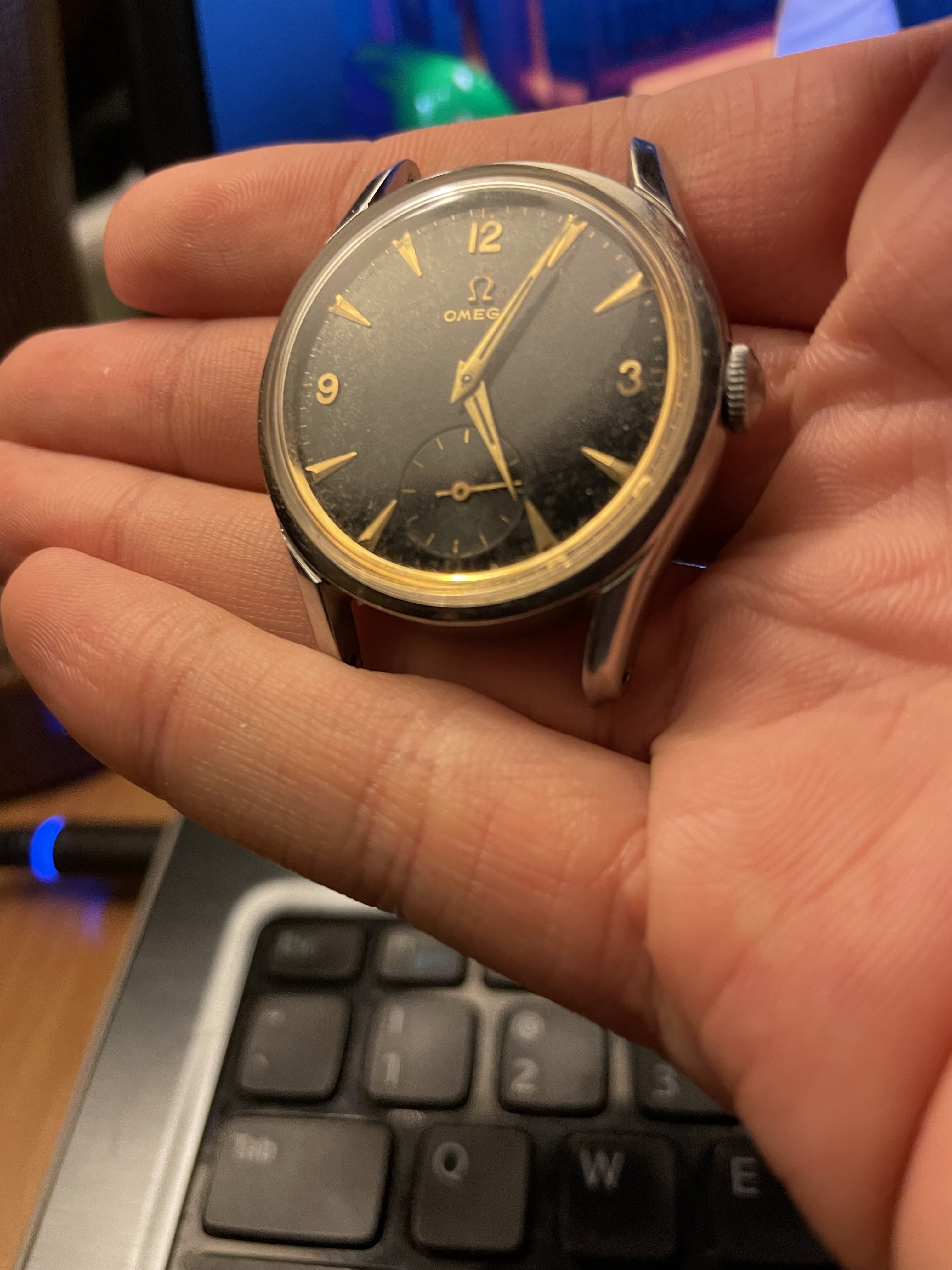

In case it helps, I think this is the same as was on my 2640 as well:

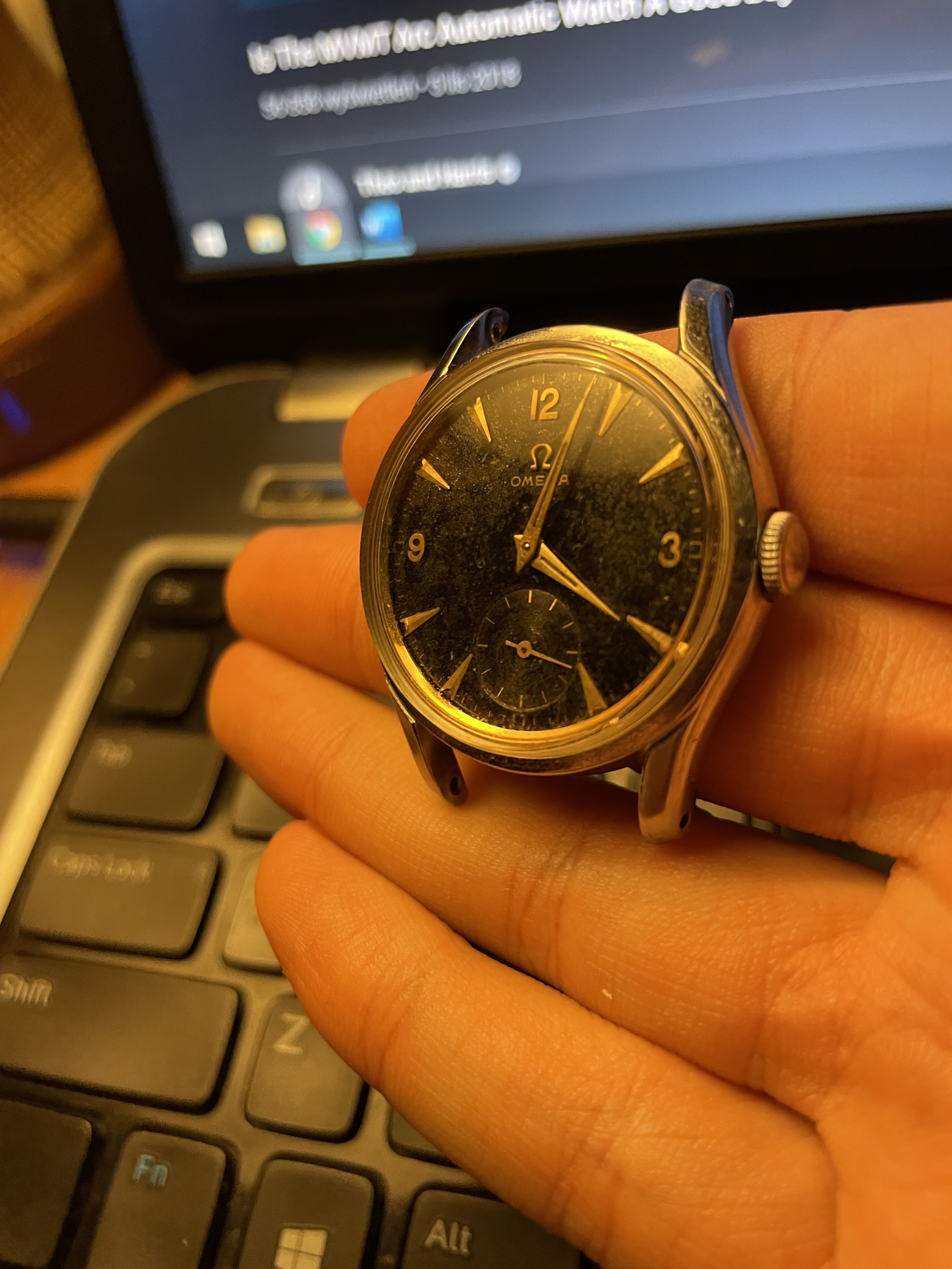

My 2639-13 from 1952. And yes I know the crystal and tension ring are not original-waiting for the correct ones to come. As for the crown I don't think it was ever replaced. It's not logged.
