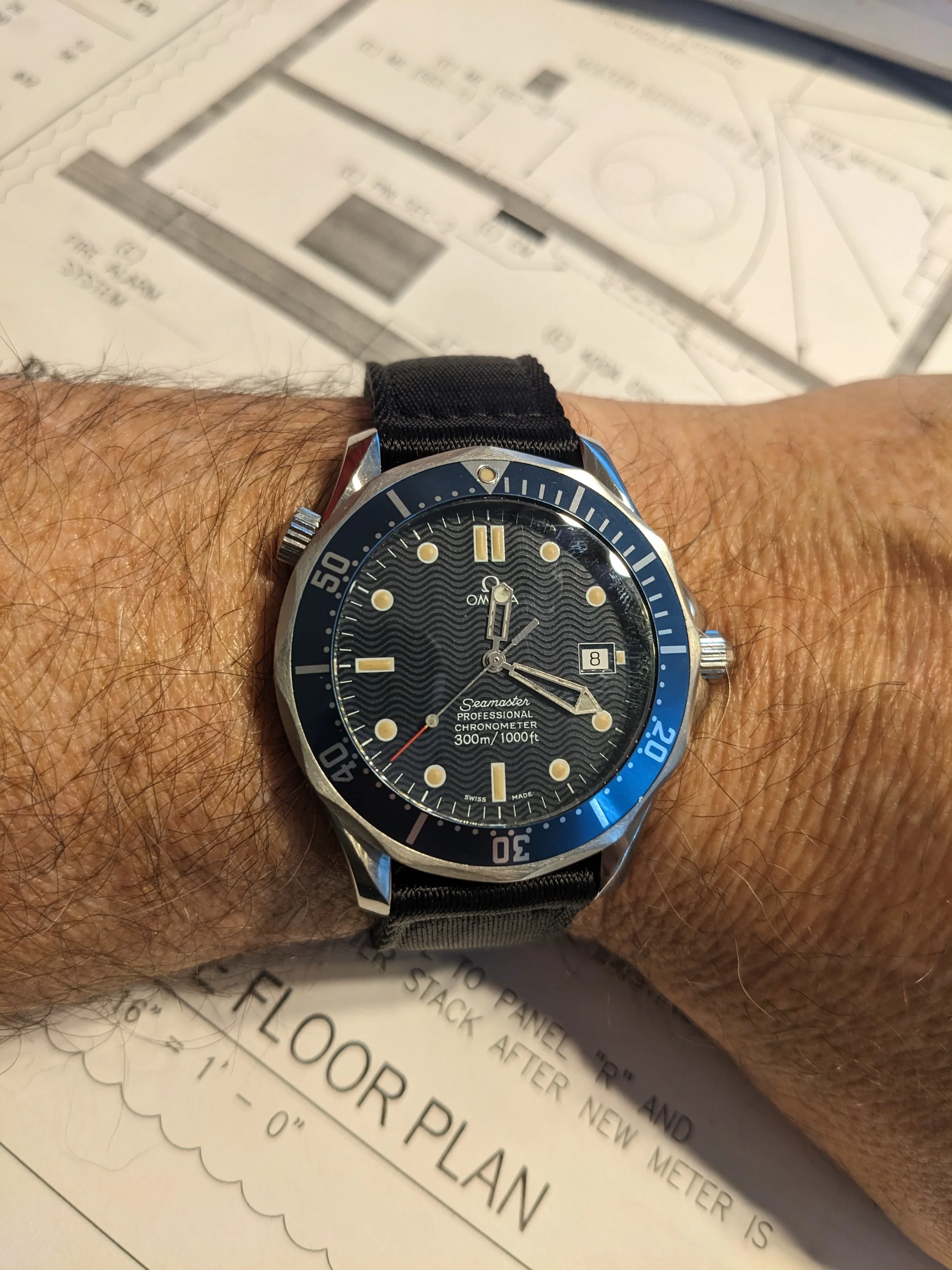

When did Omega stop using tritium? Was it at the same as Rolex? (which I believe was 1997-98)
The reason I ask is that I own a quartz Omega 2541.80 (the GoldenEye watch) that has a serial number dating to 1995. But the lume on the dial and hands glows after charging with light. I've seen many trititum Bond SMP's and they have usually developed a yellowish color as the tritium has aged. Mine has not and it has the characteristic white/green coloration found on Superluminova.
So I'm assuming my watch was serviced by Omega at some point and the dial was replaced by a Superluminova version. And the hands as well.
Not a problem, as I wasn't intending to buy tritium dial and hands when I bought this 5 years ago. But right now I'm just curious.

The issue here is likely your dating of the watch. What is the serial?
ps SL lume wasn’t seen on any model until late 1997. The 3570.50 had tritium in its first year.

55,873,XXX

Instead of trying to translate serial number to year and the estimated year to the type of lume (which is just based on previous estimates and personal opinions, and can lead to all sorts of uncertainty), you should probably do explicit research on your particular reference. In your place, I would try to identify 10 example of that watch in a reasonably close serial number range, and make note of the dial and lume. Then you can post the results of your research and the thread will serve as a great resource for people in the future.

Based on watches I have owned and handled, in fact think you might be right to think that serial is indicative of 1995/1996 production, so as you suggest still in the tritium era. Perhaps your watch did indeed receive a new dial and hands at some point at a service. It wouldn't bother me, many watches look much better with tritium lume but IMO fully functional clean bright Superluminova suits the SMP since the tritium examples often look mismatched and tired.
