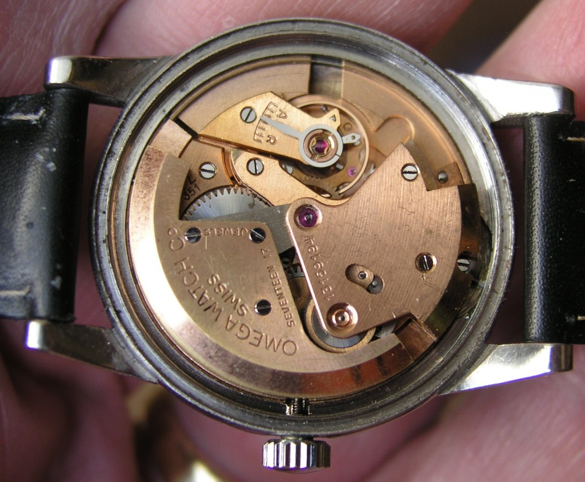

15,996
48,112
I have an Omega caliber 355, date at 6:00. Sure it is far more inconvenient to re-set the calendar than modern quick-set calendar watches, but how is the 353 caliber the “worst”, or worse than a caliber 355, may I ask?

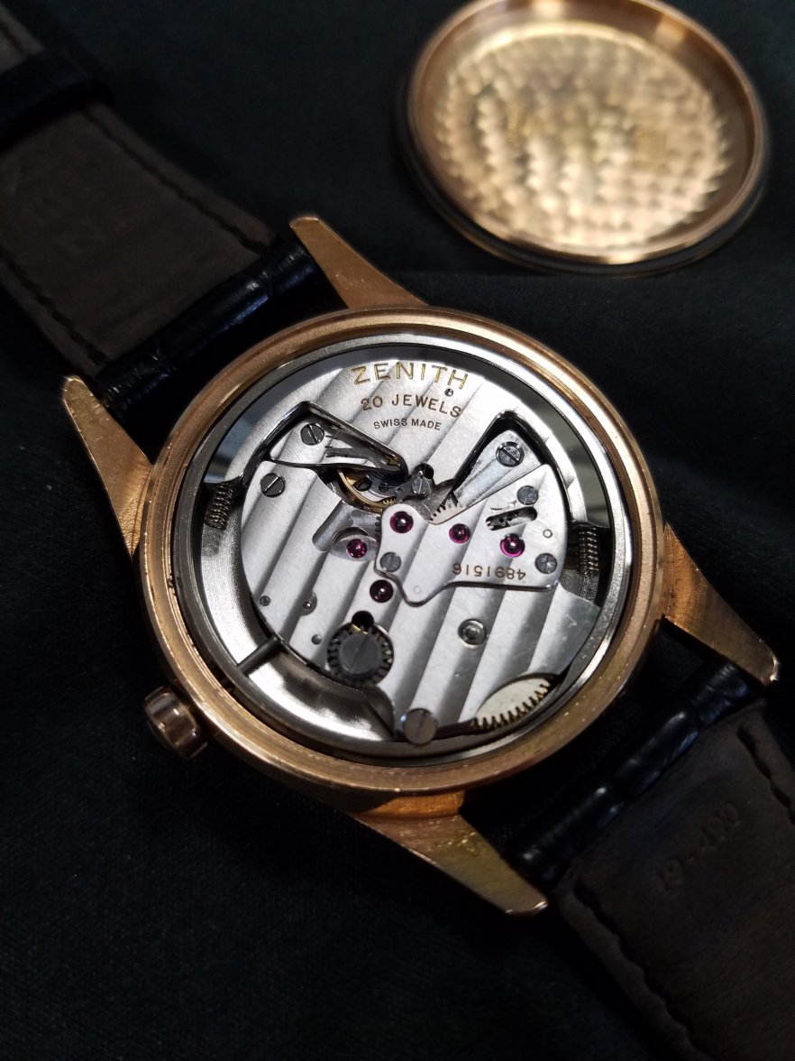

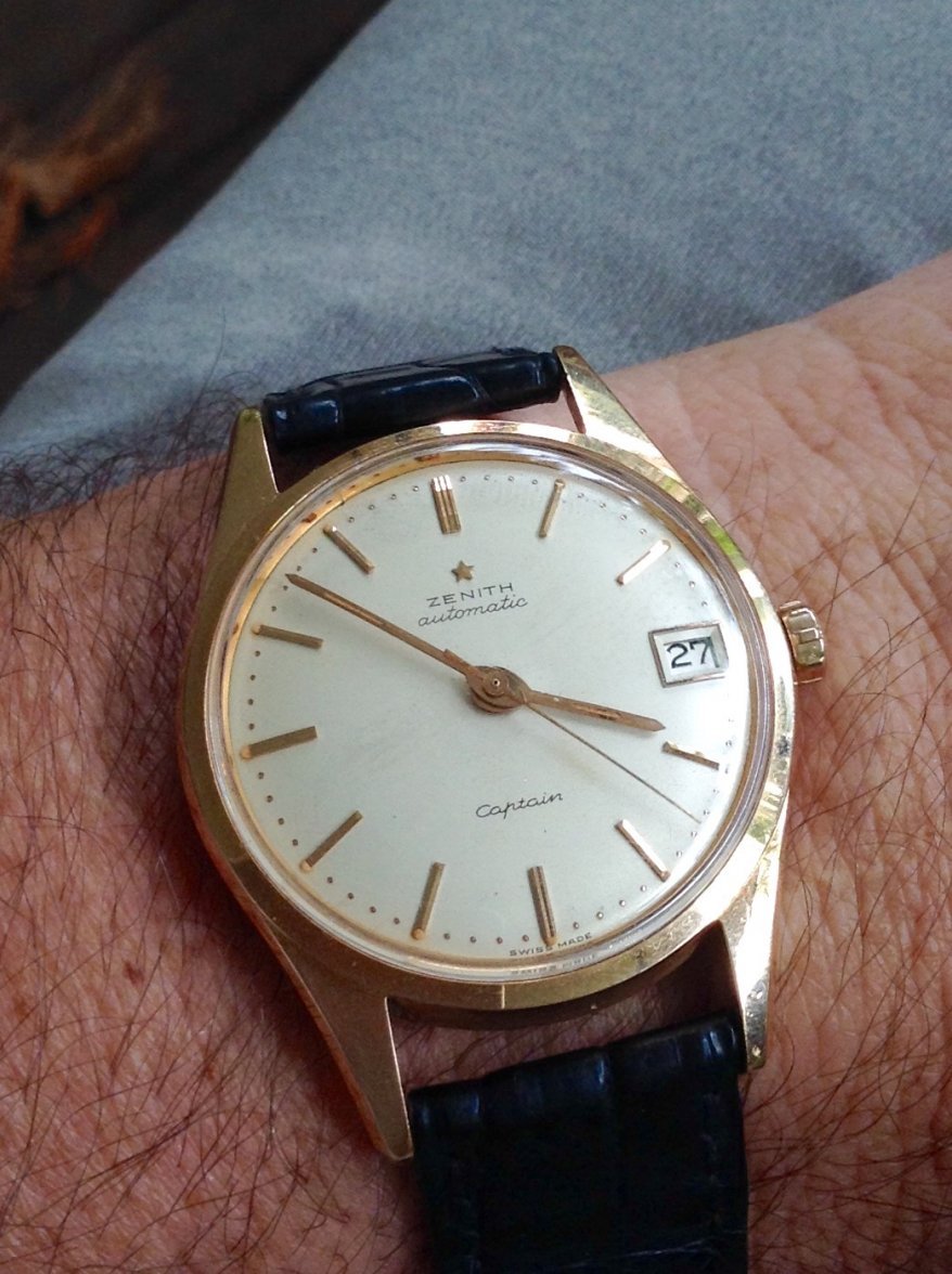

Plenty of great bumper movements that are sought after by many here. To write off bumpers would be crazy in my book.....

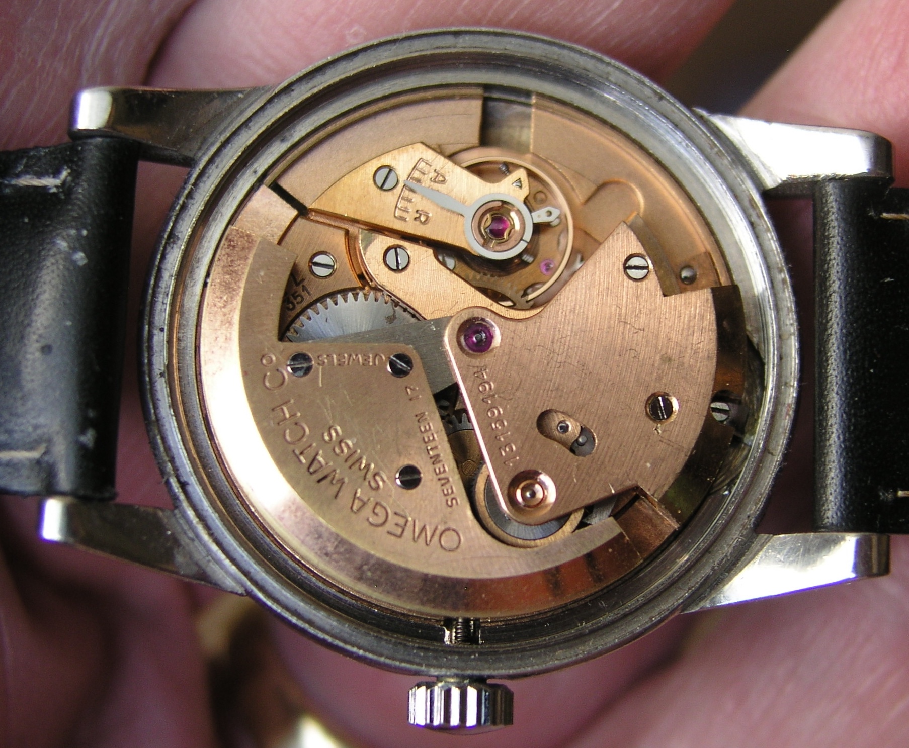

15,996
48,112
Likewise. Omega caliber 351. Acquired as a basket case. But today, an excellent performer and timekeeper.
