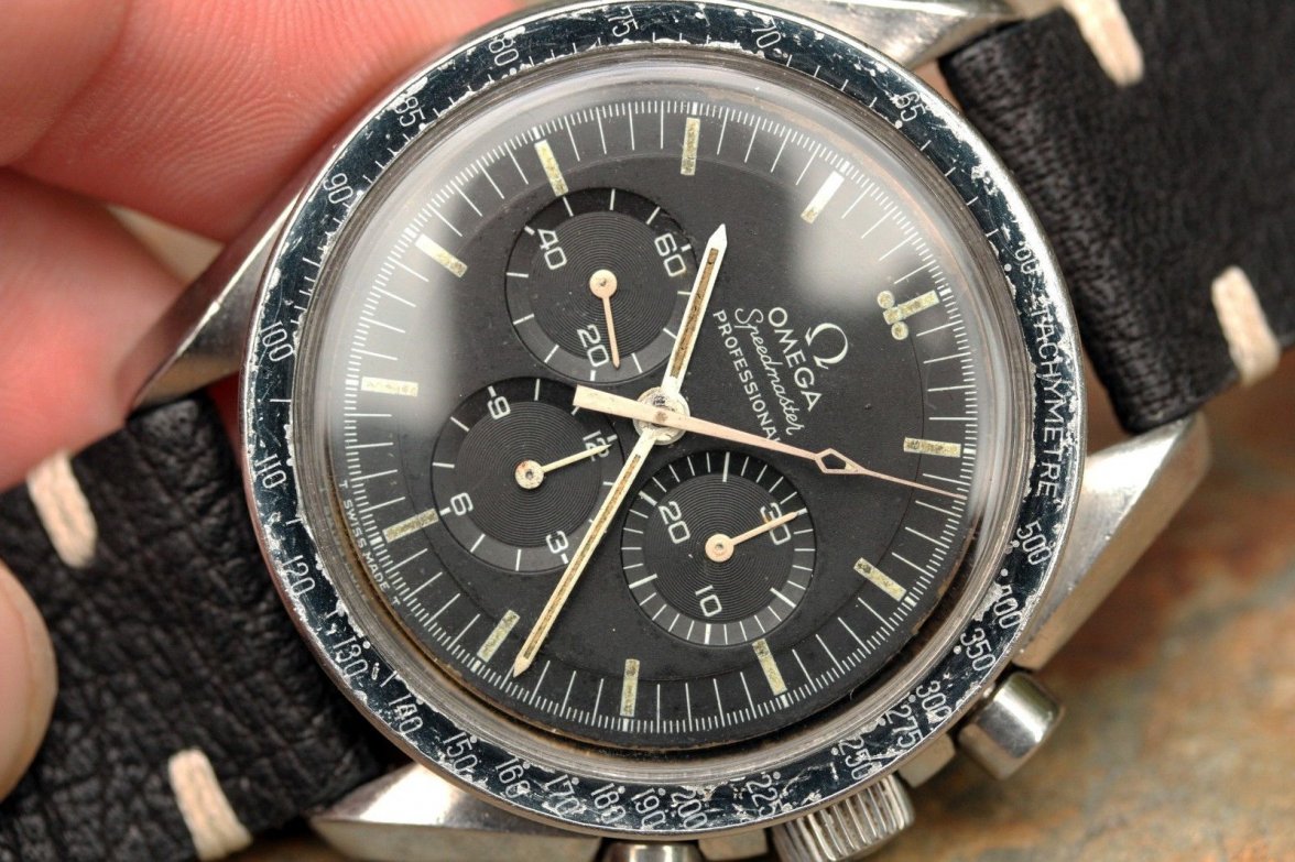

    Looking at this 1969 Speedmaster DON.
    What's up with this dial coming away from the side of the watch? s-l1600 (3).jpg

    Missing tension ring.

    Ah I see, easy to replace? It has DON bezel. Otherwise may class as 'running'.. not good, condition..

    Looking at the edge of the dial, I would say somebody removed the tension ring to keep it from rubbing the dial further. You probably should just replace the crystal to be safe. Should be about $50-$75.

    The movement could be missing the dust cover and is moving in the case.

    Yep, definitely a 'running' example - should be priced accordingly.
