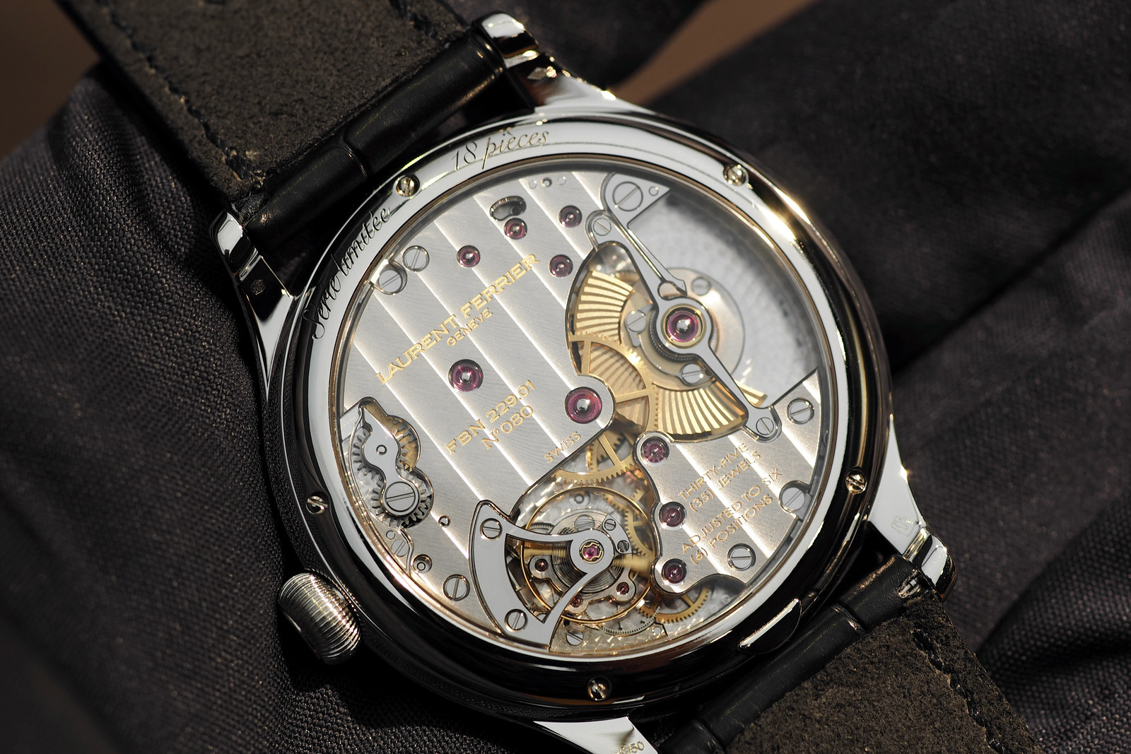

I agree that a manual wind has more interaction, however an automatic is also convenient, especially if like me you forget to wind the manual every morning. As others have also mentioned there are some beautiful automatics, especially some of the micro rotor models, like this Laurent Ferrier (photo from internet)

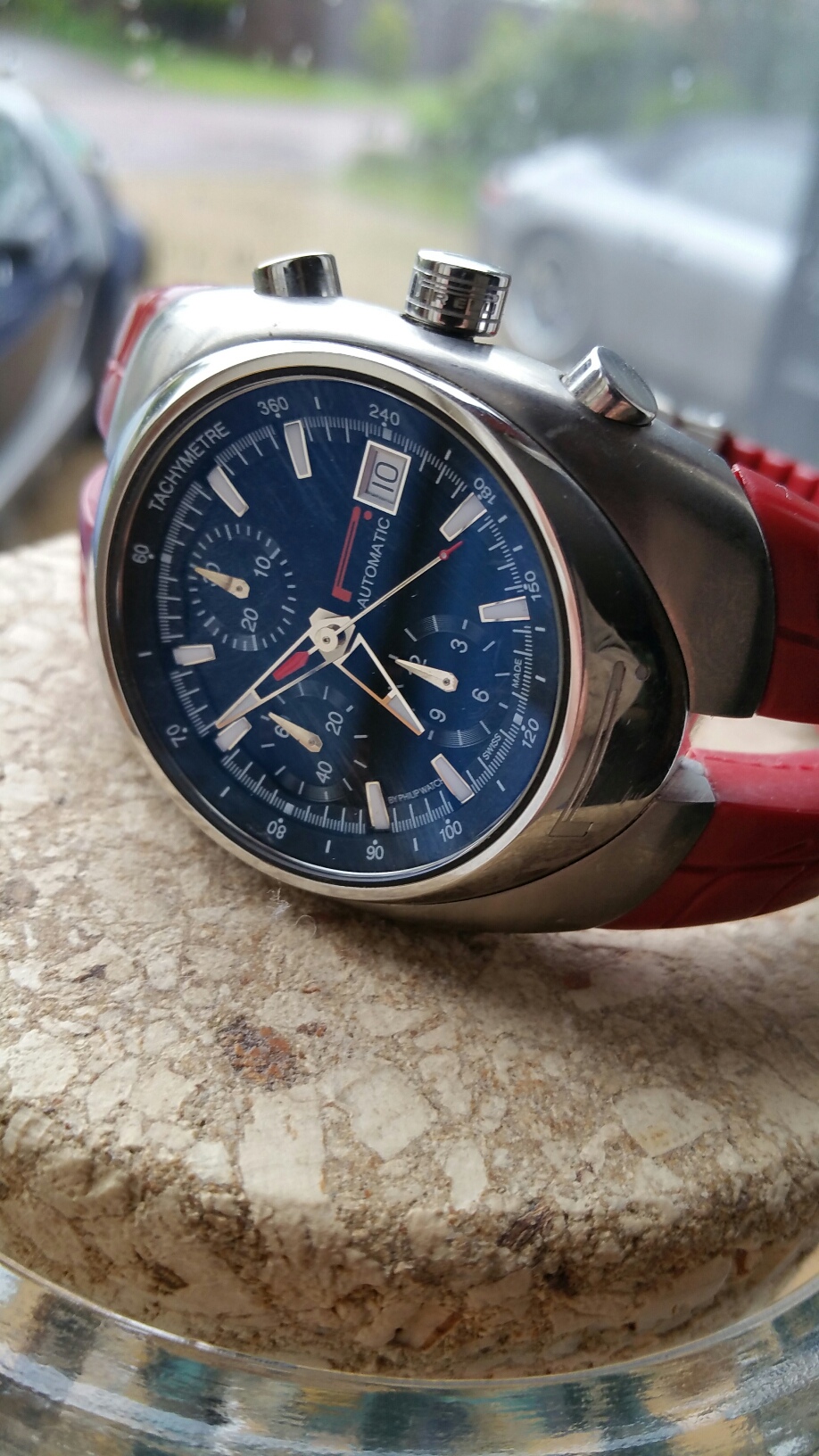

The 7750 in my Big Block does "Wizz Wizz Wizz" and the rotor is so chunky you can feel it wobble on your wrist...
And if it didn't wobble, it wouldn't be a wobbler.
