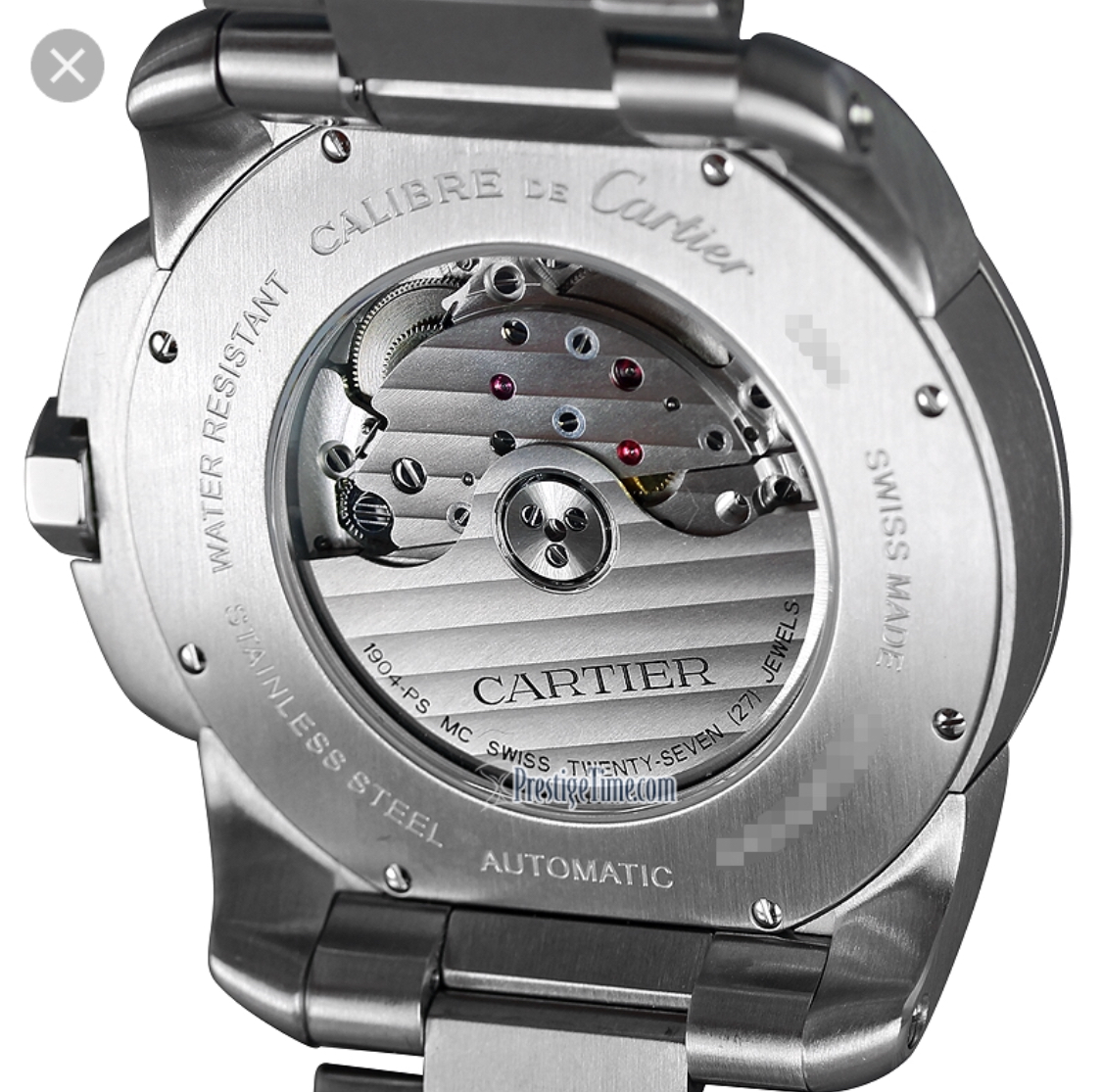

However, the recent trend of sapphire display backs has exposed us to a litany of boring rotors hiding the nicer mechanical bits underneath.
Why do we need to see this?
Gives the company another opportunity to shove their name down your throat...in case you missed it the first two times.
