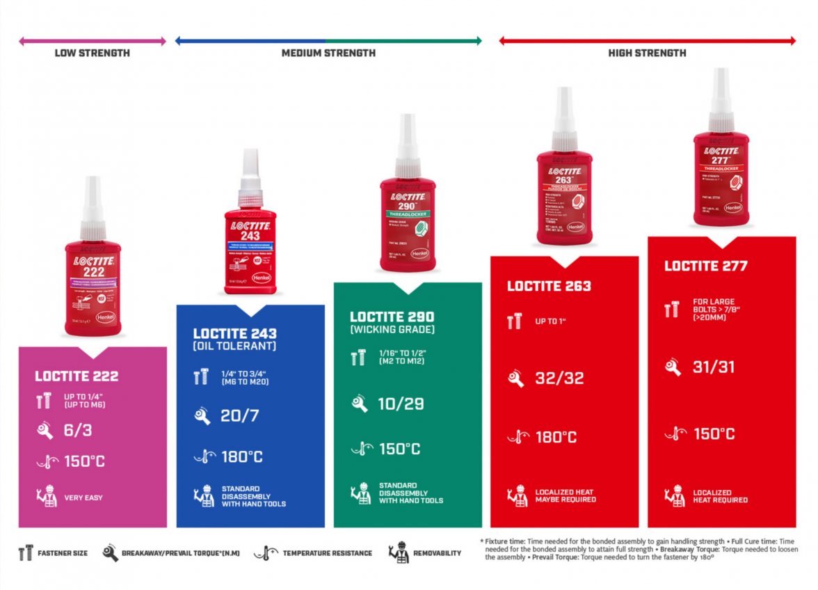

These values of breakaway torque tell me nothing..🤔
Blue or green I guess, blue 243 has fixture time 5 - 10 min., green 290 needs 20 - 60 min.

I prefer using the 243.
Keeps the screws in place and easy to take off with a screwdriver.
As for knives, imho, you have to use a stronger one than the 243.

For things like bracelet screws purple (low strength) works fine for me. There is little to no torque put on these screws (especially in an Omega bracelet), you just want them held in place.

Locktite 222 purple.
The blue, orange and red are for larger fasteners. Green is wicking for application after assembly.
They all have their place but only 222 on a watch. I use it for pusher and crown tube threads, also stems in crowns. No problems getting it apart when needed.
